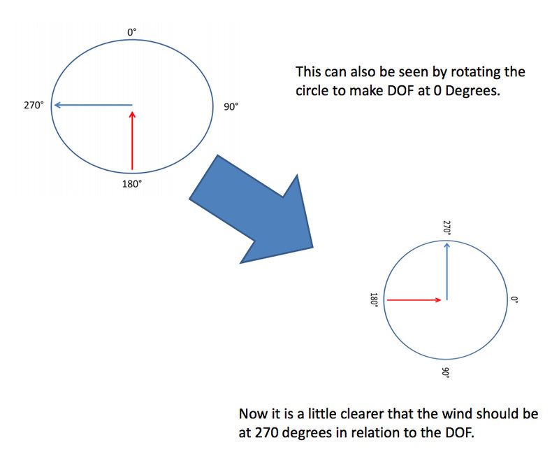

Hey Jamie,
I think the issue here is that you may be expecting both DOF and Wind direction to be absolute values but Wind Direction is not absolute, it is relative to the DOF.
For example, suppose you capture your DOF as 90 degrees (shooting East). The wind is blowing from the South (180 degrees). When you do your capture the DOF will show as 90 degrees (absolute) BUT the wind direction will also show as 90 degrees (relative to DOF). The wind is coming from 90 degrees in relation to the target.
So if you are showing a wind direction of 20 degrees, that IS pretty much a downwind wind direction. 0 degrees would be a perfectly downwind wind and it doesn’t matter what your DOF is, a perfect downwind will always be captured at 0 degrees.
Typically we tell people to just to use Magnetic North and they should be fine. You shouldn’t have to calibrate the compass every time they use it, but it is good practice to calibrate any time they go to a different location to shoot.
I’ve attached something that helps people manually enter numbers, maybe this will help explain it.
You can also see this post I put up for you:
https://kestrelmeters.com/blogs/news/compass-calibration-dof-magnetic-vs-true

Ran into this also when I taught a Kestrel class to my guys. Nothing is wrong, as it has been explained by Kestrel themselves. If you run dof and wind off a compass azimuth reading, it's going to confuse the user. Set the wind direction to the clock method and it will match what the wind is actually doing at your firing position.

I think you've got it except...generally wind direction is expressed on the "heading" you'd be facing if you looked directly into the wind. Look up your local airport weather observation and stand outside and check the wind direction....it'll make sense. So in your example above if DOF is 225, and you have a right to left wind that's exactly 90 deg full value, a Weather Station would report that as 315 at 19??? knots.
You're correct in thinking from a Land Nav Mag compass perspective with your back to the above wind your compass would read 135. But wind direction reporting standards hails from Nautical and then Aviation roots, and is generally expressed in the direction you'd be pointing when facing directly into the wind.
You might be over thinking it some. I think you're on it except for this piece.
For the Kestrel...DOF=magnetic...WD=use Clock position relative to DOF (DOF=12 o'clock)...and then where the wind is FROM, not going TOO...is the Clock position.
So in your scenario above, DOF of 225, a perfect right to left full value wind would be from the 3 O Clock
Hope that helps.
