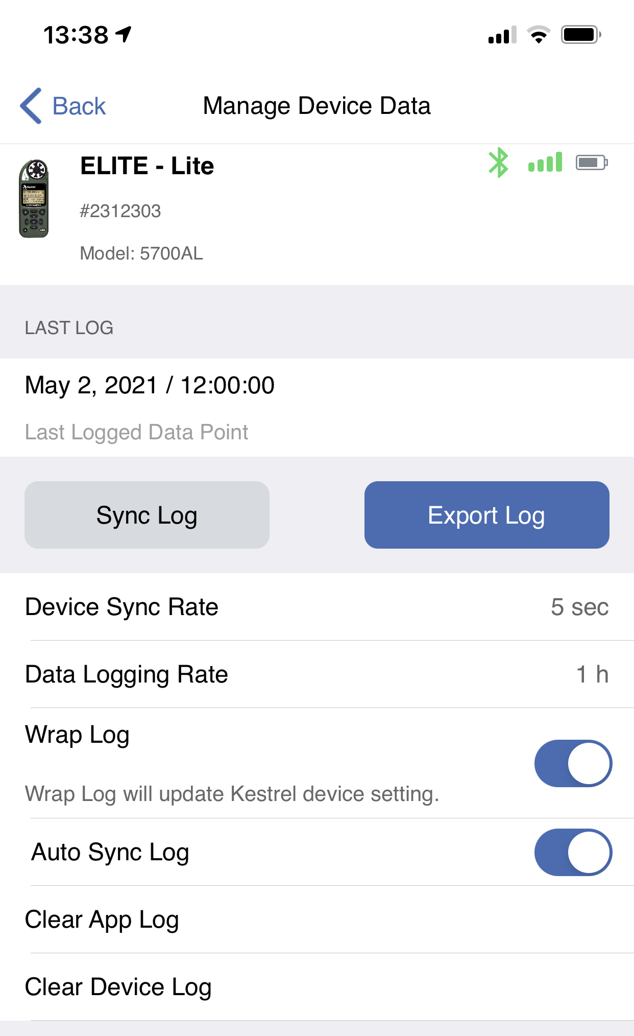

Restore and fw update revert settings, you want Data Refresh Rate (iPhone) and Device Sync Rate (Android) set to 2 seconds. Data Logging rate is interval if you store weather conditions on Kestrel and is normally not used for ballistic use. In your Kestrel go to memory options and turn auto store off to be sure you are not wasting battery and memory on that.
Reactions: Lite
Thanks! Auto Store was turned on! I've reset the interval to 1 hour and turned it off in Memory Options as suggested. Appreciate the insight.
BTW I'm using the new Kestrel LiNK app on iPhone and it does use the term "Device Sync Rate" which I have set to 2 sec as recommended. The legacy Kestrel LiNK app warns me to use the new app.
