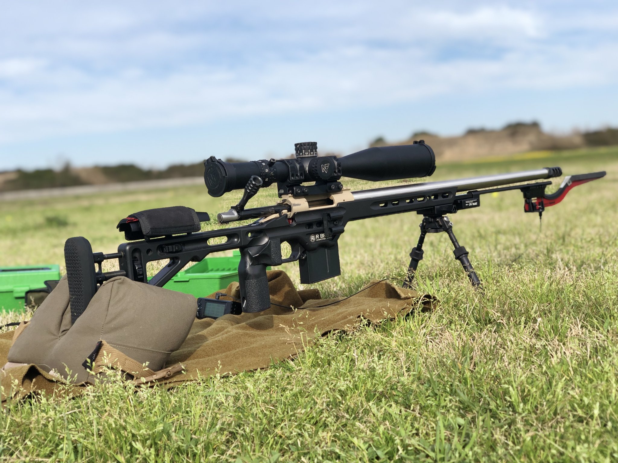

I need to pick some brains with the issue I’m having with my dope/Kestrel/apps
Start off. I built a 6mm Dasher for PRS matches.
My round.
Berger 105 VLD HUNTER

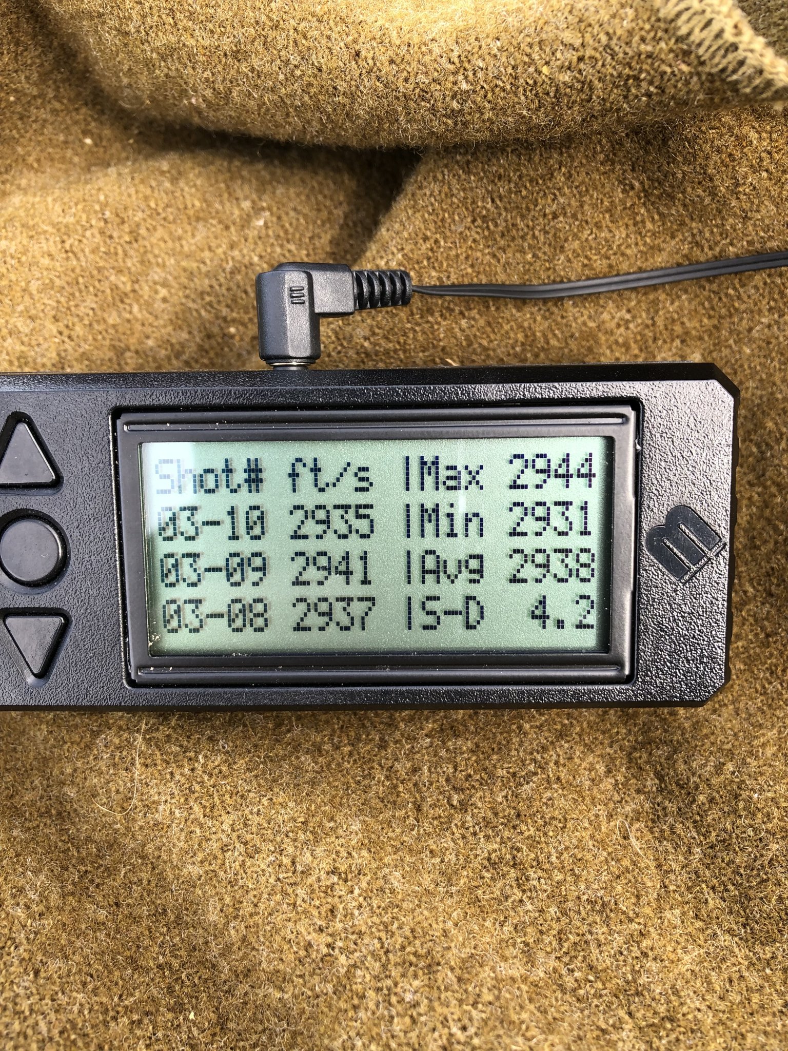

Magnitospeed Vel - Avg 2939 FPS 10 shots
SD- Best 1.4 with 10 shots. Avg is at 2.1-4.1 with 10 shots. That’s .020 off lands.

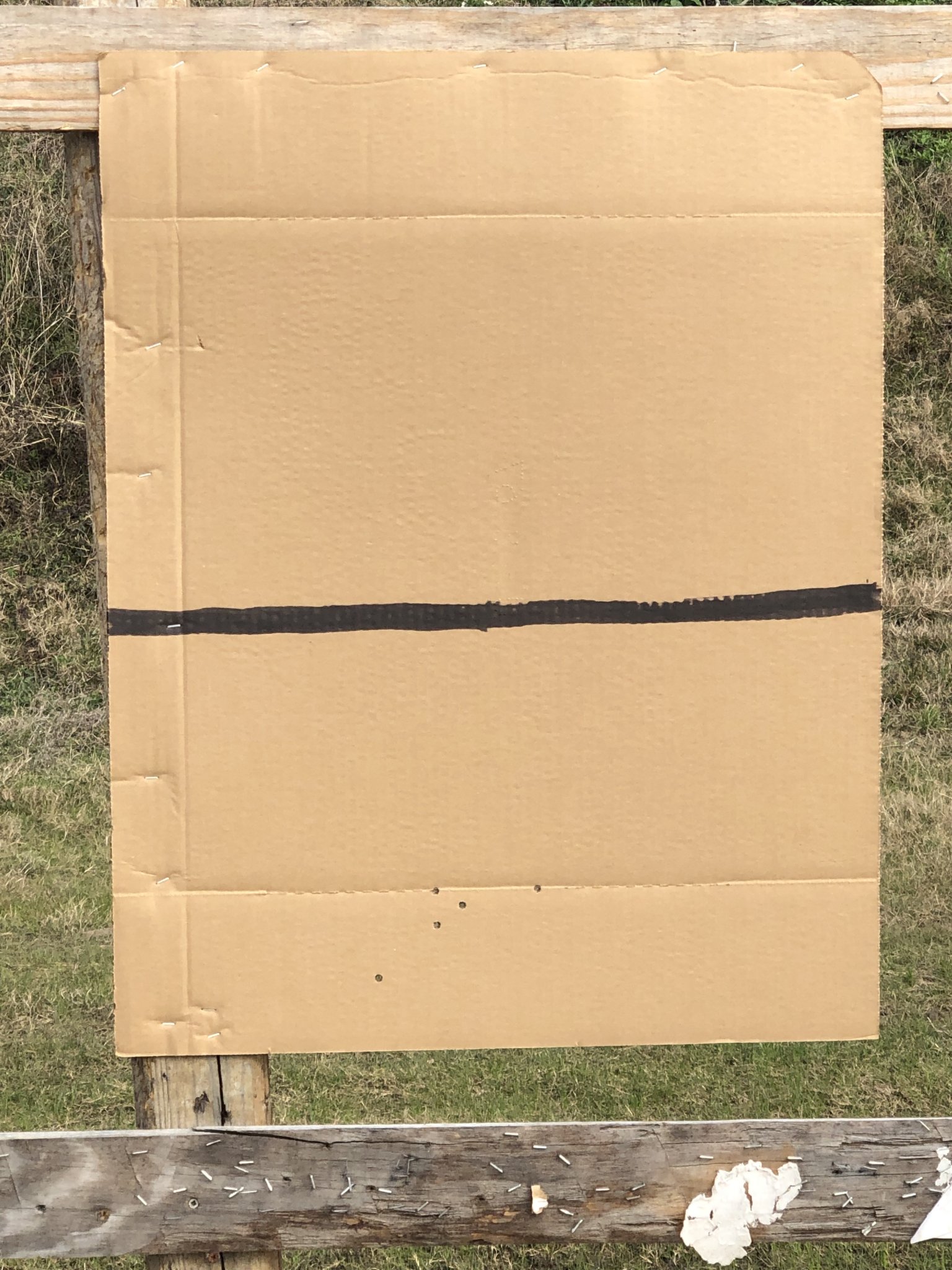

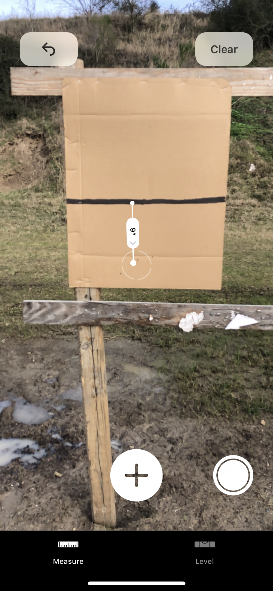

Get home wondering. So I go out and do a test. I put up a target at 600 with a waterline. I shoot a group of 5 shots. They all hit way below water line. About 9”. Three group and 2 I broke the shot badly. But still in the same area.
My dope should be 3.1 mills. My group was under an inch at 600.
So I dial until I get center impacts. My dope is 3.5 at 600. So I start shooting steel. Hitting the 2” repeatedly. Dope is on point.

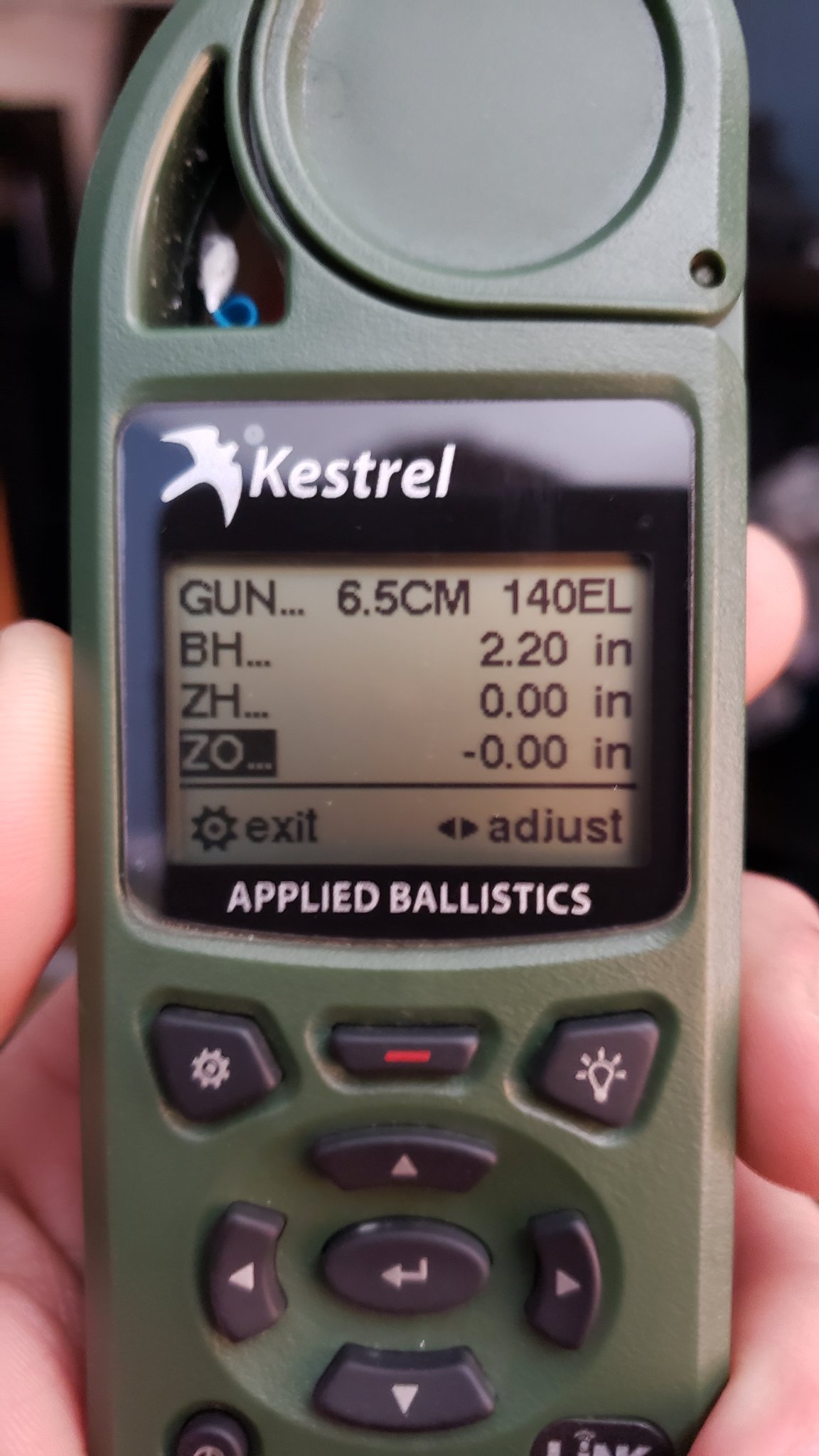

So I go in check my Kestrel. All data is correct. So I change my vel until it’s 3.5 mills. It says 2835 FPS.
I check my ballistic AB app. Says the same. For 2939 3.1
I check my StrelokPro app. Says the same. I change them to the 2835 and they say 3.5.

Oh. And I’d did change all sensitivity settings and got the same read outs etc on the magnitospeed to double check it too.

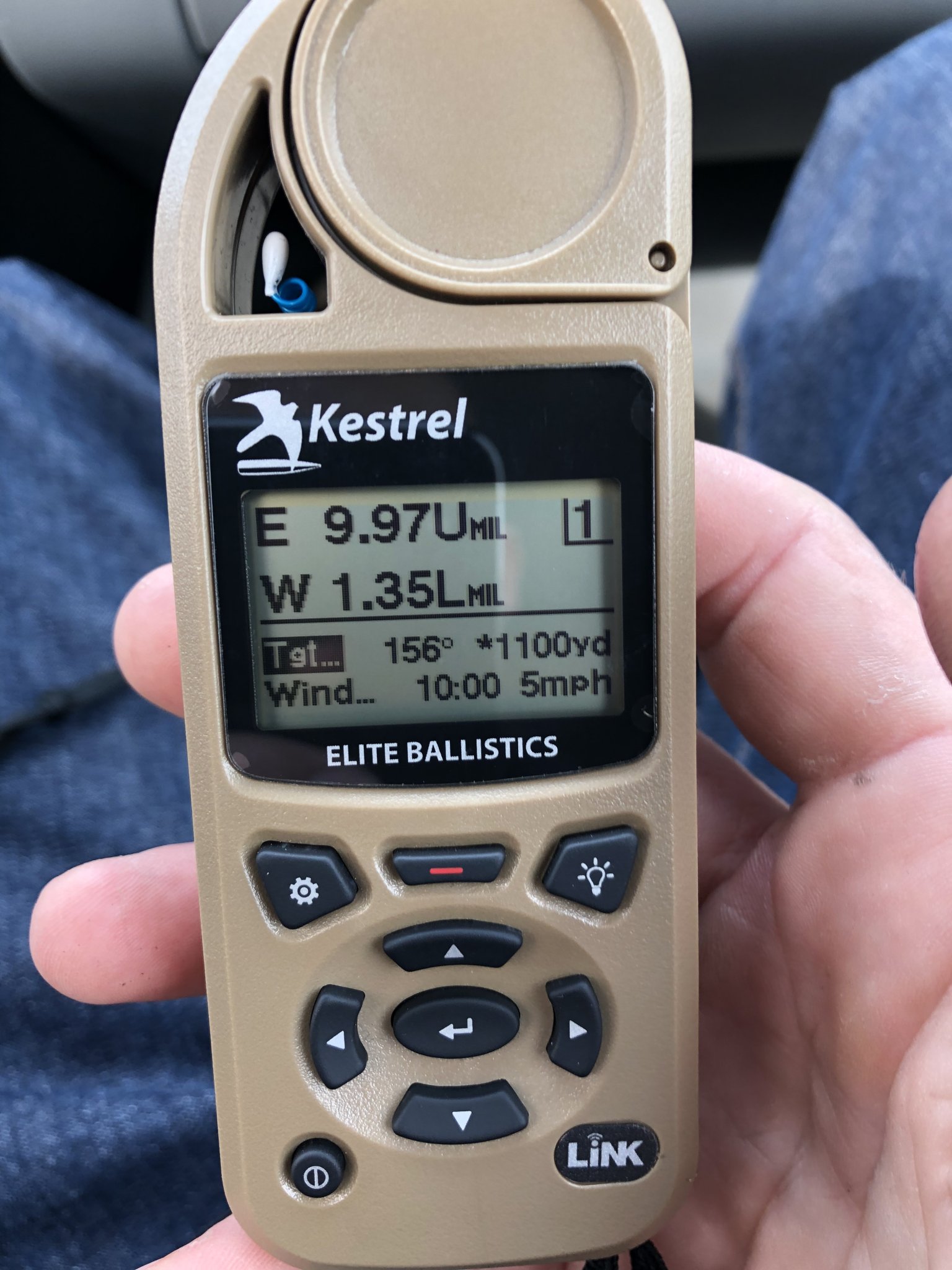

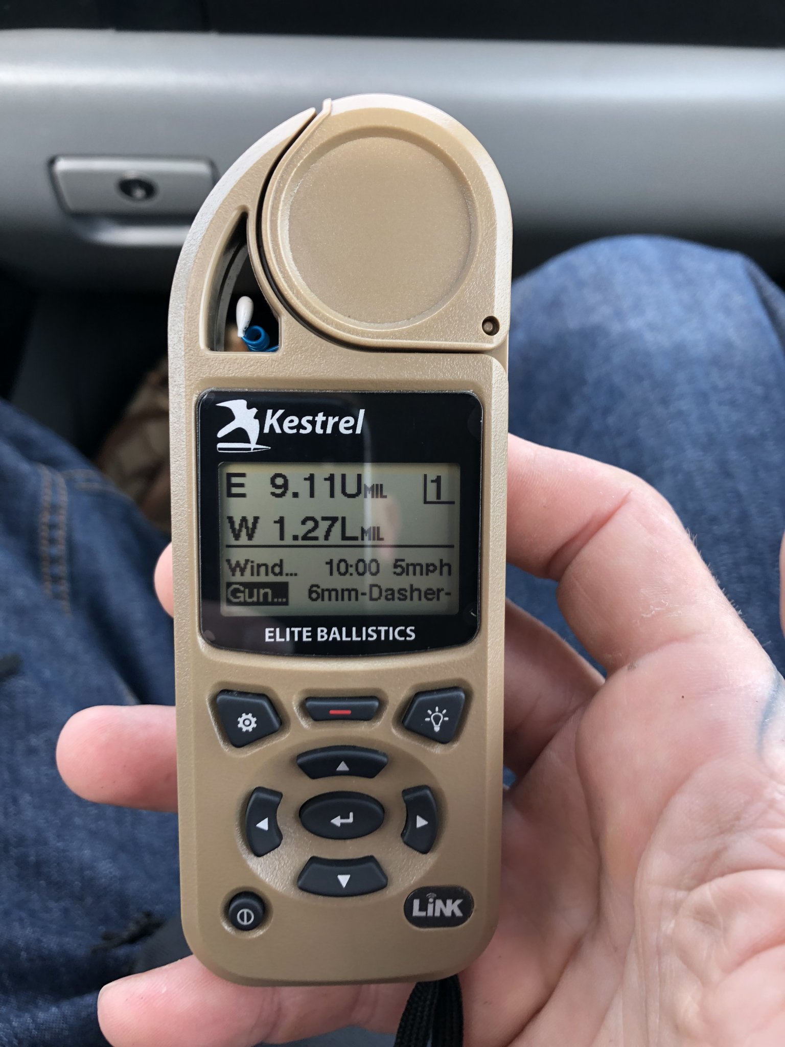

So at 1100 yards
E-9.1 is with my supposedly correct velocity of 2939
E-9.97 is with the 2835 velocity that yields me center impacts.
I’m stuck at the moment. Hopefully someone can shed some light on what’s going on. I’m going to go back to the range tomorrow and see what the incorrect velocity dope do’s at 200,300.
View attachment 7024165View attachment 7024166View attachment 7024167View attachment 7024168View attachment 7024169View attachment 7024170View attachment 7024165View attachment 7024166View attachment 7024167View attachment 7024168View attachment 7024169View attachment 7024170

  • Verify Chrono data with another Chrono at the same time if possible).
  • Double check inputs for Kestrel: sight height, zero height, BC and proper bullet profile selected (verify the numbers Kestrel has for your bullet like weight, length, BC etc.)

I’ve checked with a few shooting buddy’s. They have gone over everything with me. Say that everything is right. But it has to be something in the data somewhere. Iv prob gone over everything 15 times to try and find it if so. But I can’t. And with 32.450 grains the VEL is right where it should be. A buddy who shoots this is running 32.7 and his VEL is AVG -2972 FPS. So I’m pretty sure the chrono is on point. Just can’t find what’s causing this.

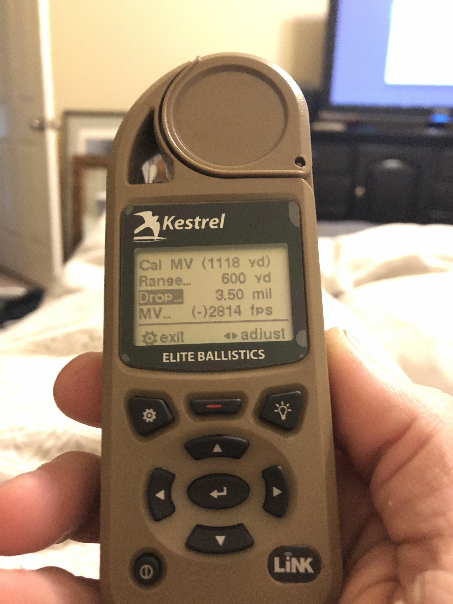

I did this at 600 because I don’t have 900 to 1000 available. Mine go’s transs at 1118.
Just did it in my Kestrel and it shows about 20 FPS Slower than I had put in at 3.5 mills. It is showing 2814 FPS.
Iv also been meaning to true my BC to at some point.
