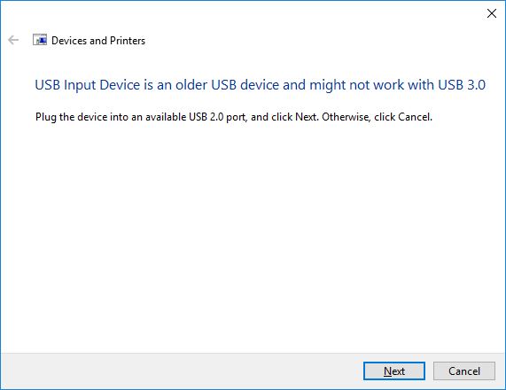

    I can't seem to get my PC to connect to my Kestrel. I've had the cable for a year or more, always worked. PC is new, and Kestrel just got the latest firmware via LiNK for iOS. Any ideas how to troubleshoot why the Kestrel cannot communicate to the PC apps anymore?

    I wonder if the cable doesn't work with USB 3.x ports? The 'Devices and Printers' screen shows it recognizes the "Kestrel Infrared to USB Interface" device. The troubleshooter suggests I plug it into a USB 2.0 port, which the new PC doesn't have.

    They do work with USB 3.1. That is what I use.
