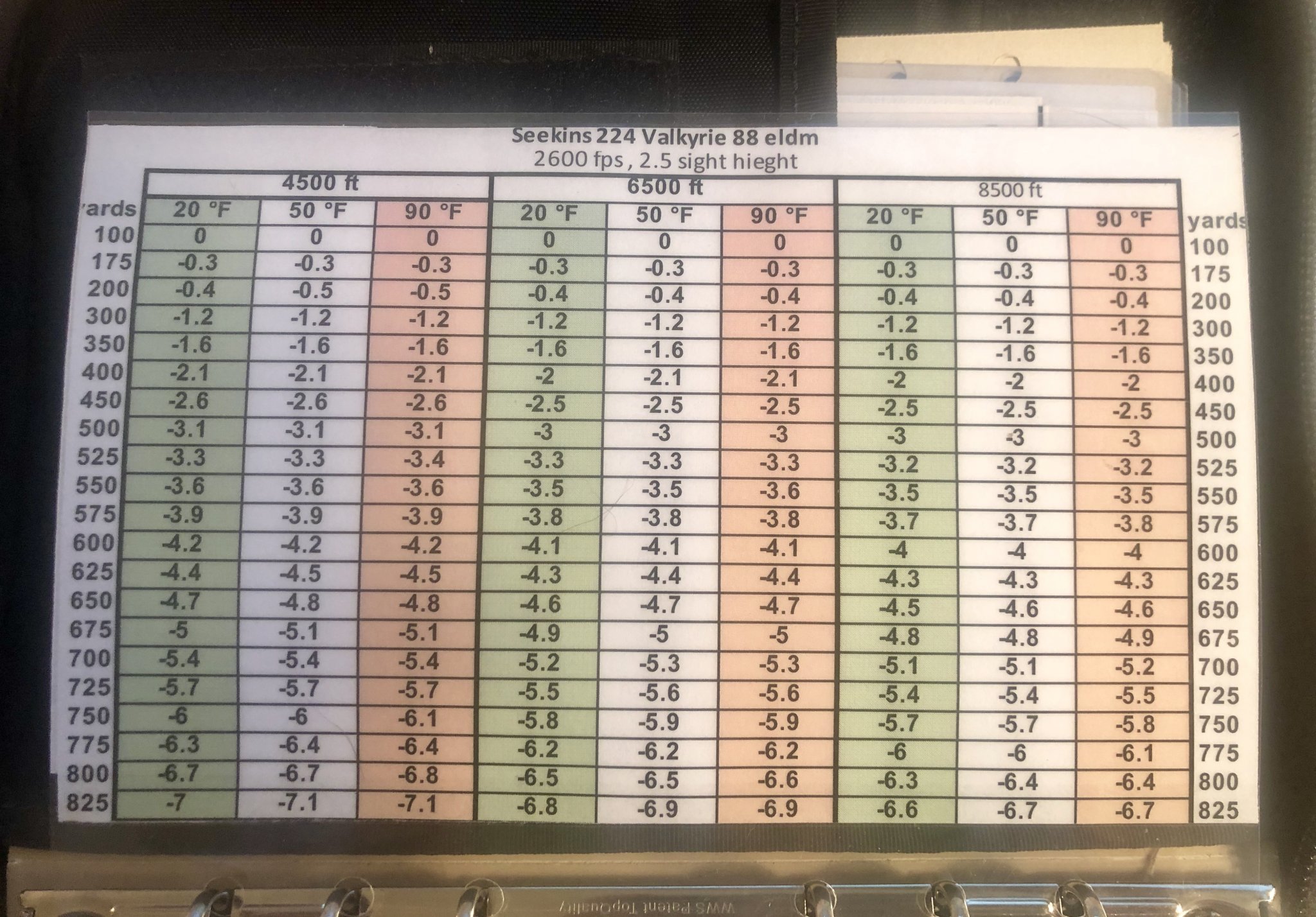

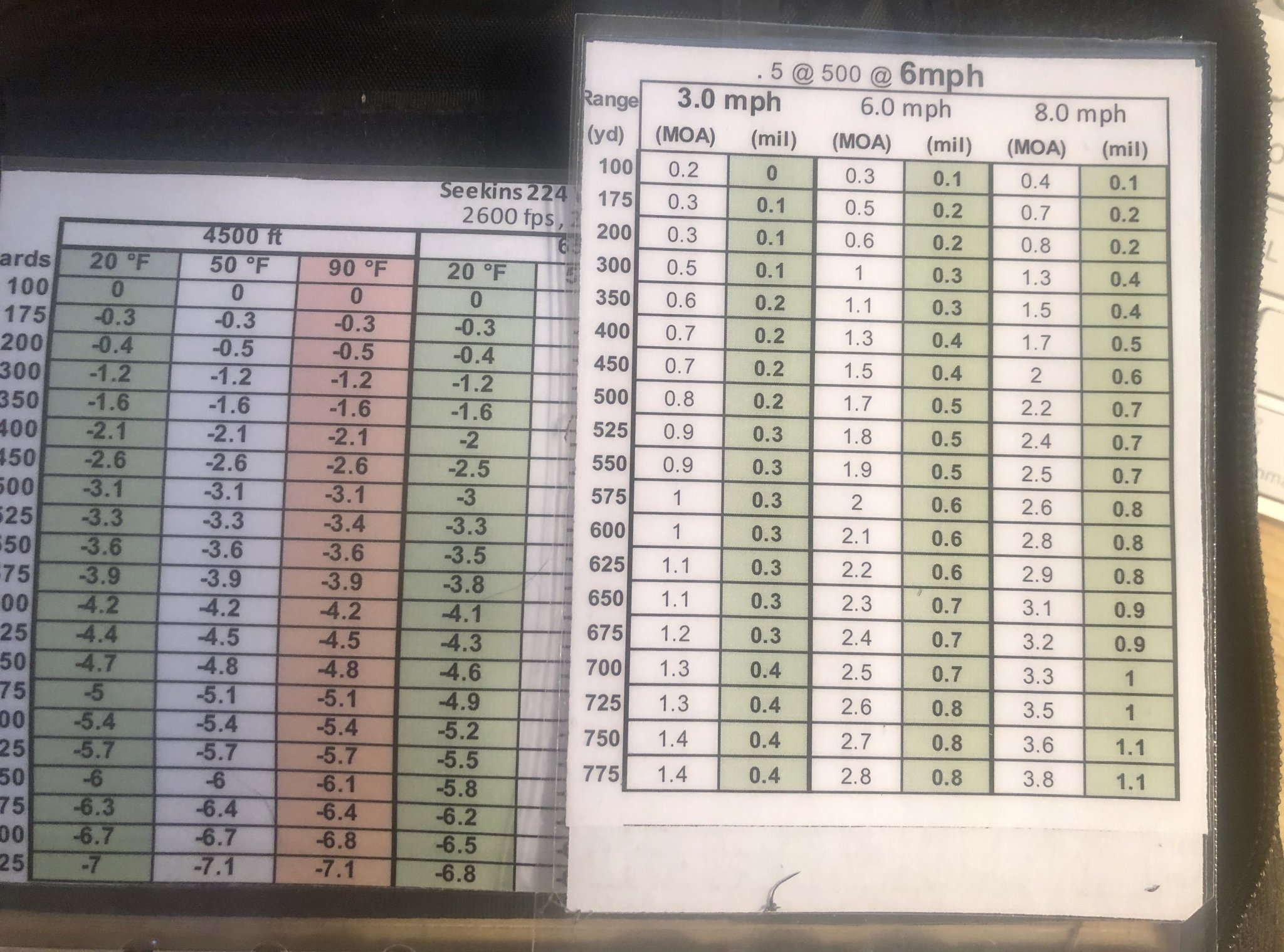

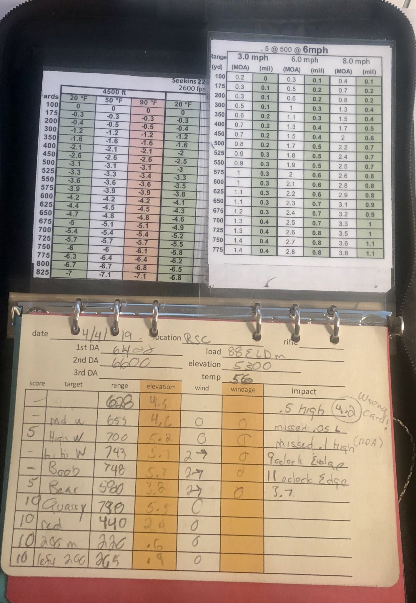

Use this set of cards unless targets are 1moa then use kestrel
