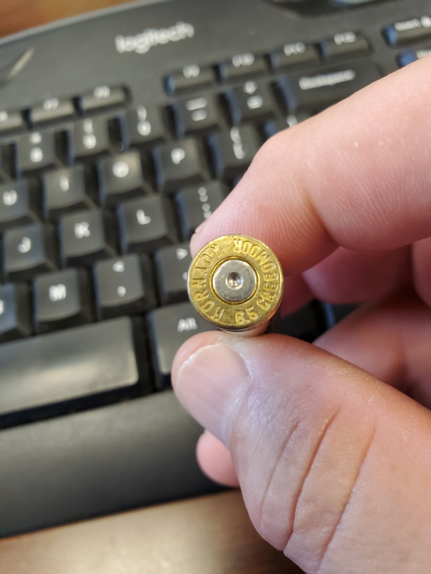

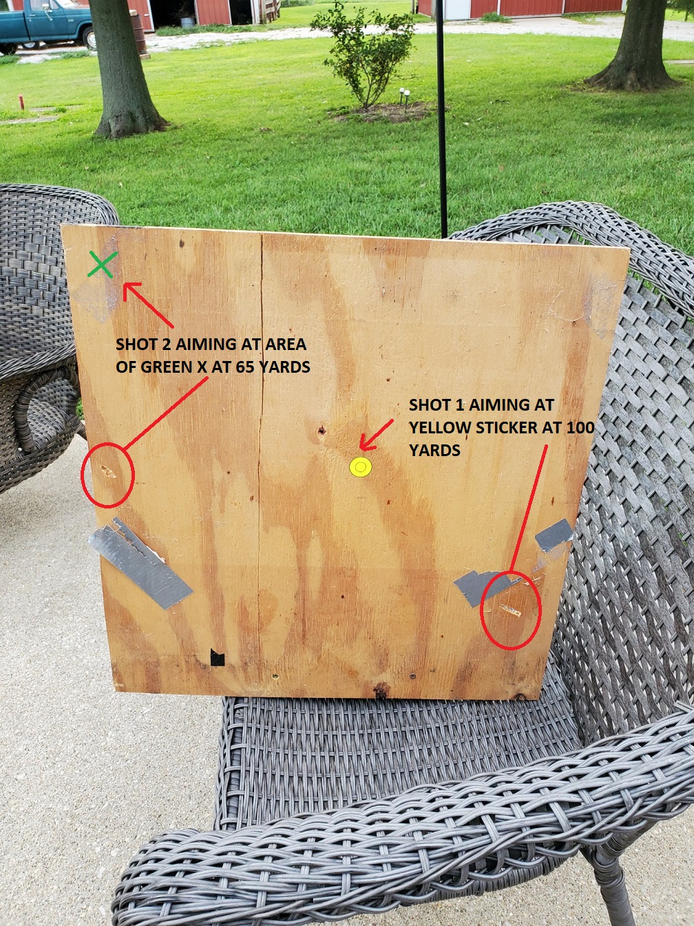

I just purchased a new Ruger American Predator 6.5 Creedmoor. Using Hornady Precision Hunter EDL-X 143 gr. 1st shot 100 yards (sighting scope) 3/8 plywood. Left a perfect boat shaped hole. Wondered if it was shooting really low and skipped off the ground causing it to tumble. 2nd shot 65 yards, raised higher, bullet went higher but again a boat shaped hole. I have read that this load does well in other 1 in 8 barrels. I have a friend that is going to check out the rifling and head spacing because he too thinks it is the gun and not the ammo. I am having a hard time with at 2700fps 65 to 100 yards this is turning completely sideways in this short distance. We are going to try different loads as well but I'm not expecting different results. Any suggestions or guidance is appreciated 20200811_195842.jpgshot 1shot 2
Check your headstamp on the brass. I have seen the wrong caliber in a new box of ammo before. How is the recoil? If it is very mild that could also be an indicator of undersized projectiles. You may have got 6mm creedmoor by mistake.
I had checked that right after the first shot and it says 6.5 Creedmoor on the box and the casing. Is it possible to press the the incorrect bullet in the correct casing?
It's possible I suppose. Highly unlikely, but worth a check. If you have a calipers or a micrometer, you can measure the bullets.

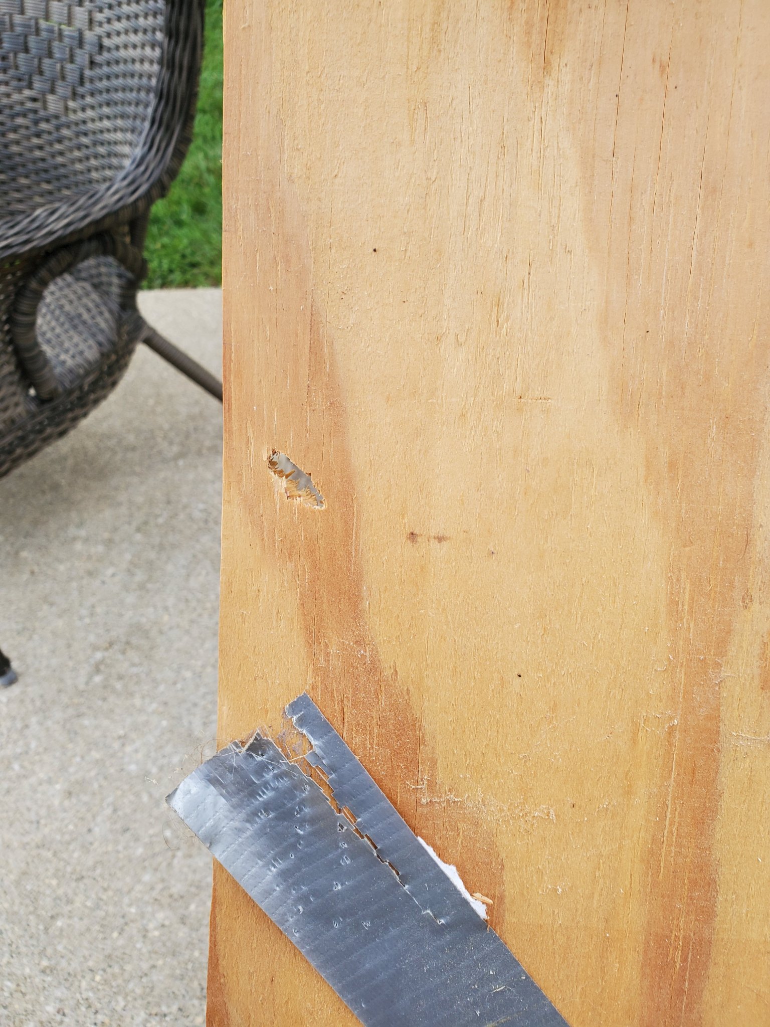

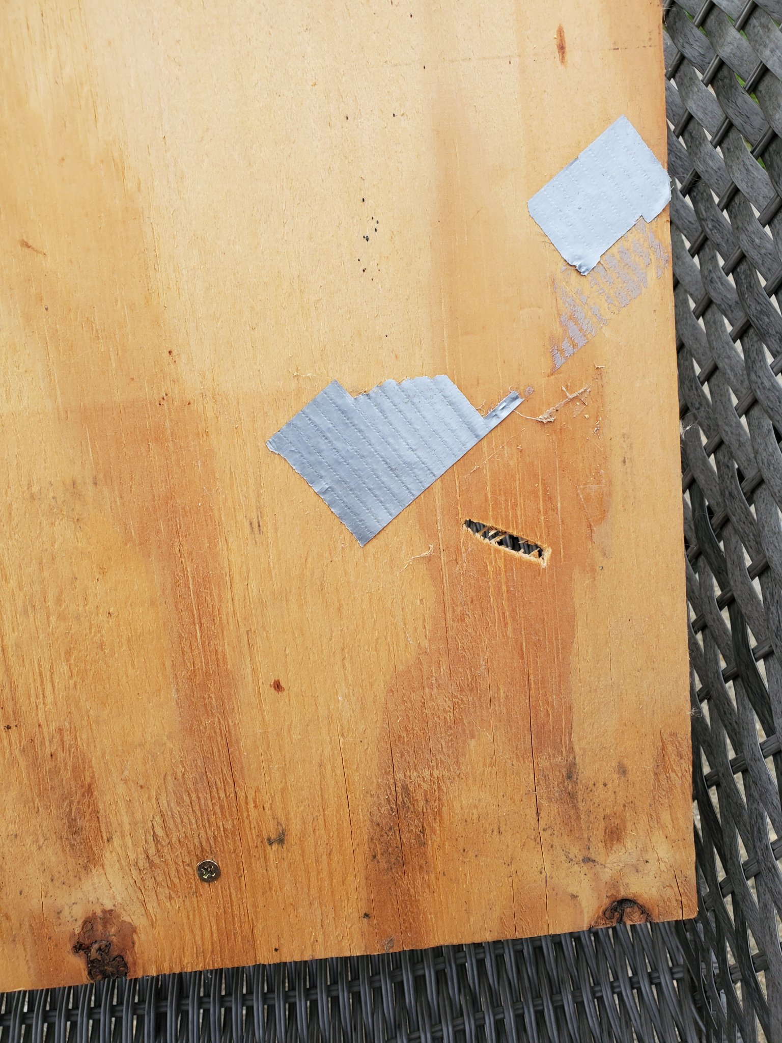

Is there a brake or suppressor on it that might be adversely affecting accuracy? If a bullet grazes a muzzle device, that sort of thing can happen. (this would do it if the threads aren't done correctly)
Good picture, btw. Keyholed perfectly.
Take any muzzle device (if you have one) off, and shoot at 20 yds to see if it still does it. If not, most likely skipping off the ground.

No brake or suppressor. Bad barrel or incorrectly stamped (marked 6.5CM when its actually something else. I live by Murphy's law! Itching to sight it in and shoot it since I just bought it, looks like Ruger does not pay return shipping, 2 to 4 week turn around, lost in mail Hahahaha
Good call.
Zero your scope to about 2" above that point of impact, that will put you close at 60-100 yds and you won't be skipping (if that were the case)
The second shot (left side mid) was taken at 65 yards aiming at the upper left corner. I did this because I too thought it might be skipping, so aiming at the top, and reduced distance would have eliminated bounce (100 yards bottom right contact vs 65 yards mid left contact)

Not a single blemish other than the incorrect headstamp.

Being checked out now. Never shot a 6.5 before so nothing to compare recoil. I'm definitely not an expert, so all the help is appreciated.

The first thing I would do is make sure the bullet is not skipping. Set up a 2' x 2' paper target at 25 yards and shoot at the middle. Once you know where the impact is adjust "0" then try longer ranges.
I have it at a local gunsmith right now and he is checking it out. If it gets a clean bill of health, then we try different loads. The rifle was set up 3.5' off of the ground, aiming at a point 24" off the ground at a distance of 65 yards. The bullet would have to hit the ground 10 yards before the board, to impact it 1/2 way up the board. In my thinking, there would have to be visible issue with the barrel? I also looked after both shots and saw no visible marks on the ground.

Bore sighted (crude but always got me close enough for a start) sighting through barrel on a fixed point at 25 yards, adjust scope accordingly. Second question, was not trying to zero in. Keyhole at 100, moved closer and aimed higher because at that time I was thinking the first shot skipped off of the ground. I did not try at 25 yards because its a 6.5 Creedmoor, 25 yards for that gun would be like setting a target at 3 feet to sight in a 22, so why not set it at 100. Looking back, I hit a 24" x 24" board with a bullet doing the hokey pokey at 100 yards, and could have easily zeroed it in. At 25 the bullet hole would have looked normal because it have had less distance to spin. My thinking anyway. Humor me and explain " Nothing about this makes sense, including what you're doing" because guidance from someone who know everything might be what I am looking for.
The first thing everyone does when they have a keyholing issue is to investigate at what distance the keyholing begins.
If the bullet is full profile keyholing at 65 yds, the hole wont look "normal" at 25 yds. It will be noticeably elongated.
At 100 it was full profile keyhole, 65 partial and noticeable, at 25 I believe it will be barely noticeable. I guess what I need to do is start at 25 using different loads and then step out to 50 and repeat. I have not had time this week between rain and work. If switching loads solves the problem, Great! If not, I would say it has to be the rifle. I am a little leary after others have said I should not shoot it until it is checked out.
