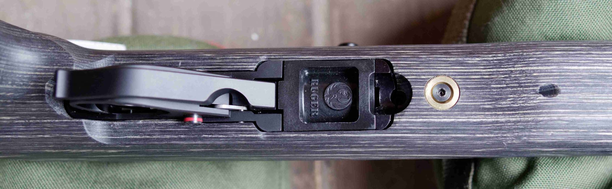

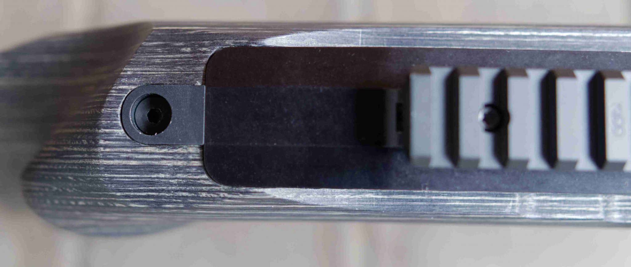

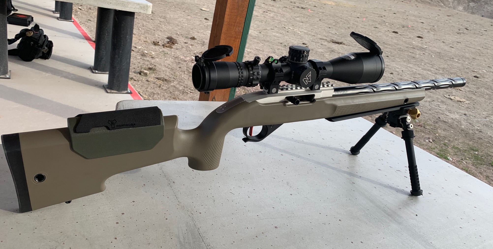

I wanted my Kidd Supergrade in a GRS stock because only a custom stock is better ergonomically for me. GRS makes a stock for a Ruger 10/22 but not for the Kidd rear tang. That additional inletting and bedding was expertly done by George at SonoranGunstocks.com. George even drilled the appropriate channel so can change barrels without removing the action.
It would have been about six months but took about five weeks longer because of the pandemic.What was the turnaround time for this work?

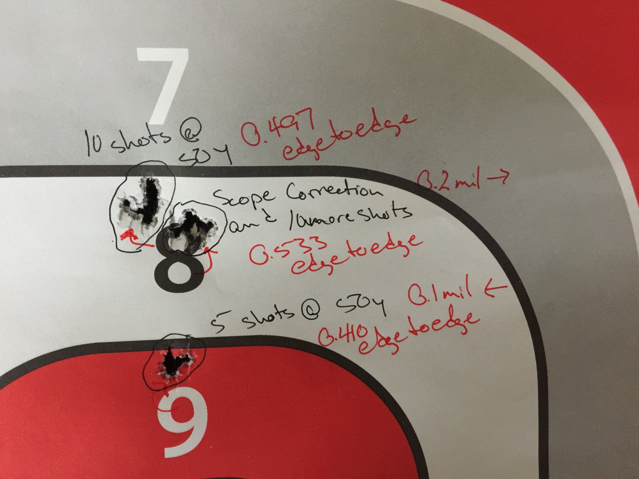

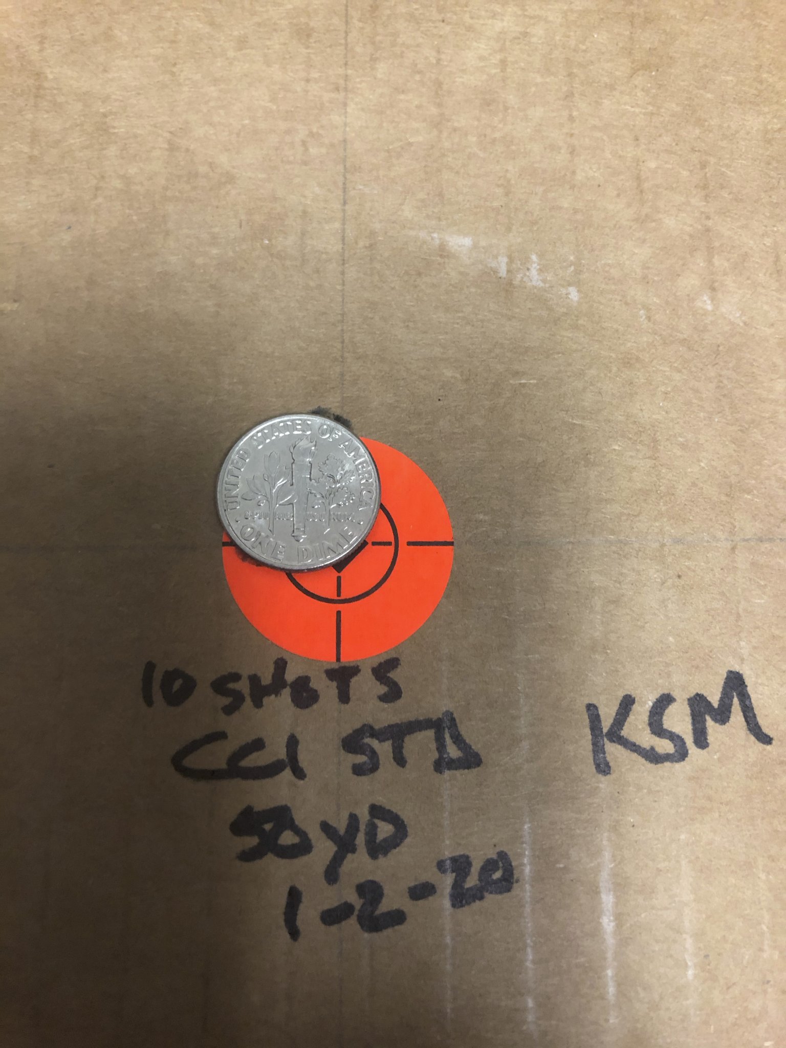

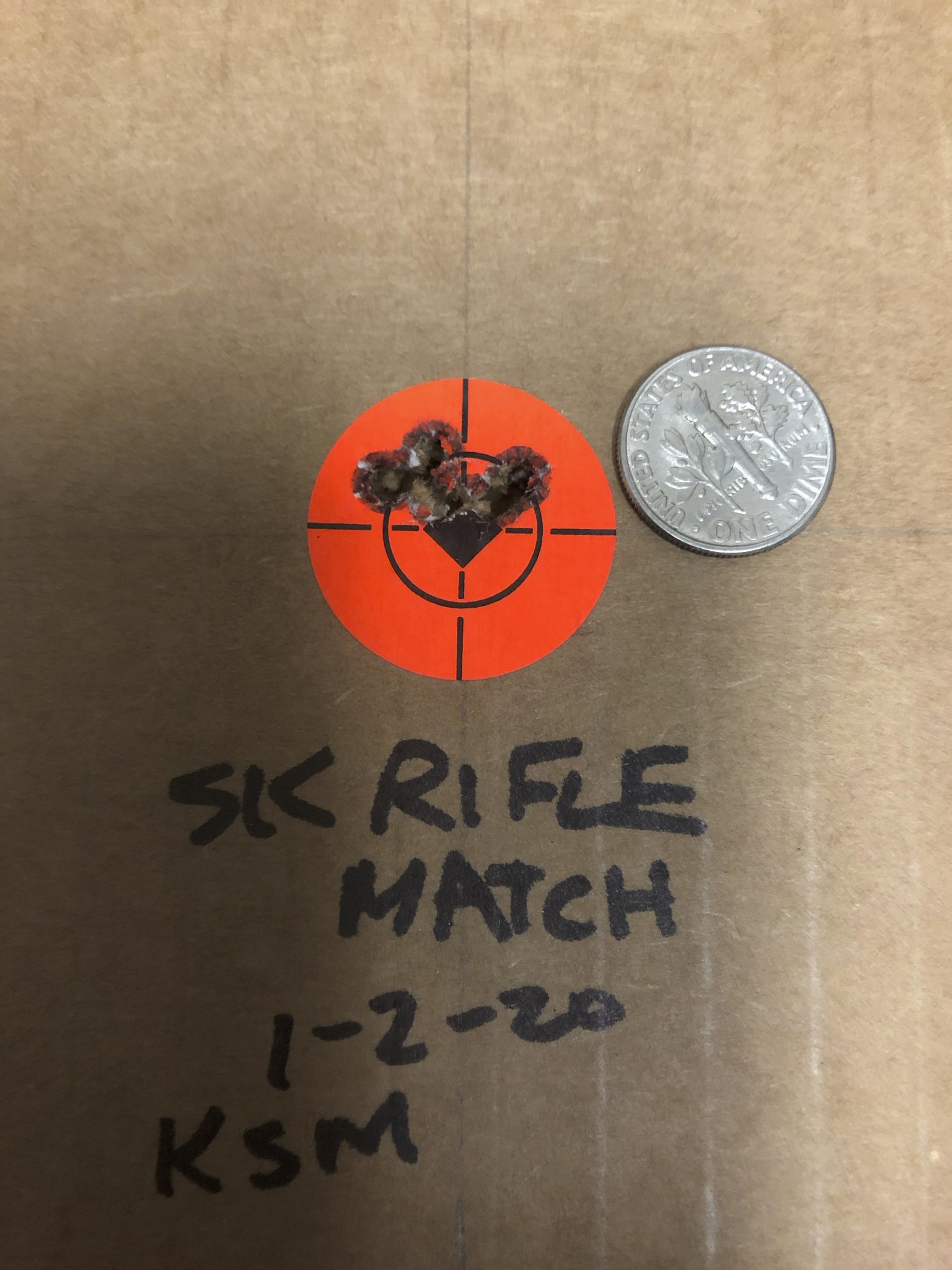

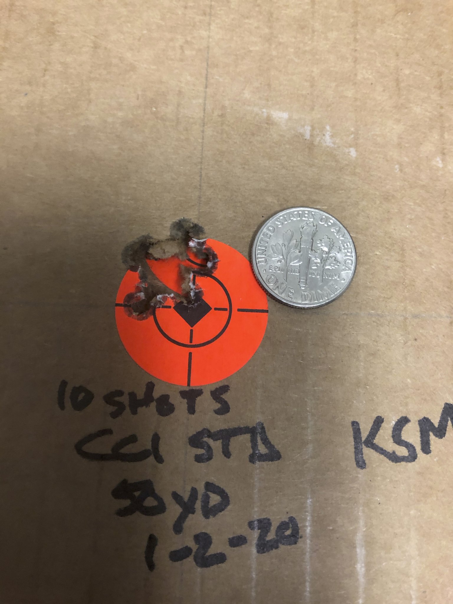

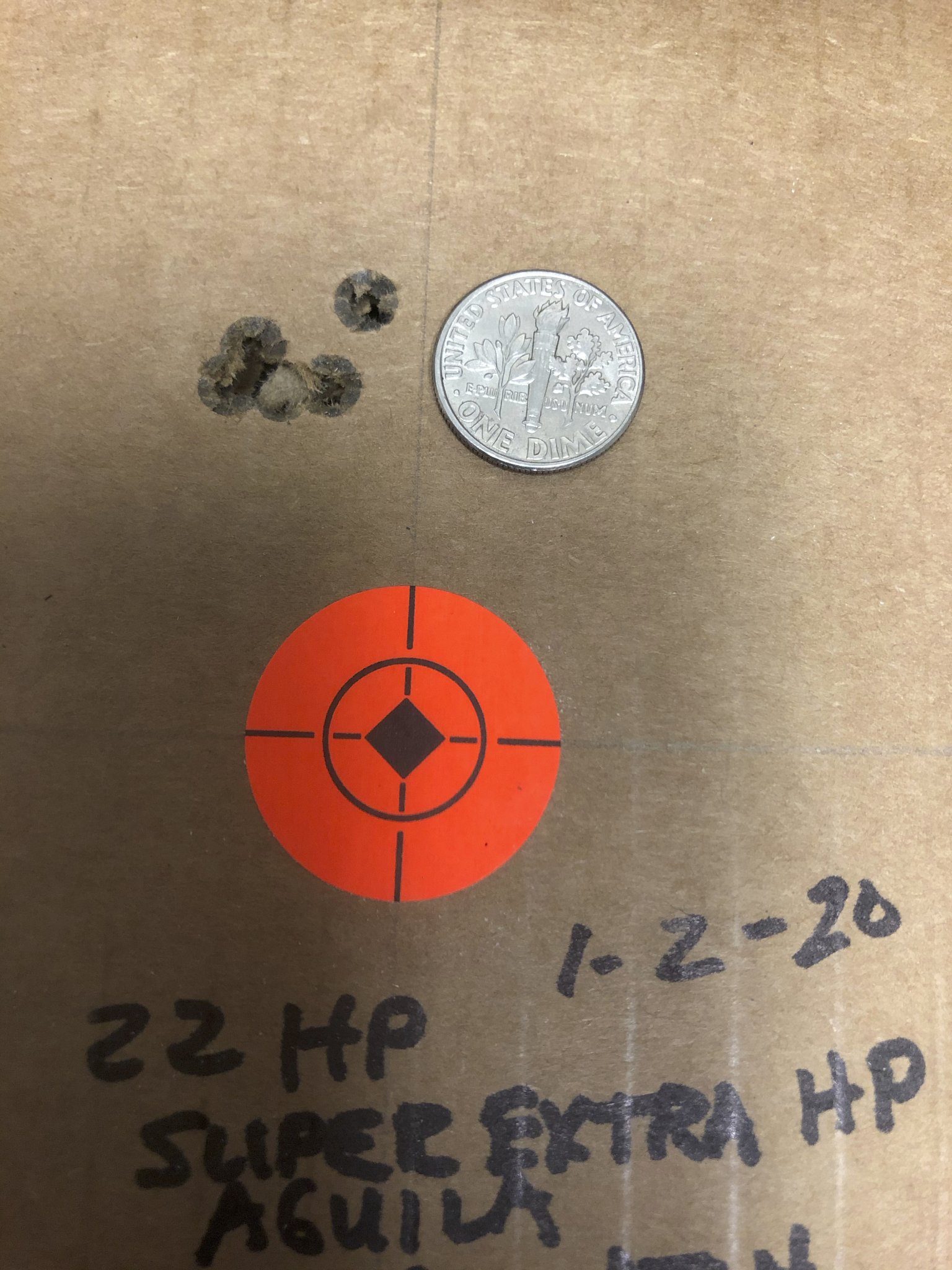

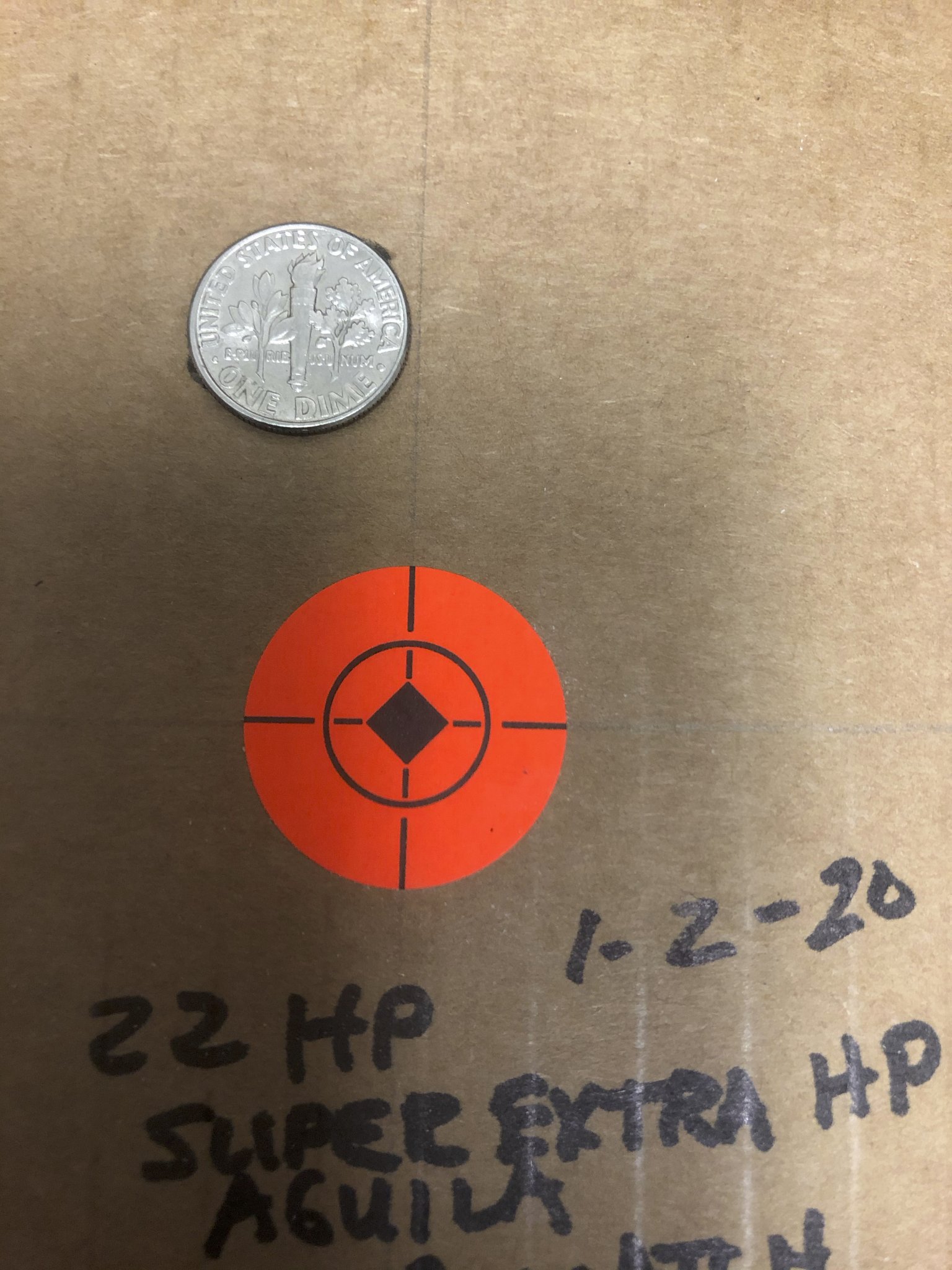

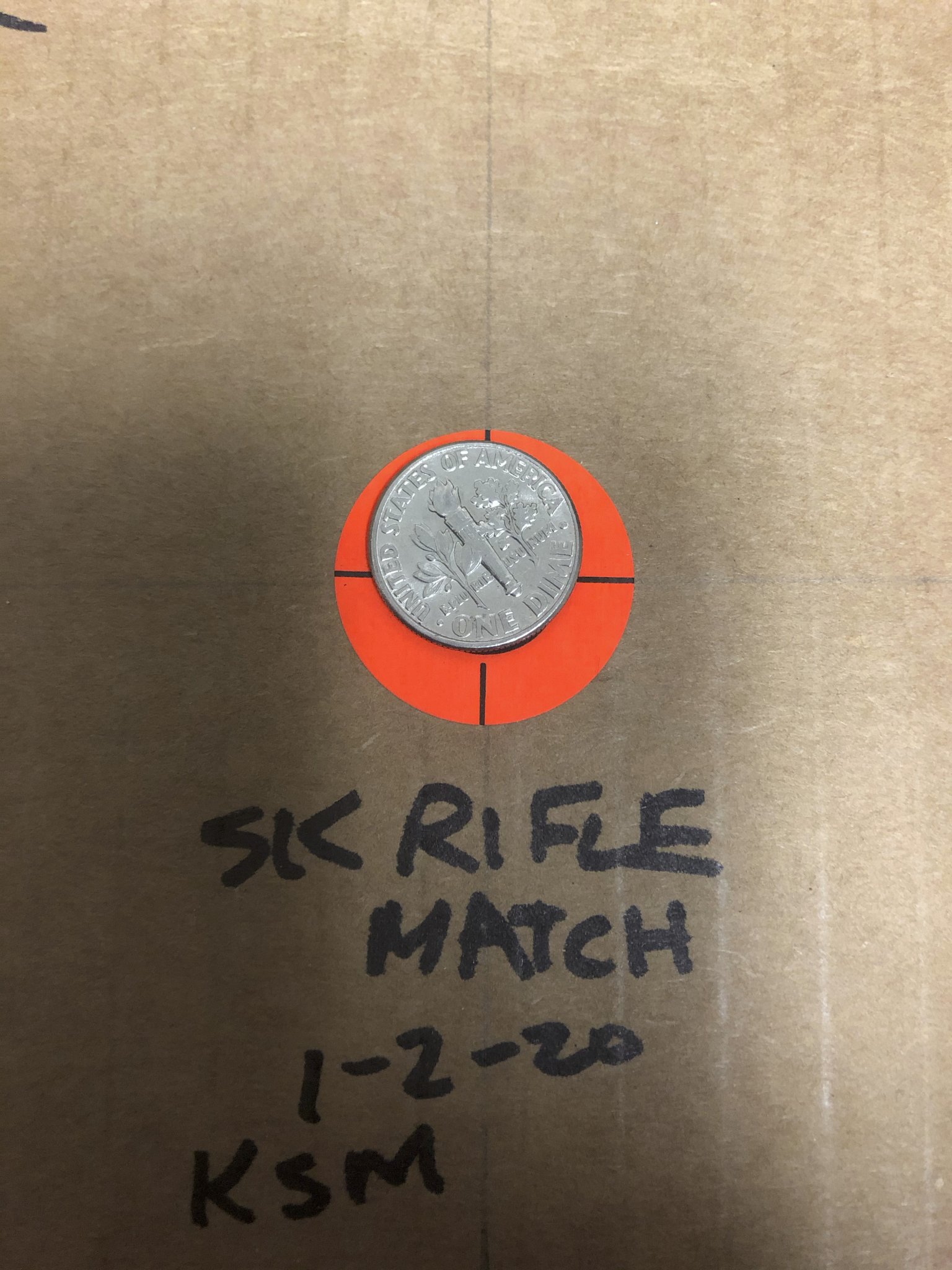

I've had my KSM for several months now, and am very pleased with performance and accuracy. (When I ordered the rifle I asked if they recommended a particular brand of ammo and the gal that I talked to suggested trying CCI STD Velocity) I ordered a couple of boxes of various brands of ammunition from Midway (CCI, Ely, SK, FED, etc. match loads) to test with. I have several other .22's, one of which has the Victor stock, match barrel and trigger. CCI (for my rifles at least) seems to be the most accurate for the money. At $.07 it is much less expensive than SK or Ely and accuracy at 50yd is on par. (at least through my rifles) Past 100yd is where I see some benefits in the more pricy ammo. For example, SK rifle match shoots very well past 100yd, but so does the CCI Mini Mag Target for less money. I've attached a couple sample targets from just before our local authorities closed down ranges because of the Wuhan Virus.I'm genuinely confounded by the results other folks report from CCI Std. I've shot thousands of rounds of this stuff and I've never encountered a box that was better than 1.5 to 2 MOA at 50 yards. I run it through my MK IV pistol, so every time I buy a new lot I test it in my Kidds and my CZ and it always disappoints.
