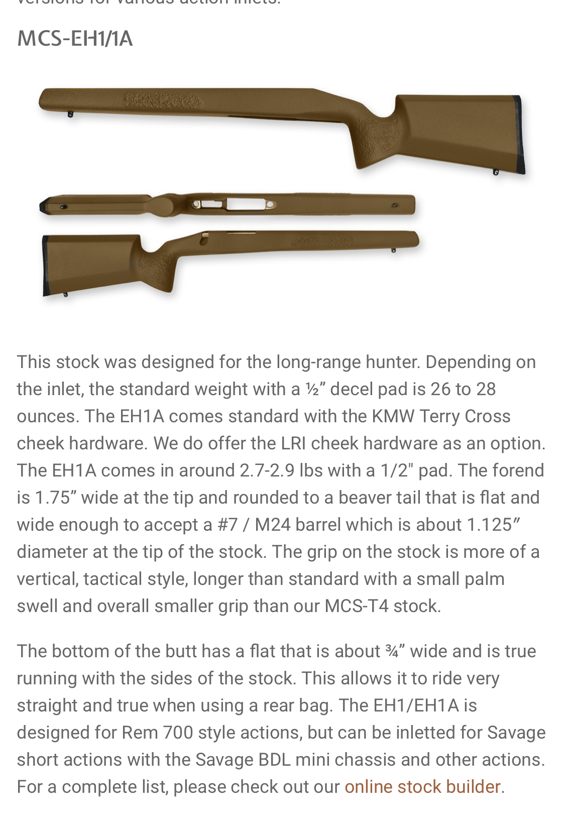

I was just going by the quoted weight differences on the Manners site that they list. For example, for the Elite Hunter 1 they list 26-28 ounces and for the Elite Hunter 1A adjustable they list 2.8-2.9 lbs. Maybe there are other differences in the stocks that account for the weight difference?
I am thinking that a stock out of the 2 piece "adjustable" mold will always be heavier because of the added shell weight. I also believe that the ultra light fill used throughout the one piece stock cannot be used in stocks that will host hardware because that fill cannot tolerate any shear at all without tearing out. This would be true of any hardware configuration.
This is just what little I know about the process and manufacture constraints. I would highly encourage you or anyone else having specific questions regarding these type topics to contact Manners directly. Robert Brantley and the crew are super knowledgeable and eager to help.
