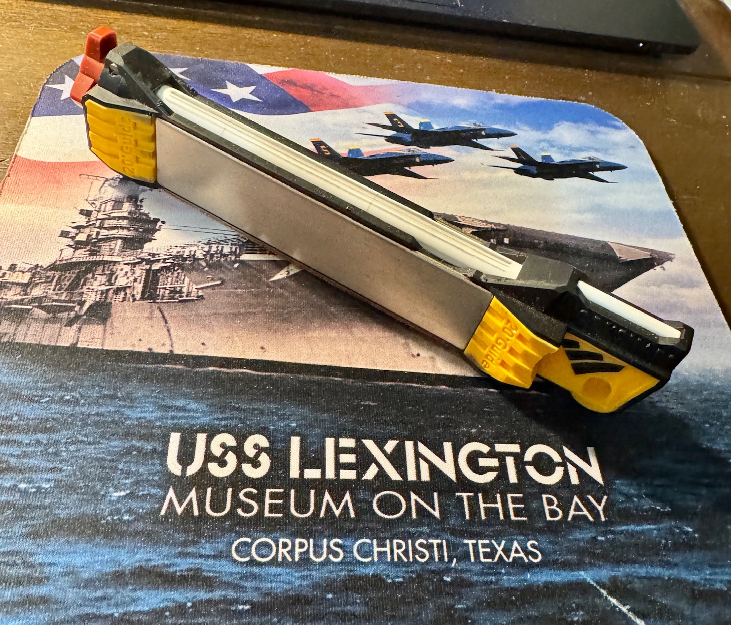

This little unit from WorkSharp has worked really well for me. Coarse and fine diamond stones, coarse and fine ceramic rod, leather strop, with guides for all. $35 at Menards/ Cabelas/ Scheels. I mostly just use the ceramic on my MiniFreek S90V.
That looks simple and in my price range. I watched a video on it before I started this thread.
Started using this sharpener as my general purpose sharpener and it has been working really well from my pocket knoives to my 9” cooking knives.
That's the third recommendation for this affordable and relatively simple sharpener.

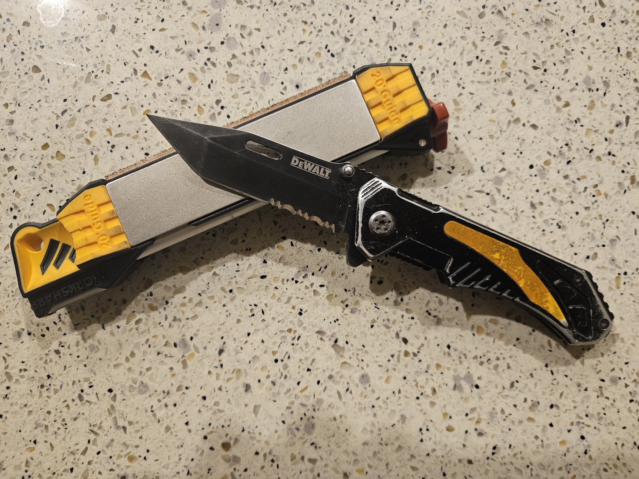

The Worksharp Field Sharpener showed up the other day and I have been trying it out.
I like it. It is conveniently sized and was affordable. I like the little serration stone. Learning curve is minimal. I don't think I am using it to its full potential as I need to get more of a feel for pressure and number of strokes required per step but already I can get a decent edge on a dull knife in a few minutes.
Thanks again for the recommendations and I do appreciate the people who suggested other setups as well but I think this is just what I was looking for

Well there isn't much to my setup. It's the same one 1911Hombre posted.
One of my well used Dewalt knives was a bit of a challenge with the tanto point (I do a stroke for each section), the serrations, and because it is a little bent but it was a cheap knife good to learn with.
I would suggest watching a video on the sharpener to see everything it has. It's a neat product.
I probably won't get as nice an angle as a Lansky or other setup that holds the blade for you but it works. In one of the few negative reviews someone said they used it for an hour and couldn't get their knife sharp but if I can use it anyone can so I'm not sure someone could struggle that much.

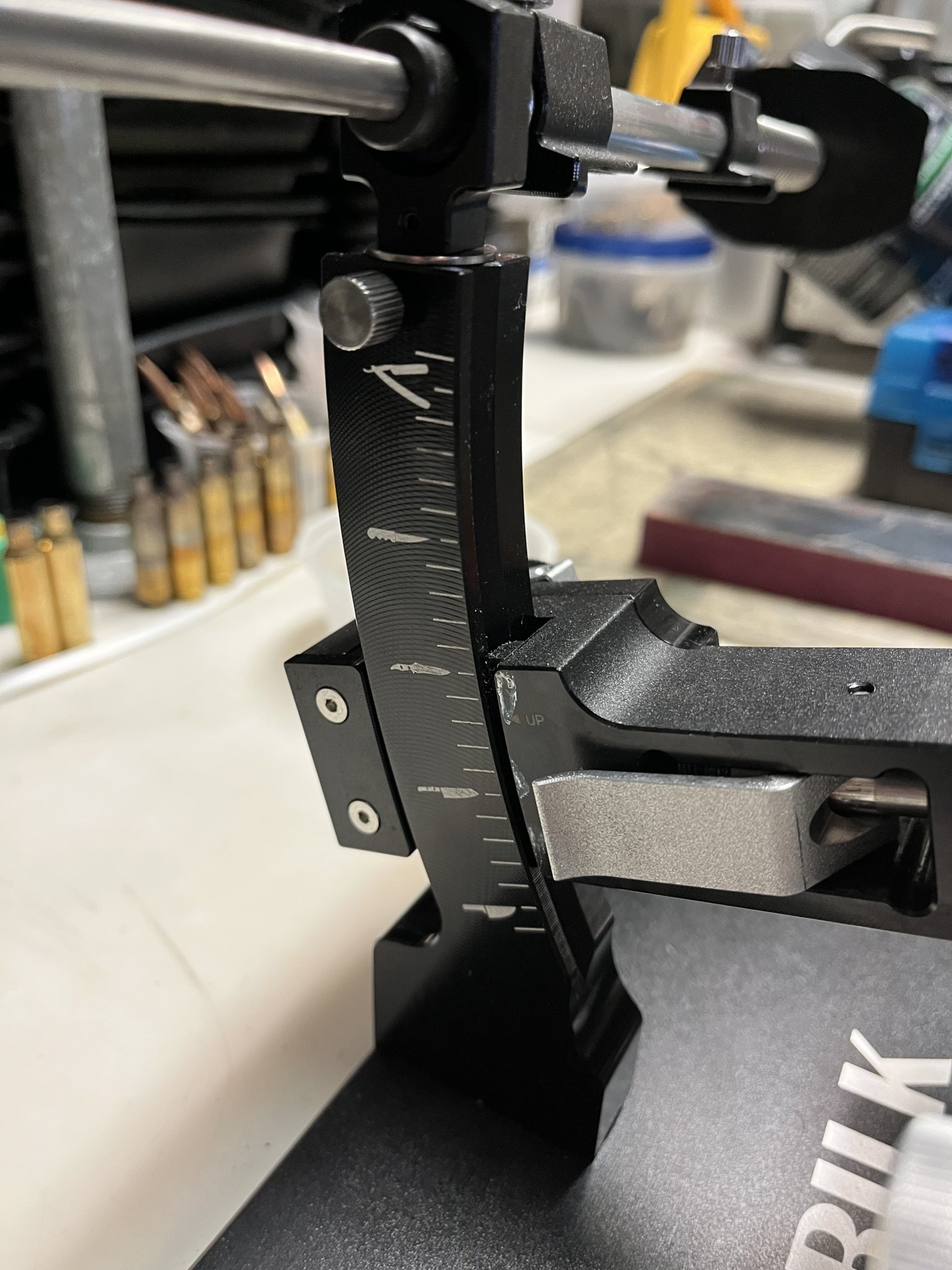

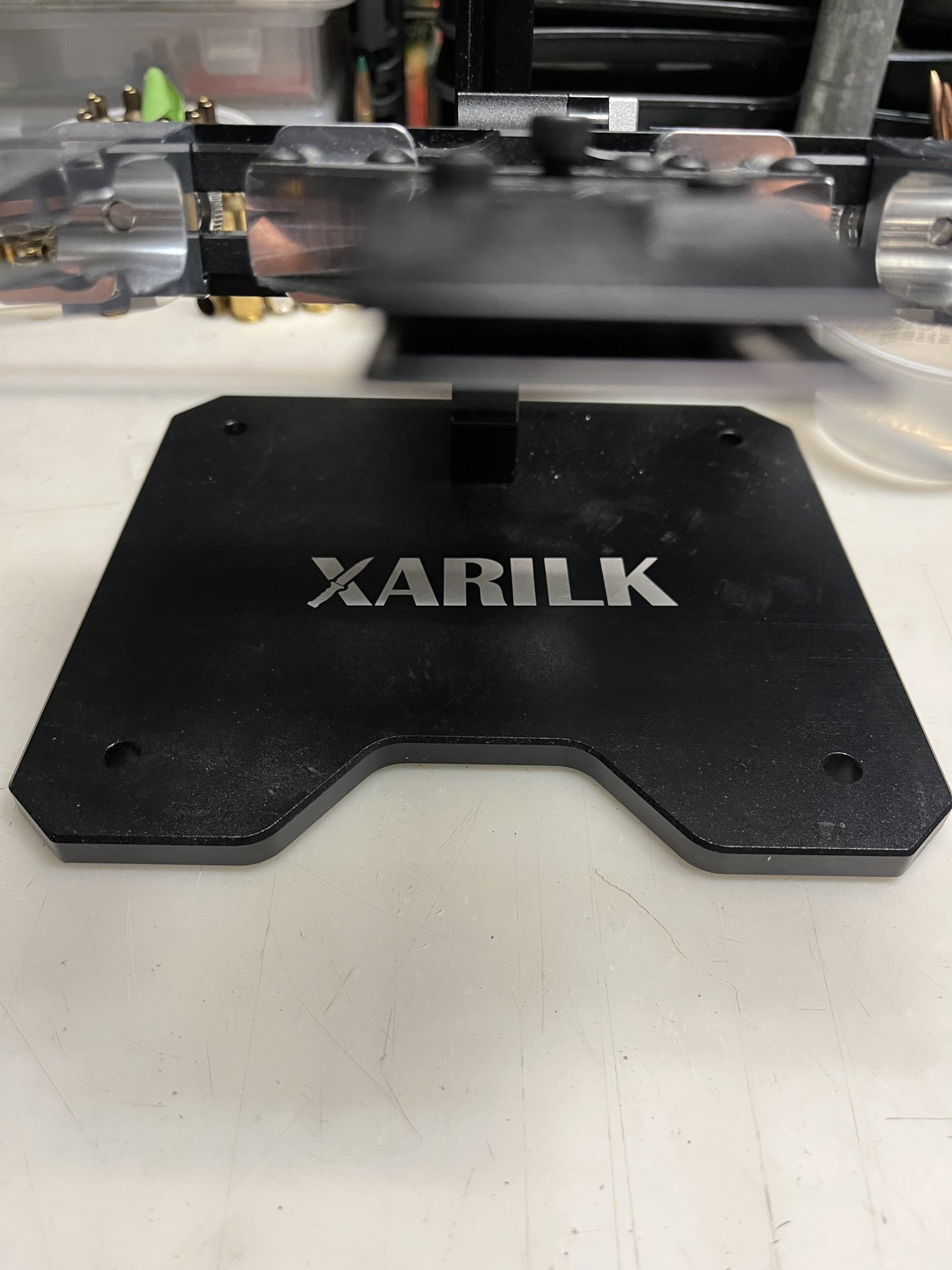

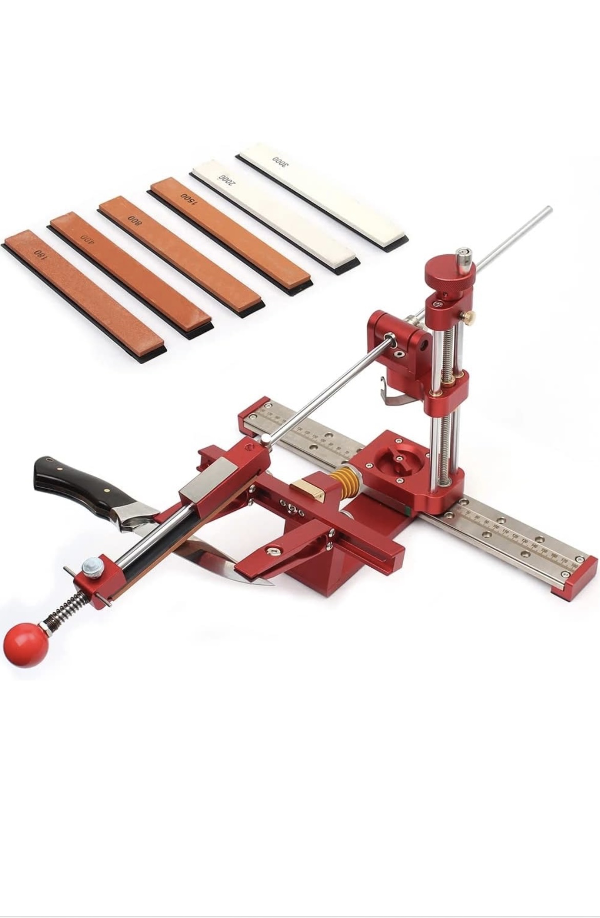

This isn't on the market yet as Wicked Edge is going to do a kickstarter for it I guess, but It looks like a pretty interesting design from just a field guided sharpener, though more bulky than some field options. Evidently available in different angle options and materials from light polymer to fully machined aluminum. That said I think I read an estimated price of ~$150 (not sure which version that was for), which is pretty cheap compared to some of WE's sharpeners that can hit $1500+ these days but still not cheap.
