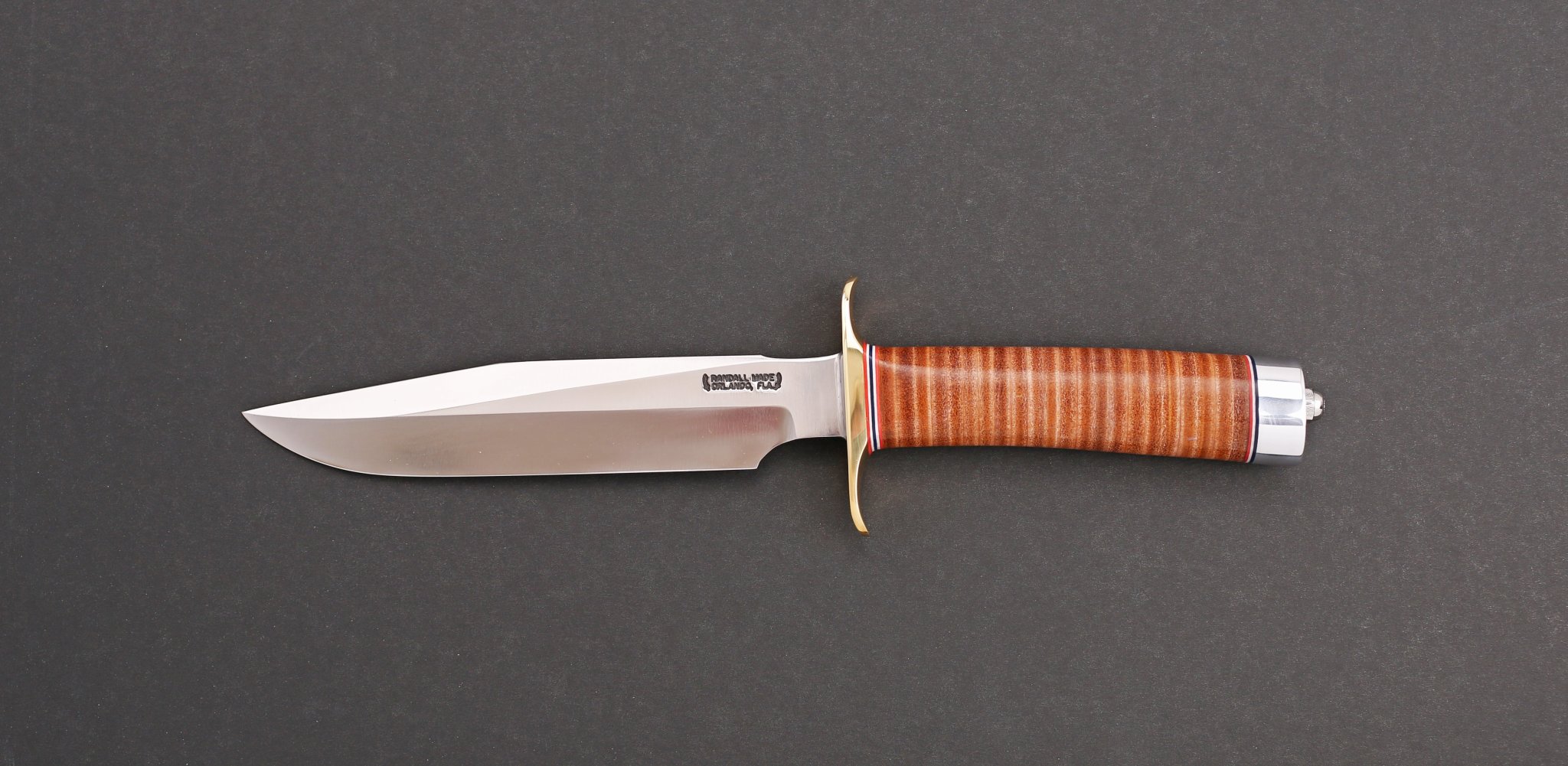

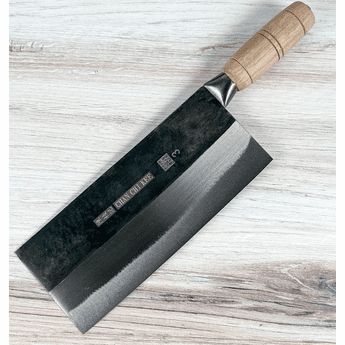

Re: my carbon blades - for a time I had a Randall knife, and I still have a CCK thin Chinese cleaver, model 1303, I believe.
Just couldn’t bear to use the Randall (so pretty lol) and even then it caught an extremely faint blob/cloud of corrosion in one area. Since I try to actually use what I buy, I recognized my folly and sold it. Man that knife was something, though!
The CCK cleaver was $50 at the time and is all about the geometry. Fun to use, a laser! Except I misplaced it in a move. I know it’s in a box around here 🙄
