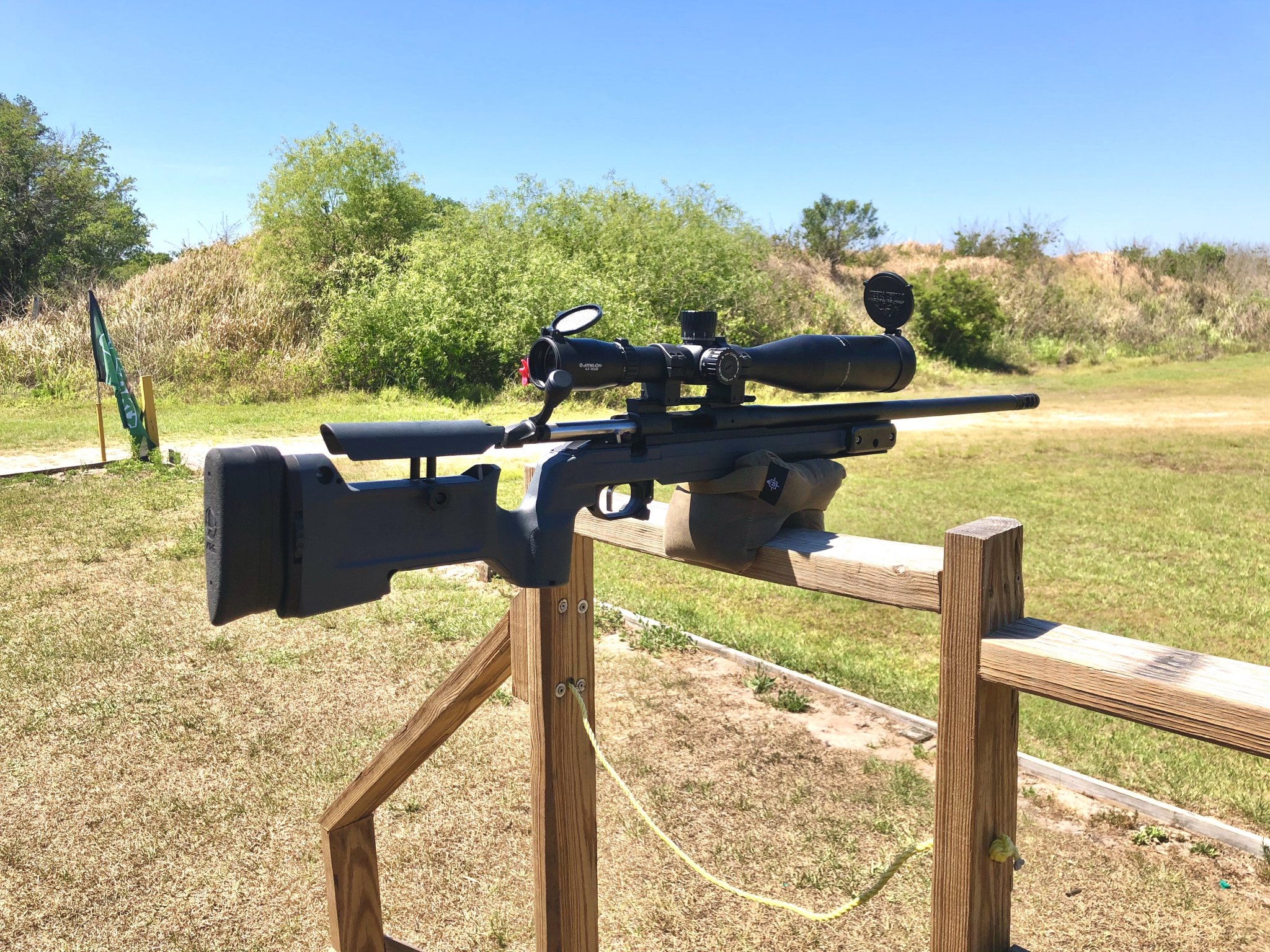

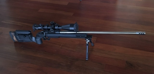

I've got a 22" barreled action pulled from a 6.5CM Bergara B14 HMR, placed in a Bravo with the added KRG fore-end weight, the Arcar Rail, and 2 MDT weights in the MLOK slots up front. I've also added some weight inside the butt stock and it balances right where I want (directly in front of the magwell). I wanna say the B14 barrel is a #5 contour (double check me on that) so not very heavy. Hope this helps a little.
When I re-barrel this thing I'm def going at least M24 and adding more weight to the rear.

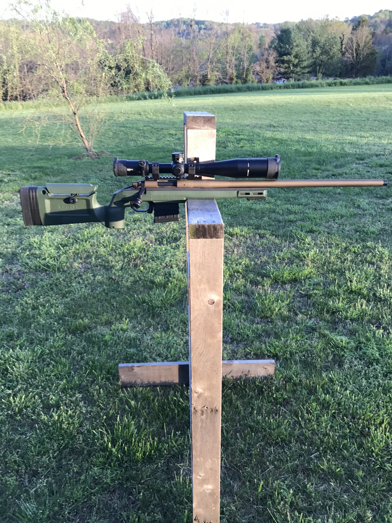

Remington 700 trued with area 419 bolt knob
Krg bravo , hawk hill heavy Palma 7 twist
223 match chamber finished at 26" threaded 5/8x24
.250 precision ground recoil lug.
Vortex pst g2 5-25-x50 weighing in at 17.5 pounds.
Balance point seems to be 1 to 2 inches forward of recoil lug.
When I re-barrel this thing I'm def going at least M24 and adding more weight to the rear.View attachment 7307757

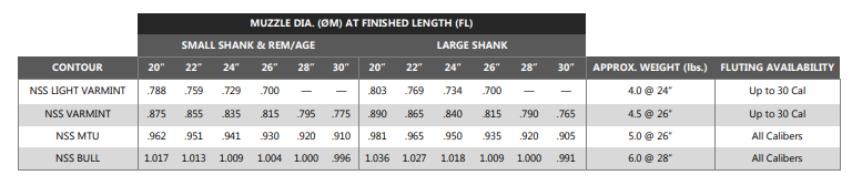

We do recommend a max of a Rem Varmint contour (or T3 varmint/CTR, they are similar). Comp guns are a different story if you are going for weight of course, but then you need weight in the rear for balance.

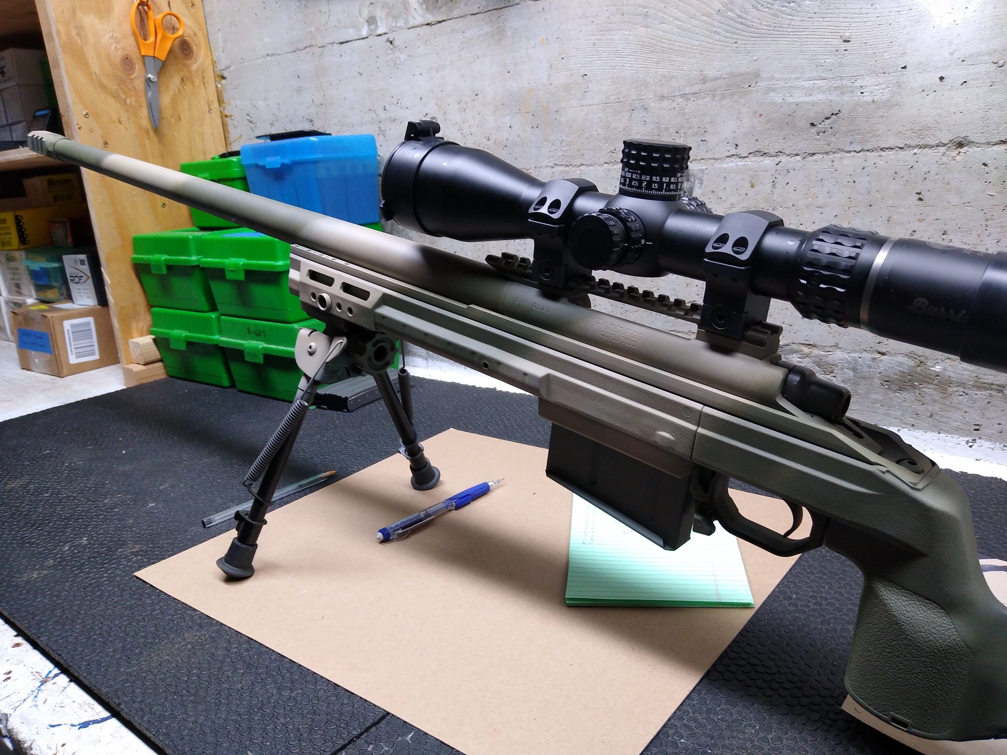

I am running a 26”medium palma(JHR) and considered the balance near perfect for me. However with the addition of accessories up front I fashioned my own length of pull spacer out of walnut and slugged it with weight to maintain the balance point.

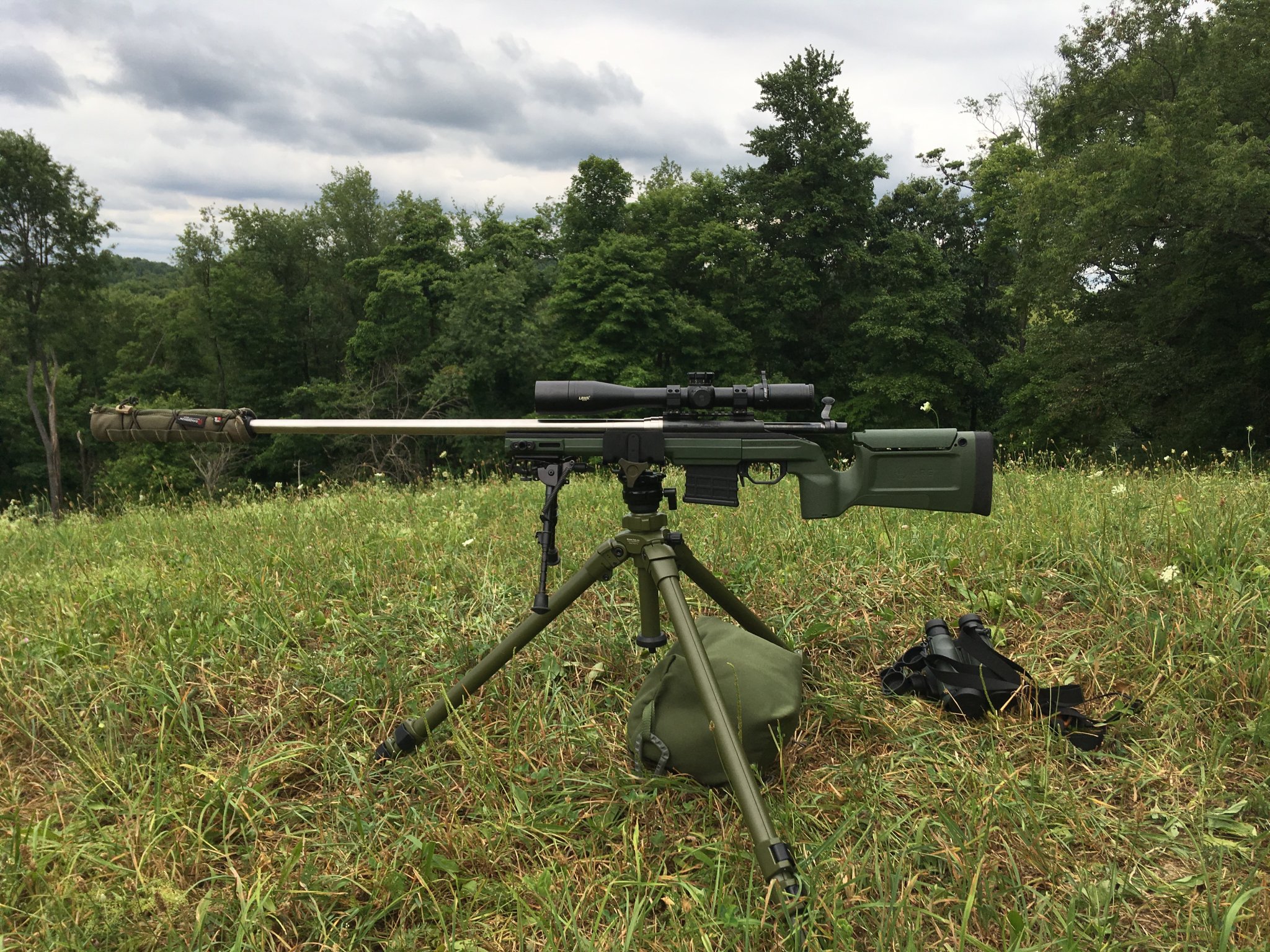

28” from the lug m24 contour 6mm barrel. I felt it was front heavy so I filled the butt stock with lead shot. It works as nice as putting grains of sand in the hilt of a high end chefs knife. You can add ounces at a time instead of pounds, doesn’t add any length and almost as good as mercury because it’s not one solid piece so it takes more of the recoil out of it
