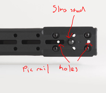

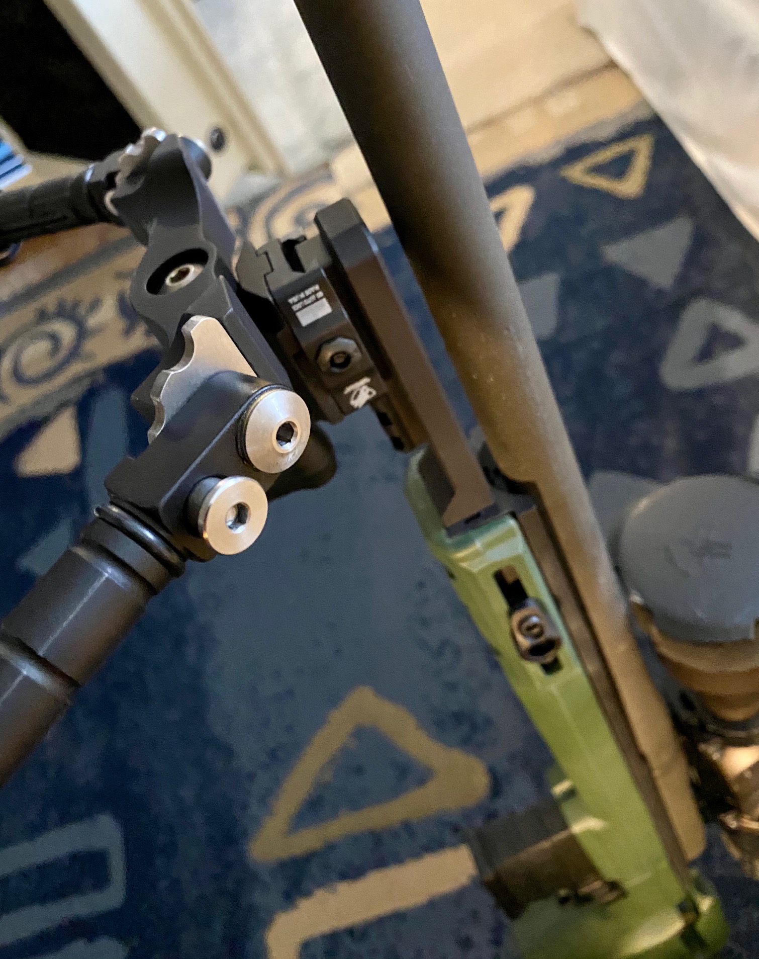

Looking to get a krg bravo.. I still dont understand how I can mount a bipod to it. Cant find any pictures of the rail. Anybody have the setup and have pictures or advice?
What mounting system do you have on your bipod? Sling stud (Harris), picatinny, ARCA/RRS?

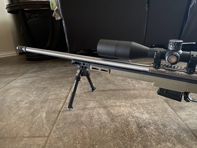

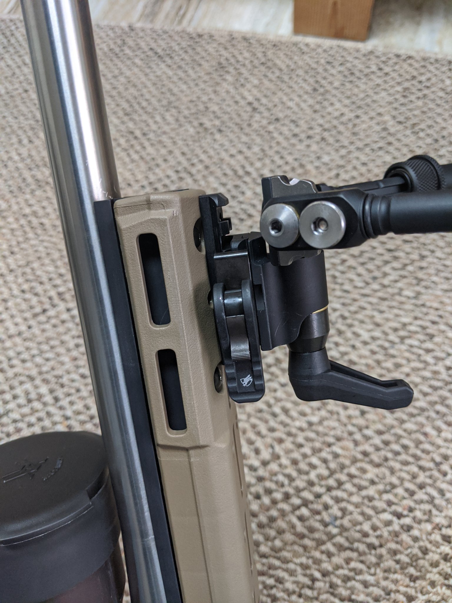

I put an ARCA/RRS plate and spigot on the wife's bravo. Her bipod is mounted using the RRS slots machined into the spigot.

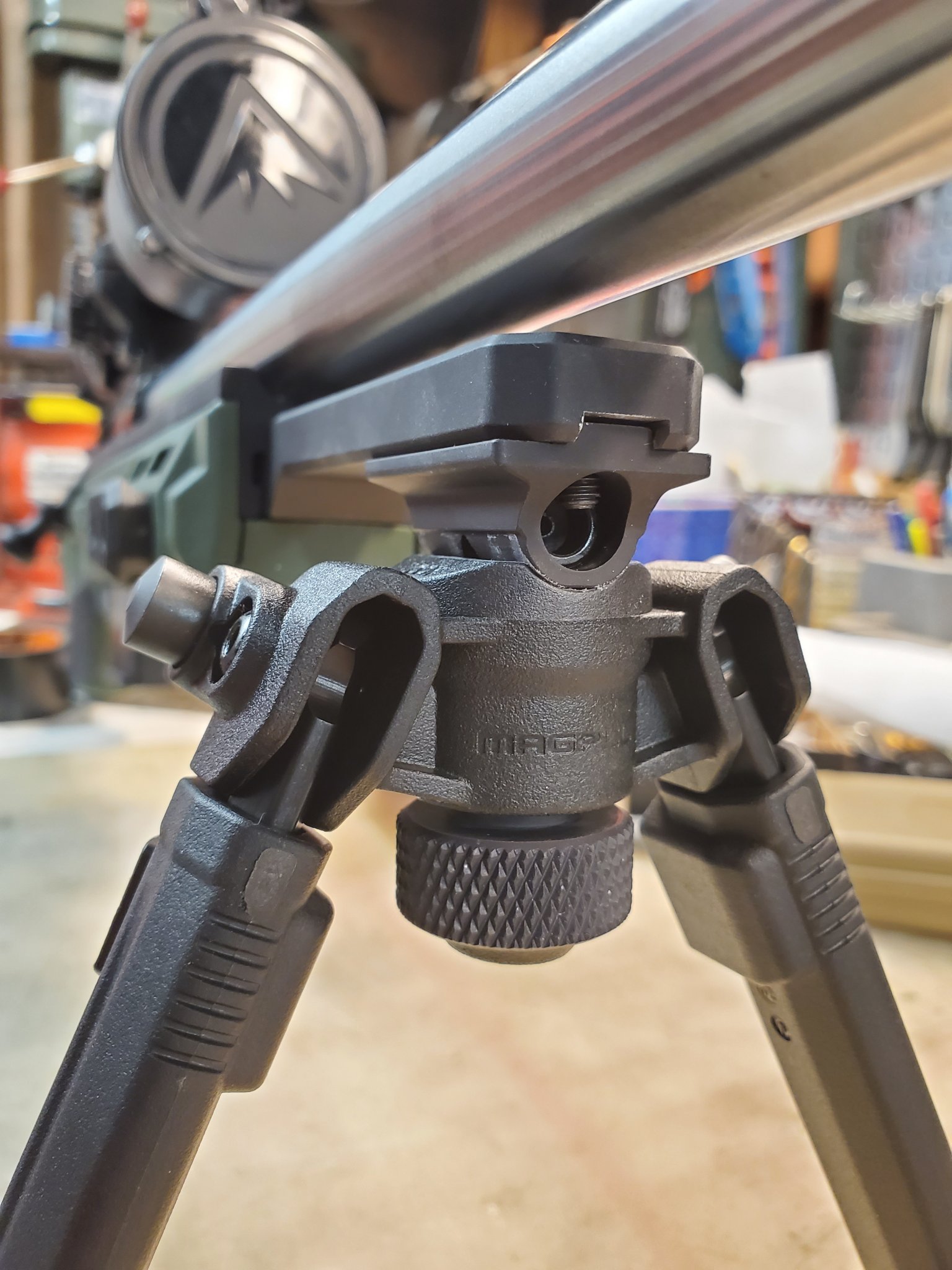

Atlas Cal2, KRG pic rail

The spigot is better option. It bolts to aluminum backbone, very rigid. Rail or stud on polymer forend will flex, unless they have changed it. The one I was around just bolted to plastic, not what I'd prefer.

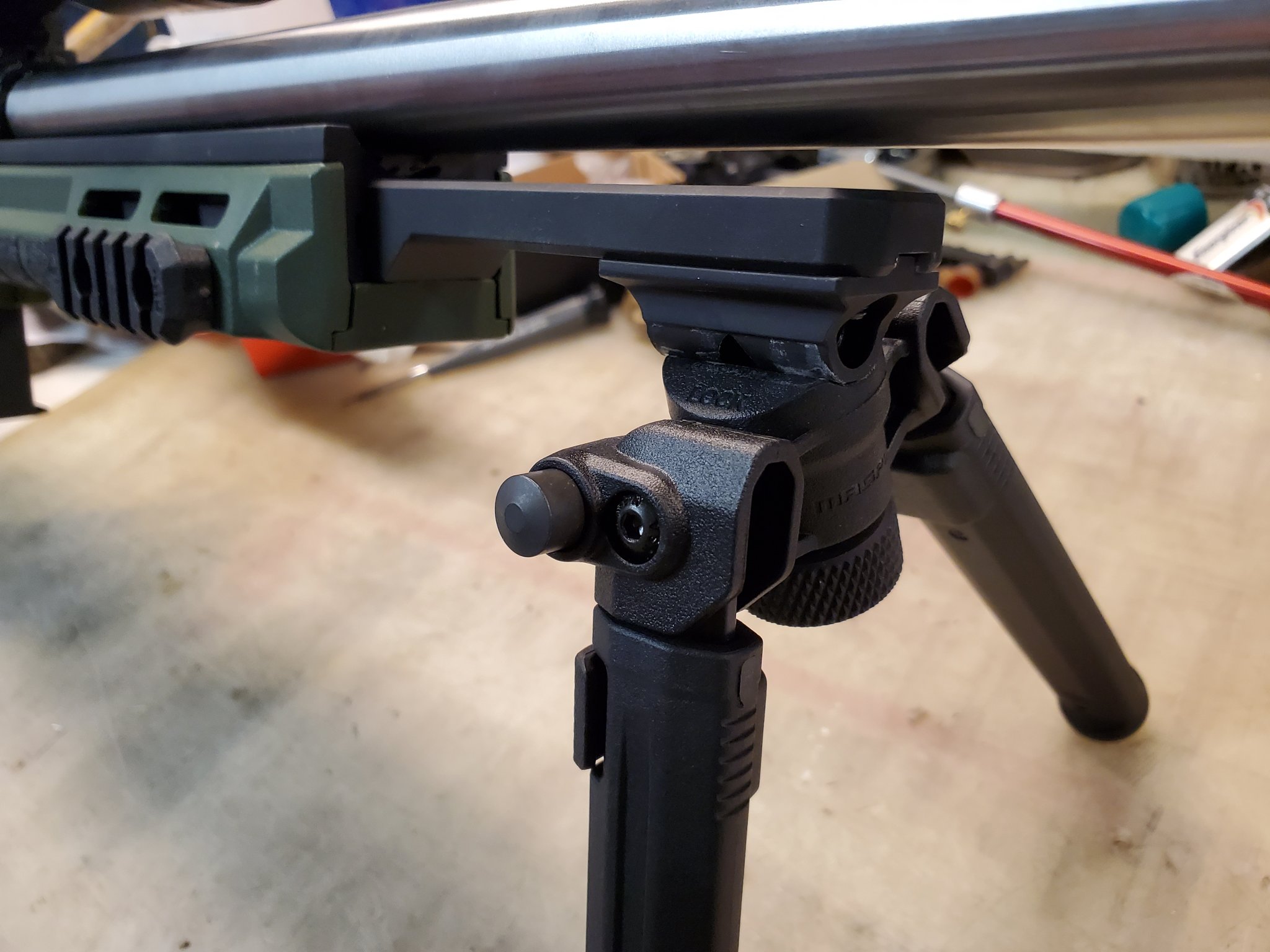

I did a spigot just to move the balance point. I had zero issues using the stud for a Harris.

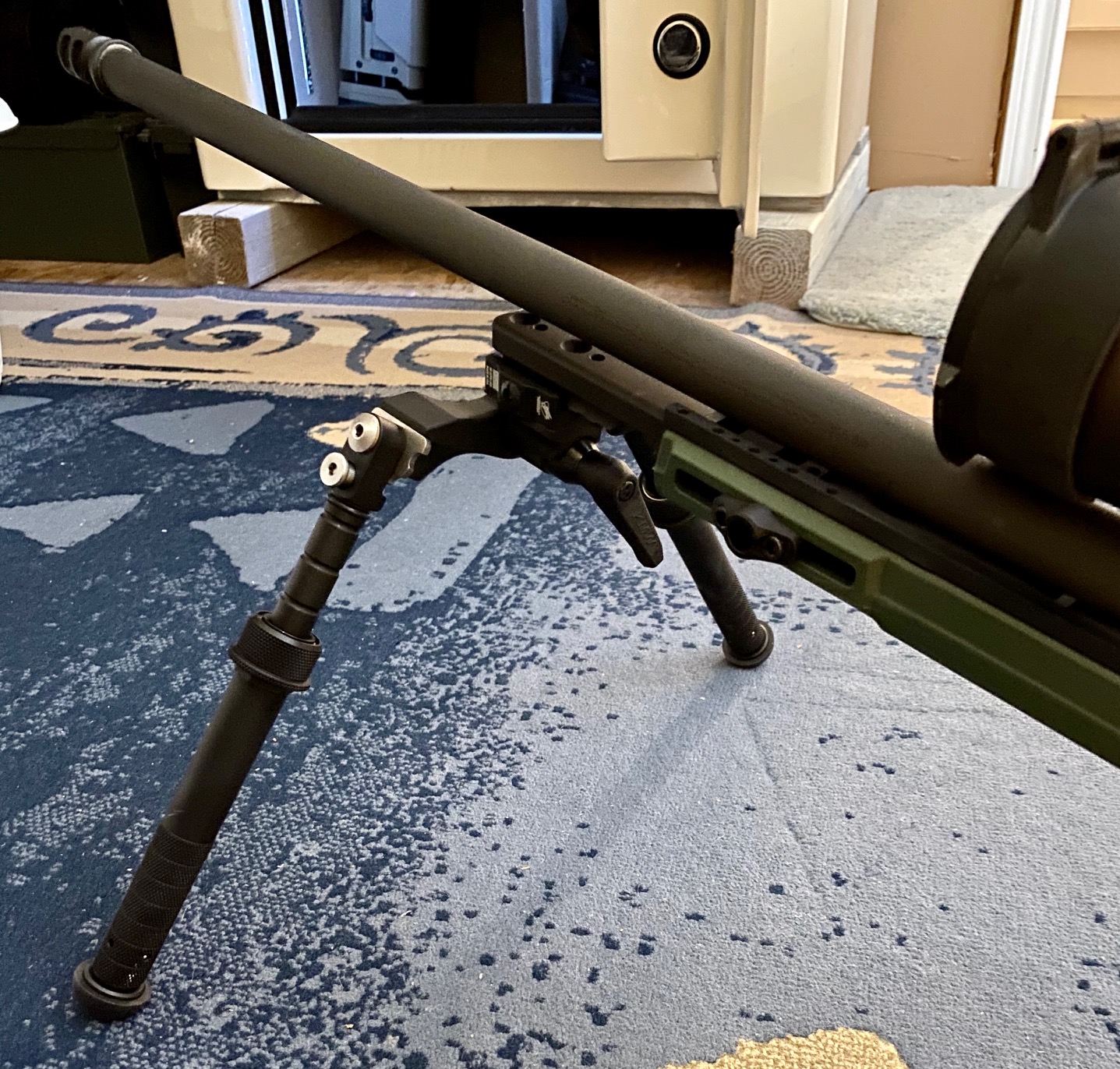

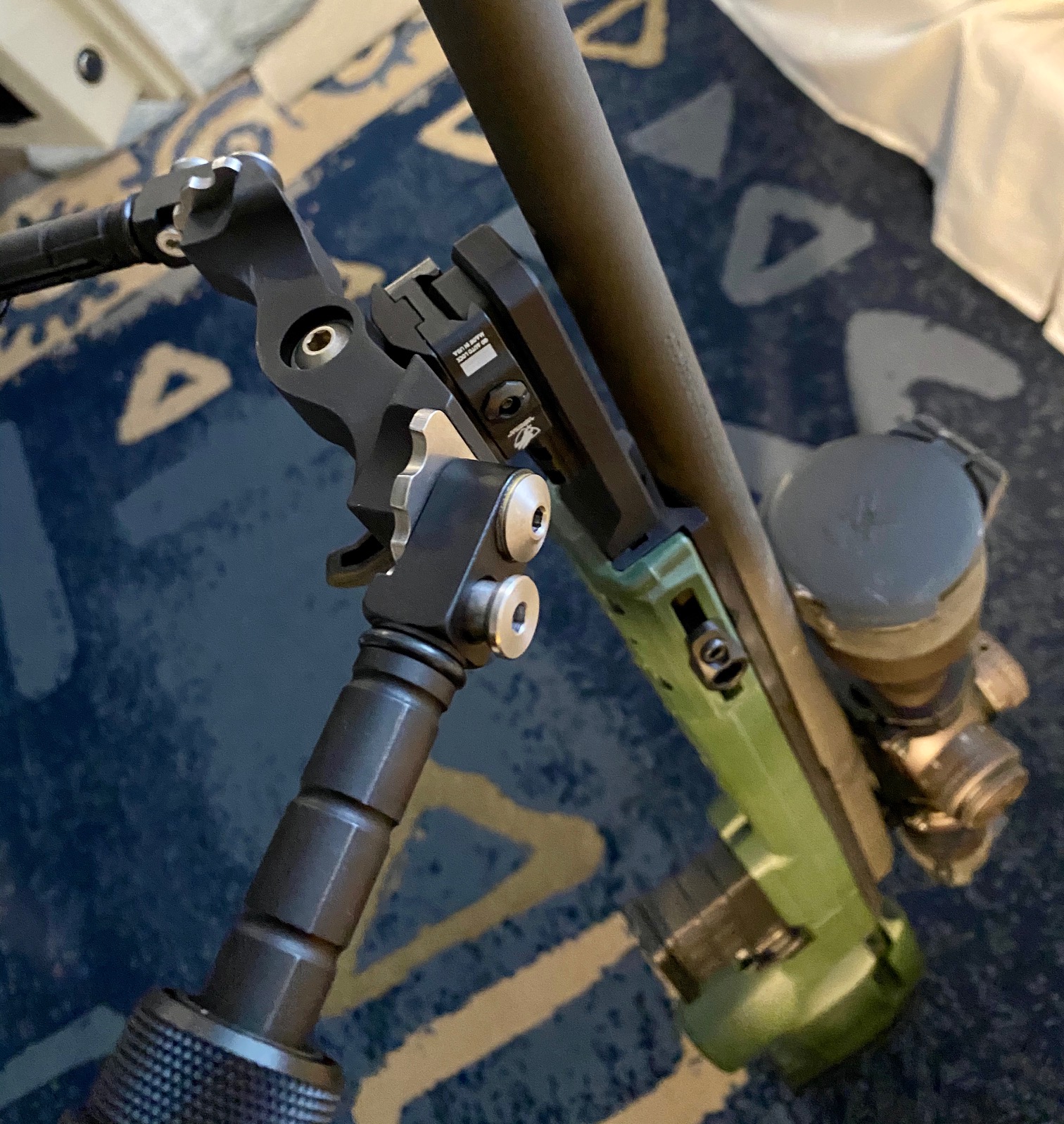

spigot and mounted direct A.R.M.S. 17S Style. Not necessary but I milled a slot in the spigot for for a better fit and to push the apex as close to the barrel as I could.
The bipod felt too high when mounted to the pic rail below the hand guard.

My two setups, bipod or benchrest plate.
I've been considering an Arca rail that would ride on a benchrest bag or shooting bag ok and accept a bipod, though I like the extended length (pivot) of the Spigot mount.
