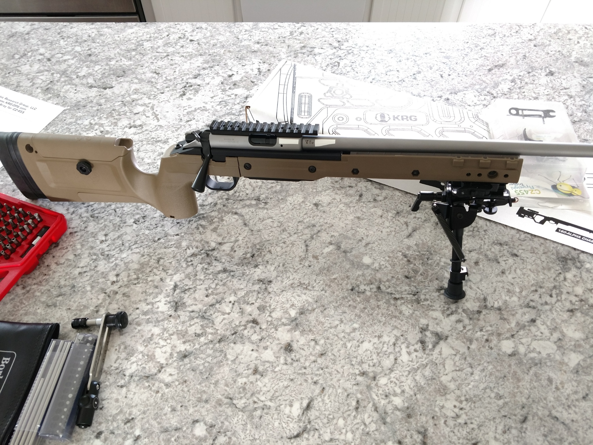

Well I couldn't stand it, I ordered one...
I looked the web over for someone posting about one, but I really found nothing much about it... So either my search skills suck, or nobody is using them yet, or just nobody is posting about it yet?..
Had a new 455 and a few parts sitting in the box for several months now trying to catch an FDE manners being sold...
Guess it's going to be an FDE Bravo now!
I'll post what I see when it gets here, and I try putting it all together

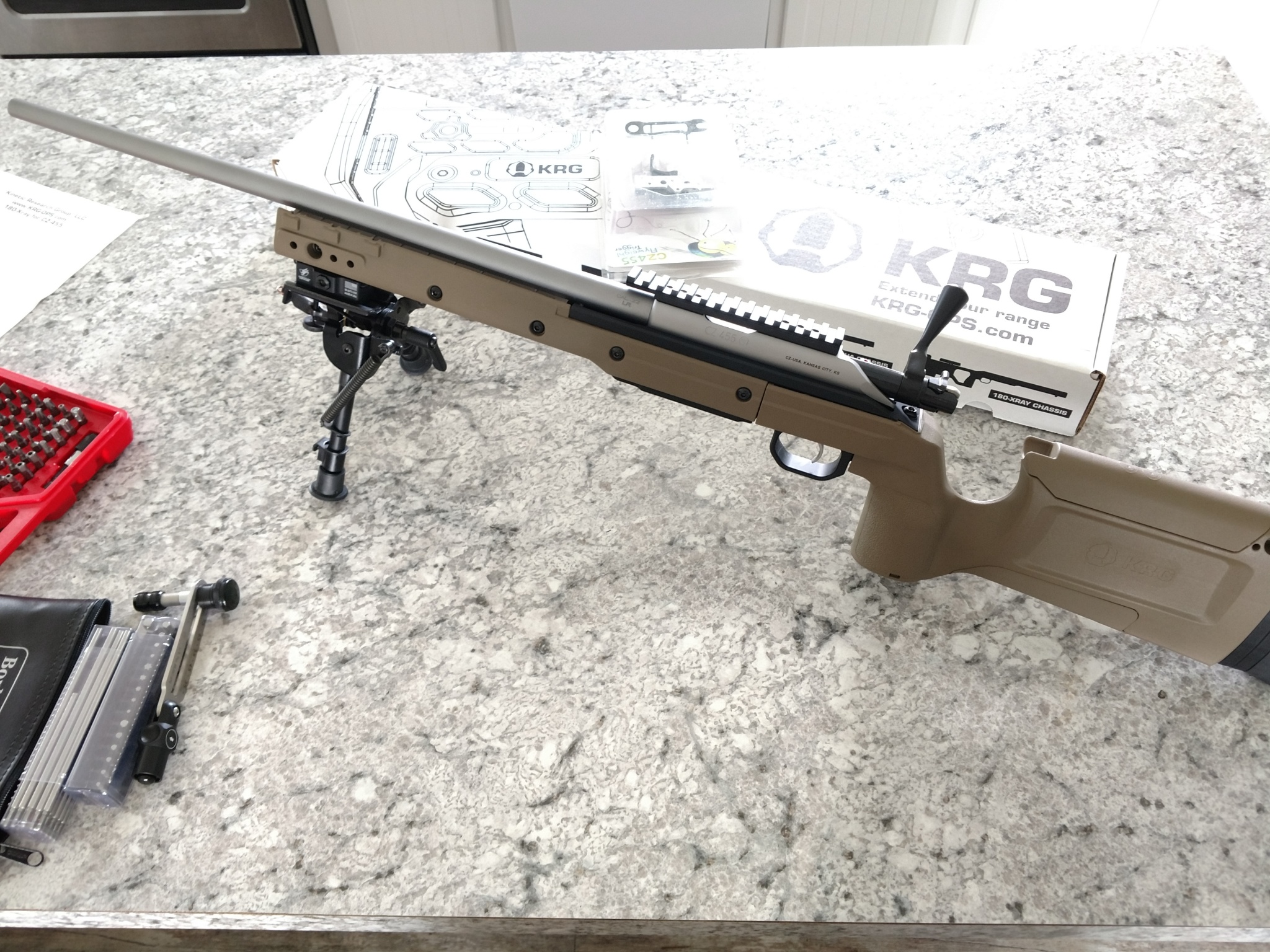

Initial impressions are GOOD!
I'll update when I have time to get the FLY trigger unit into the rifle. Looks like there is a mile of room in the trigger area, so I'm not expecting any problems.... Fingers crossed
Reactions: Stickshift

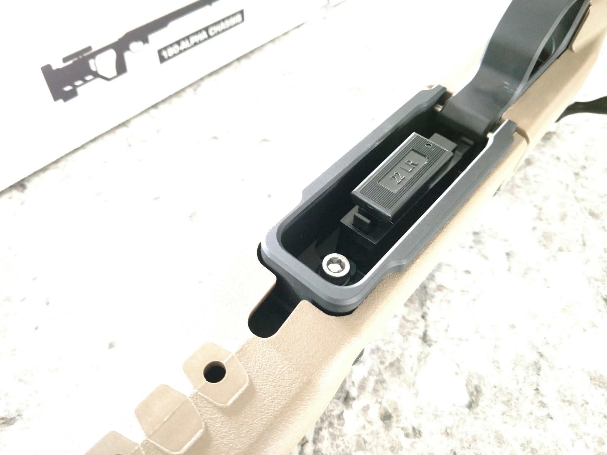

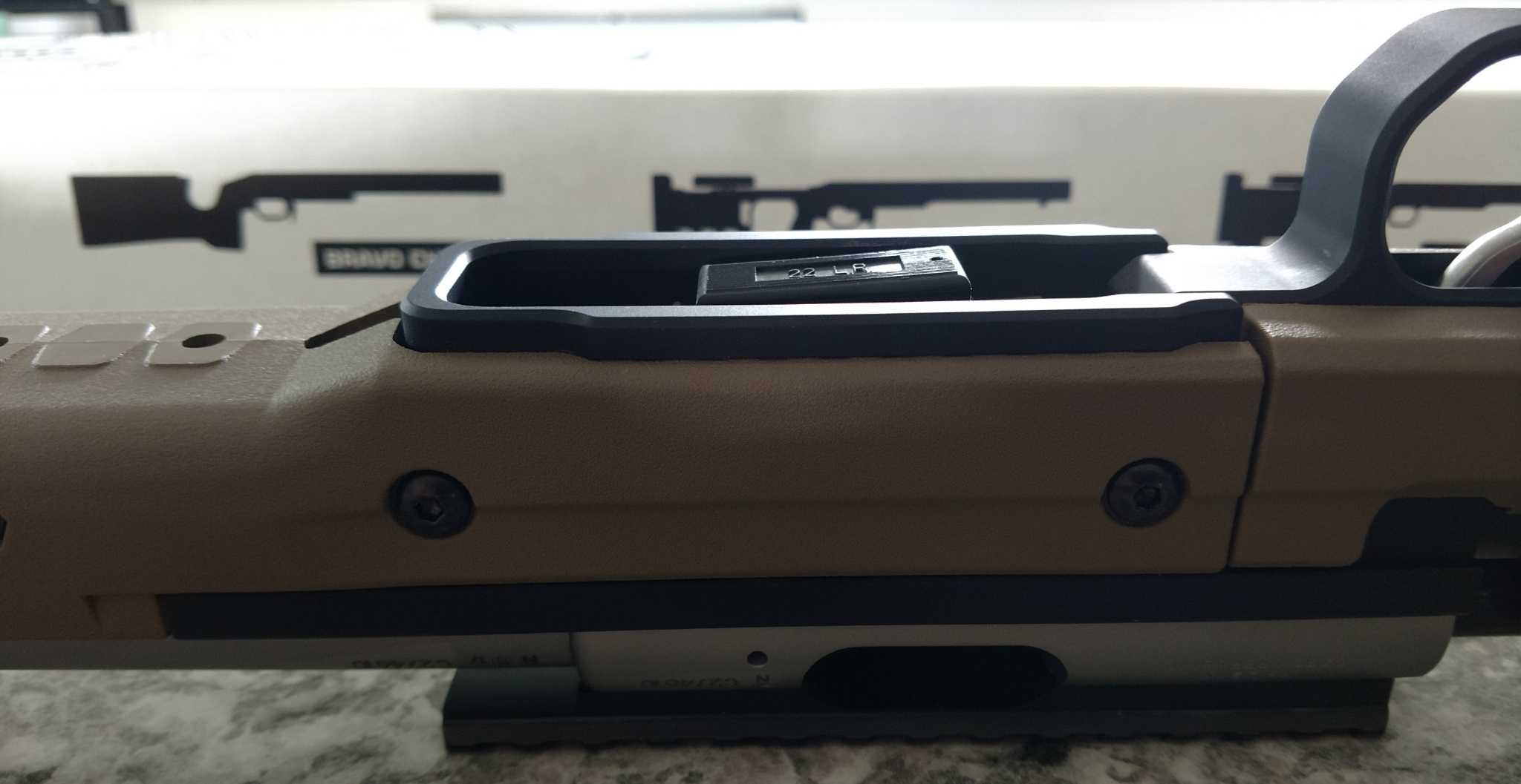

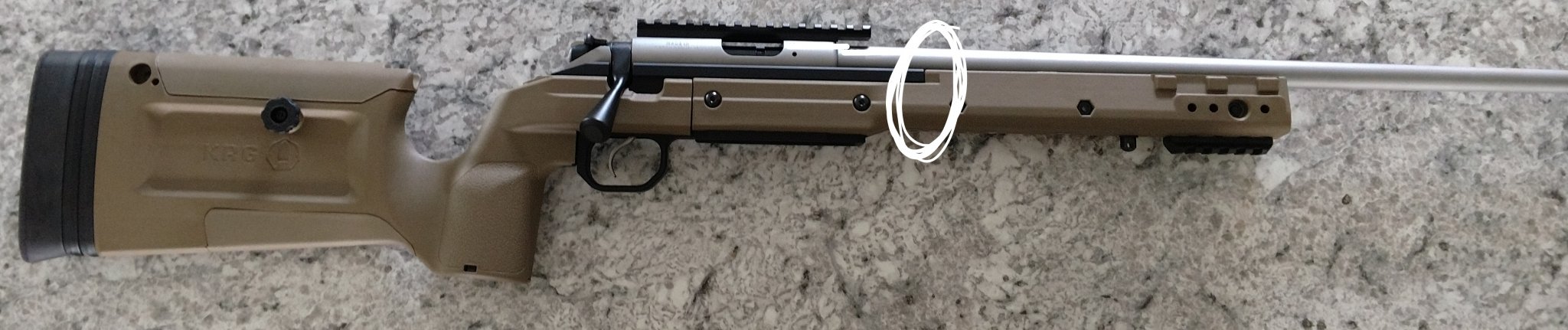

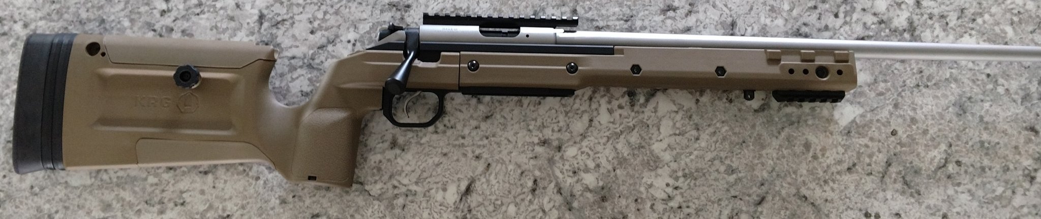

Well i haven't shot it, but I'll try to explain everything i see messing around house with it.
Aluminum ends where you see circled in the picture
BUT the way they did the forend is a solid box frame design. I'm a 220lb 20yr maintenance worker and I can't twist the forend just using hands on front and rear in any way.
Now if I use leverage... Grab barrel and apply force directly to the side of the forend I can get it to move enough that I can see it. Only way I can see this making a difference while behind the rifle is if you were to deeply wedge bipod into something and apply a ridiculous amount of pressure to basically torque the forend into a banana... Why anyone would do such a thing I have not a clue...
I took it out on the deck and got behind it as if shooting from barricaded positions. applied pressure to a single bipod leg and I can't see enough flex to amount to anything with any form of pressure I would apply while shooting normally.... Maybe if I was going to put this on a "go to hell" rifle I would rethink polymer anything, but I can't see where anything with this chassisis going to limit you in most cases.
@bunsen27 thanks for the link, might have to consider it. There is a good deal of room in the front of the mag area that is recessed, thanks to that my finger seems to get at the release fairly well. I'll have to see how awkward it is when I actually get to shooting it though.
Biggest problem is getting my hand on the mag itself while pushing the release... With how close the sides are to the mag I'm 100% going to need to buy 10rd mags in order to be able to use my thumb and middle finger on sides to pull mag out, while using pointer finger on release. The way it is now with 5rd mags I'm basically using my pointer and thumb on front and back while trying to push release with pointer as well...
Especially for guys doing rimfire competing, I believe the 10rd mags are going to be a must have

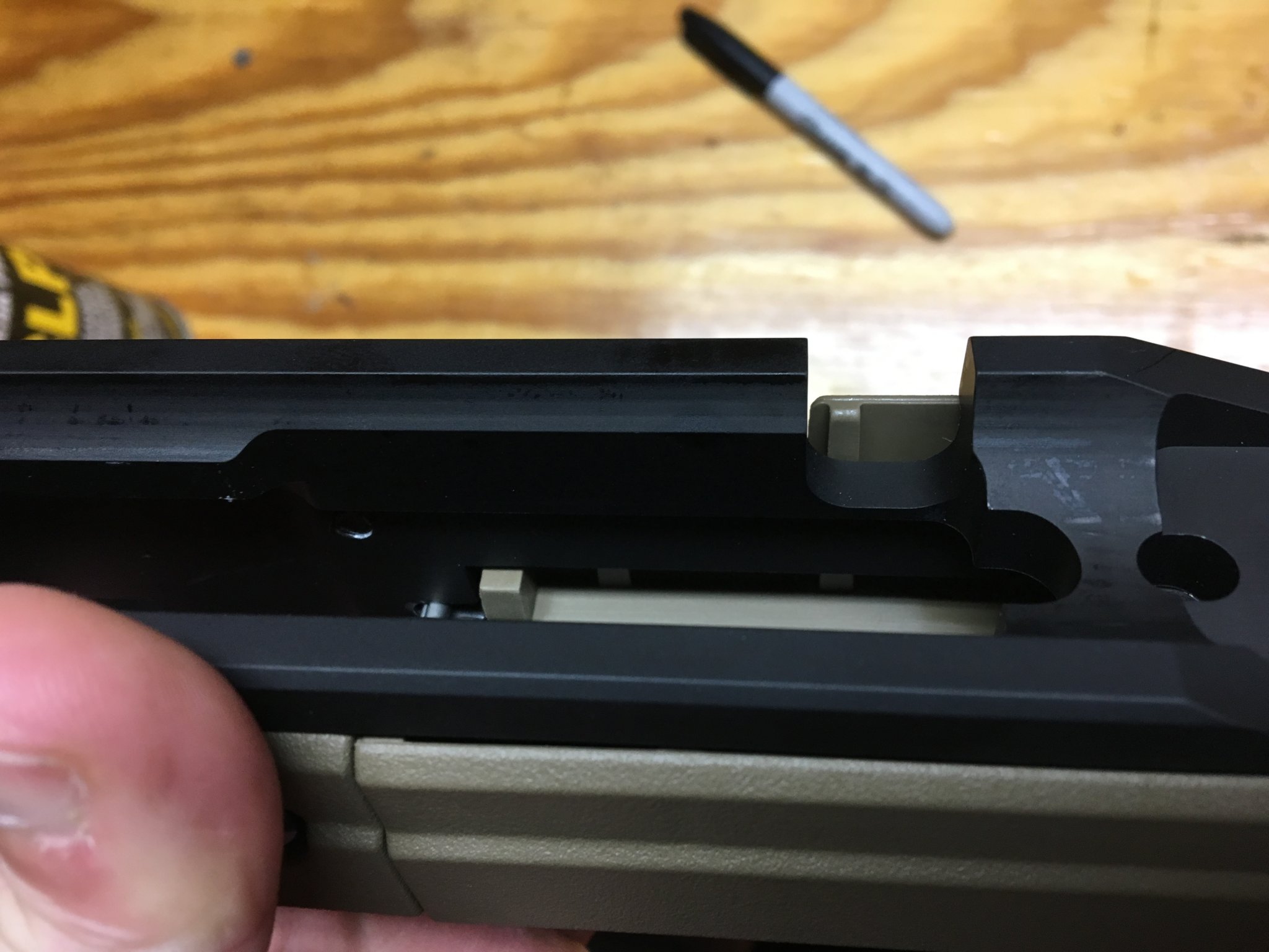

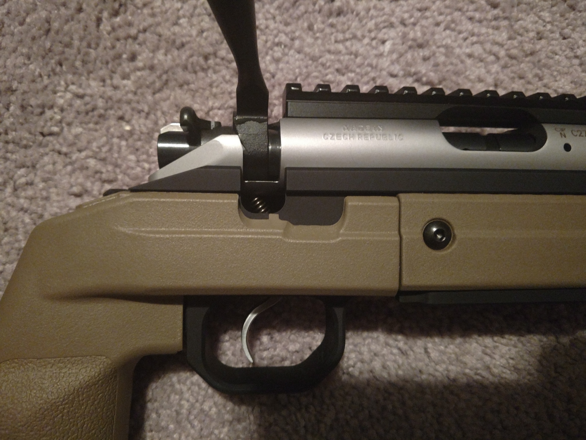

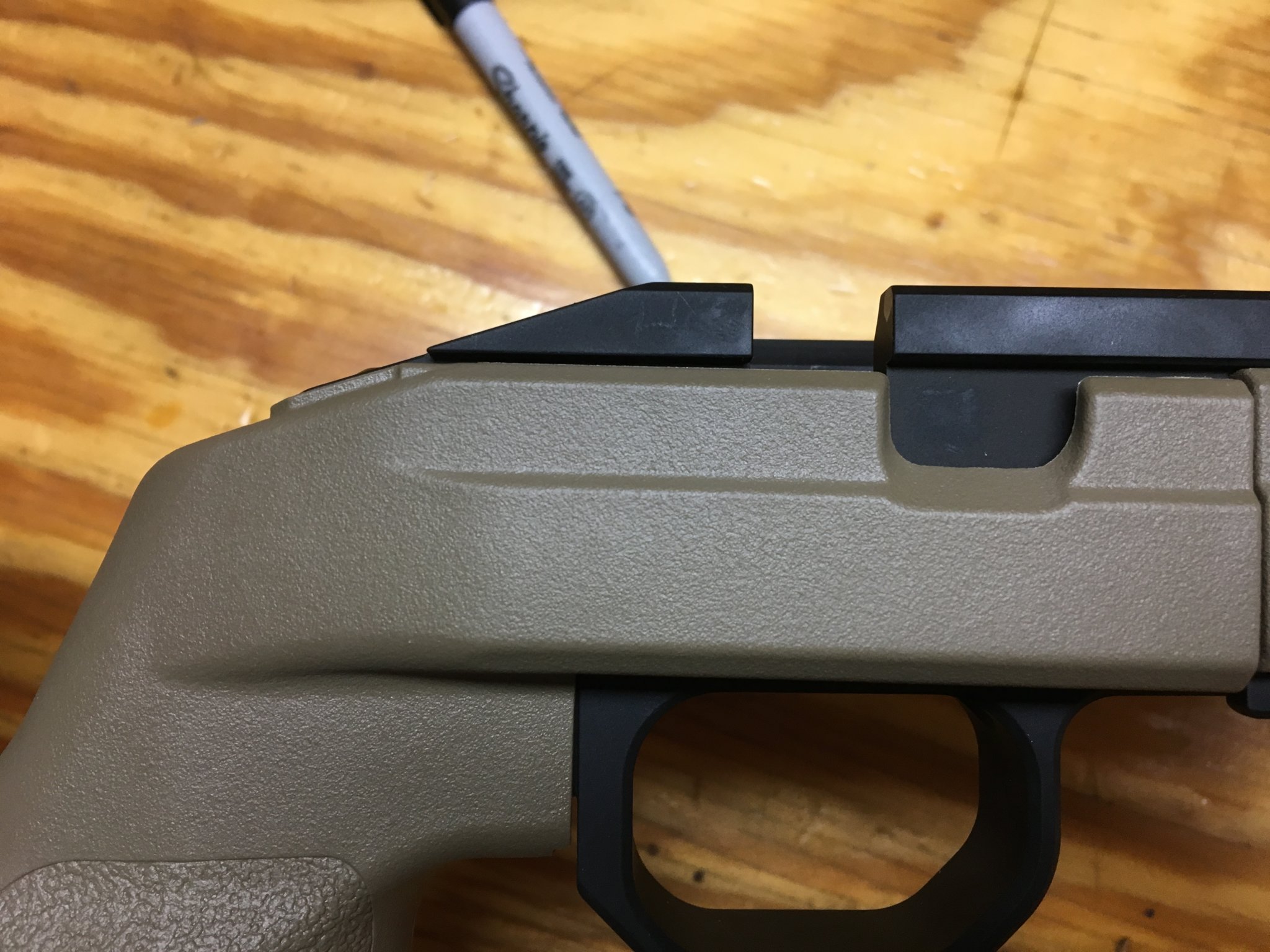

Did you have to sand out the area where the bolt handle rests? I just ordered one of these and my bolt handle won’t close all the way down. Hits on the plastic skin.
So a little update. I emailed KRG on Saturday and they responded instantly. Turns out they sent me the wrong buttstock and had a new one on my doorstep that following Wednesday.
Great customer service couldn’t be happier! Thanks KRG
