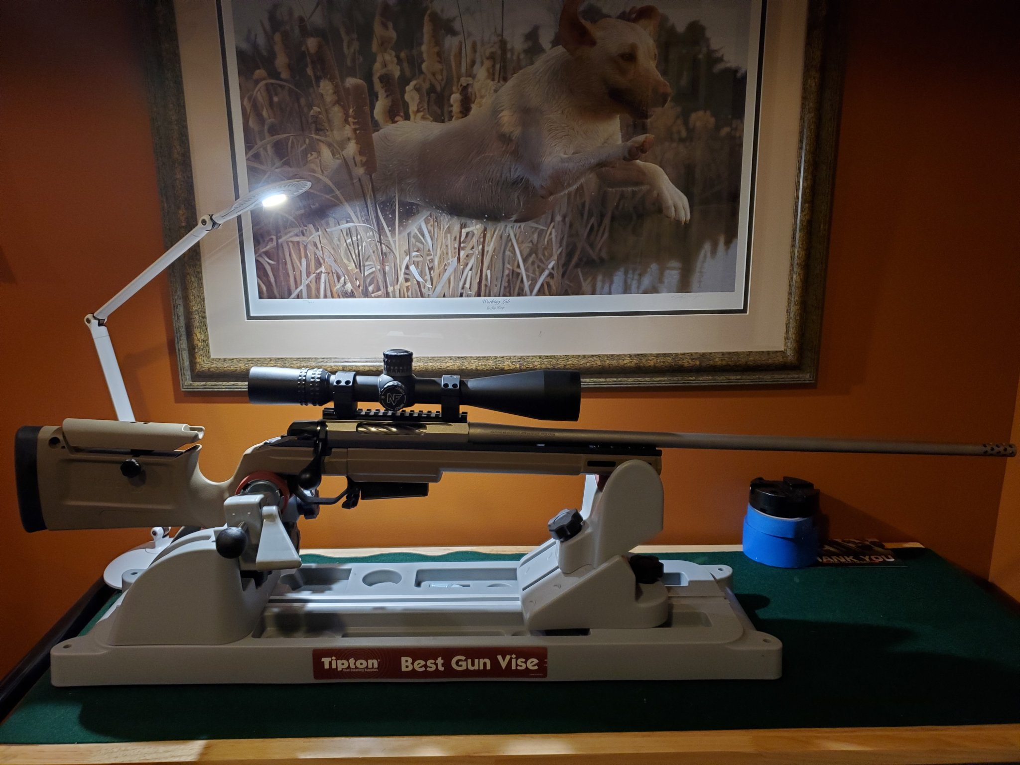

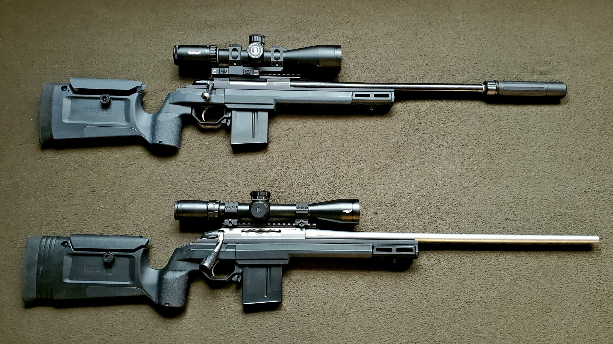

I have multiple manners, McMillan, bravo, whiskey 3, and mpa. I think for the price the bravo is perfect!! It even feels warmer to the hand then the manners and Mcmillan’s, way warmer then the metals on mpa ans whiskey. The customization about it is perfect, the hand position on it is fantastic. I was hesitant and have never been so pleasantly surprise by a stock/chassis then I have with the bravo
I use a bravo for a hunting stock and it’s excellent. The only advice I’d give you is to remove the oversized mag release “wing” as it gets caught on my jacket and wants to unlatch the mag. After doing that I have no complaints, and you can’t beat the price.

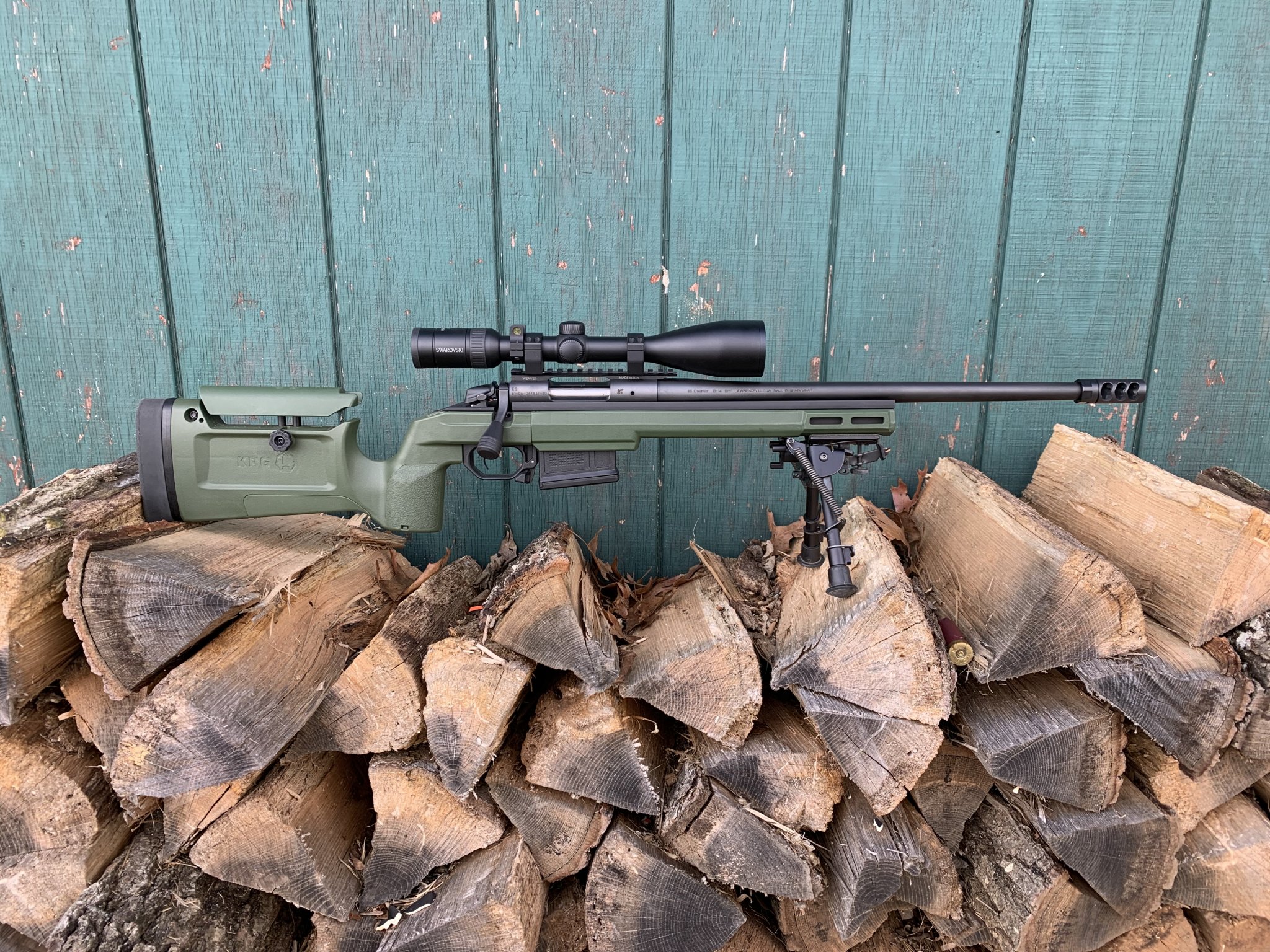

I like it a lot.

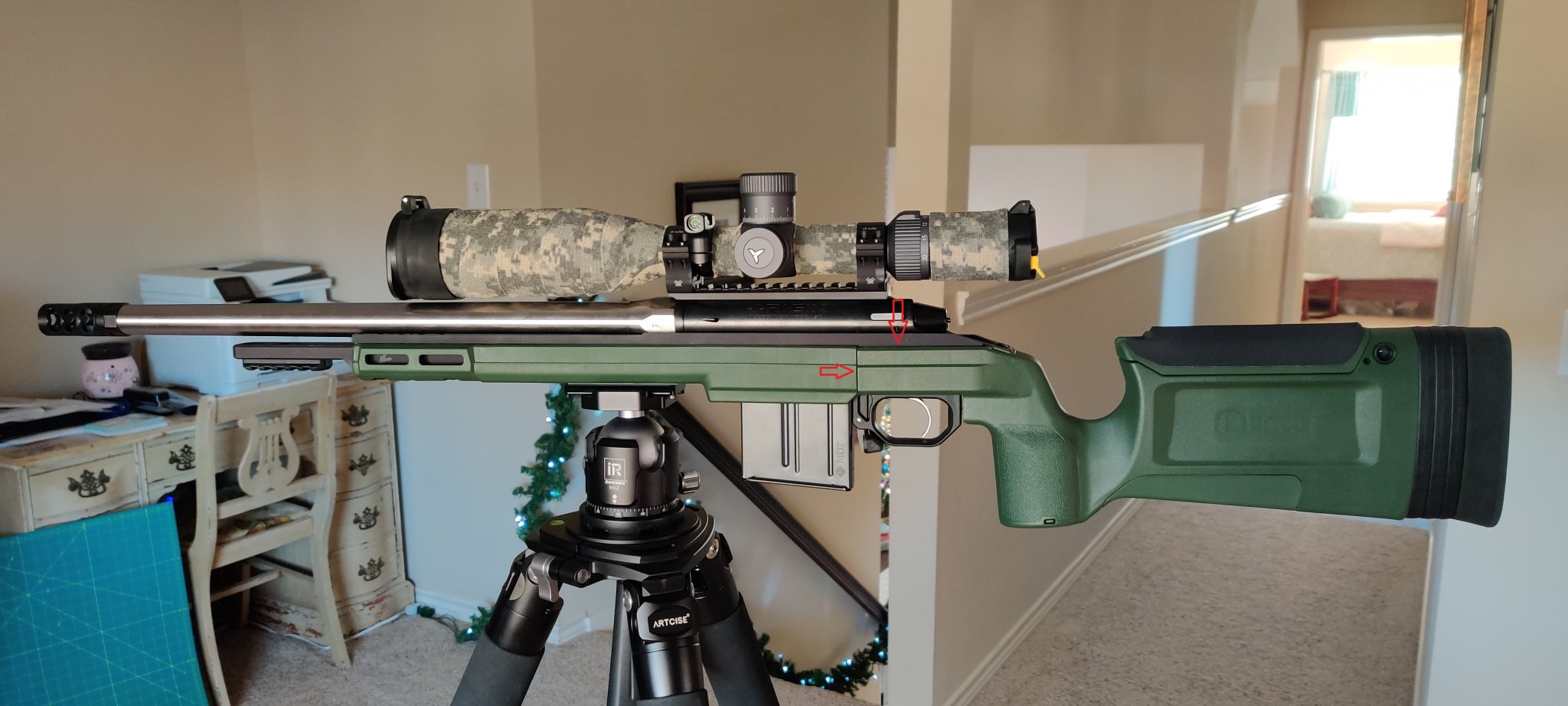

I have a build that looks much like that, except it is a trued 700 with a 20" Schneider SR60 contour 5P .308 barrel.
It is surprisingly light considering how stout the barrel is. I love the LRTSi, wish they made a 5-20 in the same configuration.

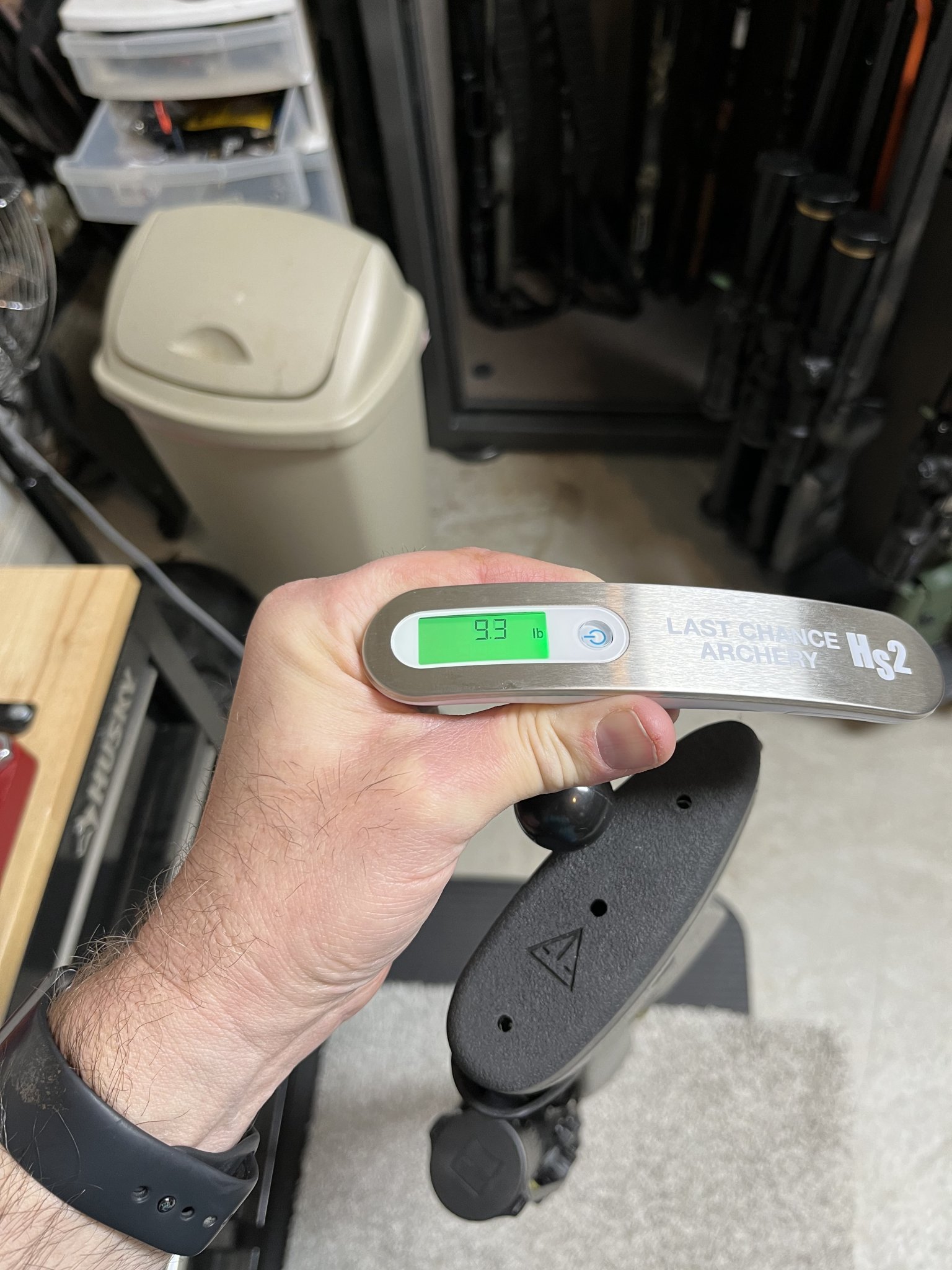

It’s fine. It a “light weight” option but it’s not super heavy either so long as you don’t slap a bunch of shit on it.

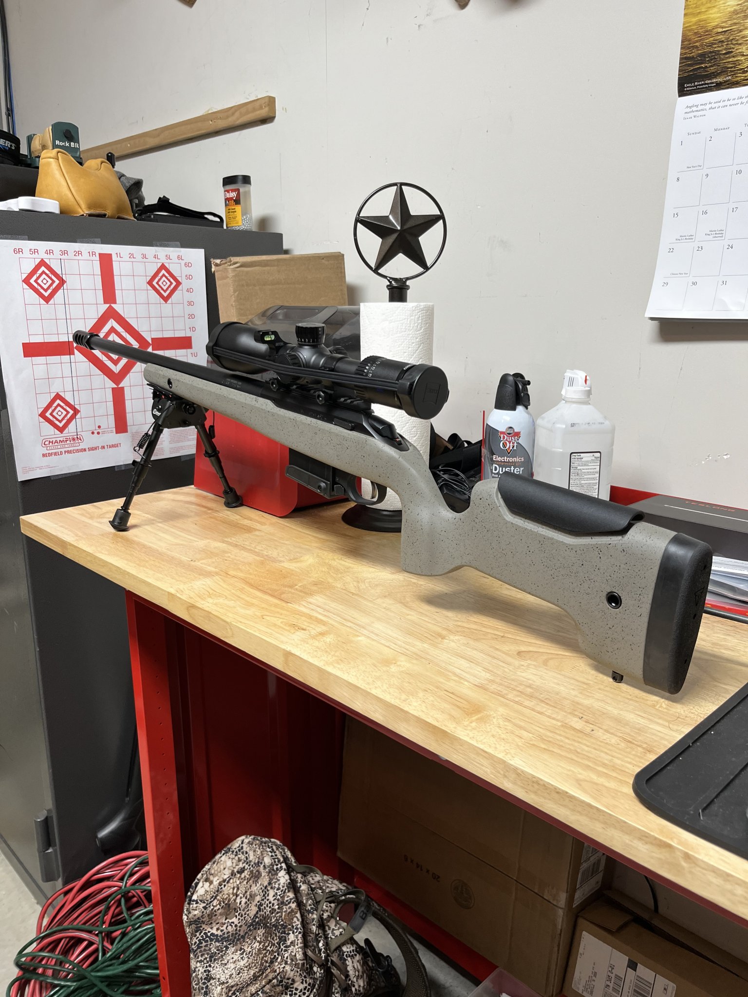

I'm a big fan of the KRG Bravo Chassis. So far I have two for my hunting dogs and likely will be ordering another for a heavy palma 223 Bighorn Origin build

velocity and load? i have a 24" medium palma and thinking of going 20" next.
The barrel is a PVA Rock Creek button prefit and has 231 rounds down it...here's what my Magnetospeed V2 said a few weeks ago on a 50F day:
135gr Berger Classic Hunter factory ammo: 2512fps
140gr ELD-M factory ammo: 2585fps
130gr AR Hybrid factory ammo: 2658fps
130gr AR Hybrid over 39.5gr Varget in Lapua SRP brass: 2645fps
I have not verified these velocities at distance on targets. It hammers with factory 135CH though they are slow across the V2, shoots Hornady 140 and 147gr ELD-M factory ammo "good enough" but not as good as Bergers (seems to prefer the 147 a hair). I haven't put a ton of the 130gr AR Hybrid through it yet but they definitely show promise in both factory and reloaded form...using Varget because I've got 24lb+ of it on the shelf, could likely get more velocity with H4350 or IMR4451. I can live with 2650ish from a 130 for my purposes...

I installed a KRG Bravo on my sons Rem 700 .308 Magpul Edition and an MDT XRS on my .270 WSM Rem 700. I think both chassis systems work great for hunting but I personally think that the XRS is the better of the two. Regardless of which one you pick, a chassis opens up a world of stability when you're out in the field that is really hard to get with a regular stock.
Reactions: spife7980

Krg bravo is a lot for a little
You could lose a pound running an eh1 or something Of that Ilk. But if ur packing quarters, head, straps and loins put, fretting over 1lb seems silly.
that said I still prefer the bravo ergo’s over any manners I’ve ever run. That it’s sub 3pounds and 350$ is unreal deal.
also, you could likely shave about half that off with a mill and some careful machining of the aluminum backbone if you really wanted to get anal about weight.
I personally don’t mind the extra weight because I prefer the stability of a slightly heavier rifle.
With the factory sporter barrel the balance is already behind the front action screw with the atlas.
Could probably get it about just right if I ran the spigot mount and pushed the bipod further forward.
It’s never going to be a great feeling walk all day in hand sort of rifle. A big ass aics mag hanging out the belly seals that. But running a Leupold 6x on a Montana in talleys didn’t seem that vastly different or then the piggy tikka for all day up and down gully’s type hunts.
But I know which one I want to get behind when a monster needs to be shot ASAP at 500 plus yards.

How do the W3 and bravo compare to each other in feel for your firing hand, cheek, shoulder etc?
Perfect thread to show off a bit lol. I’m a huge fan of the Bravo for all applications. But my only current bravo is on my 450 Bushmaster deer rifle. It’s a badass setup for Southern Michigan farm country and I wouldn’t at all be hesitant to take it to the bigger woods up north. It’s a CA Mesa and I didn’t have a fit issues at all. Plug and play
I have several bravos, and a whiskey 3 chassis and have no issues with fit or function. I have 2 Remingtons, a Bergara, and a Curtis mounted in them. It’s my favorite stock. It’s affordable for all it offers. Buy with confidence!
I have 1 of each. Each person is different so this is strictly an opinion. The bravo feels a touch short and the spacers or the new adjustable length of pull is welcome. Other then that, especially for the money I can’t think of a better stock/chassis. Fit, finish, feel is simply tough to beat. It’s one of my favourites!! The whiskey 3 is great, love the look, the adjustability but I actually find the grip slightly nicer on the bravo and slightly more comfortable. The whiskey 3 is on my main comp gun and the bravo is on my trainer.
I have a few Mcmillan’s, mpa, mdt, and manners to compare them too, and I feel The krg stuff is amazing

Older thread but I got a Tikka UPR and this thing has an excellent feeling, lightweight, stiff stock that will be perfect for hunting. I’ll be on the lookout for another UPR stock. I recently got a Bravo. It’s nice for off the bench but it’s a tad “hefty” and “blocky” for a hunting rifle IMO
