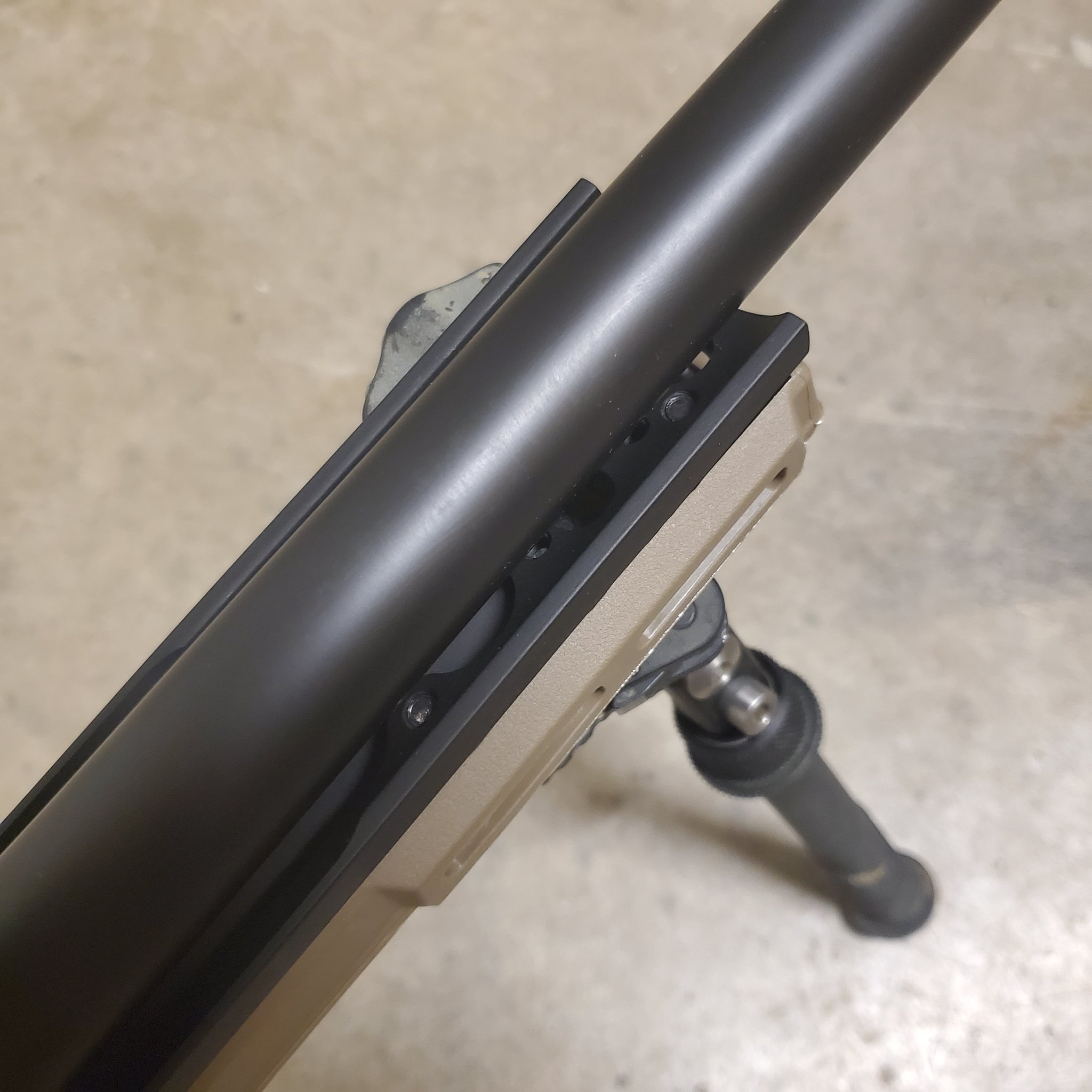

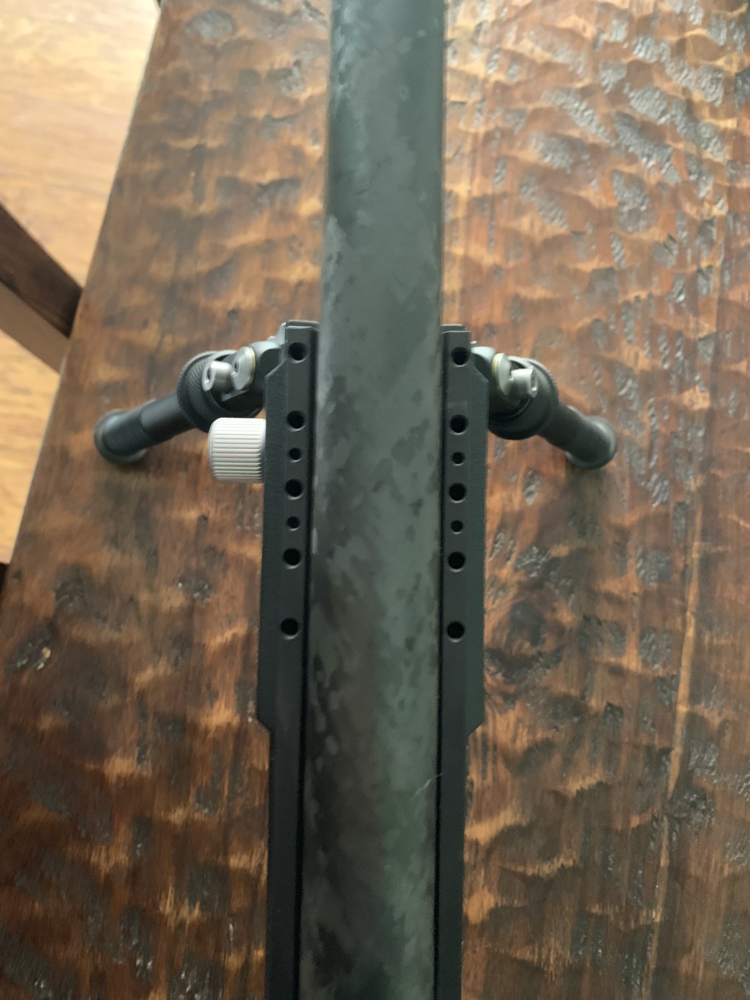

My problem with the KRG NV Mount was it wasn't sufficiently long or adjustable to allow me to mount clipons closest to the day scope objective lens in all cases.
To wit this "large" gap between the rear of the clipon and the front of the objective. We want to mount them as close together as possible.
And this was despite my only using 4 of the 6 screws and mounting the NV mount even farther to the rear than was intended.
Second problem was it would come loose ... as with most of the screws on the KRG ... massoud recommended loc tite ... and that did help where I used it (like on the sling mount back on the stock).
But I replaced the KRG NV mount before I tried loctiting it.
With the PRI (Precision Reflex) rail, essentially a long scope base. This reduced the weight, moved center of gravity farther to the rear and permits mounting any size clipon in front.

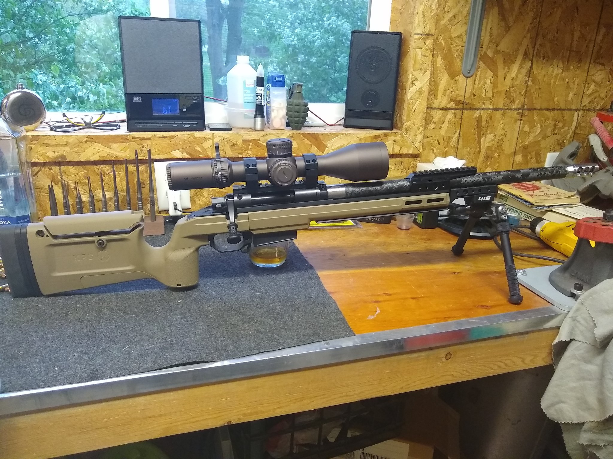

Yeah, the enclosed foreend works with the Bravo chassis. I have one I just put together. I like it so much, that I'm considering upgrading my other KRG chassis' to it.
I'd attach a photo, but it seems that function is currently broken with the recent upgrades to the site.

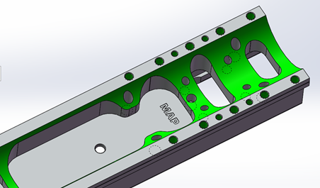

The Enclosed Forend does fit the Bravo.
All the Bravo's since after the first batch have used the same backbone as the Whiskey-3 and X-ray so they will take the INVR which mounts in the barrel channel.
The very latest chassis come with mounting points on the backbone for a new NV mount that is coming and is multi-position. Basically you have a lot of options at this point. Thank you guys for your business!
Cool dioramas @wigwamitus
Justin
... latest chassis come with mounting points on the backbone for a new NV mount that is coming and is multi-position ...
This sounds promising !!! I'll be watching out for the net weight add ... always looking to cut weight on this rifle ... this is supposed to be my "light" rifle !!! :D
