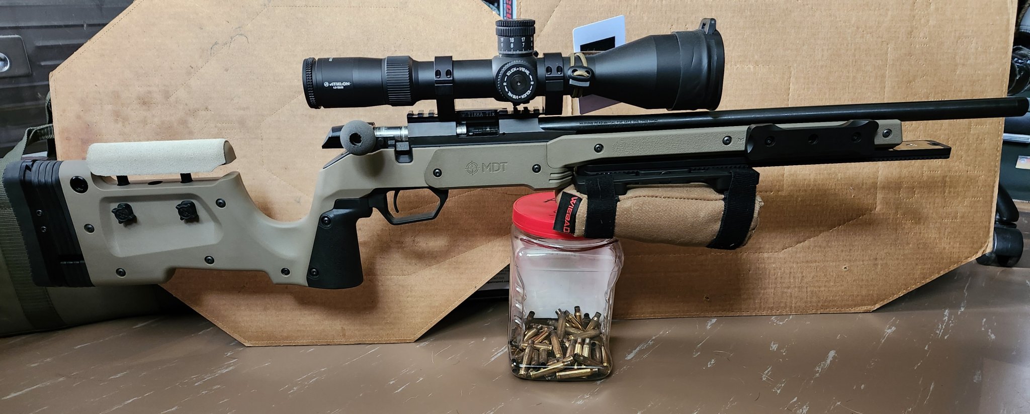

Just like thesniper my T1X is butt-heavy... have MDT XRS fore-end weight, mlok weights, still doesn't balance forward without the heavy bag. When I went looking for tuners, found these:
https://www.pmatool.com/pma-barrel-tuner-1-2-28-threads/
https://www.harrellsprecision.com/products/harrell-rimfire-tuners
https://diprecision.com/ec-tuner-v2-thread-adapters/
https://www.kineticsecuritysolutions.com/products/adaptive-tuning-system-ats-slimline-tapered?variant=39875155066995
https://lumleyarms.us/lowey-barrel-tuners/universal-barrel-tuner-screw-on-small
https://www.shootsmallgroups.com/product/ec-barrel-tuner/
Gary Eliseo will install a straight .900 Shilen barrel--any length--but that's an expensive way to get more weight out front.
Balance pic... only with heavy bag, still needs more weight out front

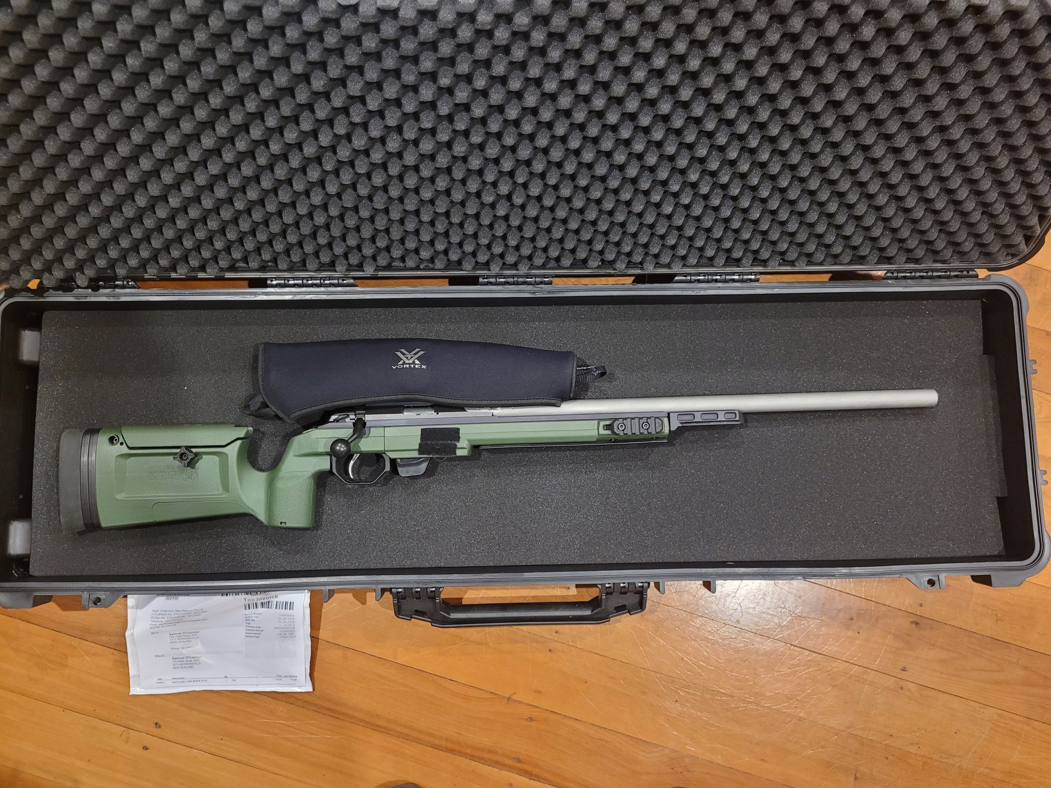

I’ve ended up putting on a 25.5” medium palma barrel and it still needs weight in the forend to balance it out.
beetroot, are you happy with the 25.5” medium palma barrel? Any pics posted here? Gary Eliseo will install a .900" Shilen barrel for a reasonable price but doesn't have them in stock, they're on backorder. I'm trying to decide if a 24" Shilen would be enough extra weight up front. Also kind of curious as to how much extra barrel the T1X action can handle, maybe that's not an issue.
I've had a few extraction issues with it which I'm just putting own to growing pains, as the company that did the job hasn't rebarrelled a T1x before.
They didn't have any issues with the action taking such a long barrel, the mounting "system" is pretty similar to other riflefires so I'm guessing it'll cope just fine.
The rifle definitely sits on a bag much nicer now, it shoots well, handles well, basically once the extraction issue is sorted I'll be very happy.
A 26" barrel would be safer I think, but a .9" strait should be a little heavier, so 24" might be ok. If you want maximum weight with the Bravo go 26", if you want a little shorter/handier then 24" would obviously be better.
