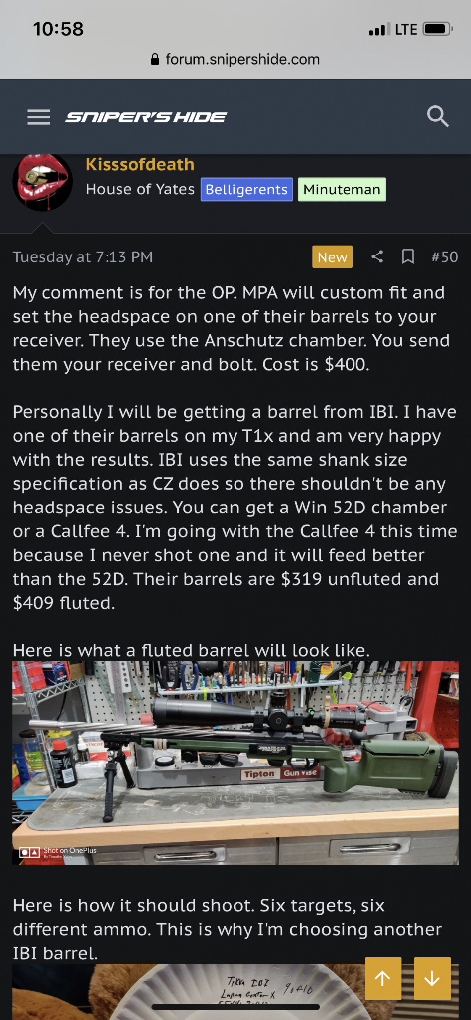

Post #50 features a T1X and comments about choosing an IBI barrel...
Right you are. Showed an action mounted in the chassis and I thought it would get the visual across.
My bad. Sorry.
No need to apologize, haha. I had hoped you had simply out the wrong post number and there was one with more info is all. :)
