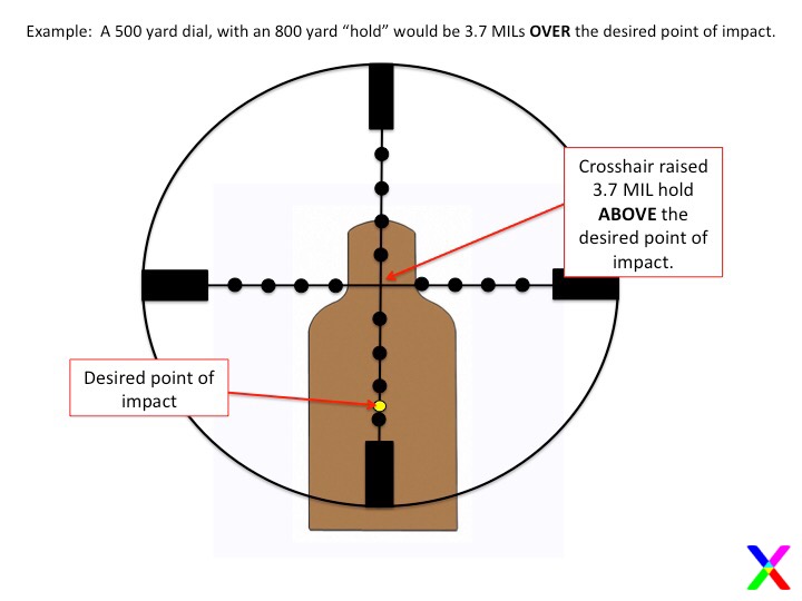

RELEVANCE OF THE MIL DOT RETICLE AND THUS THIS SERIES
The MIL dot reticle system can be used for various actions, to include estimating range to a target and holding (adjusting your point of aim off of the desired impact point of a target) in order to compensate for the external ballistic effect of the wind, etc., on a fired round while it is in flight.
If you are a tactical, long range precision marksman or hunter, the ability to effectively and rapidly engage targets at multiple distances could prove to be critical in your ability to defend yourself or others, win a competition, provide food for your family or others.
ADJUSTING FOR ENVIRONMENTAL FACTORS
While a fired round is in flight, winds, range and other factors can and do affect the round's path. In order to compensate for this affect on the round's path, a marksman may calculate the deviation upon the fired round caused by the environmental factors and then "dial on" the adjustments utilizing the windage and elevation knobs.

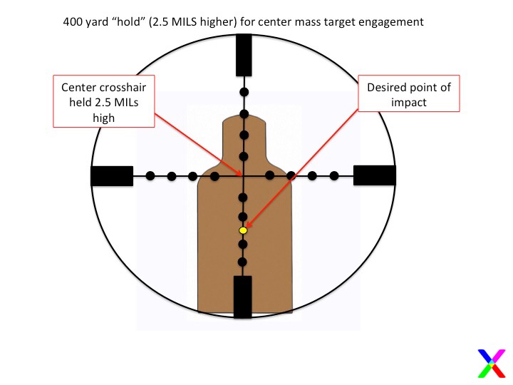

The application of this data would be thus: The rifle is zero’d at 100 yards. A target (as so deemed) presents itself at 400 yards. There are no winds to be calculated. The “hold” in MILs to engage a 400 yard target (with a 100 yard zero) is 2.5 MILs.
In order to engage a center mass or point of desired impact hit, the marksman would then “hold” (raise) the center cross-hair 2.5 MILs above the desired point of impact

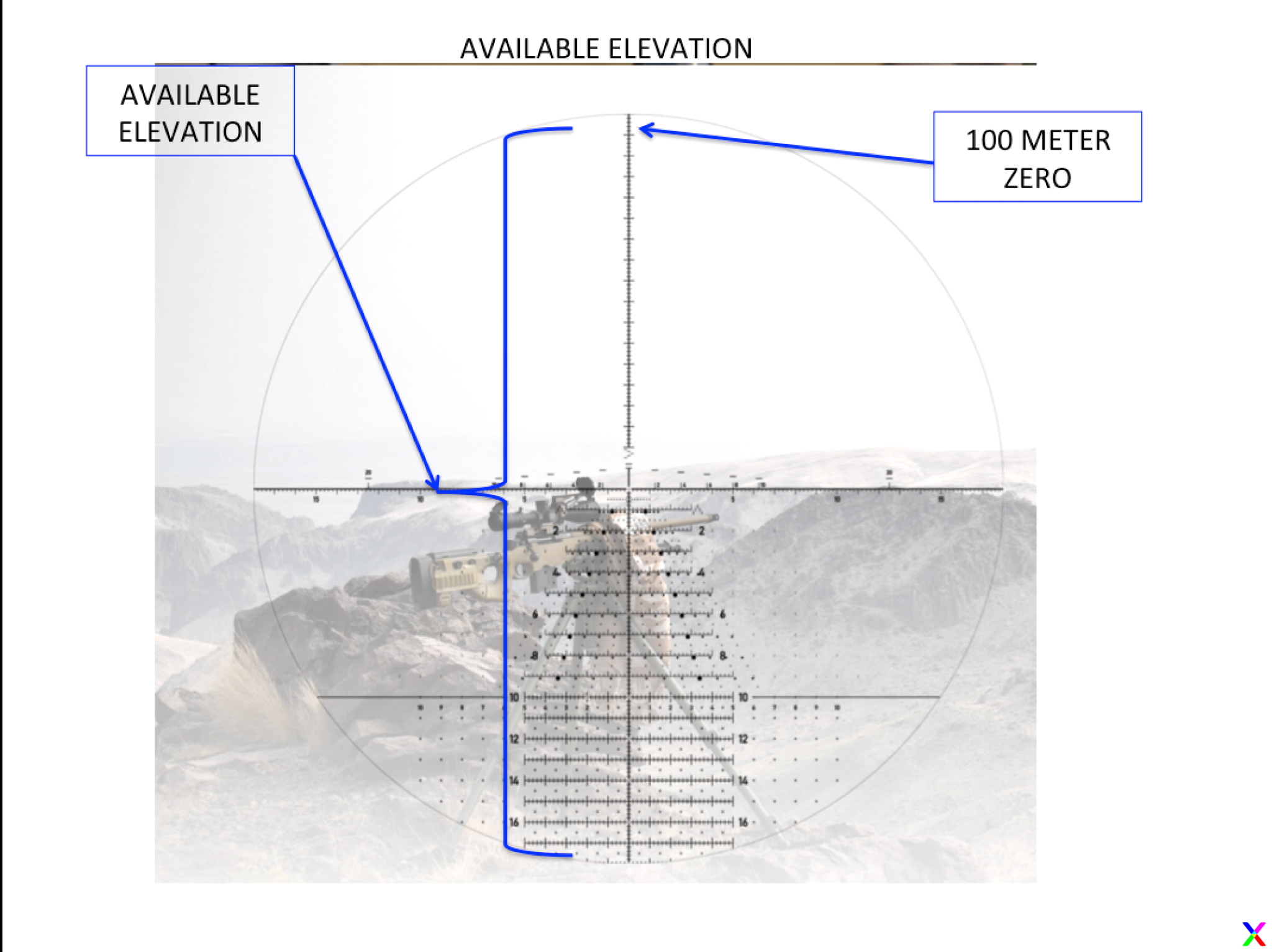

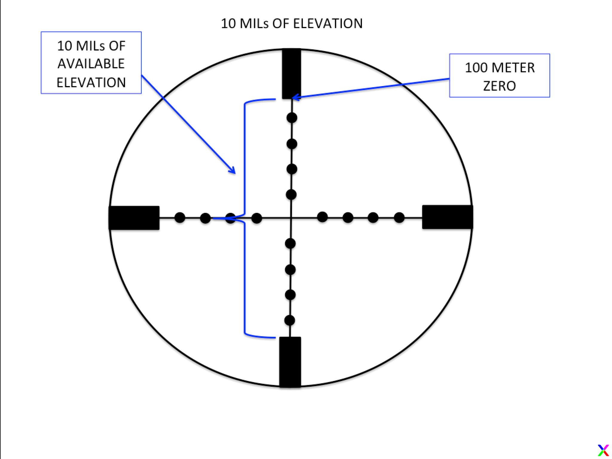

NOT ENOUGH MILS AVAILABLE

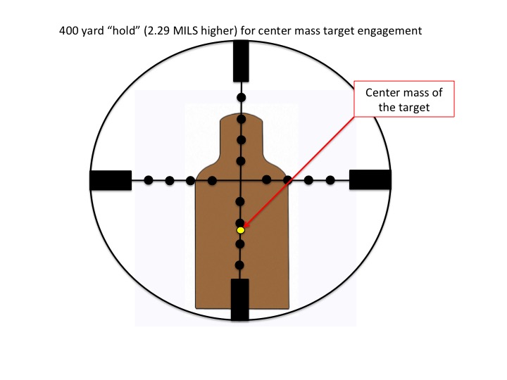

Since there are only 5 measurable MILs from the center line to the thick black bar at either end of the cross-hairs of the reticle this process can be utilized to engage a target that is 600 yards away or less as any target farther away than 600 yards requires a hold of more than 5 MILs.
ADJUST FOR THIS SHORTCOMING

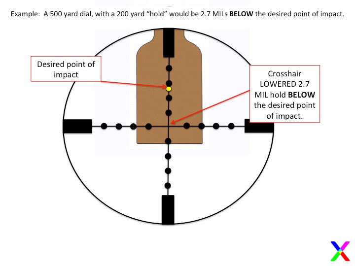

EXAMPLE
The marksman sees two targets.
The first target appears at a range of 200 yards away.
The second target appears at 800 yards away.
The marksman desires to engage BOTH targets.
Using the data above the marksman, in order to engage the target at 200 yards would “hold” 2.7 MILs UNDER the desired point of impact and engage the target:
Then, in order to engage the target at 800 yards away, the marksman would hold at 3.7 MILs OVER the desired point of impact on the 2nd target:

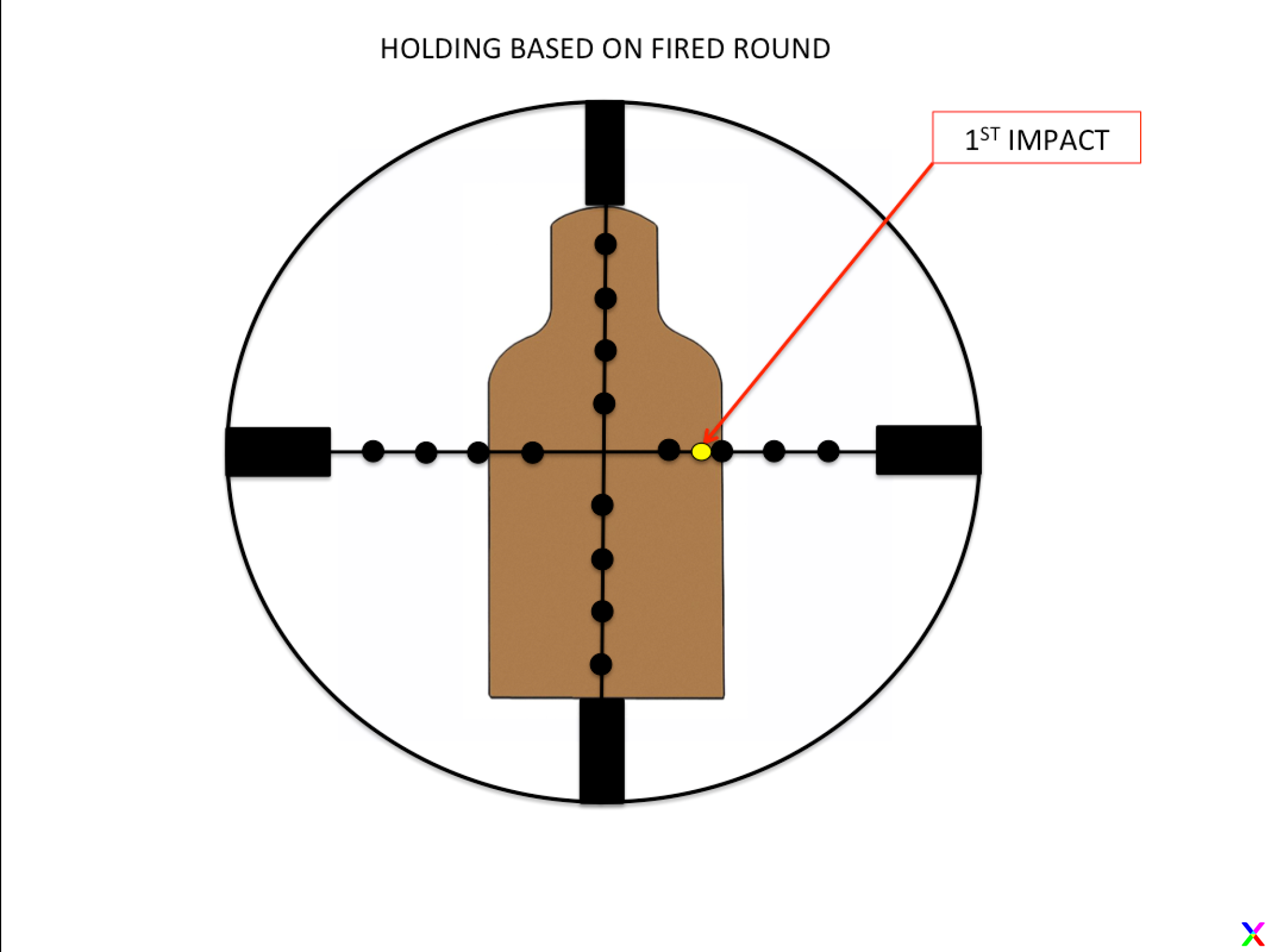

MIL RETICLES AND MOA DIALING
Your question is probably going to be the basis for Part 4! There's a LOT to be addressed here.
First off, Yes, your scope and its reticle and the MOA dialing can be used. In the example that I provided, it was MIL dot and MOA adjustments. You will potentially just have to do some math.
However for now, lets look at one situation:
Adjusting using the reference point of the impact of a round.
Range: 700 Yards
Desired point of impact: Center mass
You fire the first round. and it strikes right of center mass of the target.
While keeping the crosshairs focused on the center of the target, you make a mental note of where the impact is on the target.
You then slide or move this part of the reticle onto the center of the target.
See the examples:
First round fired strikes right of center.
Note where on the reticle the impact occurred.

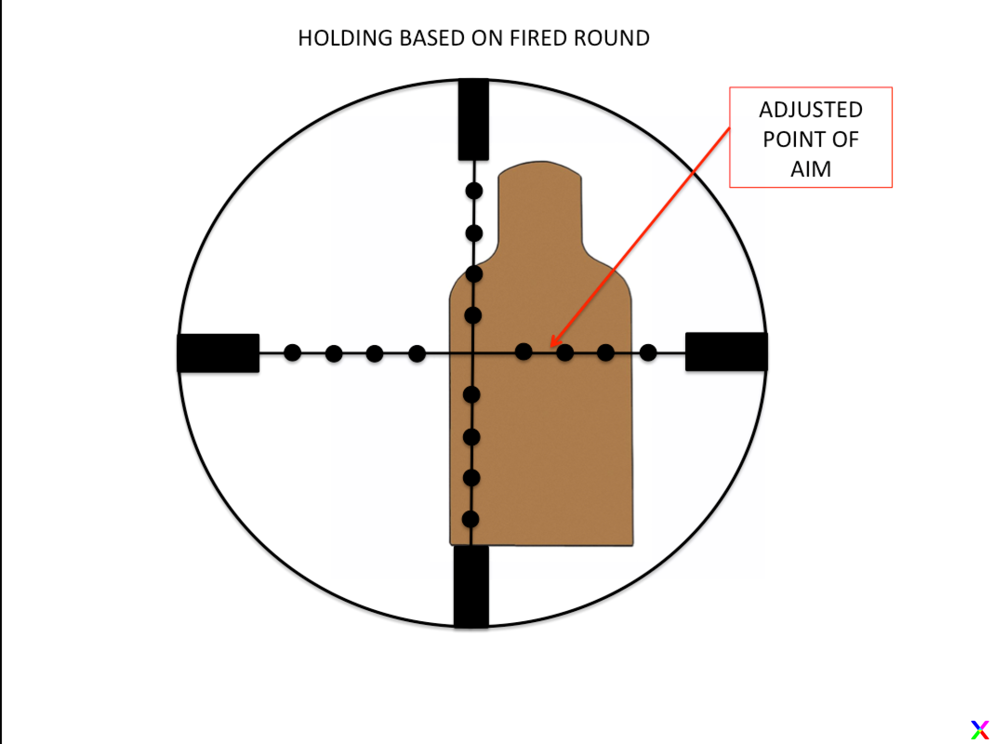

Is it this simple? Sometimes, but not always. Windage is easier to do this with than Elevation. Impacts on target or a backer are easier to do this with than trying to use impacts on the ground or reading trace. But it can be done.
Again, this is super best case scenario.
It would get more difficult if you had a spotter who is reading in MOA and then you are holding because the spotter or you would have to convert the deviation of the round's impact from MOA to MIL, and THEN you would hold in MILs.
Again.. that's a whole other Part # to this series... But it can be done... and the more you do it the easier it gets. Send me a DM with the subject ADJUSTING MOA TO MIL and when I post this I will DM you back and let you know that it's up.
