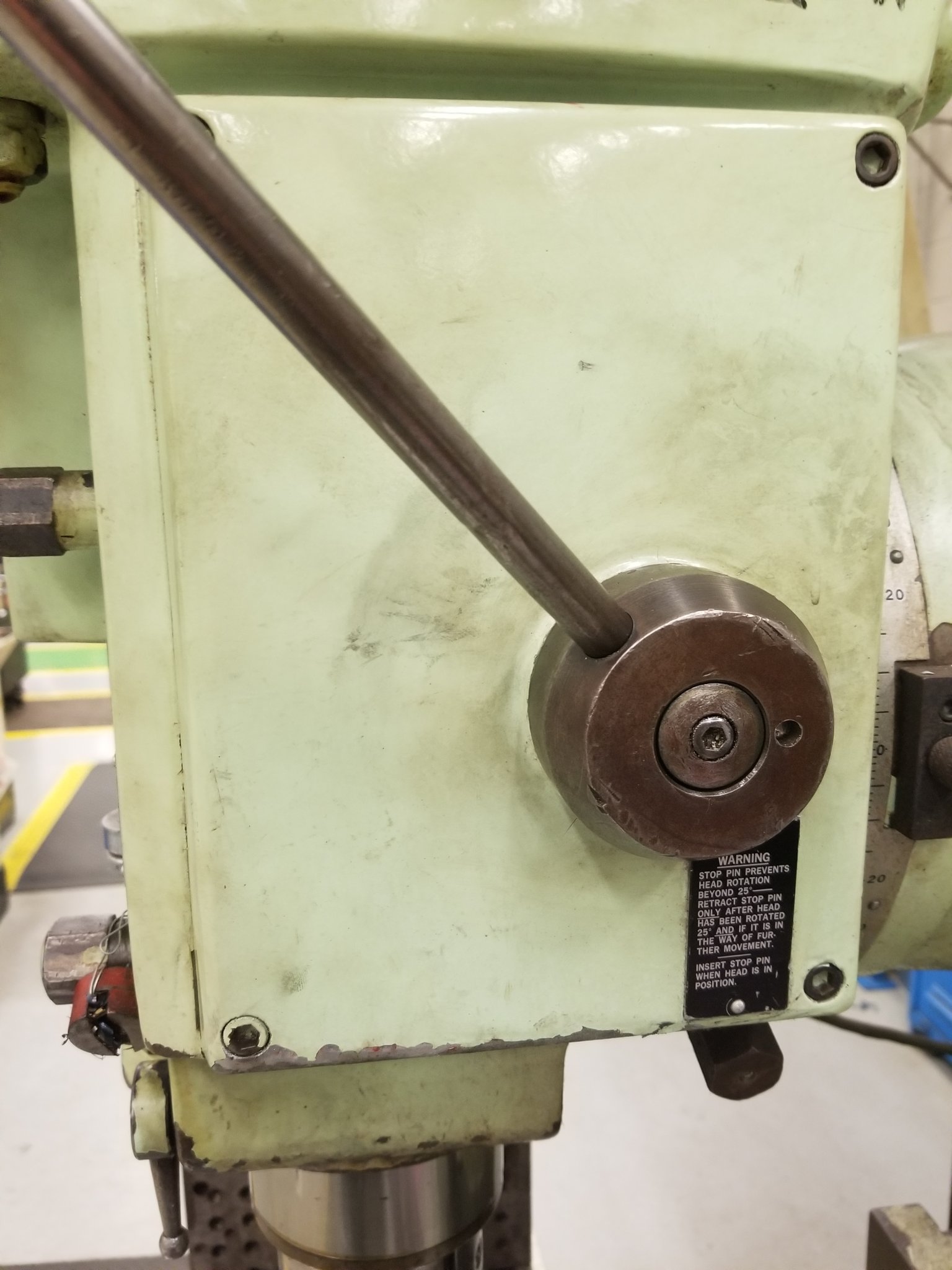

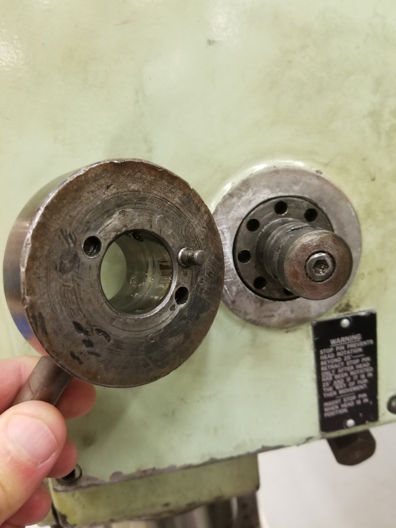

The quill handle on a Bridgeport at work is removable from the shaft and has an offset pin that can be repositioned in a series of radial holes.
A flange on one end the of the CPS shaft with radial holes and a handle on a collar with a pin to engage a different hole for position would be one method.
The flange could be secured as an add on using the existing handle threads.
Can you take a picture of this mechanism?

@orkan.
Sounds like you have had some conversation to remedy the discomfort for @HemiPowrd, but if not here are the photos of the handle.
An add on doesn't have alot of space with the current CPS shaft, maybe a replacement shaft is doable in a right or left hand only design.

@orkan.
Thanks for the pic! Yes, I think we discovered the source of hemipowerd's frustration. I'm pretty confident that he'll be happier going forward, but I appreciate the picture anyway. I'll keep it in the back of my mind, should this situation come up in the future and not have an easy resolution. ;)

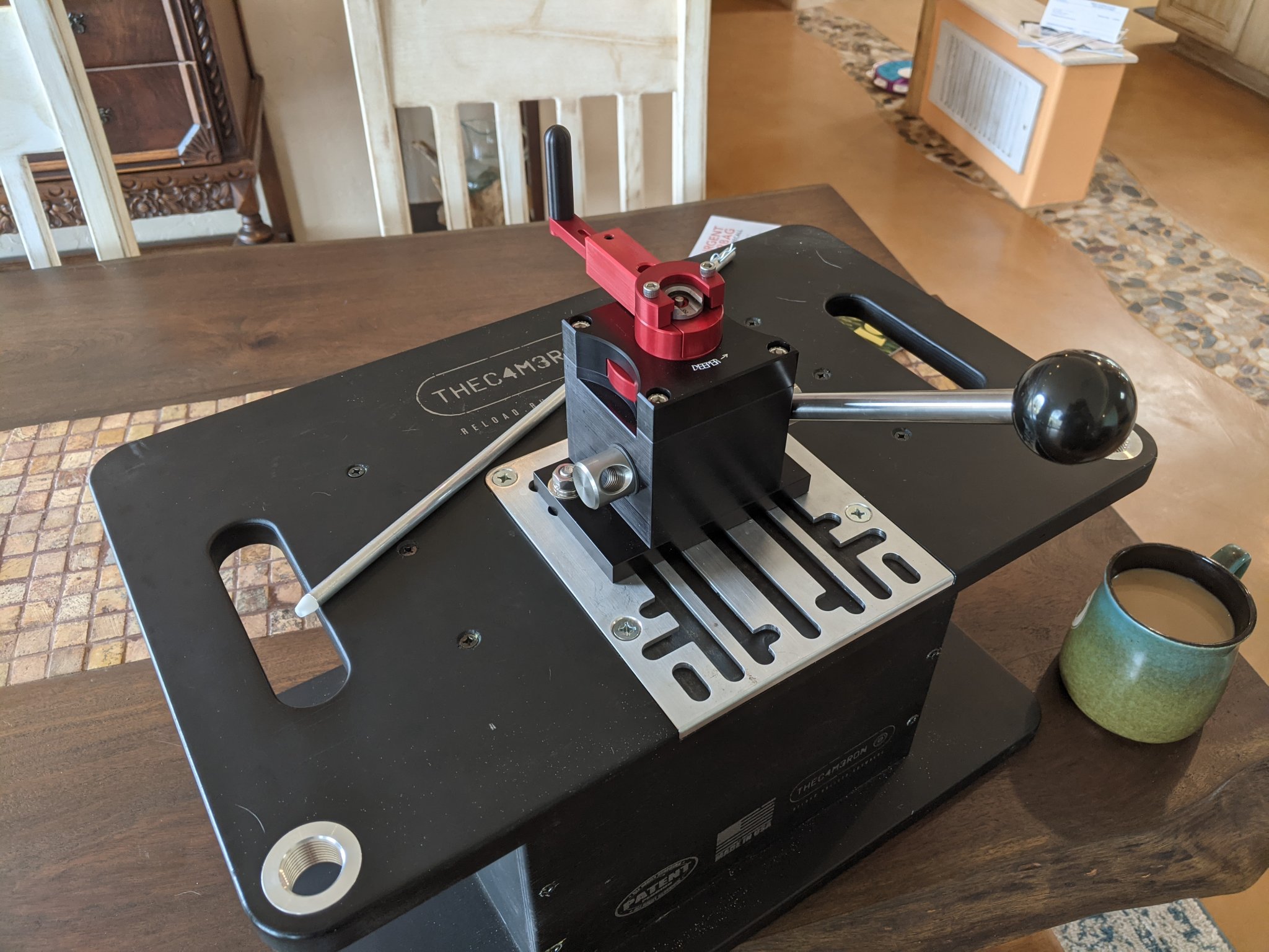

apparently your CPS came with a nice, hot cup of coffee. I guess that is something new that Primal Rights is shipping with the cps now. I did not get one with mine.
