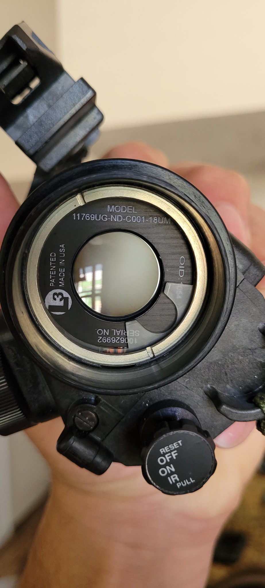

11769UG-ND-C001-18UM would decipher to unfilmed, P43(G), non-gated but maybe 🤡 world has affected part numbers and ident plates.
