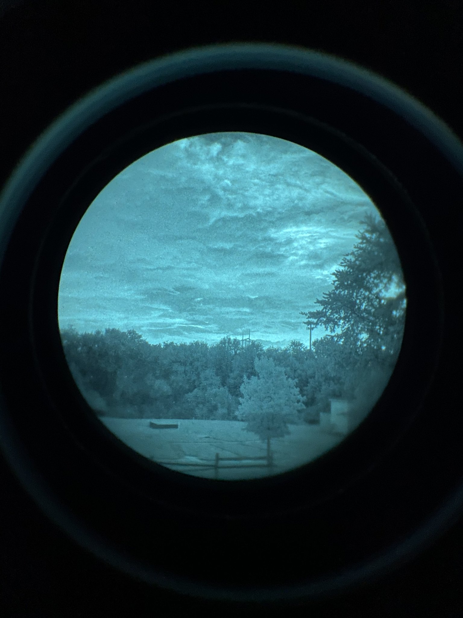

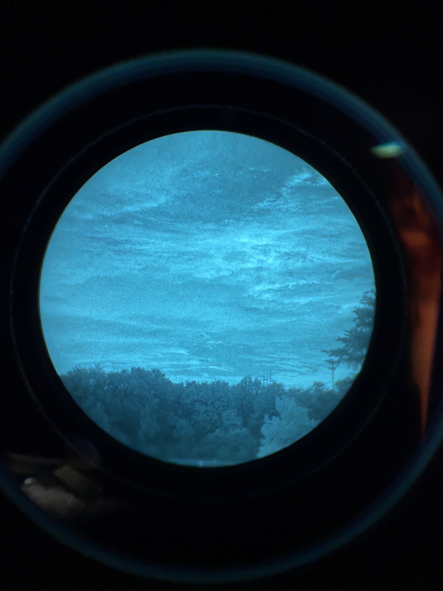

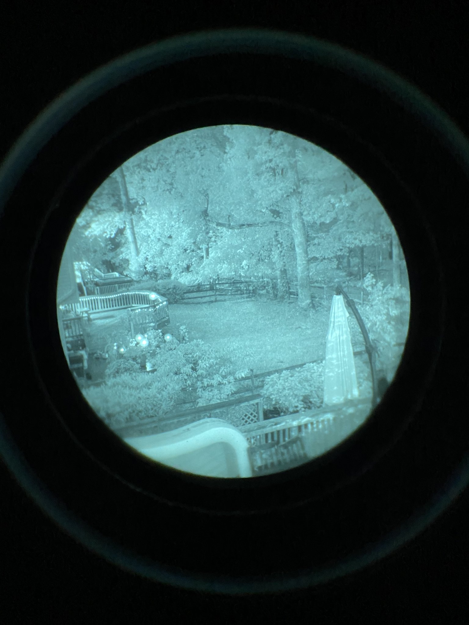

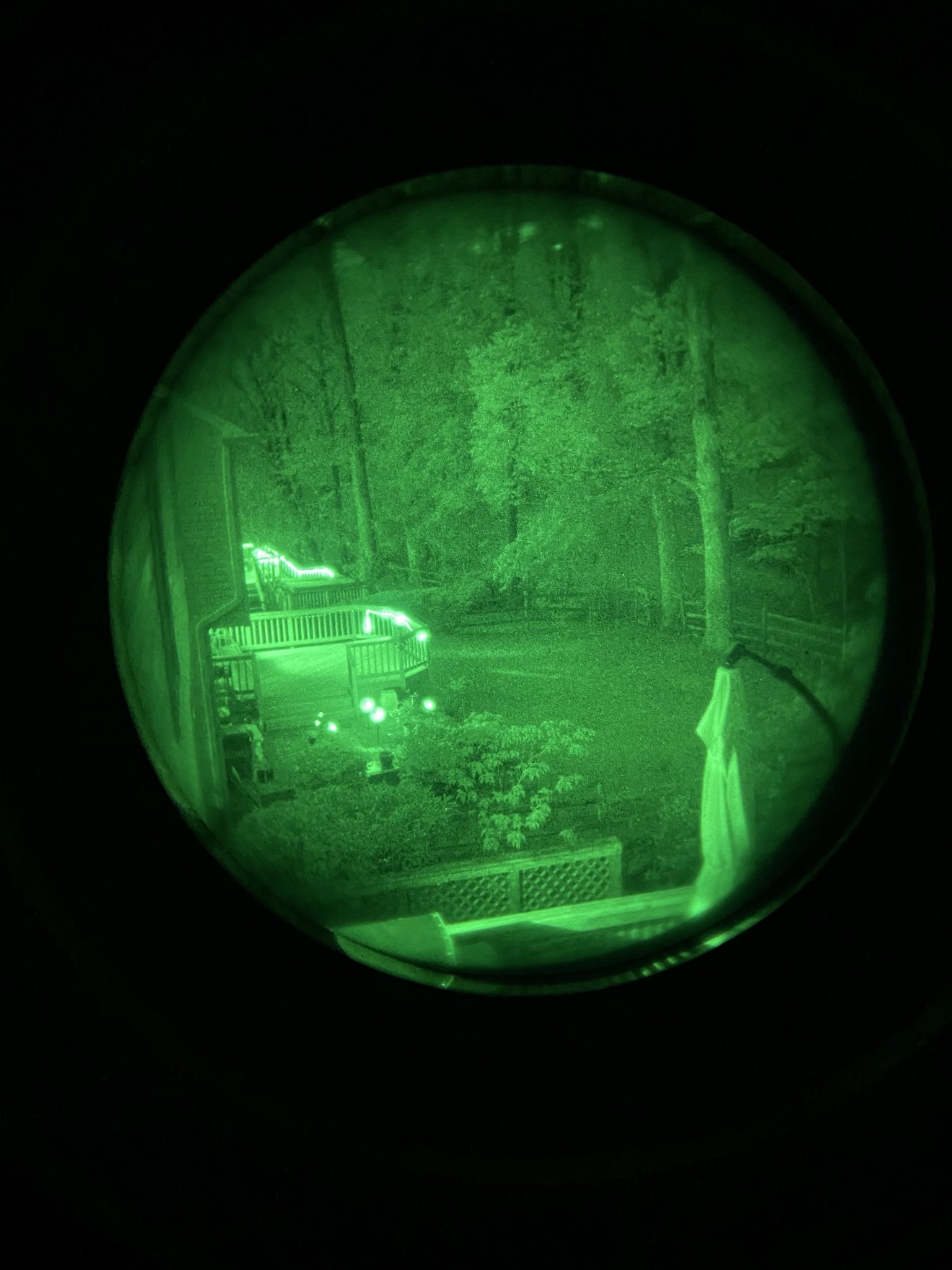

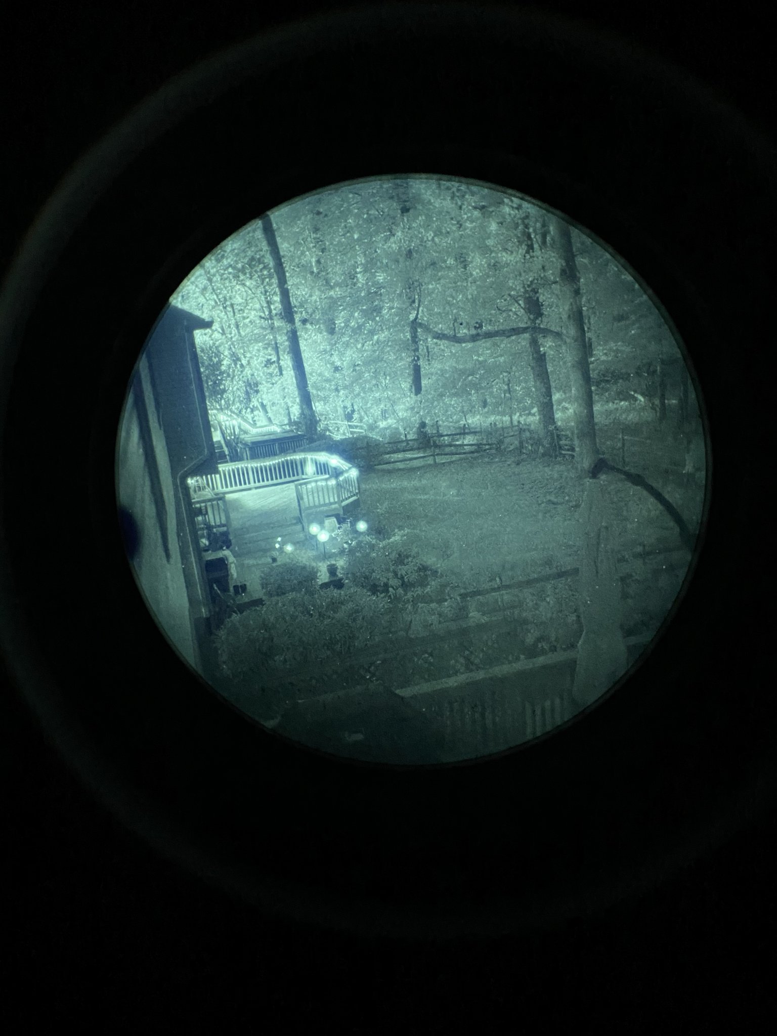

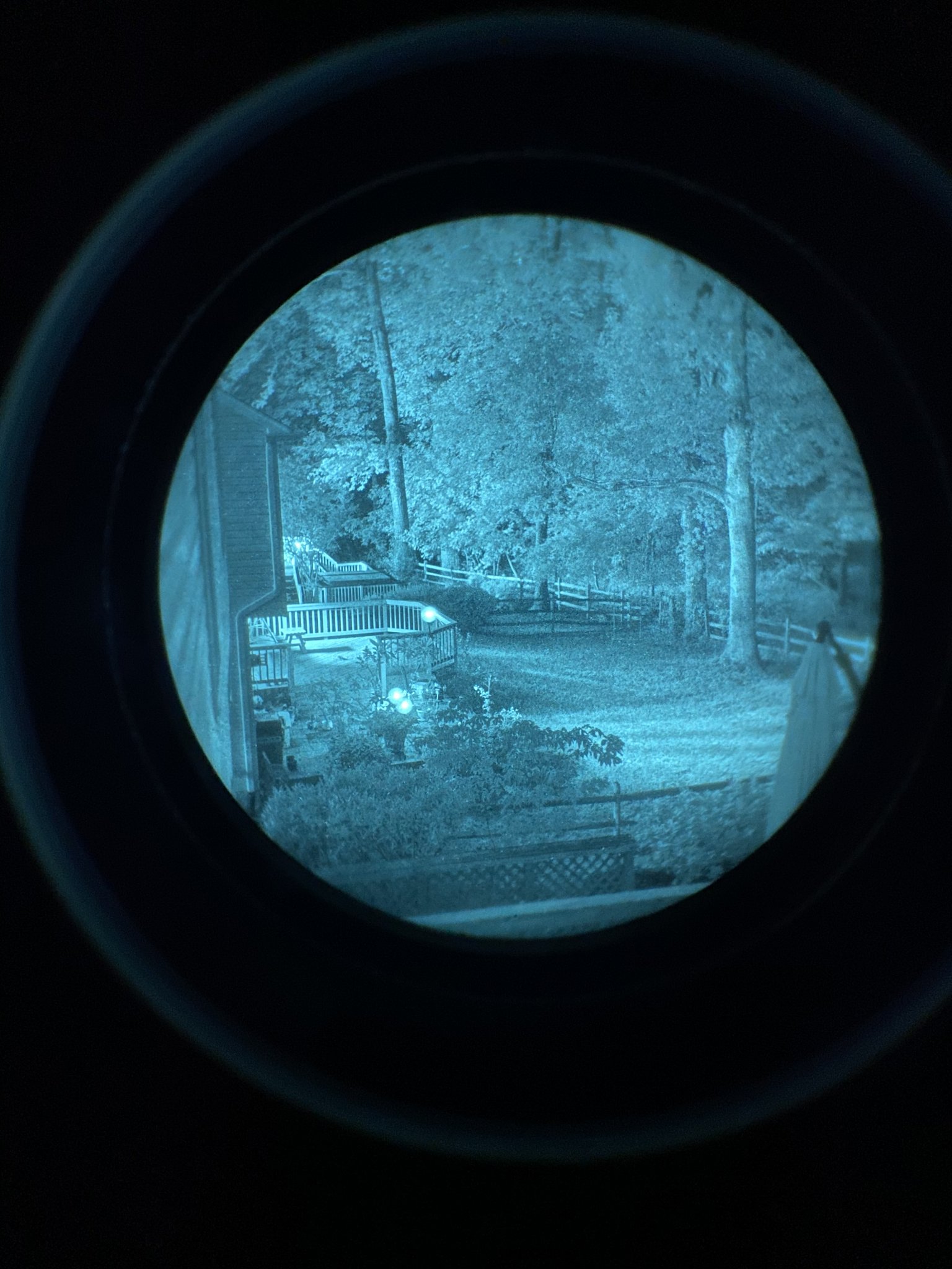

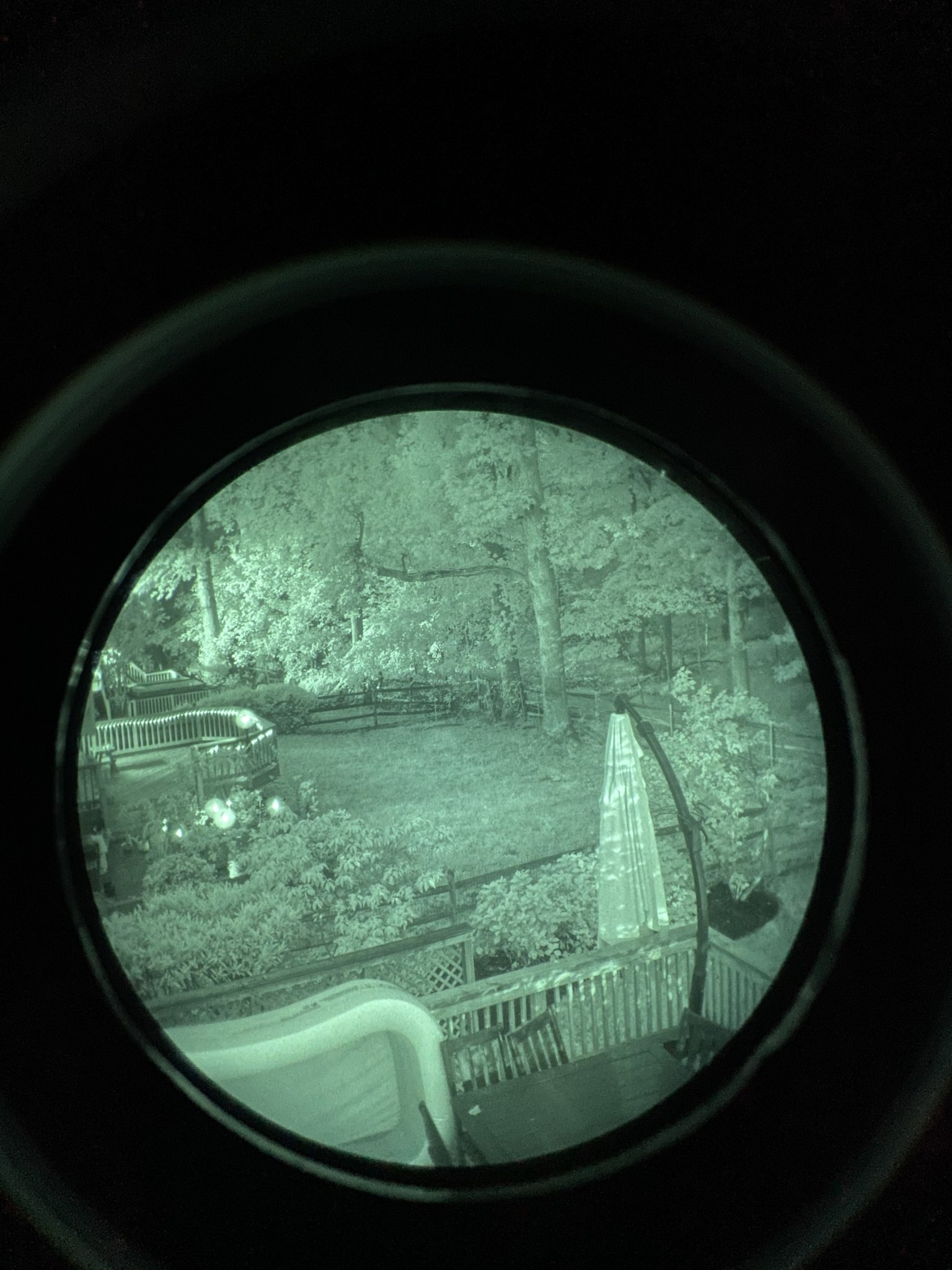

    Had an opportunity to do a little playing around tonight...
    The room in question is actually nearly pitch black to the human eye. There is a blind in the next room and very faint light coming off the white tile.

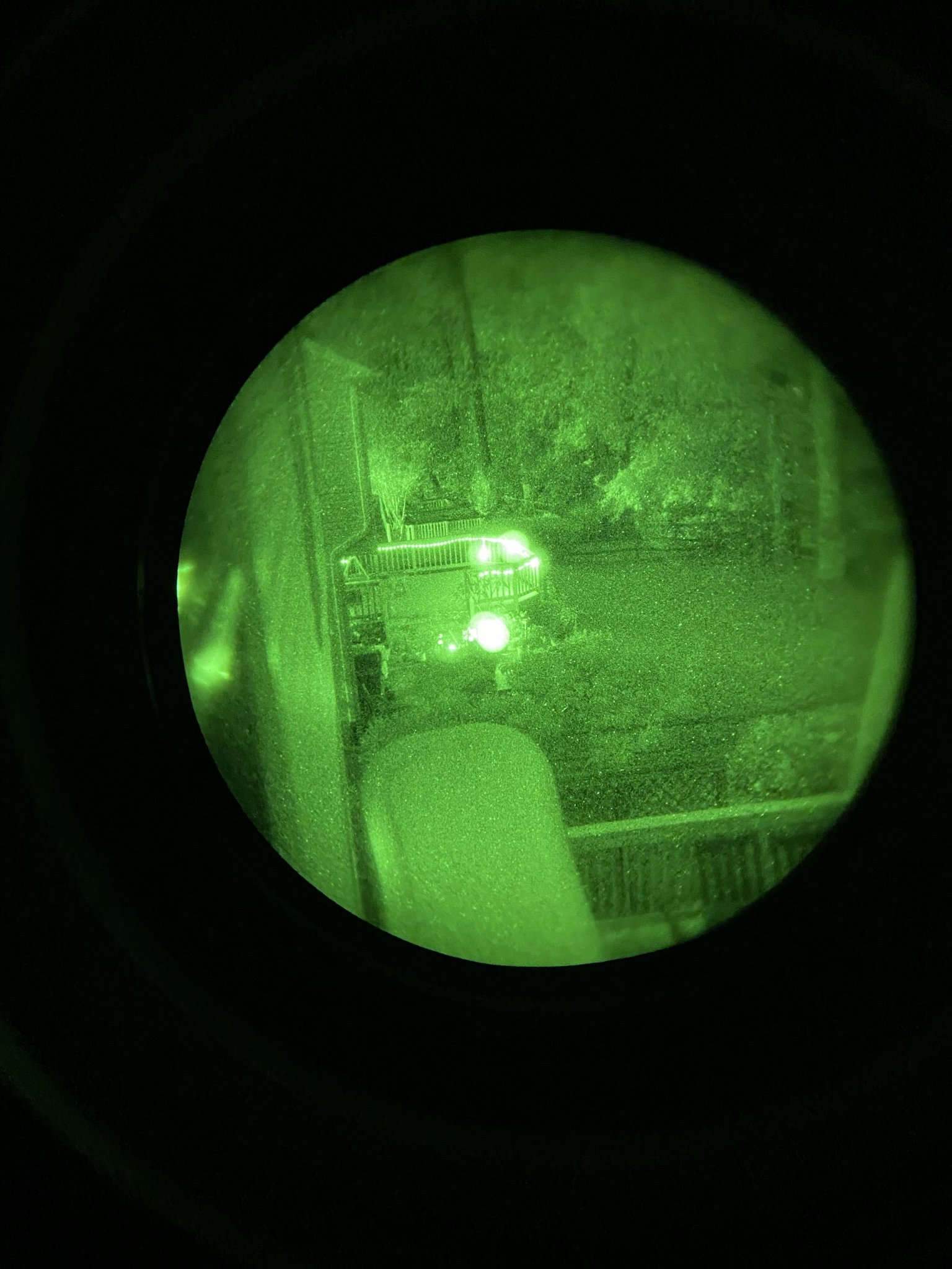

    L3 Unfilmed 2100FOM:

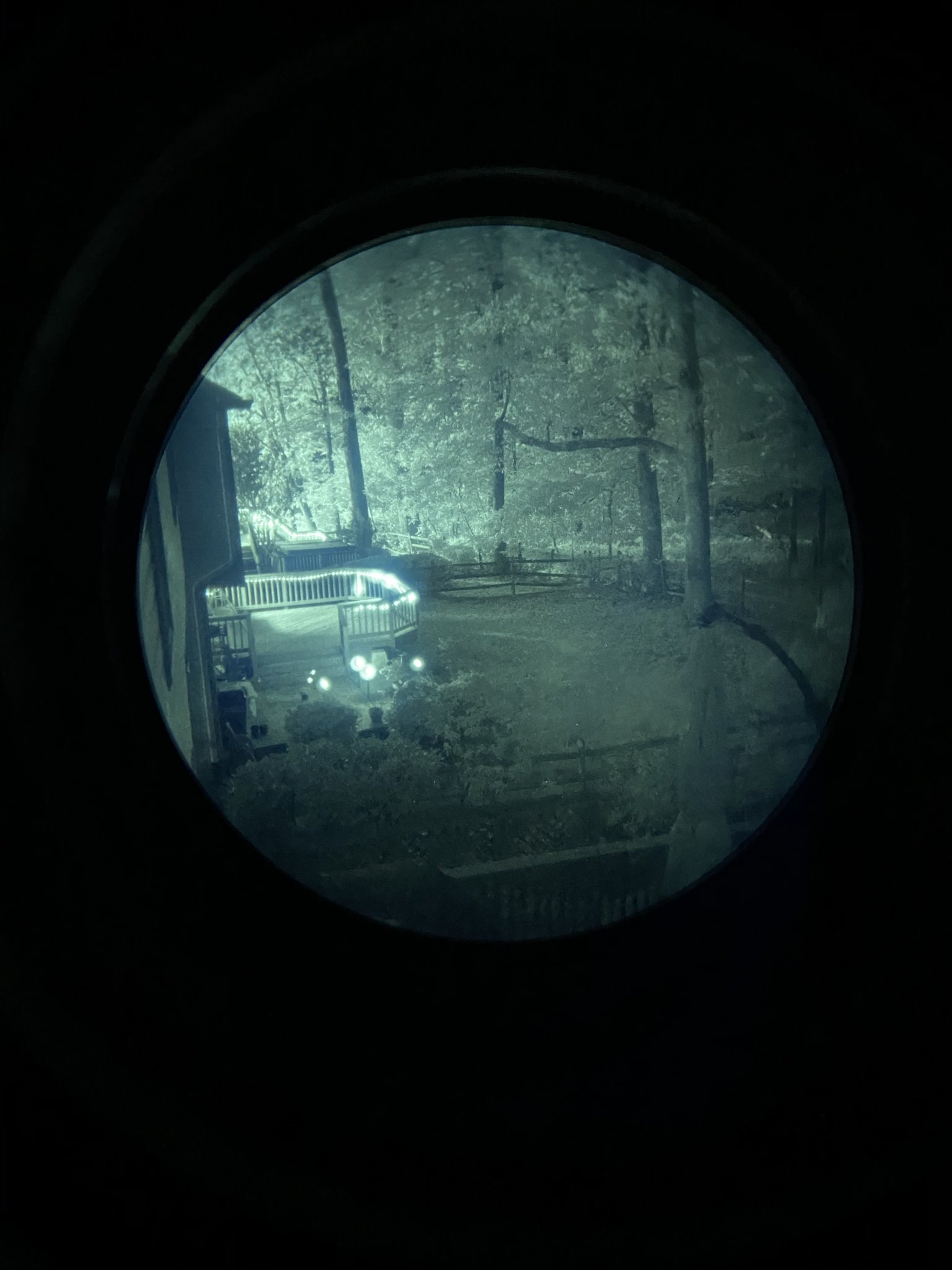

    Photonis Echo 2300FOM:
    The L3 is better. Not sure it’s $1000 better.
    The Echo is definitely darker than the L3. However the Echo has a 35:1 SN and 68lp/mm resolution.
    If this had been an Intens tube with a 35:1 SN it would have been indistinguishable. Of course good luck finding one of those…
    Seems like a cost effective alternative...
    you could get a 35 to 1 L3 tube, but that’s gonna be like $1500 more... And the performance gain would only be somewhat nice not unbelievable

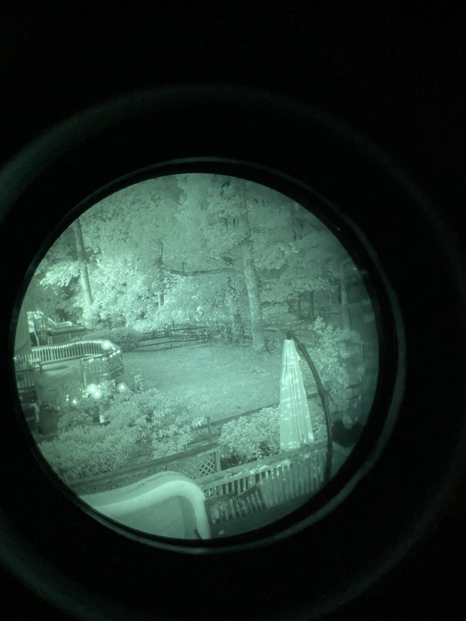

    I think GB Maryland kinda proved a point with his above photos. Yes L3 high spec filmless tubes might see somewhat better in really dark environments and you pay a premium for that slight increase in really dark environments.
    But the $64 dollar question is: "is that seeing better" good enough to ever make real decisions when it counts. Probably not, so you gonna have to use an illuminator anyways. Then the Photonis will likely give a better image because of its high light resolution usually being much better than the L3 filmless.
    When its truly dark enough for the L3 to see better, it is usually illuminator time for real decisions is my take on the situation. YMMV.

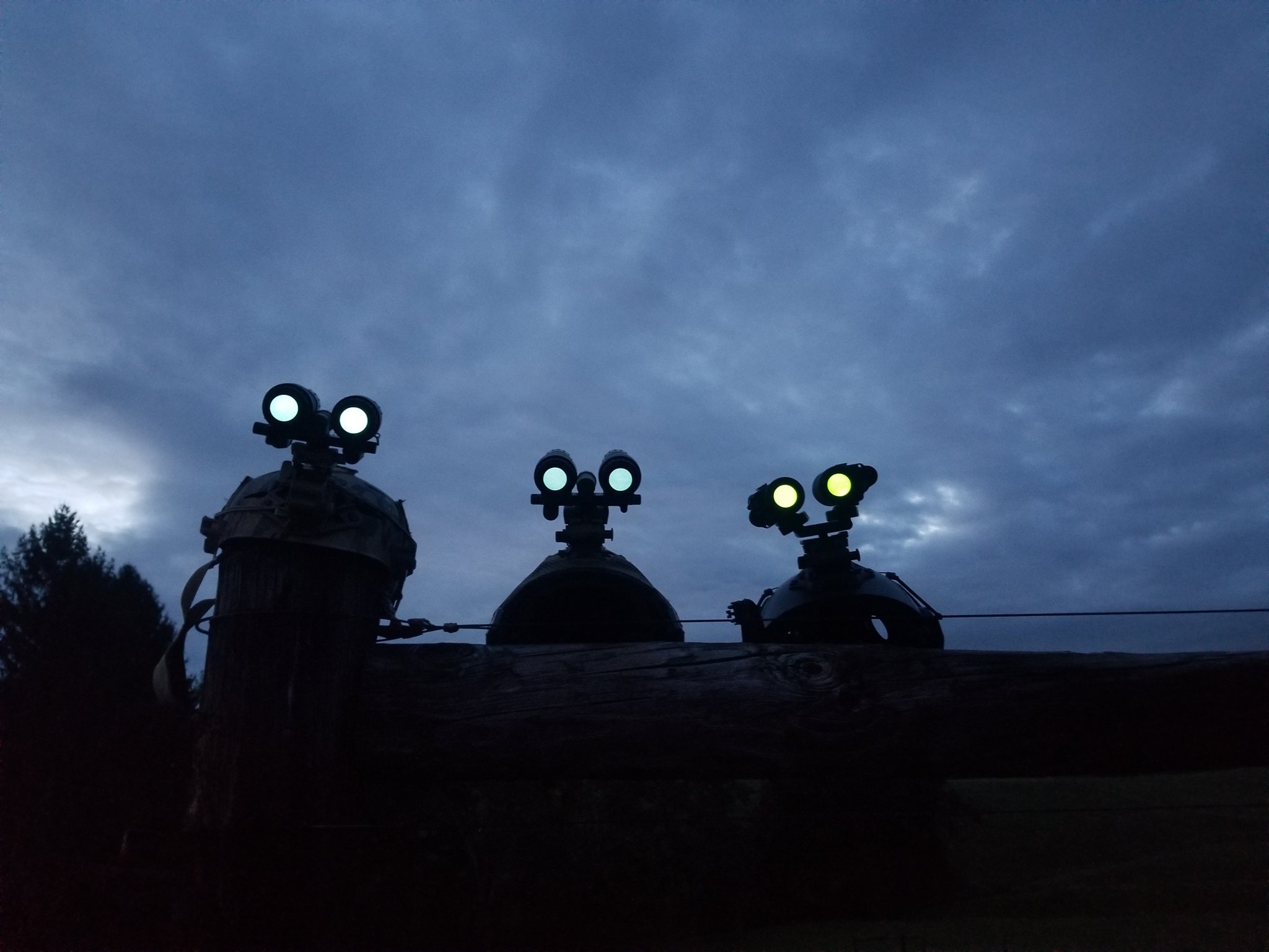

    For me, NV is for moving around at night so it does not have to be the best of the best. Thermal, (be it a COTI or helmet mounted Thermal) is for detection and moving around at night, and the Illuminator and NV is for positive ID. YMMV
    It ultimately depends on how important it is to you to have every edge/advantage to see in the dark and how important it is to have the clearest/sharpest image possible. And of course what you're willing to pay for it.

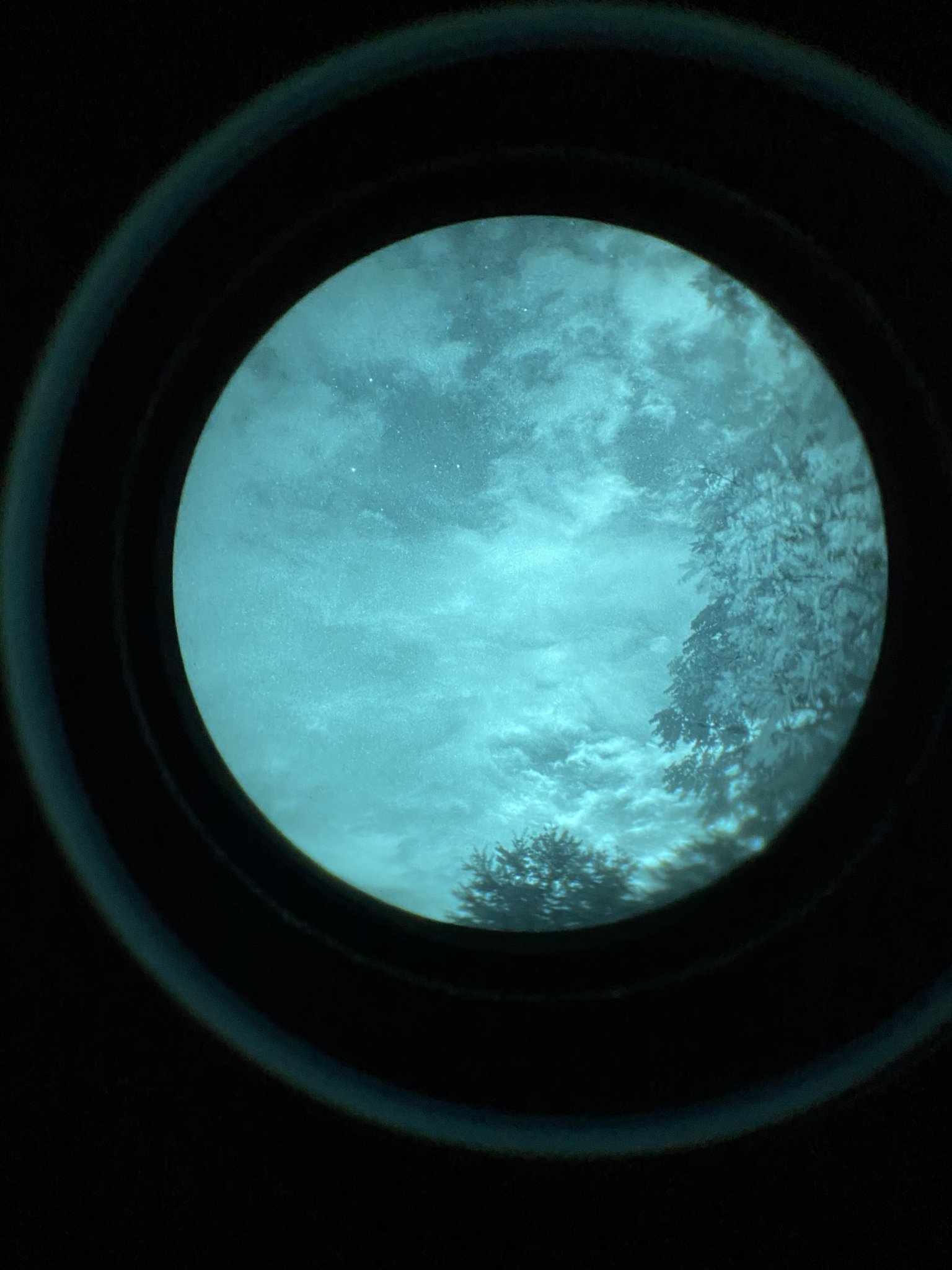

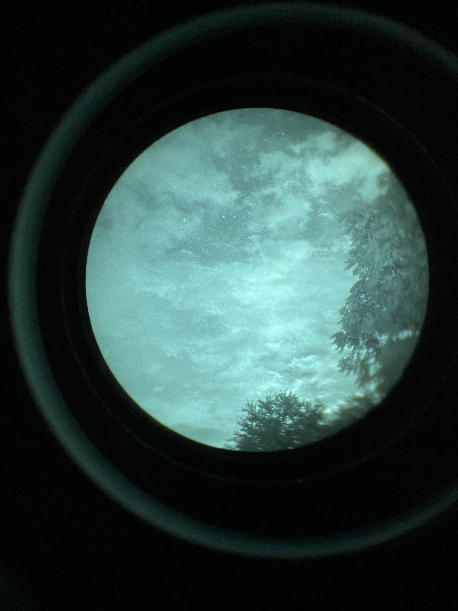

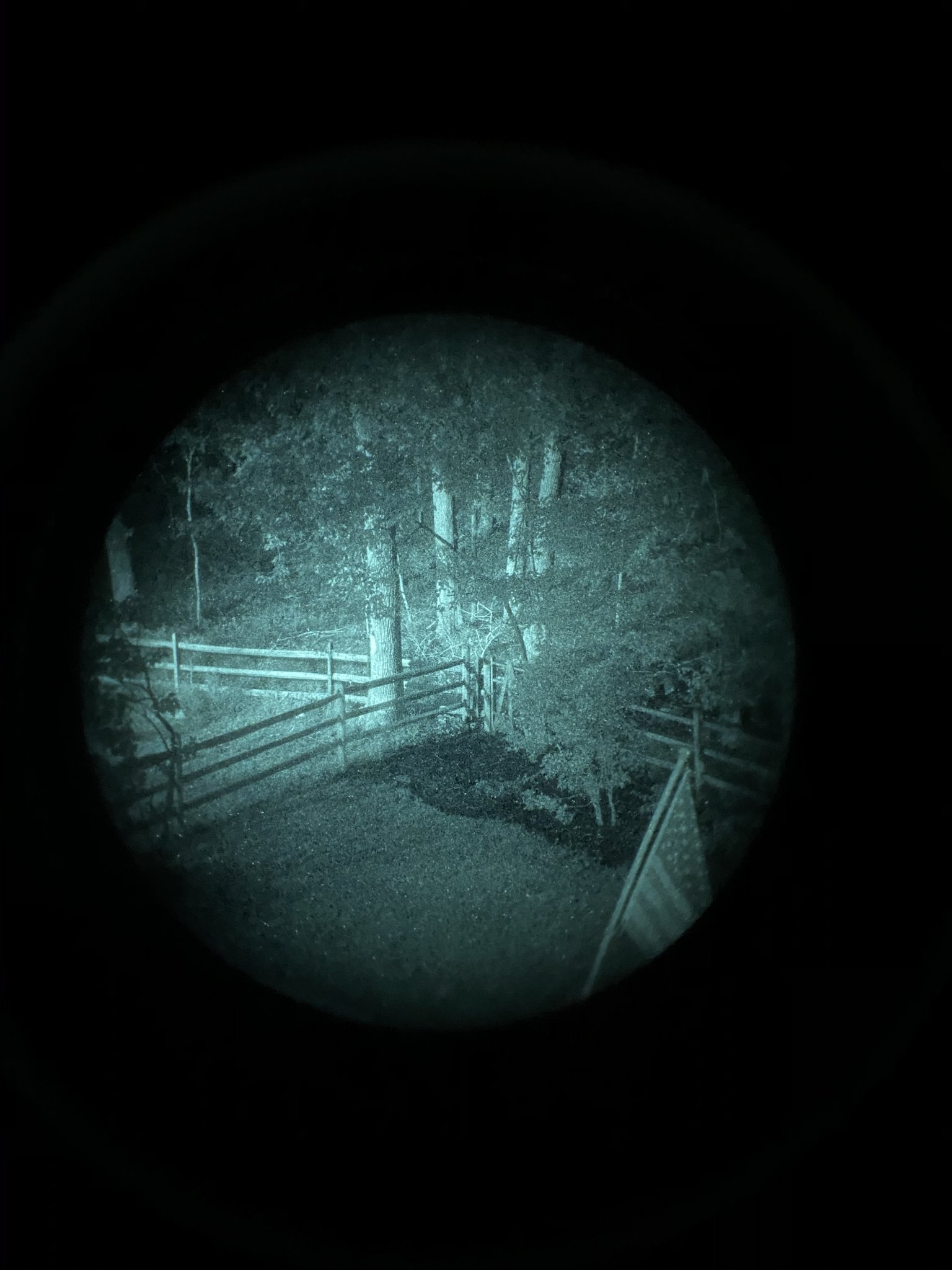

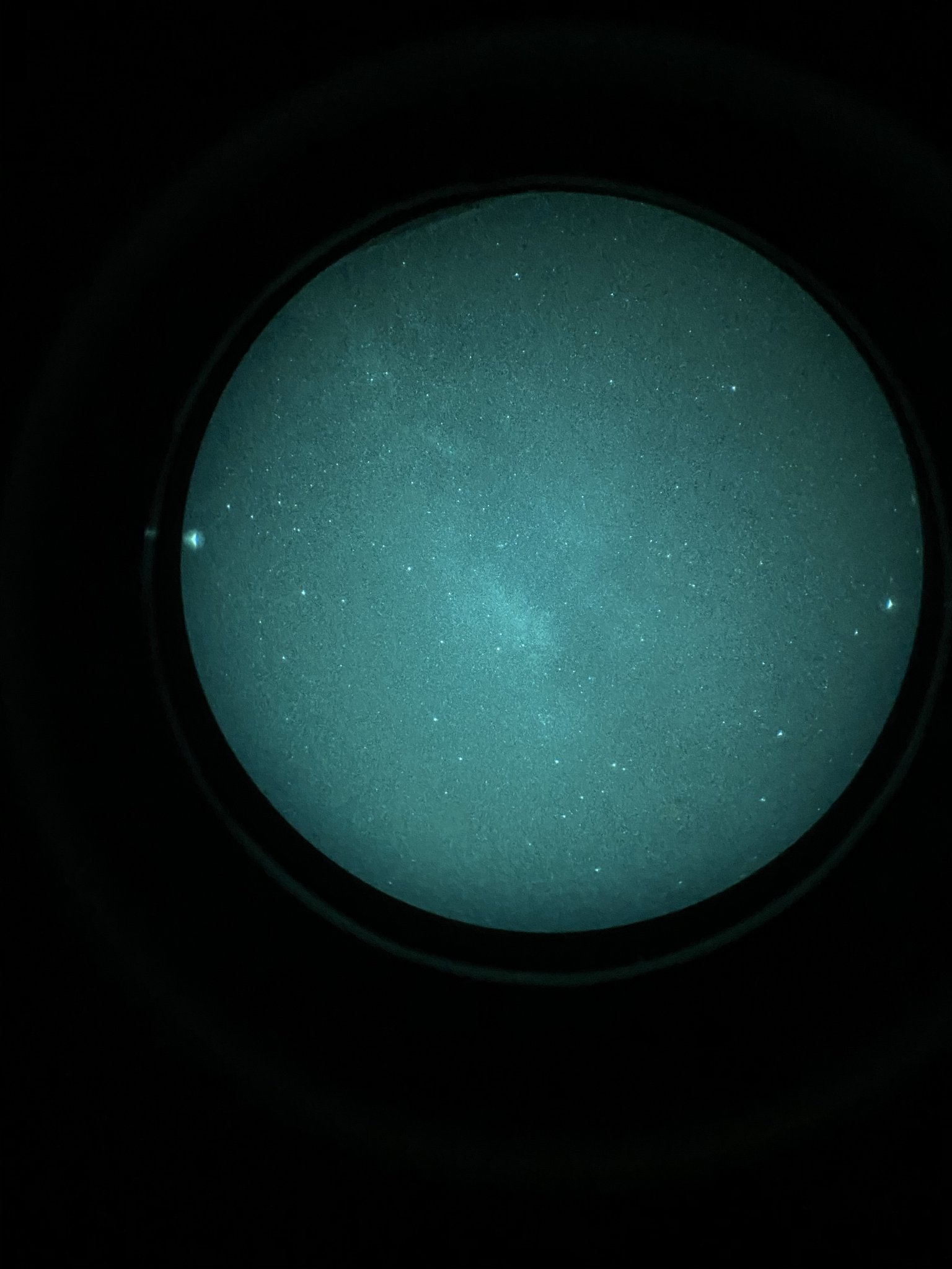

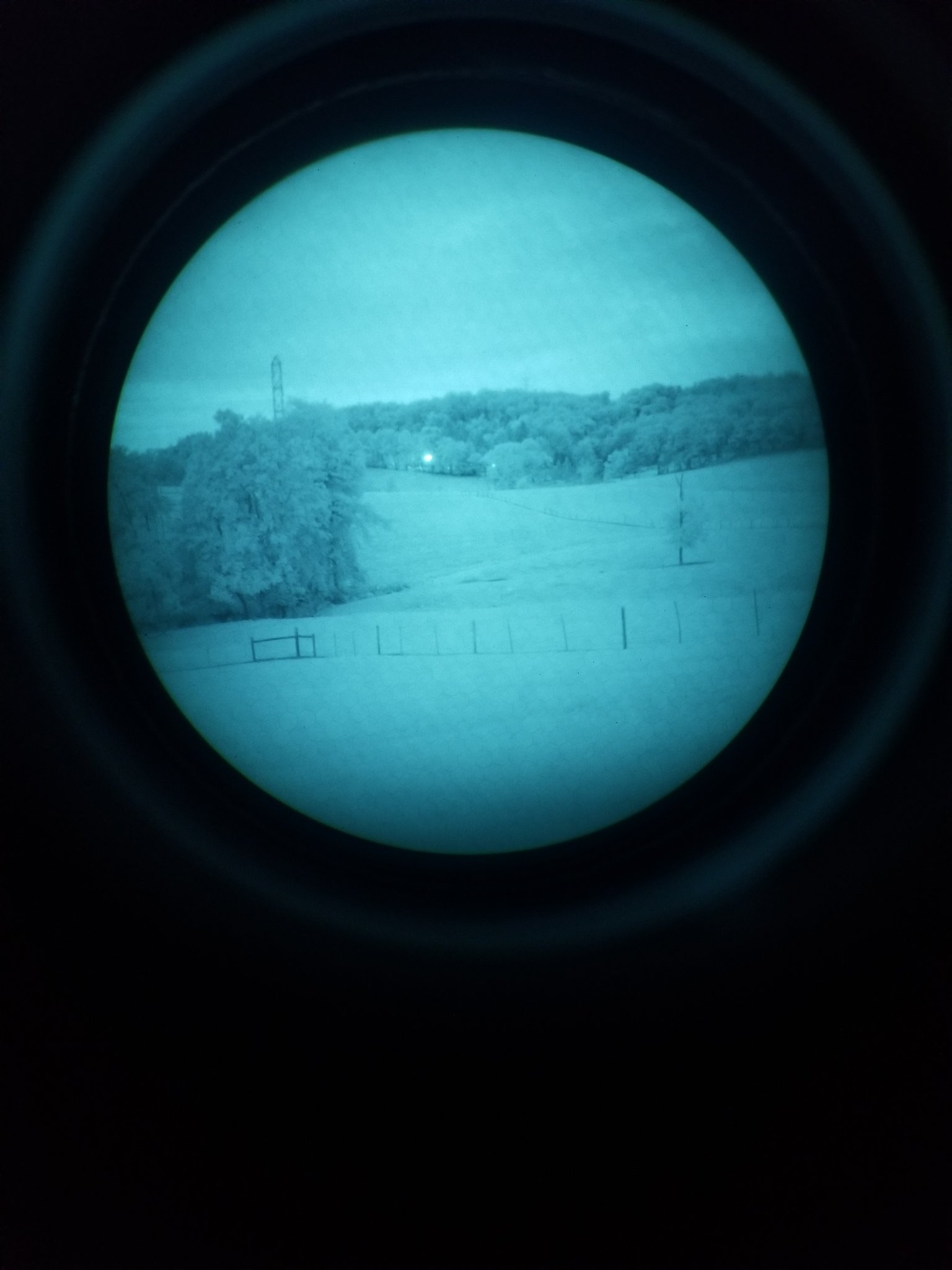

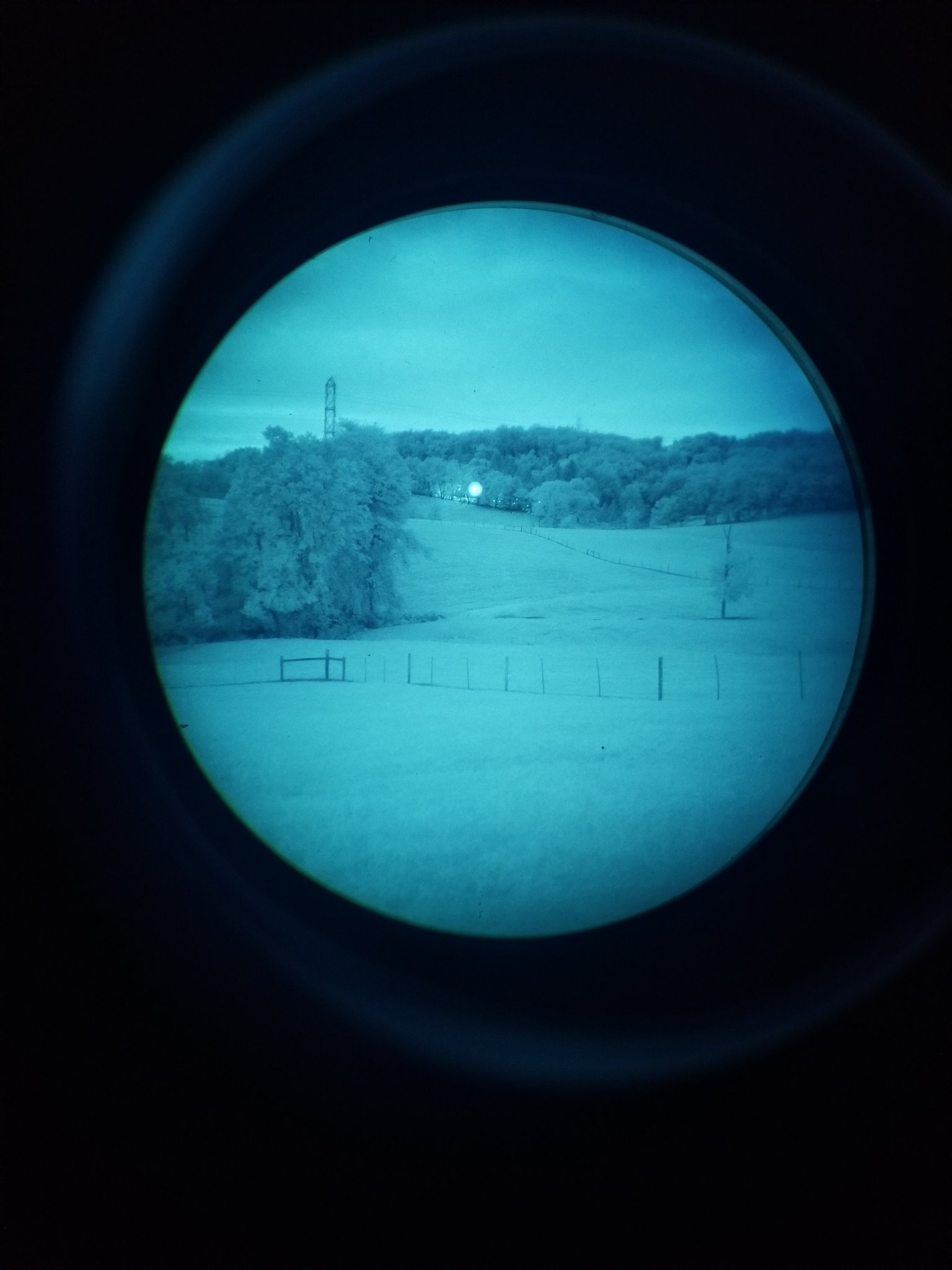

    These two pics show some of the differences pretty good. Viewing them on a larger screen you can see much more detail with the filmless in the dresser drawers, door knob outline, and bathroom vanity/sink. And that's with 2100 FOM (either 32.8 SNR or 29.17 depending on 64 or 72). A higher SNR will be even better. The Echos work good but they are darker than gen 3 (thin filmed or filmless) which I did not care for personally.
    In my experience, the difference can be enough to be able to distinguish/not distinguish if something is a tree/bush/rock or an animal/person/etc. I'm not anti-IR by any means since I'm not fighting bad guys with NV but it's good practice to only use it when you have to and not to rely on it IMO. I prefer using IR as little as possible and I use far less IR with high spec filmless compared to gen 2 Echo or thin filmed gen 3.
    If someone doesn't mind using a lot of extra IR, it's worth exploring saving $$ and going with the Sionyx. They work pretty awesome with a lot of IR from what I've seen and it's a cheaper way to get your feet wet in the hobby.

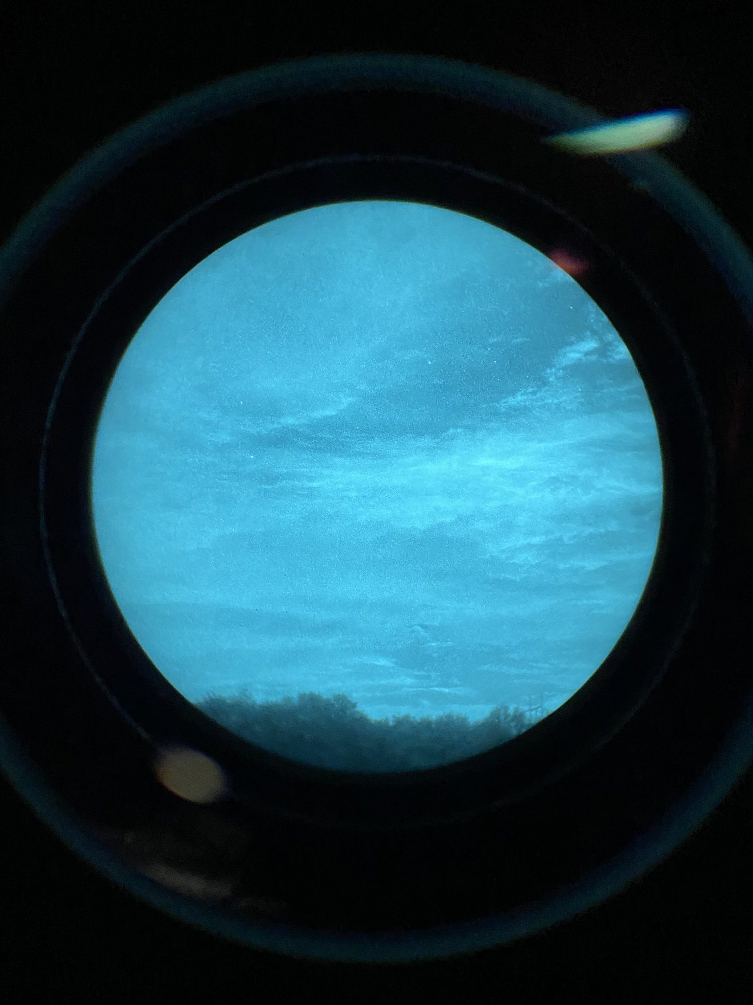

    Exactly correct, And the L3 is a 29.8 some thing signal to noise.
    The INTENS actually does a pretty good job compared to the echo showing you the details on the dresser.
    However it’s pretty clear that it’s a dresser and the echo shows that very well.
    However, once again the echo is definitely darker and has a fairly significantly higher signal to noise ratio if apples to apples were being compared. Unfortunately every single manufacture of tubes uses their own definition of signal to noise as opposed to using dB for example...
    still the echo does a pretty good job when you compare the pictures I just posted. But that’s not a dark dark environment....
    Interesting about the high light mitigation. In the above photos, it appears to be a fair bit of ambient light and the Echo image looks much sharper and cleaner than the L3.
    Especially when you look at the leaves of the trees furthest out. The Echo image shows a much cleaner defined leaf image than the L3 unfilmed.
    Both of the tubes are at their maximum gain....
    part of the deal there is at the L3 is noticeably brighter.
    Also the camera is actually doing a one second exposure for each of the tubes so we can see just how good they actually look to the human eye.
    Let me post the instant pictures.

    I'd love to get my hands on an Intens one day to check it out. It's the details on the dresser I was using as an example similar to looking at objects against a mixed vegetation outdoor environment in low light. It's the ability to distinguish the small details against each other that stands out.
    I like your backyard picture comparisons but that is a fairly well lit environment.
    Standing behind me is another house that had a single 50 white floodlight pointing in the opposite direction.
    The LED lights on the porch directly in front of me that both tubes pick up are literally barely visible to the naked eye.
    about 300 yards down there was a 30 W bulb on that deck which is what was lighting up the woods back there for these two tubes.
    so while yes there is light, it really isn’t that bright... it’s more so a testament to how good these two tubes are.

    L3 unfilmed,photonis , older gen 3 green

    Tester images of two lens on ultra low...
    trying to find an Intens to put in a Mod3 bravo for comparison
    It’s funny because both of these are long exposure images and the computar Ir lens seems to cause that blue corrective look
    Reactions: WhereNow&How
    Took these last night with another hide remember playing around with the high spec photonis echo and a couple of L3 unfilm tubes:
    (They are all long exposures but we found with the L3 they stay dark and the photonis got bluer... it seems that the brightness of the L3 tubes had a tendency to not require brightness correction with the camera. The photonis Echo is just not bright enough to prevent that. How are they both took some pretty great pictures.)
    Good pics above. It is tough to take them with a phone looking through them and yours look better. Back of fence line is about 350 yrds and 650 to the light In the background.

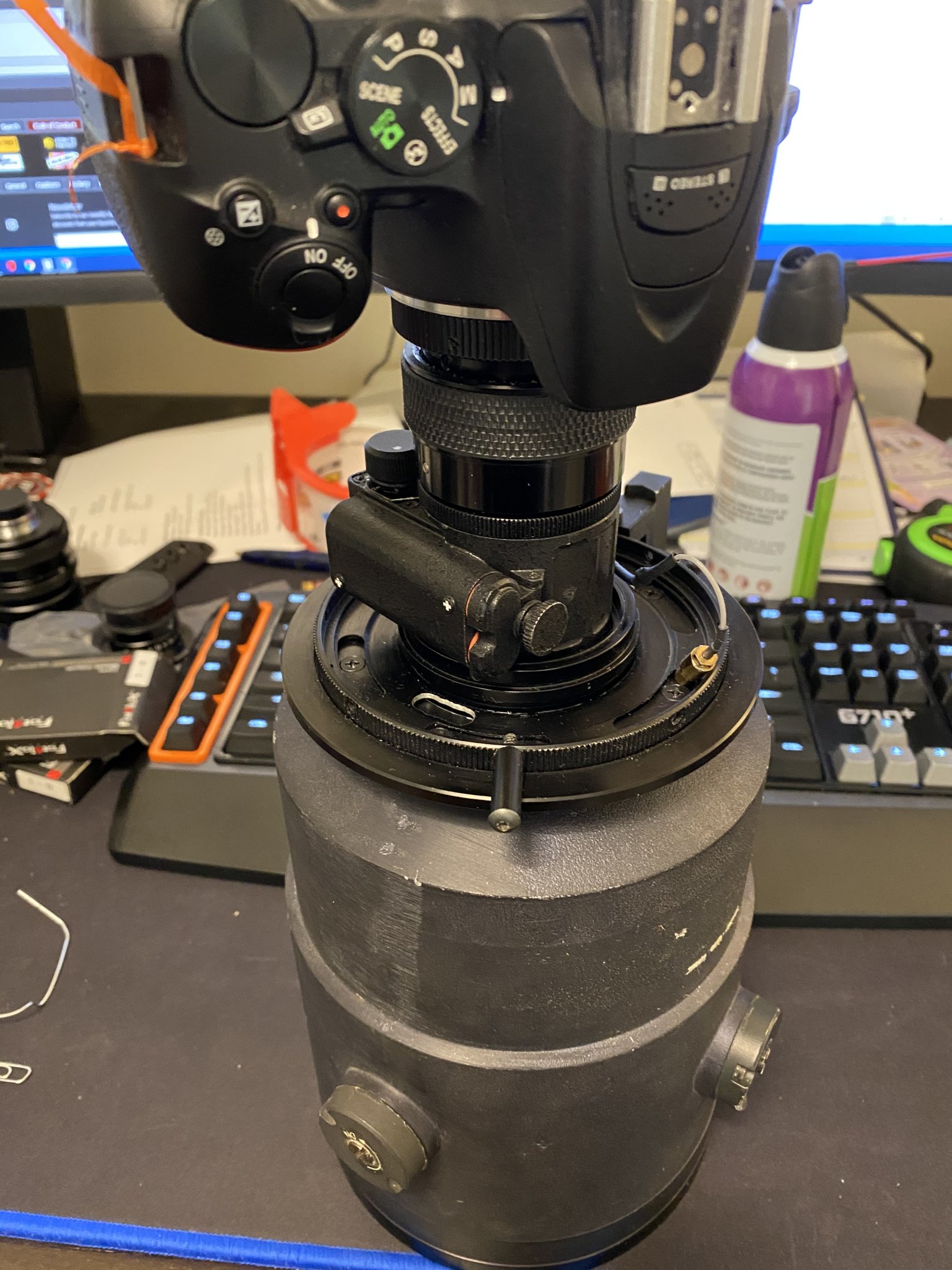

    Computar IR lens... 400-1000nm light wavelength lens.
    A guy from cloudy nights showed everybody a $1500 lens that he was putting on his night vision devices. What was especially interesting was that when he put it on the tester it was surprisingly clean compared to the standard PVS-14 lens.
    I wanted to see if a $300 Japanese version of the same thing would do a better job, and it seems to do a little bit of a better job.
    Problem is that it’s not the same focal length so there’s a slight bit of magnification. But even my really old but super clean unfilmed L3 Commercial aviation tube looks a lot better with that lens
