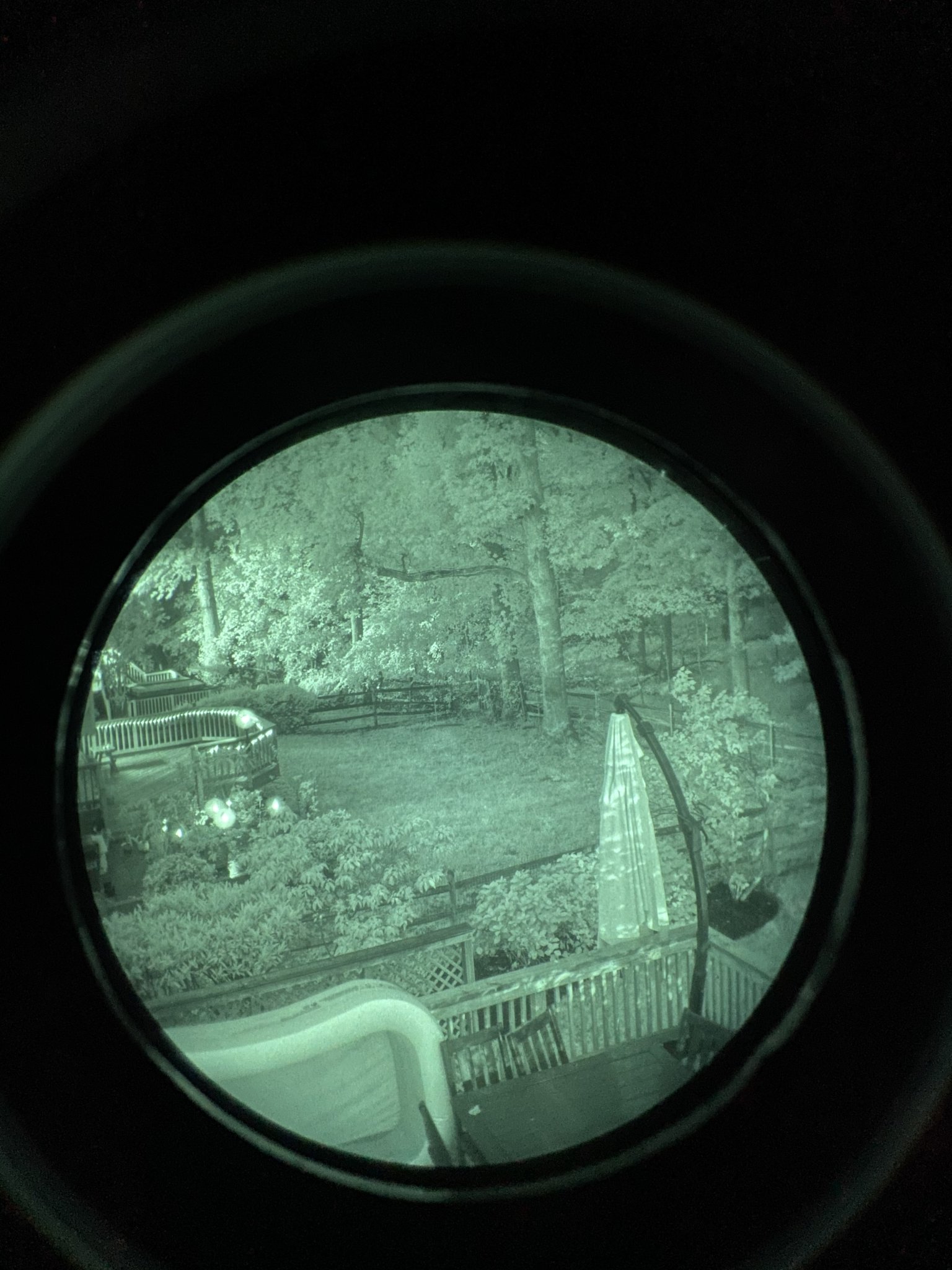

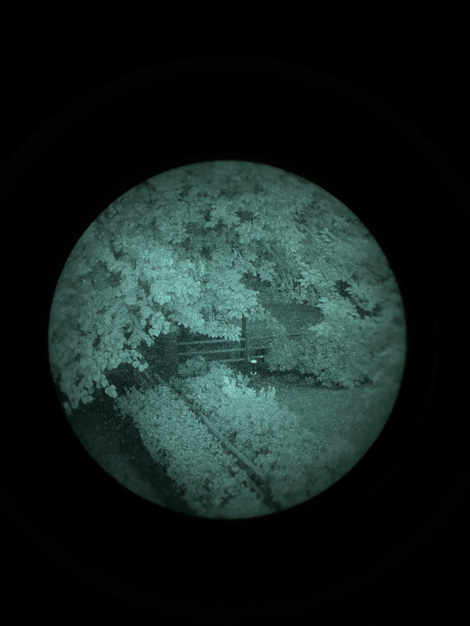

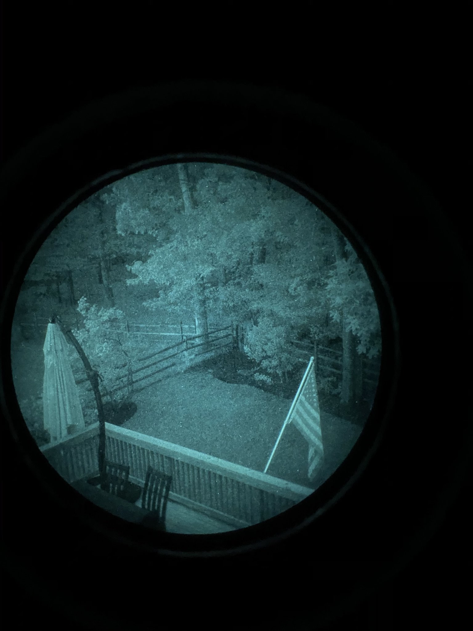

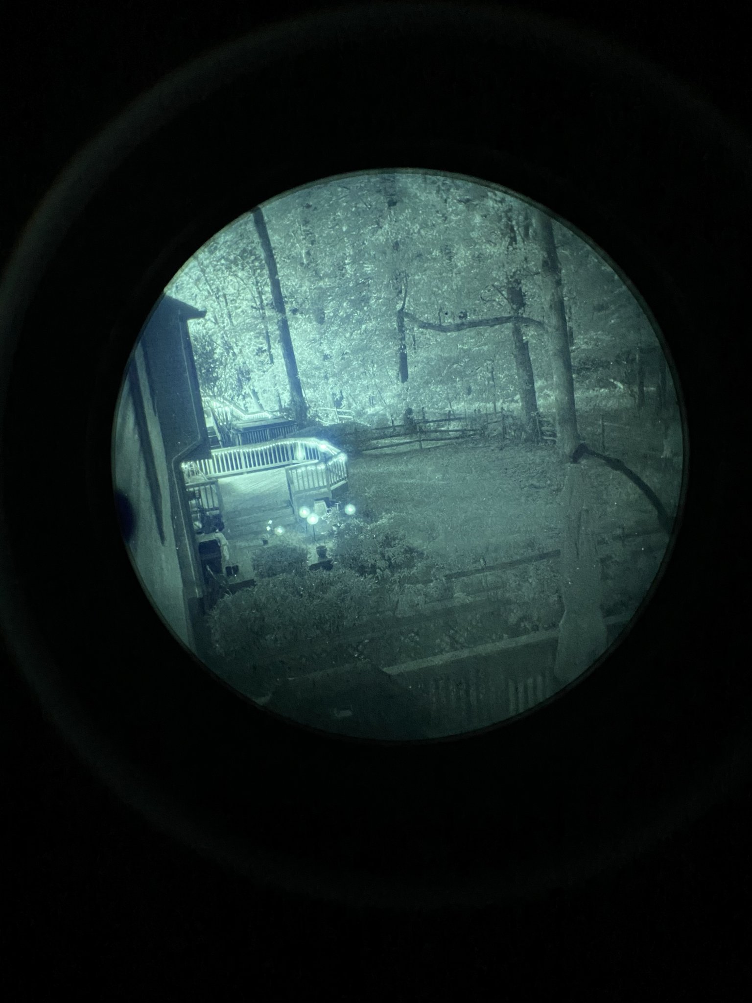

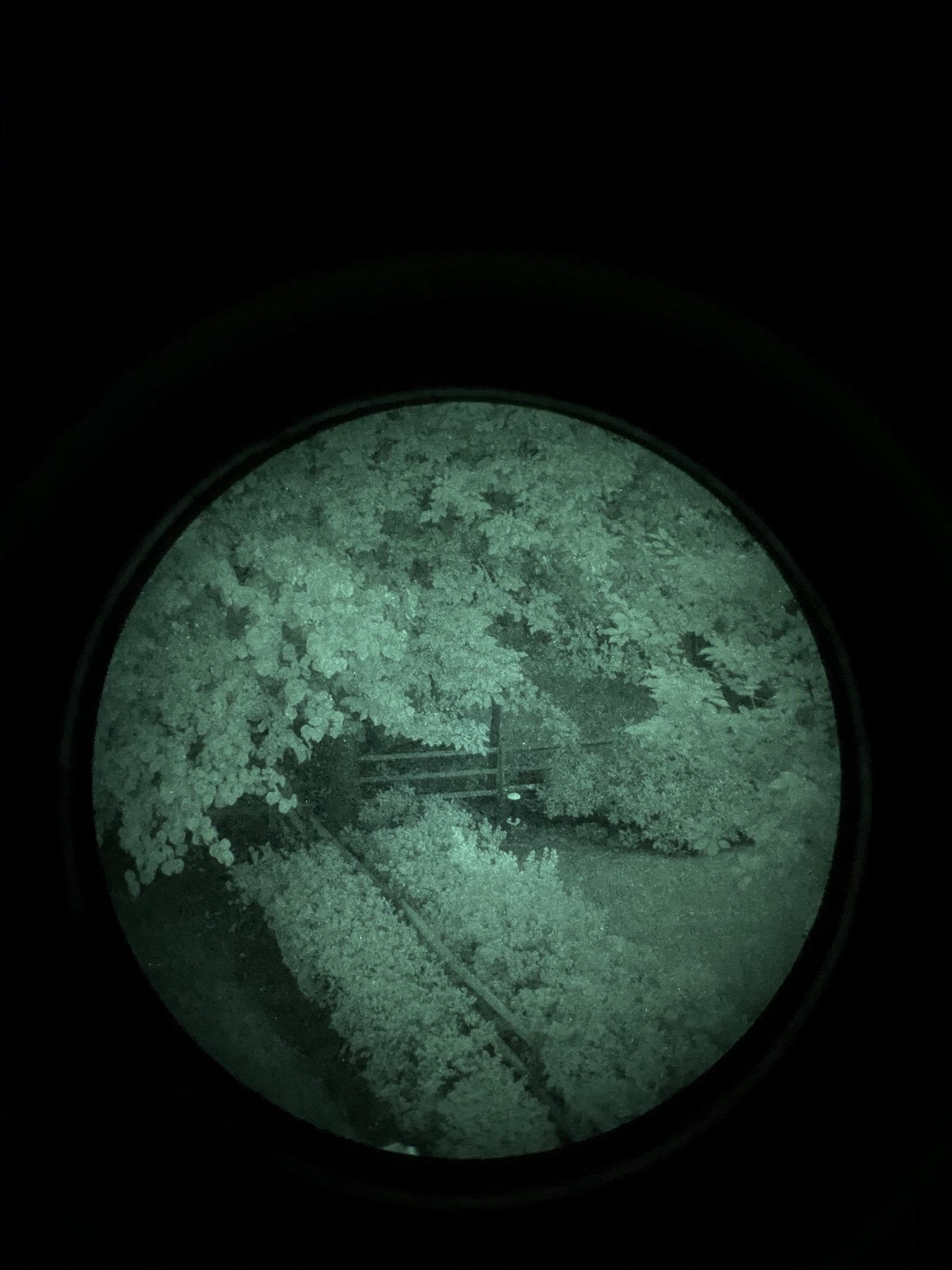

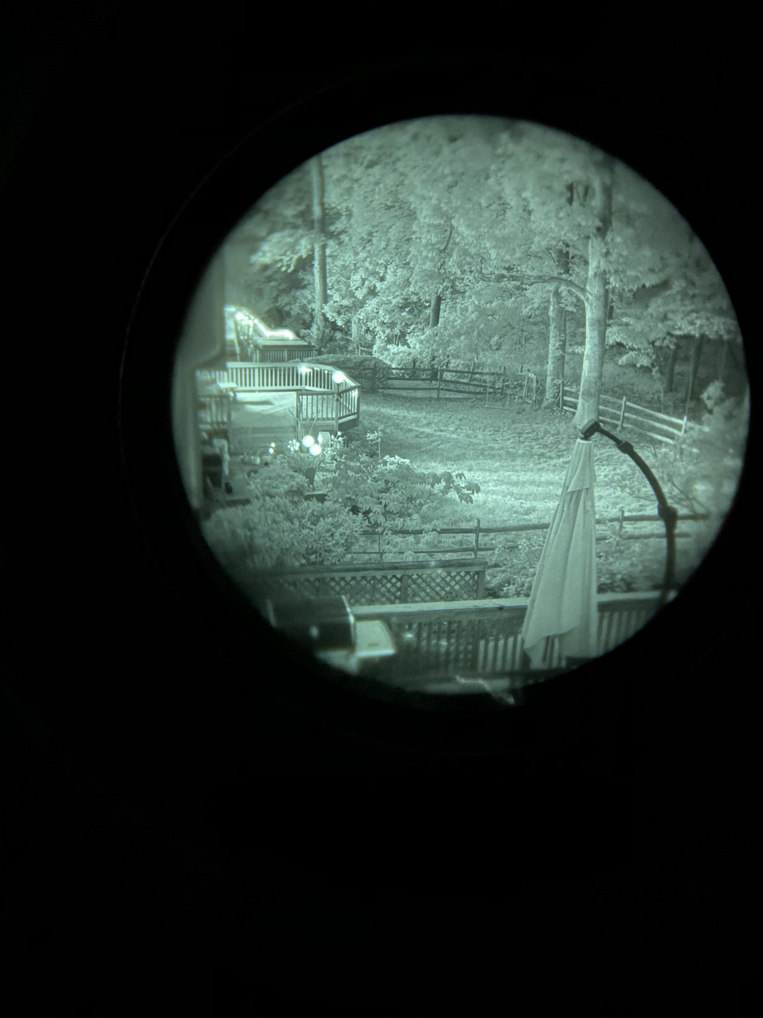

I’ve noticed with my own pictures that sometimes I have a really hard time getting a good picture depending on the amount of light

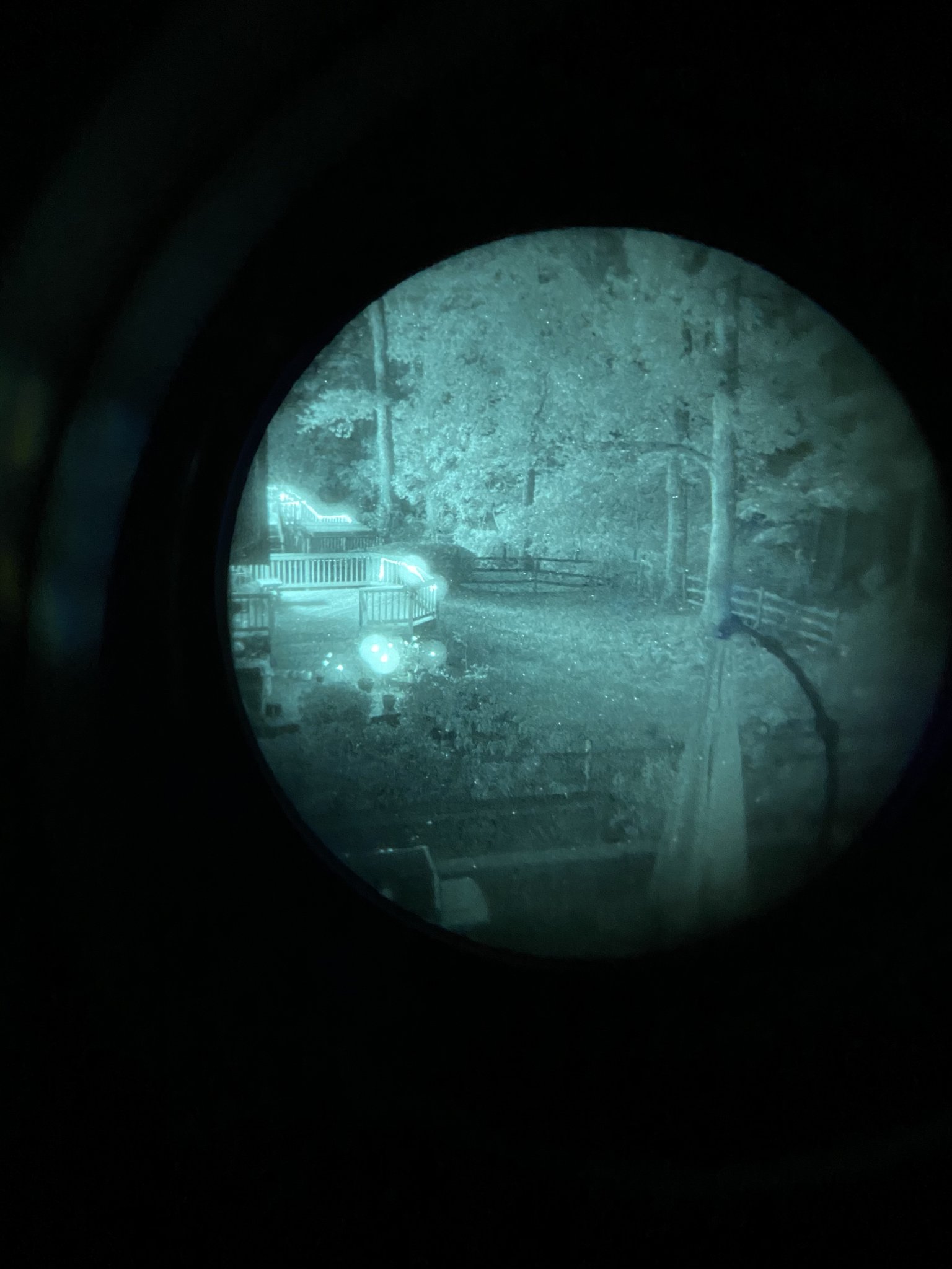

One of the really difficult ones with with the thin filmed Elbit... The EBI in the halo are kind of crappy on that one and it just wouldn’t cleanly focus an image. Plus it was unusually bright, which really played games with the camera
I have a similar issue with the astronomy spec’ed L3 that I have.. But it’s such a cleaner tube that it definitely come through well
And of course the photonis echo is such a high spec tube that it also comes through really clean but just a little bit darker
I have yet to see it unfilmed tube aside from that really old M890 that didn’t have a clean image
Intens (2700 FOM):
L3 39:1
Y
ELBIT 30:1
Echo 36:1
The problem with the pictures above is they were all taken at different times… However you do get a pretty good idea of how good each tube actually looks visually when you try to make the picture larger… They were all taken from the same camera and generally have the same exposure
With the exception of the Elbit, they all look substantially better with the naked eye.
The Elbit was underwelming with it's largish halo and large EBI

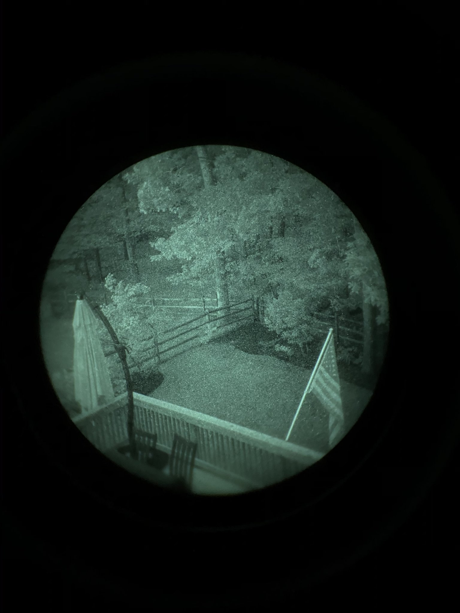

Very dark, Echo, 36:1:
L3,unfilmed, 35:1,
taken at the same time in the same lighting conditions
The echo does tend to be a little bit darker.
All pictures in this series were taken using instant shutter, no extended exposure time
Wow that looks allot more favorable to the photonis than I expected. I'm definatley gonna pick up that intens tube now! I hope they have the 4g+ version also not only the 4g as they are getting it from a supplier and the supplier isn't giving them the option to hand pick a tube.
