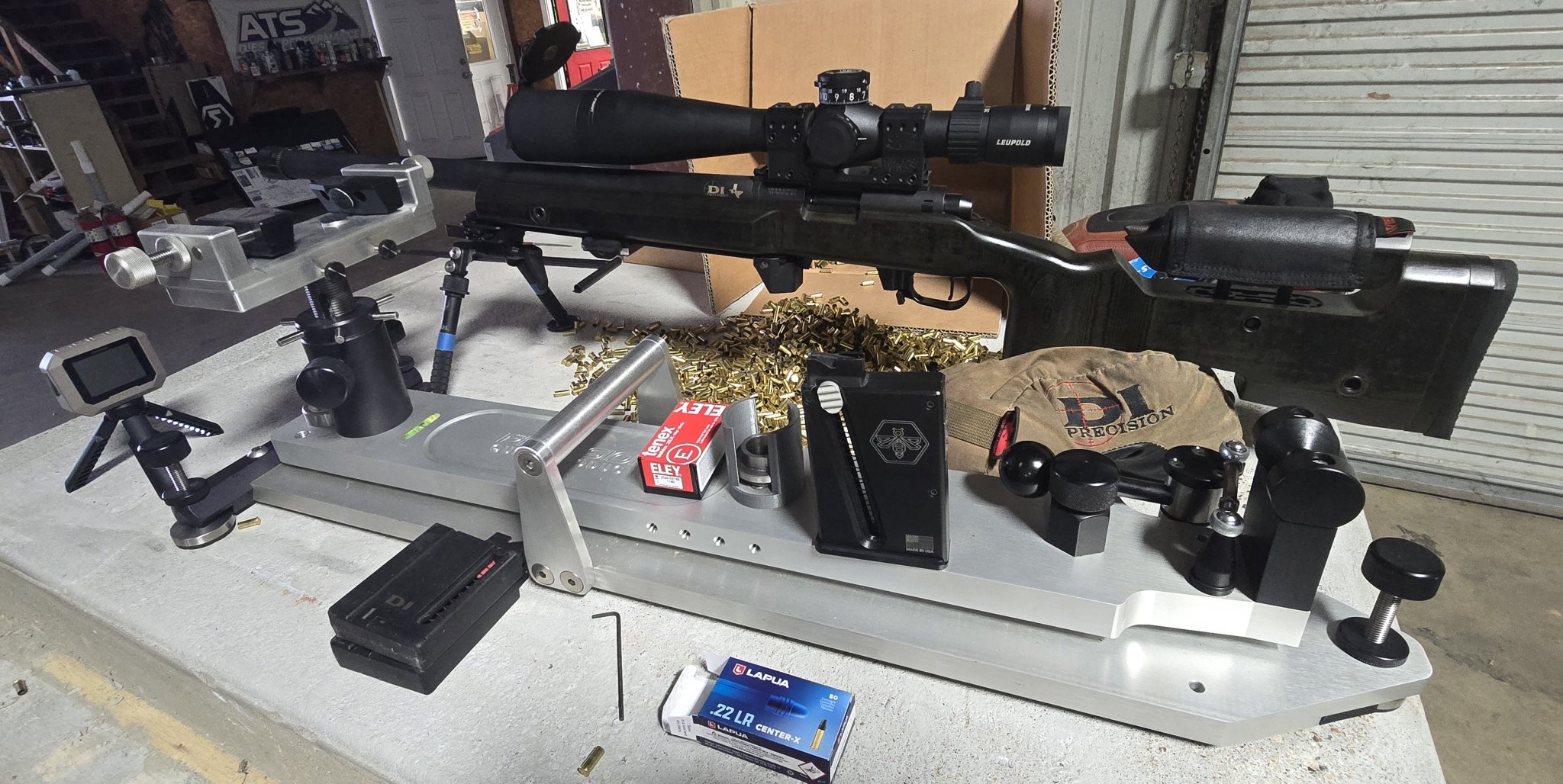

    This is not really a review per se but since I had a lot of testing to do I thought I'd give it a fair shake, Derek Webster ran it in a few matches that ran perfect after adjusting it to his MPA BA comp chassis. When I tried it in my Foundation Centurion originally I had a few issues but today I thought I'd give it a good adjustment and see what it could do. Turns out it works awesome once ajusted correctly but like everything else 700 rimfire we have to "make" a rimfire work in the design of a centerfire rifle so all in all I think it was a great idea that they came up with and absolutely flawless feeding for 300 rounds today.I Actually shot some of the best groups today simply from not worrying about possibly having a feeding issue, strongly recomend them.

    @David Lott Dave that pile of brass looks like a few more than 300 rounds LOL!

    I average one a day with no problems, so the brass piles up
