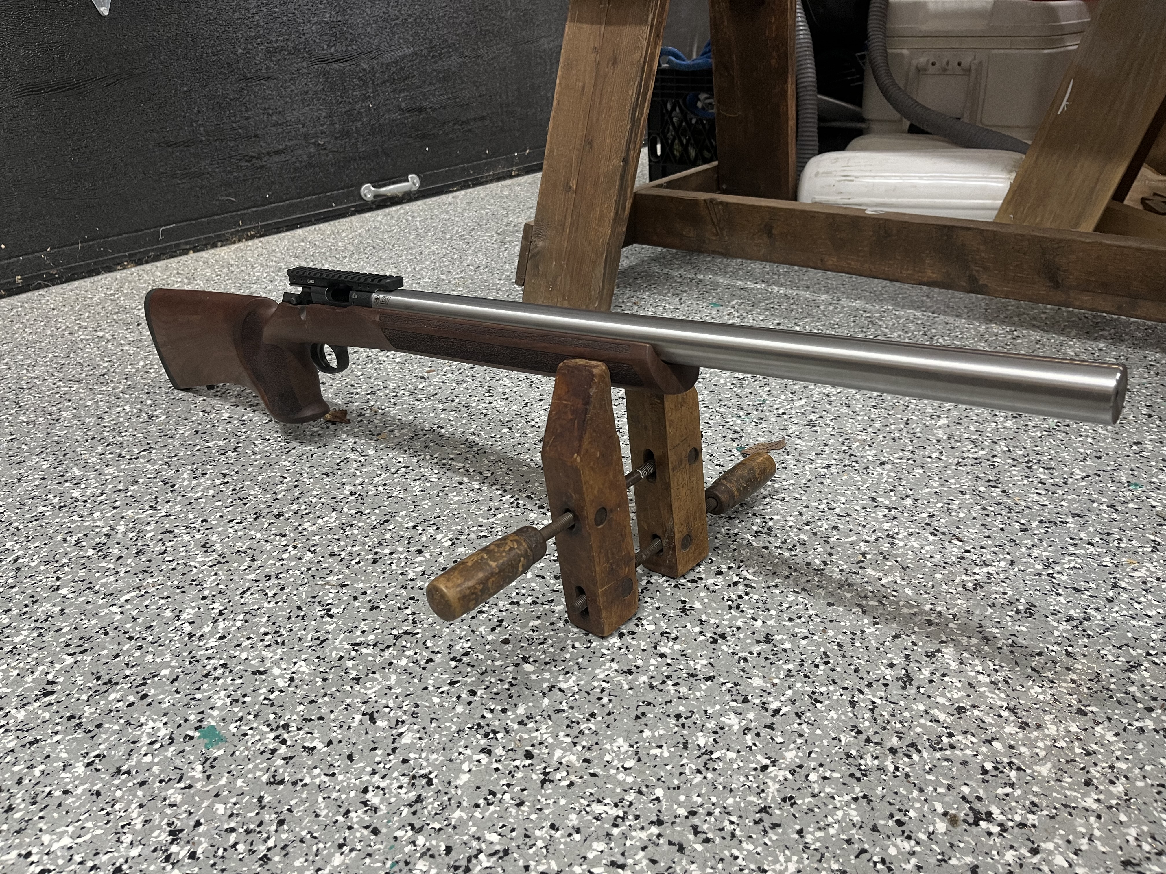

It’s not much work to fit the l3i in a stock if you’re handy with sandpaper and a 30mm pipe. It’s really all about balance, if you’re thinking about trying some prs go for the l3i. The fat barrel weighs 7lbs and looks great too.
It’s not much work to fit the l3i in a stock if you’re handy with sandpaper and a 30mm pipe. It’s really all about balance, if you’re thinking about trying some prs go for the l3i. The fat barrel weighs 7lbs and looks great too.View attachment 8730326
That’s really nice. I didn’t think those would fit the MTR stock without removing a lot of wood.
I think I’m going to have to get me one of those front rests, that looks old school rustic. 🤣
Reactions: JFricke and p5200
The only tricky part is right in front of the action. The barrel sits below the action flat and you need to be careful to preserve the step up, or you can just go ham and pillar bed it afterwards. Markdorman did a nice write up on it somewhere on here.
Reactions: p5200
For that spot in front of the front action screw, you can take a look at the underside of the action and get an idea of how much you have to play with. I’m guessing it is about 1/10” or so. On the stock, I would put a piece of painters tape that same measurement in front of the front pillar and be careful to not get into that area while sanding. It should be a small step at that point to just clear the barrel from contacting the stock. I’ll try to take a picture later to show what I mean.
