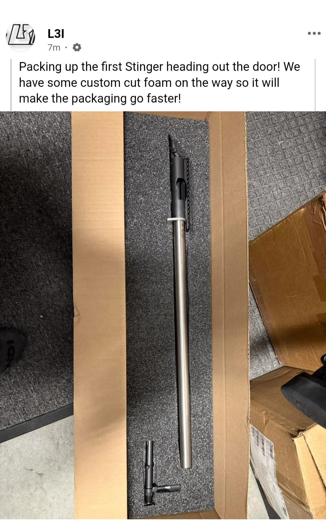

It's officially started!!!!

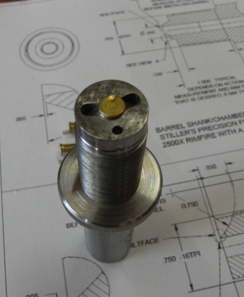

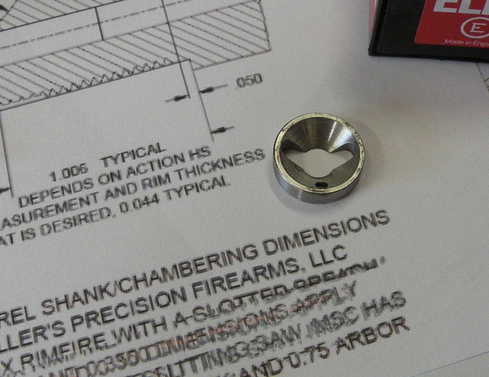

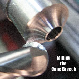

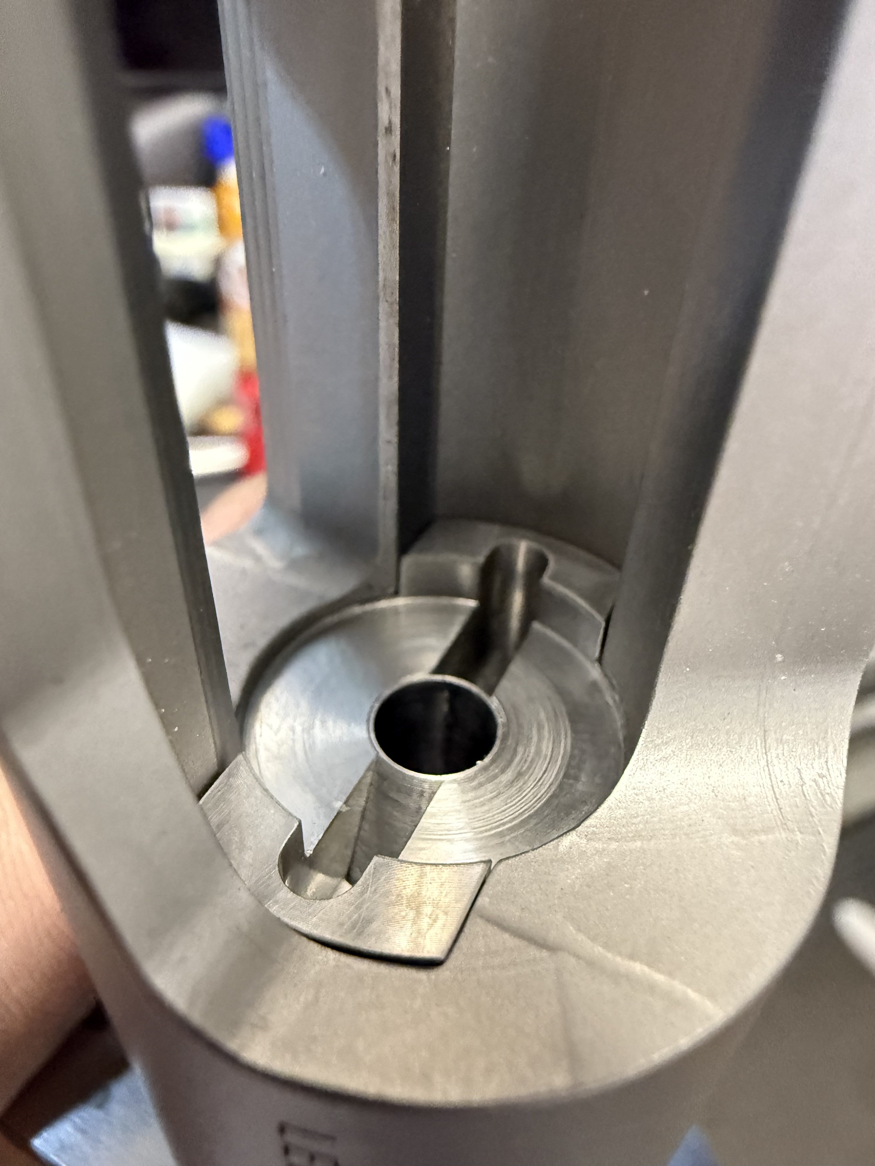

Well given they are using my solution posted here on page two of this thread for tennon insert as core feature of new action its a machined cone protector with cuts for extractors so barrel can utilise a cone breech ,it also enables minor head space adjustment by screwing a barrel in and out a bit, being a Rem40x type action with lug raceways it indexes of those while also centering bolt face. All in all good concept for 40x clone
one more tip while mine and theirs was for simple tapered cone breech , i would recommend trying radiused breech variant so that extractors have better purchase and continue to extract when extractor slots get fouled with wax and gunk.

Sure thing, PM me your info. The spacer idea was fantastic. The lugway indexing was the dual purpose feature we added to keep the bolt nose concentric to the bore while orienting the extraction cuts. We have tested several thousands of rounds and the cone breech has shown no significant signs of wear!

That's a good question. We don't really know how they'll sell since everyone always has a favorite brand they tend to stick with vs trying a new one. If we can keep if for this entire batch we'll know what to expect on the next one. We basically pre built all the components even before we listed them so now it's mainly assembly and testing on each one. I will 100% say we were behind on the boxes lol, so some have gotten them in hand cut foam vs the due cut
