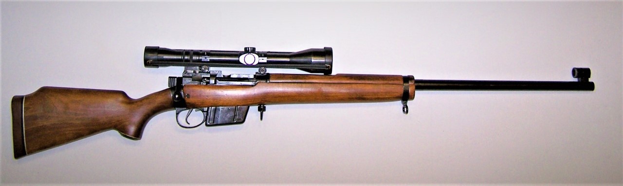

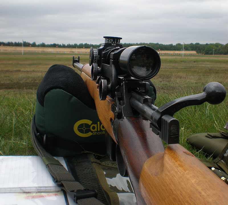

That sounds good. Convincing, stringent. There is a development in load data, oh yes. True.. . Not always simple to analyze... . Caution is the Mother of the porcelain-box, we say ;):)
If reloading is not possible, this Federal GM seems to be the 1th choice of many shooters.. . An often available round, by the way.

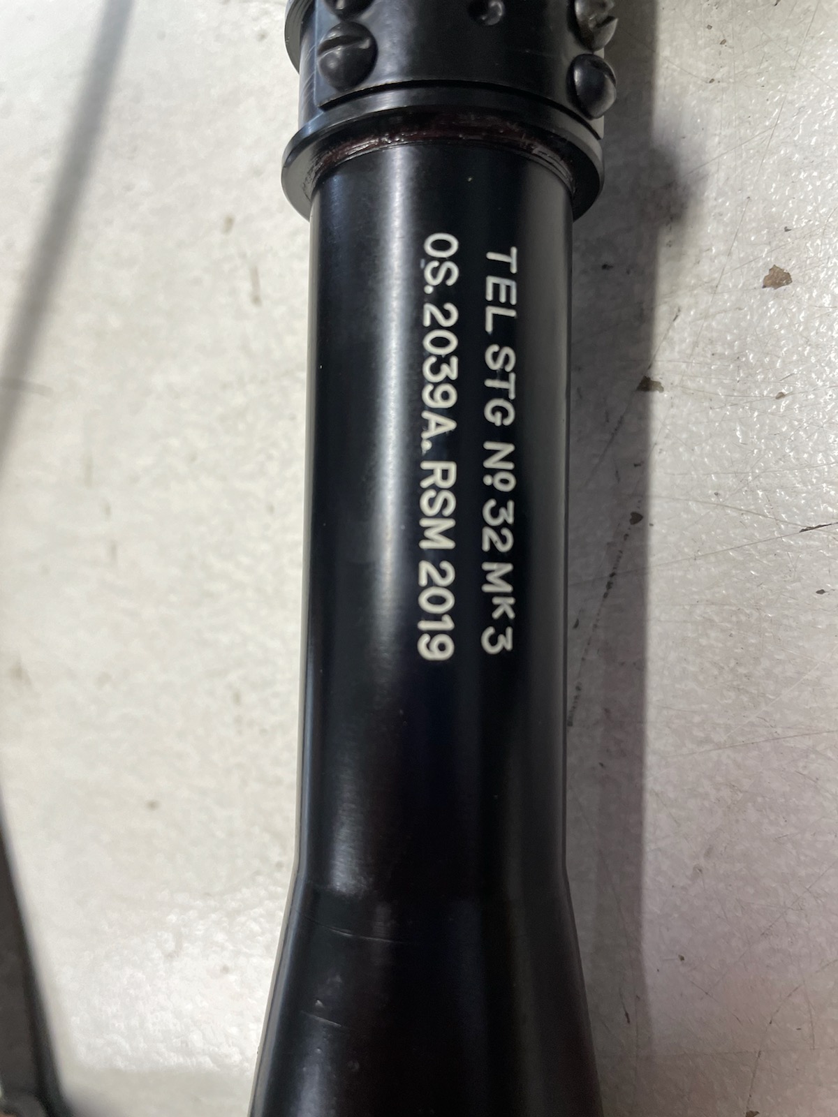

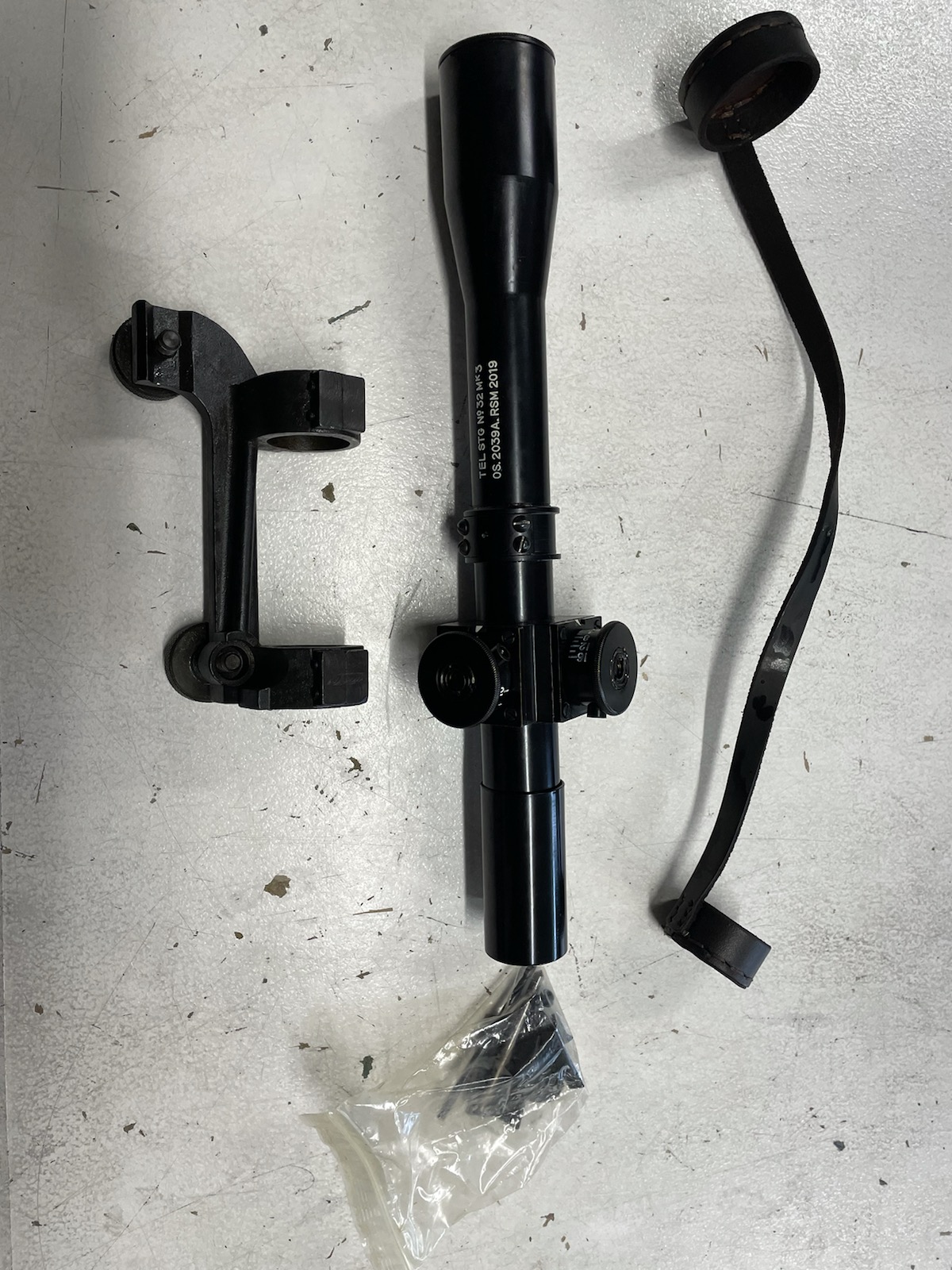

Which scope/which reticle and type of mount is it, please ?
That's with the RSM replica scope and mounts.
Surprised me, and my mate.
I've been working up to that group, put about 70 rounds through my L42A1 clone to get to that, with a handload.
Very happy with it.

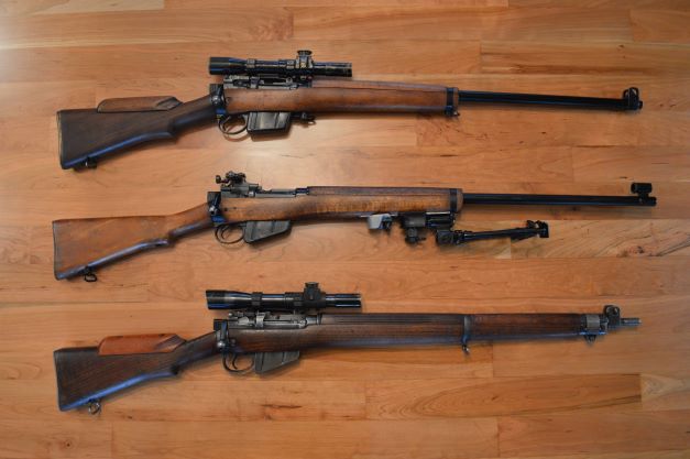

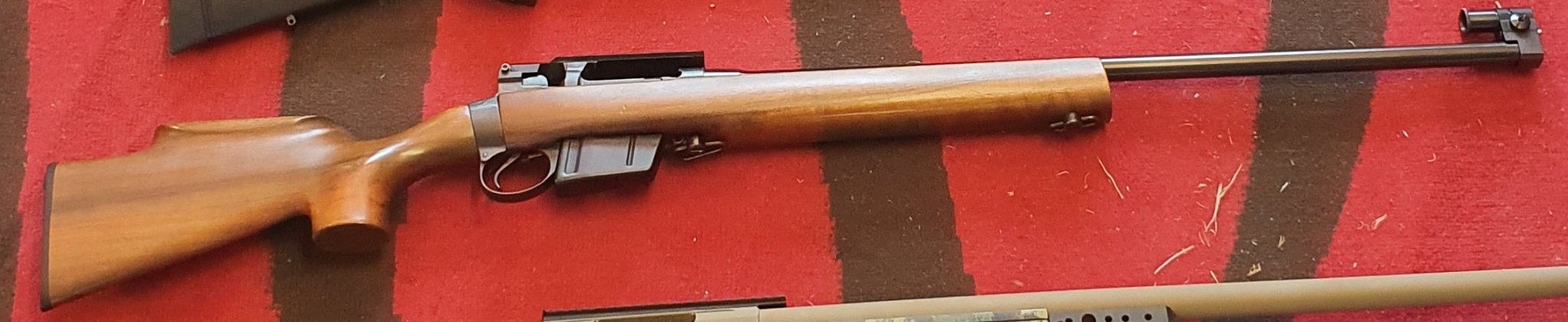

Do you know the Enfield L42 A1 or Enforcer-Rifles then, I suppose ?
