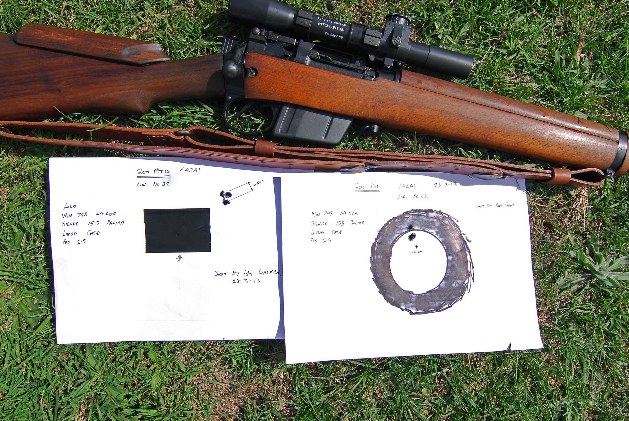

If you reload for an L42a1 can i suggest looking at 4064? I have a replica fitted with dimensionally similar Sportco produced barrel and a Mark 3 scope. The previous owner tried Win748 and 4064 / 2208, with a 155 grain Sierra Palma i regularly see sub 1 inch groups at 100 meters. Incidentally the previous owner has a genuine L42a1, it has a definite preference for Win 748.

Thanks, Rock Chucker. That sounds really interesting. Because I can't remember such a handload-info before.. I saw some of them.. .
Is a pic from your replica possible ?

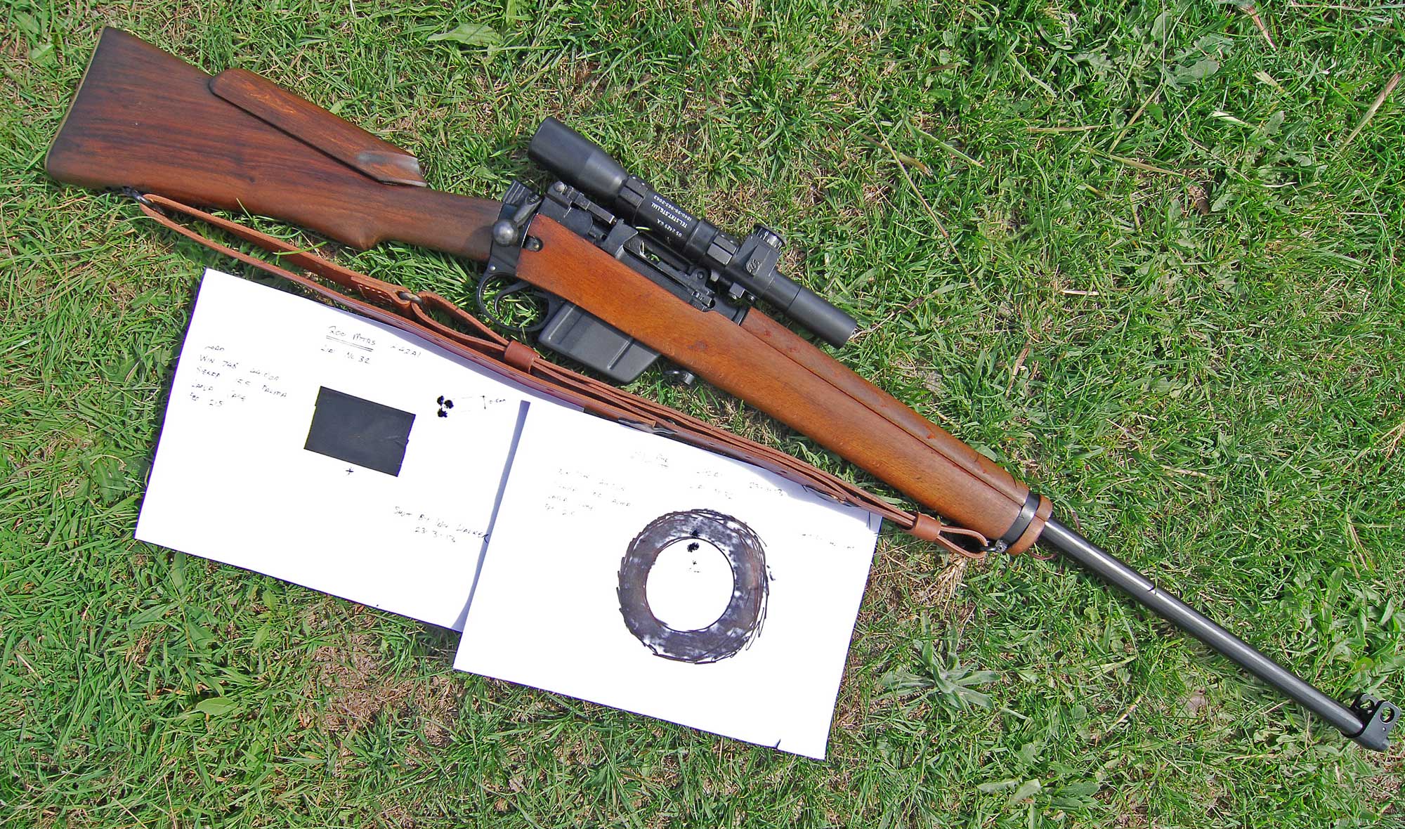

I just checked in this morning will post a photo of the L42A1 replica shortly, the load i use is mild at 42.5 grains of 4064 with the 155 Sierra. I dont like running heavy loads on any rear locking Enfield action. I figure the 155 is close to the original Radway Green load of 144 grains if my memory serves me. I also built up an M24 Replica on a long action and in that i run 4064 and the Sierra 175 BTHP @ 41.7 grains

From Memory as tested with Lab Radar it ran roughly 2730 with very low Standard Deviation at 11. I set up a Lee Classic to drop 2208 / 4064 to 42.5 grains over using my RCBS Charge Master. Cases were American Eagle (Lake City) 7.62 new brass. I will find the photo I took at the range whilst testing, I am very happy with the results considering the 3 piece stock and 3 power scope
