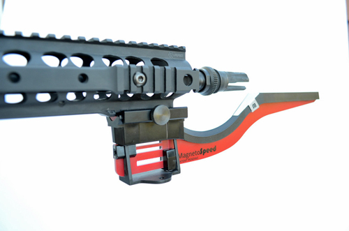

Masterpiece arms has come out with an adapter that attaches to the spigot mount on there chassis so the magnetospeed doesn't contact the barrel.
it looks pretty cool. I've seen a few guys make there own as well
