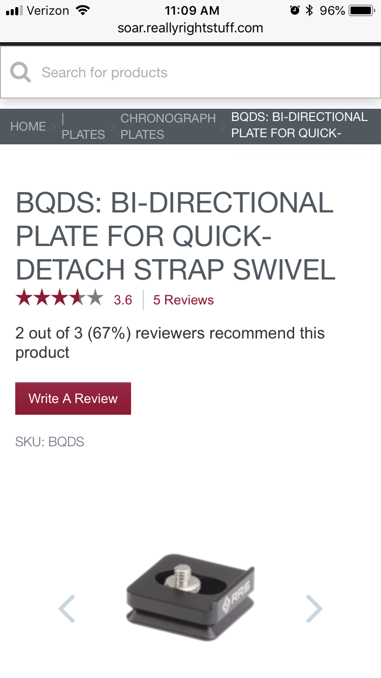

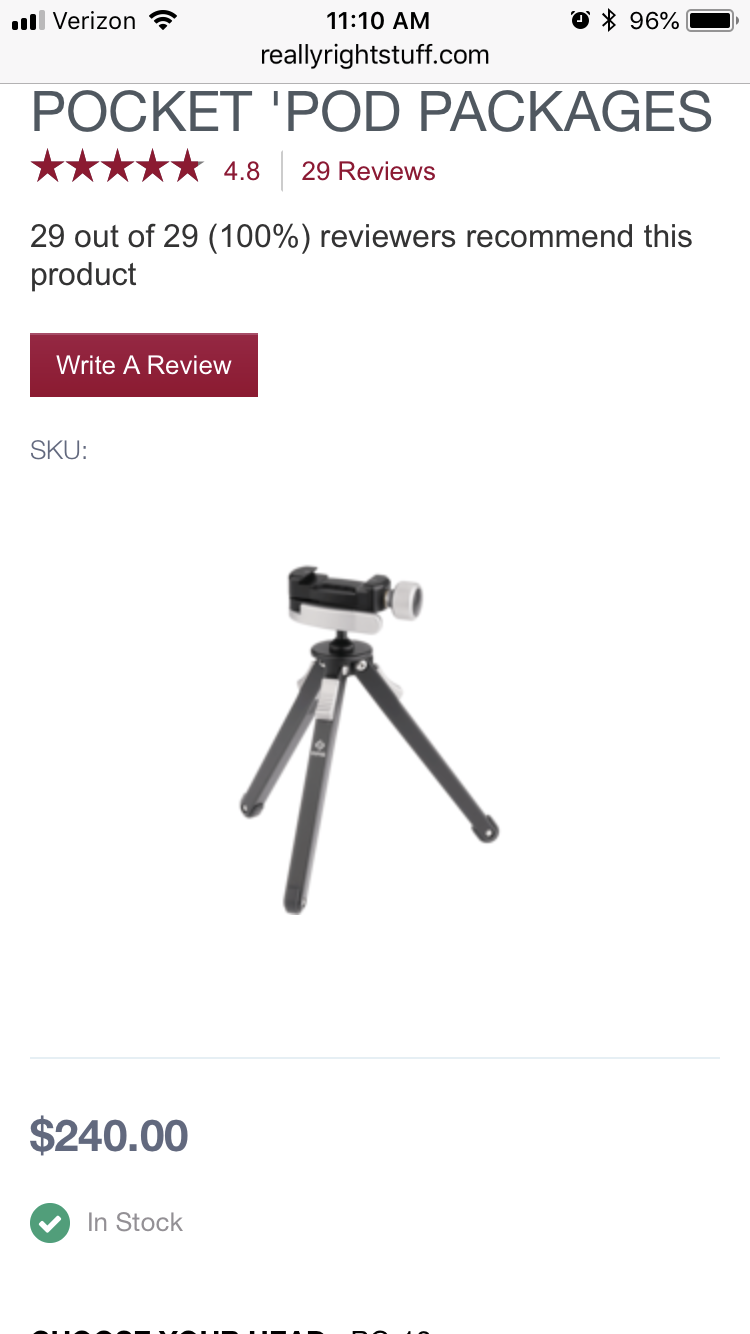

Go to rrssoar.com, go to the plates section, chronograph sub-section on the website and there is a anti-twist plate that works awesome with the Labradar. You can pair it with a TFA-Ultra and BC-18 ballhead and it’s pretty awesome.
http://www.reallyrightstuff.com/Pocket-Pod-Packages?quantity=1&custcol34=1&custcol35=12
Reactions: thestacche
It should. I believe the ballhead that comes with the stand package has a screw knob clamp that closes on RRS Dovetail and acraswiss style plates. The plate also has a flush mount under it so you can carry it with a sling.
