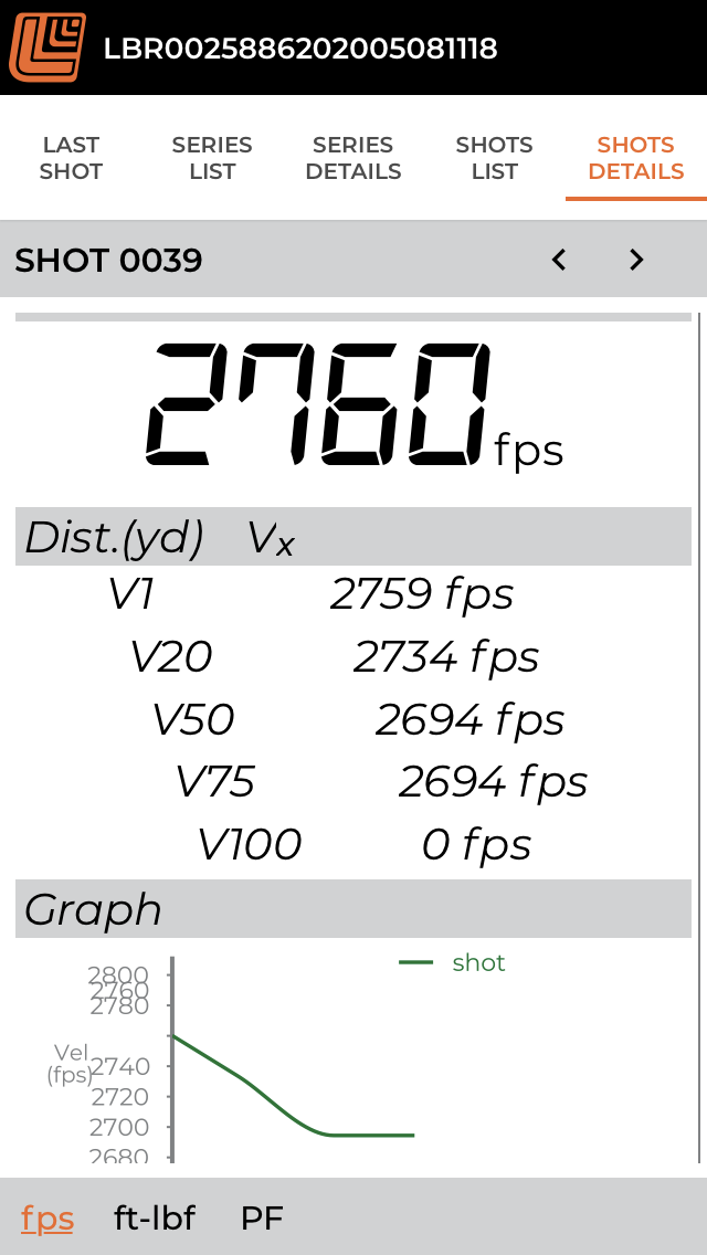

I think i found a bug in their latest software: One out of 45 shots gave me this graph, which is clearly wrong:
V50 and V75 values are identical.
