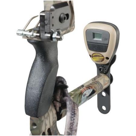

Similar in concept to the "Arrowspeed RADARChron."
