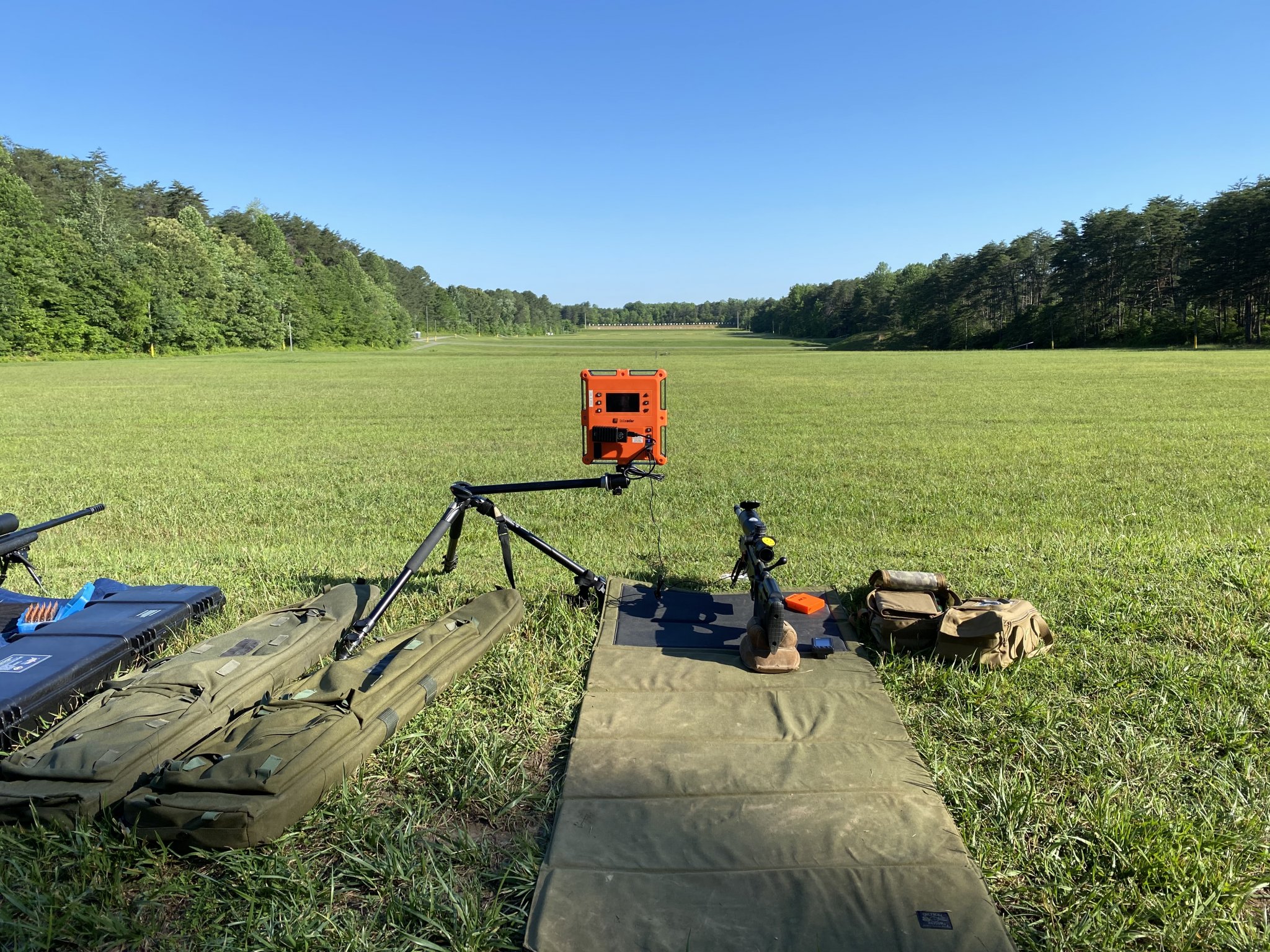

Labradar has released a new unit, the Labradar Lite, which does not have the Bluetooth capabilities. From what I have read the Bluetooth chips have been the hold up. This allows them to get product out.
For you guys that have the Labradar units how important is having the Bluetooth connectivity?
Mine just arrived today. There were no Bluetooth units available at time of ordering and no one could give a lead time on them.
Even if the Bluetooth units had have been available, I still would have gone with the Lite. As far as I am aware the Lite has 100% the functionality of the full unit, minus the Bluetooth.
I have no need or desire to have the data displayed on the unit infront of me, relayed to another seperate device.
WHEN it works the BT features are great. Much easier to navigate the menus, no disrupting aim when arming/disarming etc.
That being said, I've owned my LabRadar since before the app was available (or Bluetooth even enabled for use). Even then it was a revolutionary leap forward over consumer level optical units.
If the choice was a Lite or no LabRadar, I'd absolutely take the Lite.

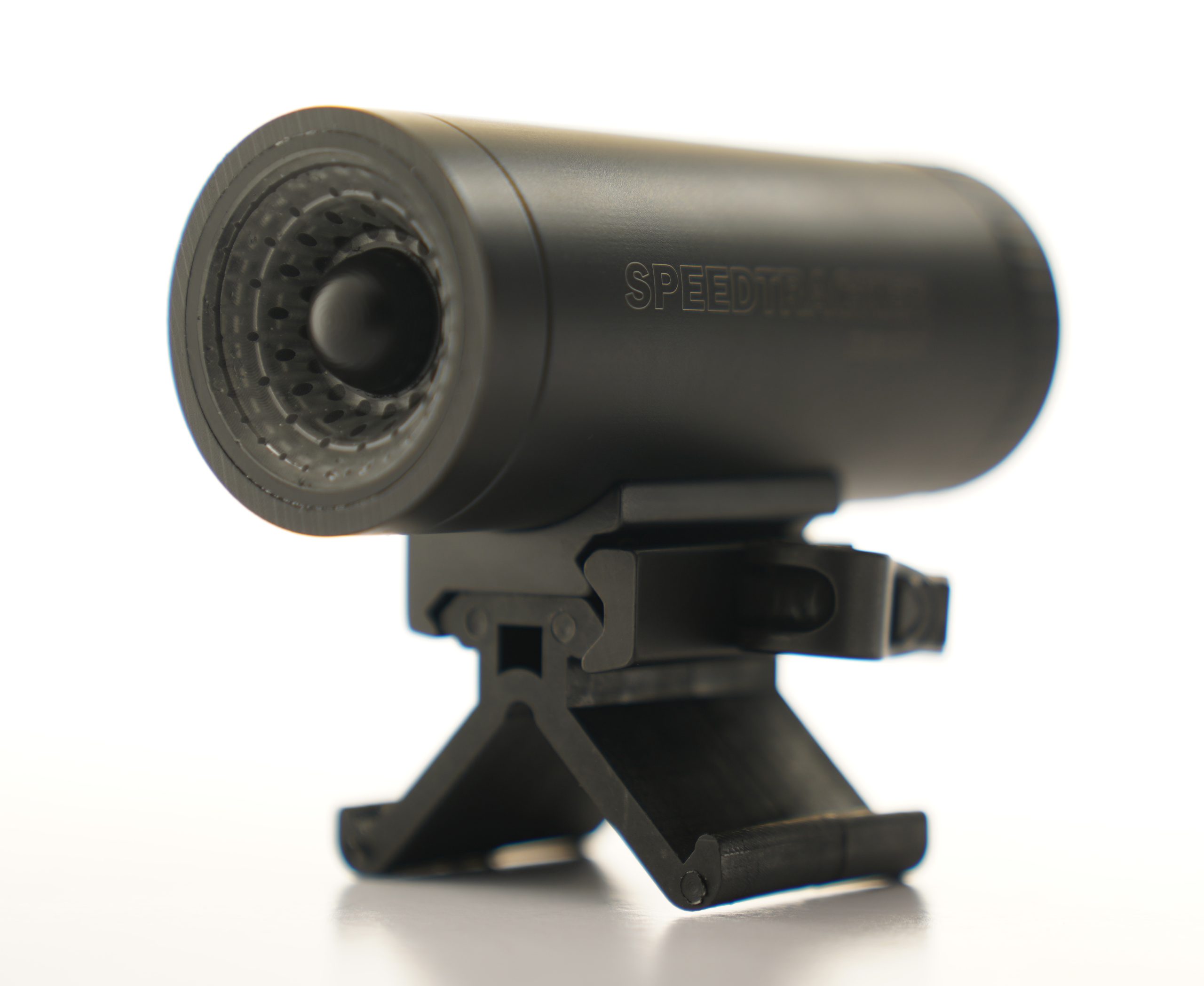

Put up a video on my experiences with it. It’s good.
Good review. I'll disagree on the title though. It's a MagnetoSpeed killer not a LabRadar killer.
The only spot it loses to both on is the price though.
When it tracks to 100+ yards then we can claim LabRadar killer. Given how David Tubb uses a MagnetoSpeed this fills that niche in a much more compact package, the only downside in that role is no display and needing a phone/tablet, but that is a minor niggle.

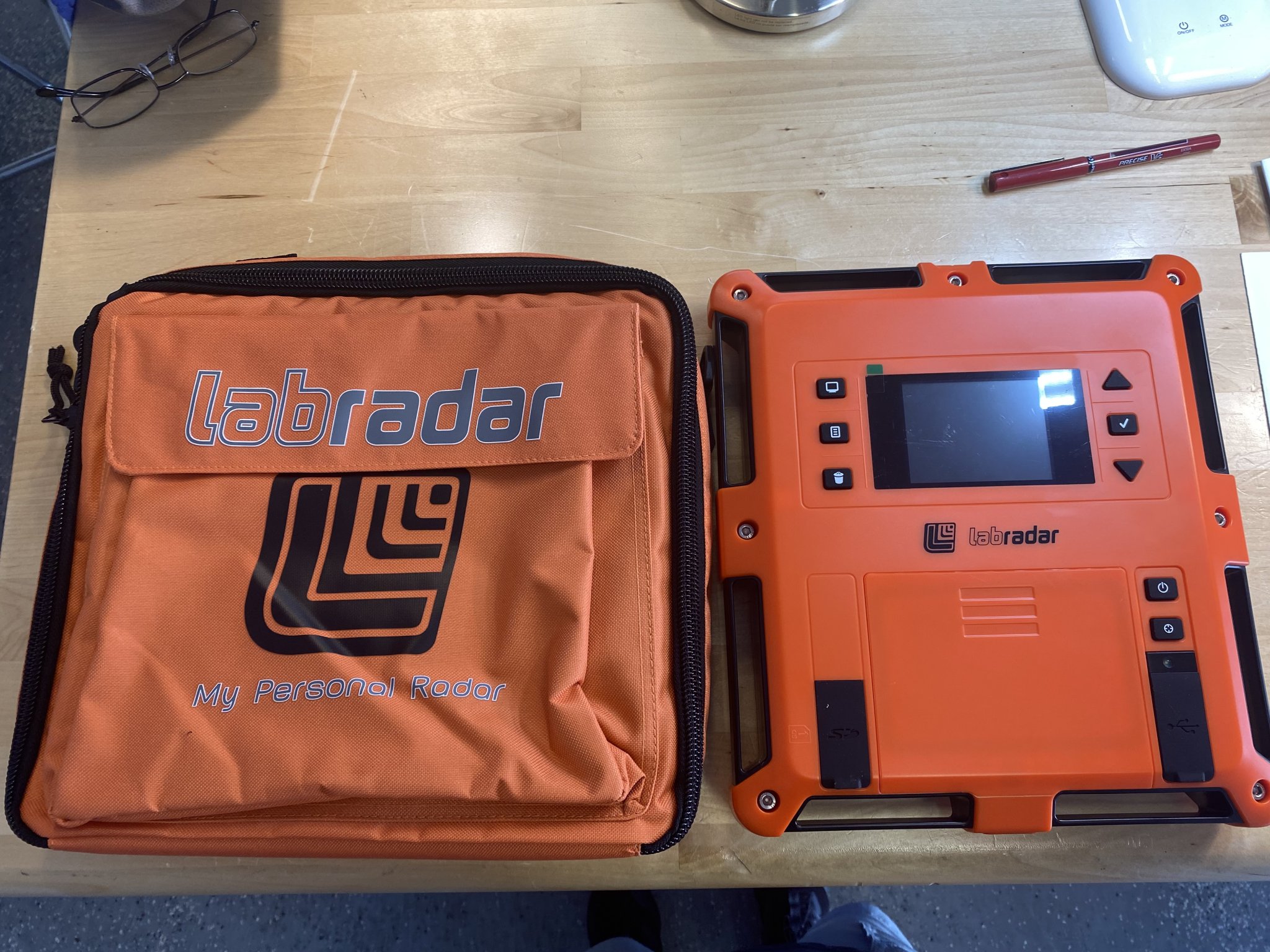

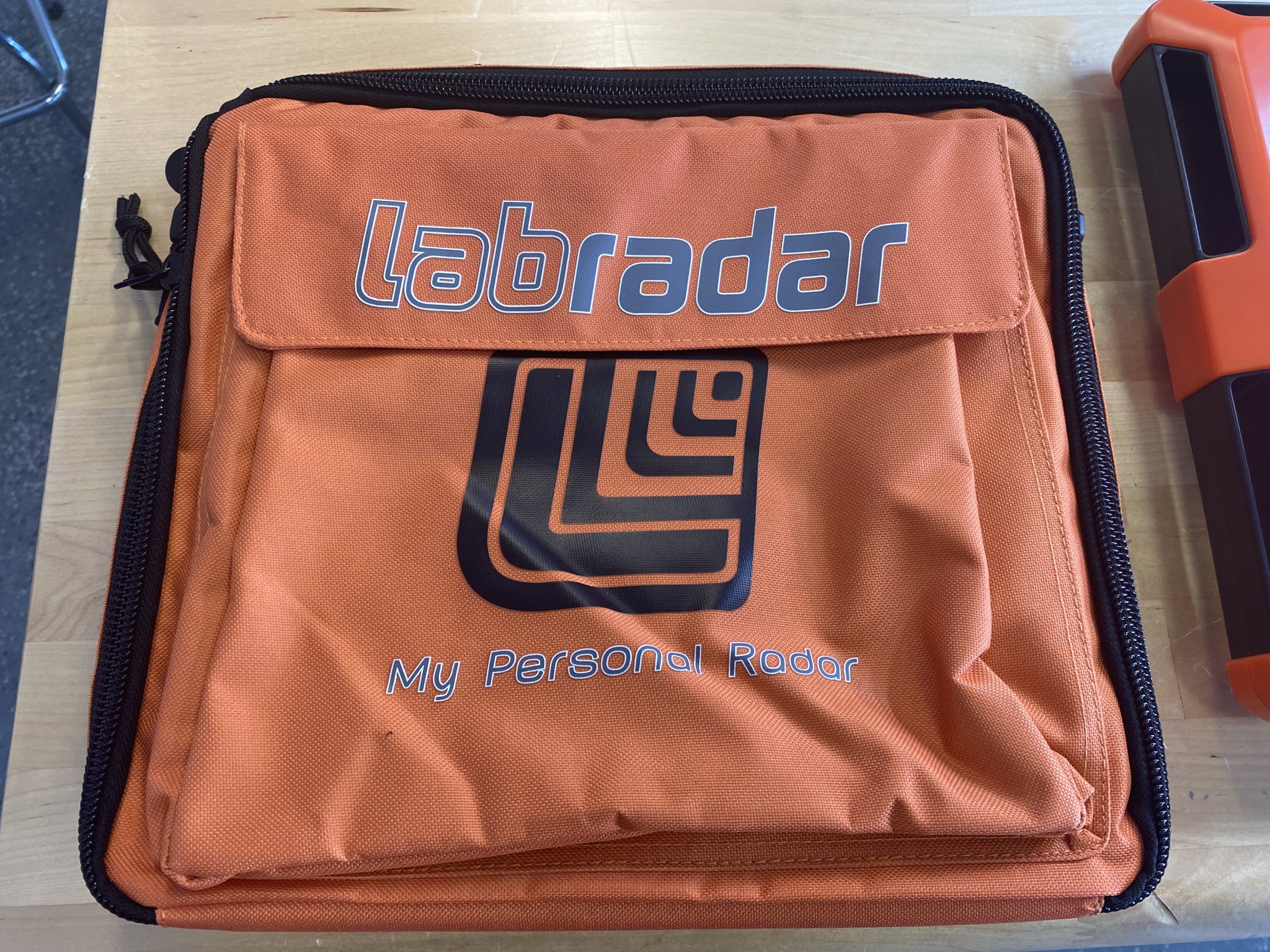

I have the Labradar case, I like it. It is plenty padded for the device and a lot more convenient to lug around than another pelican case. All the accessories (battery, cables, triggers, etc) fit in the front pouch, and the radar will still fit (just barely) even with an Arca base and an MK Machining improved aiming sight attached.
Reactions: parshal and Baron23
Another question - how is Labradar's padded case for it? Good to go or pass and get a pelican case?
Its fine unless you plan to travel on airplanes, etc with it. Far more convenient than a Pelican case. And as noted above, you can fit all the bits and pieces needed in the pouch part also.

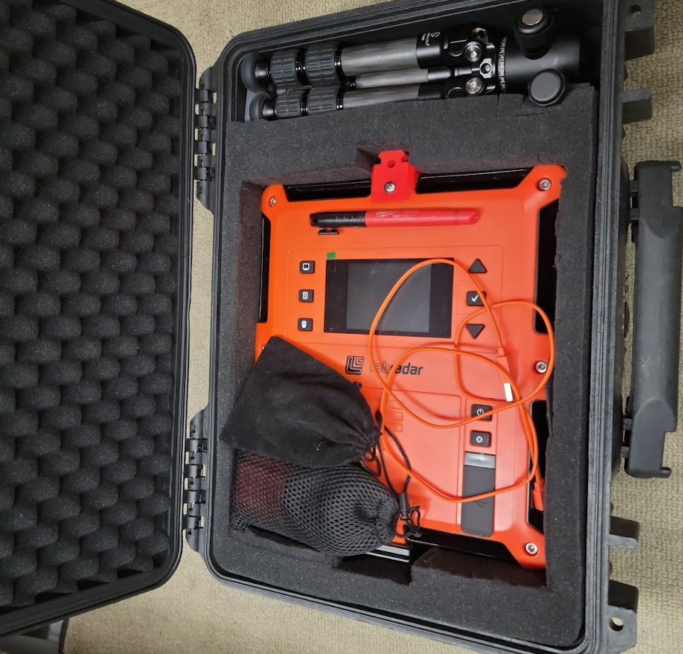

With all the shit we throw in and out of the back of the truck, van, trunk, back seat, bench, etc. the Labradar soft case is a hard pass for me.
$40 amazon special, and it fits like a glove.
I have lots of Pelican cases I could modify for the LR but the simple soft case is fine for me, as I'm not tossing it about in the truck. It has enough room for the LR tripod, battery etc. Have to look Left to not see the Made in China label.
