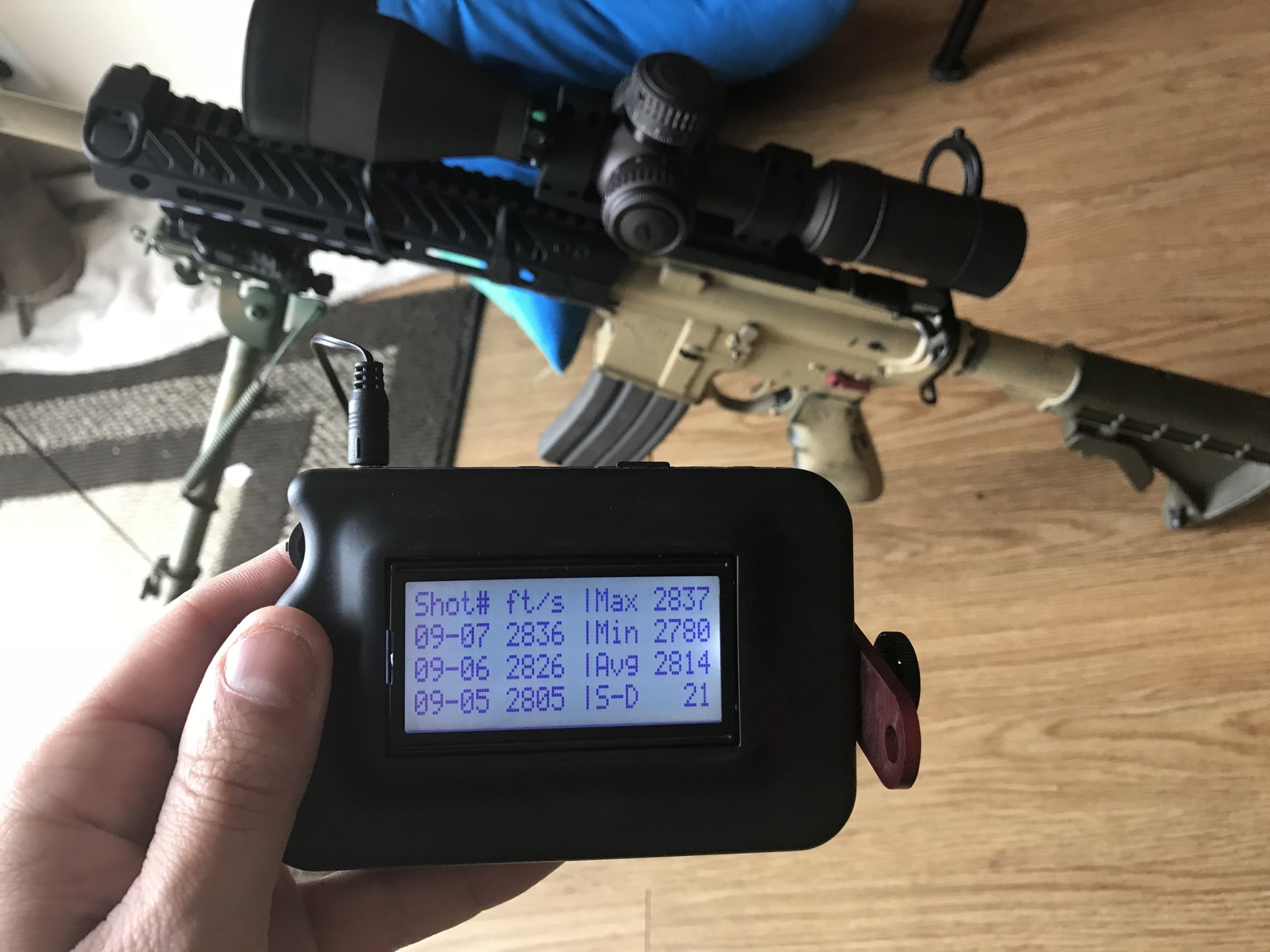

I can only comment on the Magneto Speed chrono. I upgraded from a PACT XP chrono. The PACT was finicky and I was rarely able to shoot when the wind, sun, and cloud cover were all acceptable for the PACT. The set up for the Magneto is no more than two minutes for me. I can attach to barrels or suppressors, no problem. If I want to shoot in lo light, wind, rain, snow, or in zero natural illumination, no problem. The price was right for me and I would recommend the magneto speed to anyone who asks. I have heard good reviews on the lab radar.
