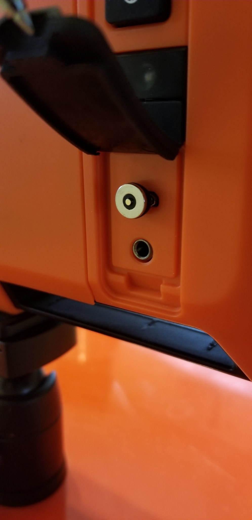

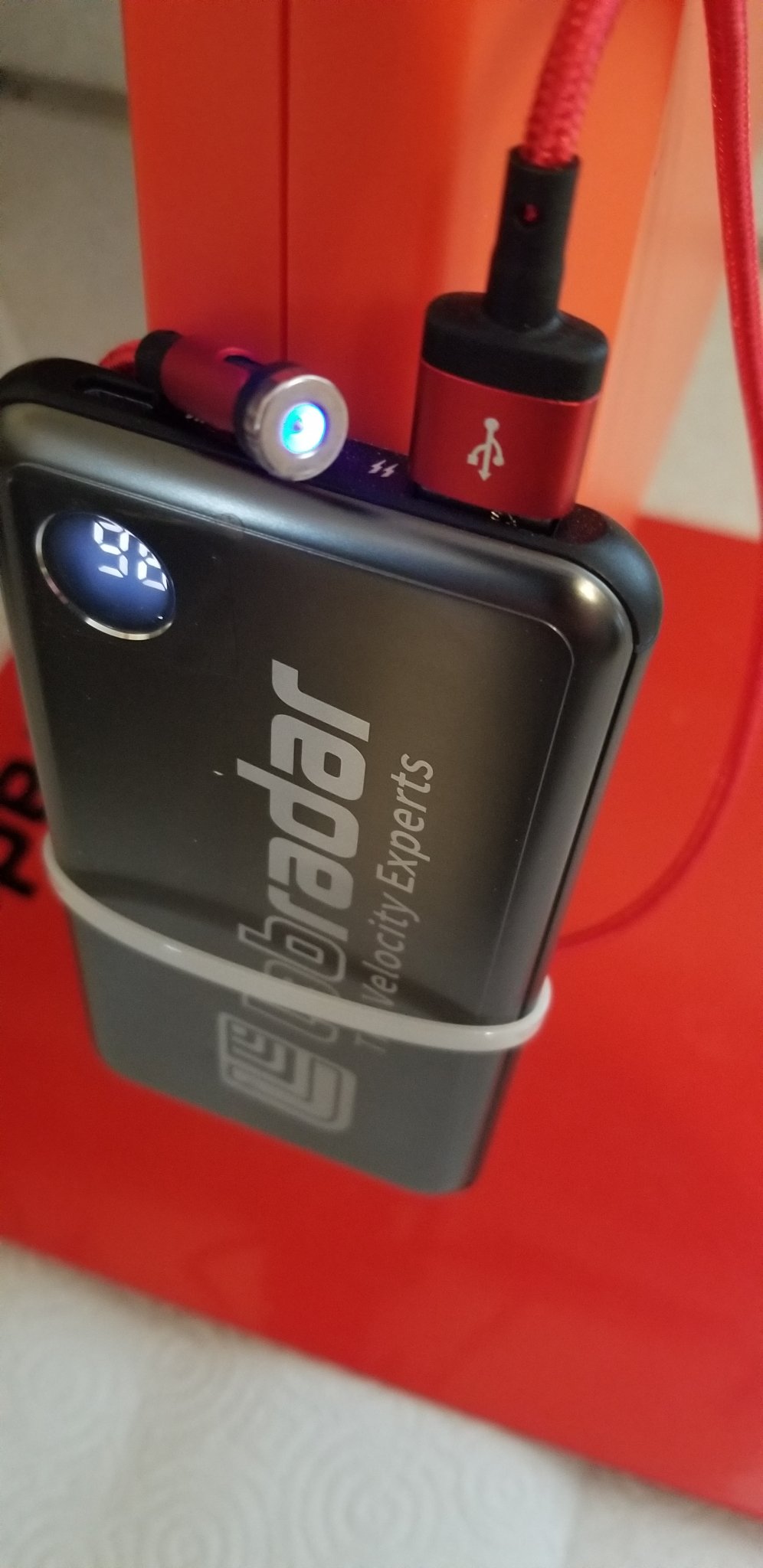

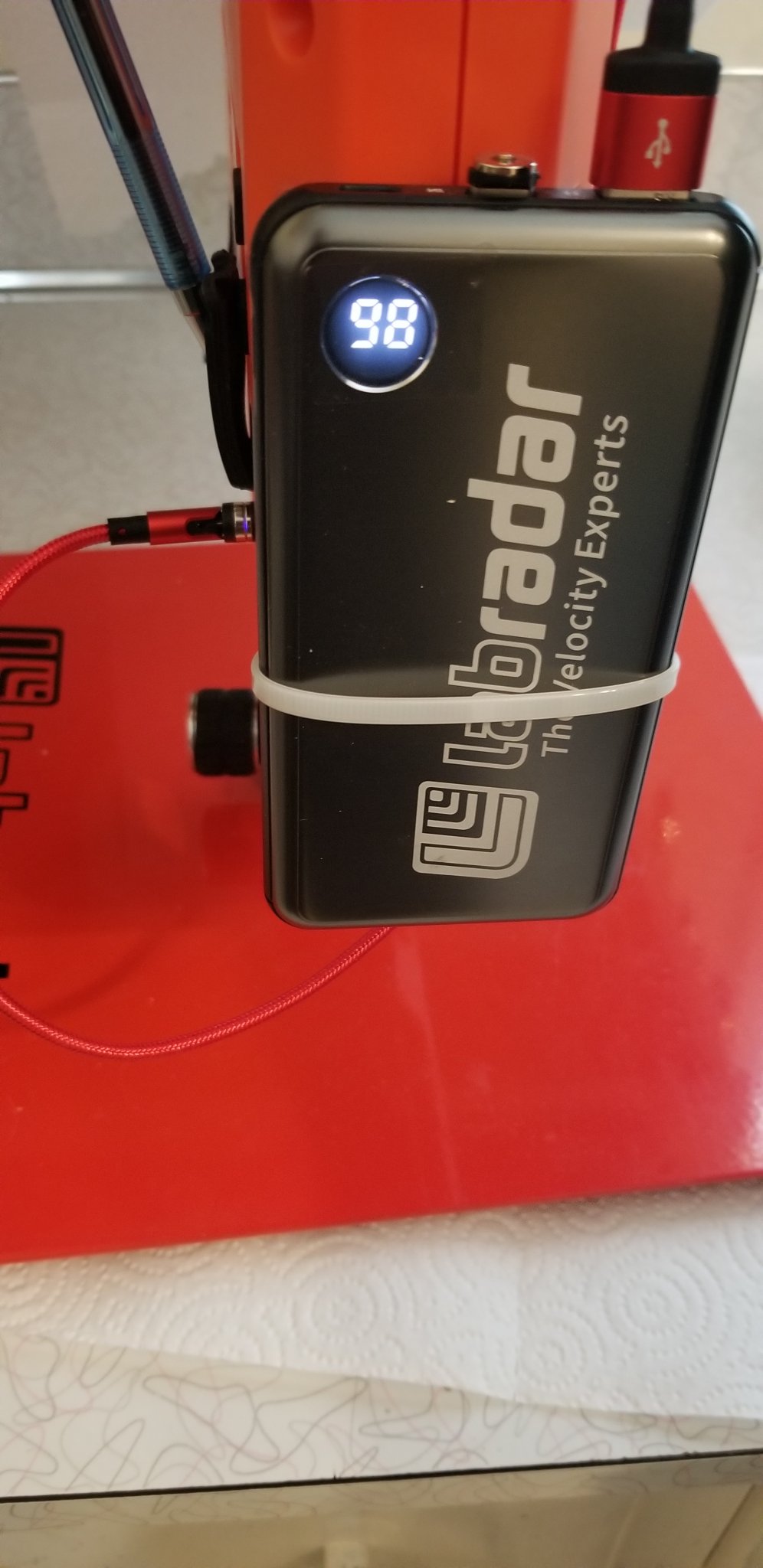

I've found the power port for the external battery on the labradar to be problematic occasionally. I've had mine shutdown and have to move the mini usb a little left or right to power it back up. At some point the connection will probably need to be replaced
Mine did similar to above^^ when using it for archery…seemed like at random times It would trigger on an arrow, it would shut down. Sometimes it would do it 3-5x in a row, but I could always restart or wiggle the plug or change the power settings and it would work eventually.
I can’t remember it ever happening in rifle mode tho, I just switched it back for a rifle a couple weeks ago and it worked fine first try
