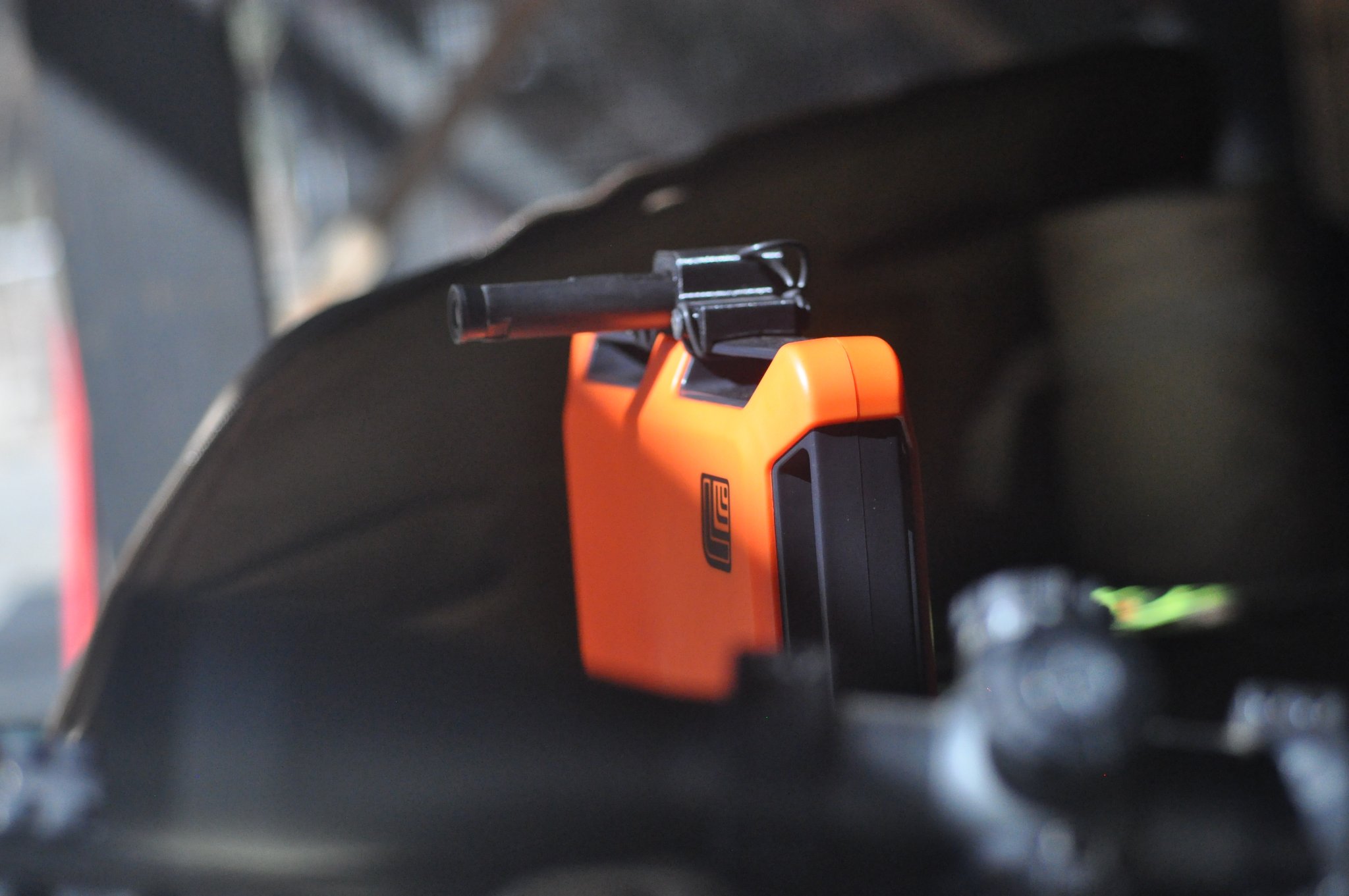

    How are you aiming it? Once I got that part set, it became an easy setup fro me.
    If you have the luxury of an empty range, I’d start with getting it aligned enough to have it track on Doppler mode. Then play around with the trigger settings.

    The message indicating projectile could not be tracked means you're at least getting a trigger. If your sensitivity level and /or rifle-handgun setting is mismatched to the round you're shooting and doesn't trigger, the display just sits there unchanged.
    Most likely, you have an aiming problem. You might try cutting about 3-5" of the barrel of a thin ball-point pin and tape it securely into the aiming notch. Use this to sight your target - step back from it to obtain the smallest target image you can through the barrel. Once you start tracking rounds, pay attention to the return-signal "bar graph" for each round - the more bars you have, the stronger the return - hence an indication of proper aim. With a 6.5CM, I look for all or all but one of the bars to be solid.
    Here are the sensitivity settings that work for me. I use the plate Labradar sells as a mount.
    • 6.5CM, APA "Little B*rd" brake (major side blast): Unit is placed about even with and nearly touching the scope turret to avoid blast. Rifle setting, sensitivity level 3.
    • .223, no brake: unit placed even with muzzle, about 6" to the side. Rifle setting, sensitivity level 1.
    • 9mm pistol or PCC: same as .223 but handgun setting.
    • .22LR: Place the microphone sold as an accessory to the unit VERY close to muzzle - in front, to the side just enough to keep from shooting it. Handgun setting, sensitivity level 1.
    I haven't missed a reading in several hundred, if not into the thousands, of rounds now. With the .22, I did have initial difficulty and call LR tech support right from the range. Quick and helpful.
    There are other threads here describing sighting and triggering accessories that are available. These may be more convenient, but in my experience not truly necessary.
    EDIT: Let me reiterate that the unit must be placed clear of brake blast. As described, I place mine adjacent to and almost touching the scope turret. A friend of mine uses a large, heavy tripod to essentially suspend his LR above the brake-blast line.
    Good luck.

    A really easy way to aim it is to take the lower part of a ball point pen (the BARREL?) and pack it along with your labradar stuff. Then, when you set it up just take the pen Barrel (actually a short chunk of a drinking straw will work, too) and lay it in the little aiming notch on top of the labradar---look through the tube (holding the tube down to/against the Labradar to keep it steady) as you position the labradar so you can point it EXACTLY at the target---and that should get it aimed about as good as you can get it. I can't remember who told me about this method, but t that guy told me the very best (most accurate/official??o_O) thing to use was either the lower part of a BERGER BULLETS advertising pen or even the same thing with LAPUA the logo on it. That works for me---or at least it impresses my shooting buddies, seeing as how they DON'T seem to be all impressed with my actual SHOOTING ABILITY!?!?!?!?
