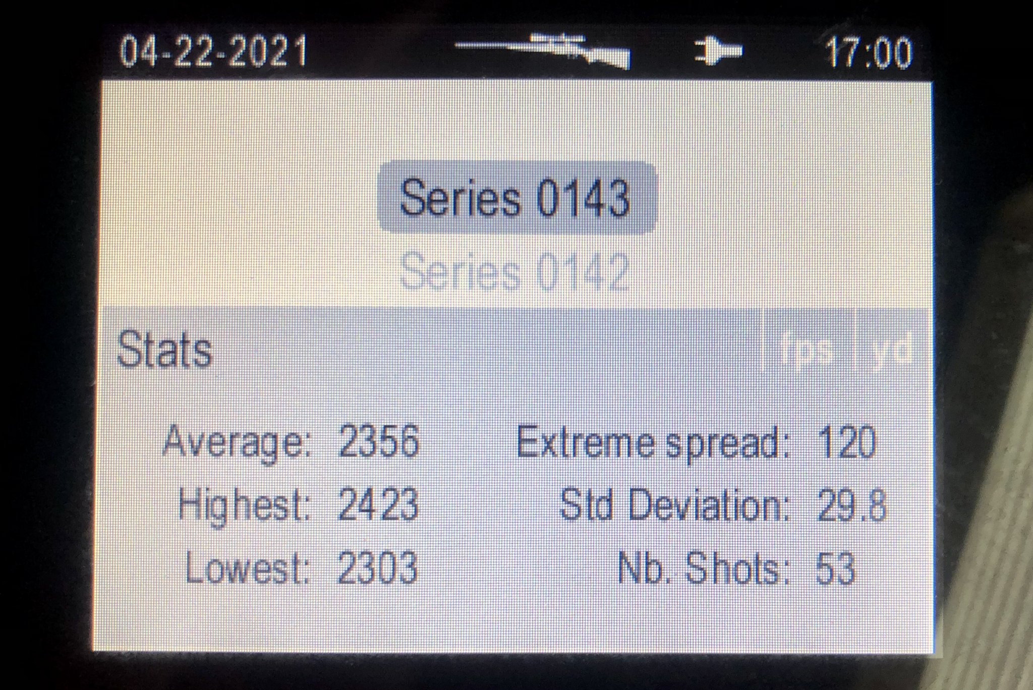

Strange thing happened this weekend: Loaded 60 new neck turned Lapua cases with a low charge fire forming load, and shot 145 Barnes Matchburners. LabRadar reported an average of 2360 fps, about what i expected based on prior fireforming work. Never shot my fireforming loads beyond 100 yards. This time i tried to shoot it (just for grins) at 400 yard steel targets, from my MPA BA rifle. Rifle has been accurate so far, capable of 0.3-0.4”. The ammo was remarkably accurate, and i could get 9/10 hits on the steel targets (from 6” or 1.5 MOA down to 3” or 0.75 MOA). Most misses were due to wind direction changes (missed left or right). Maybe 3 out of 60 shots went below or above the target. I realize that at only 400, most of my targets were at or above 1.0 MOA.
What was weird is that LabRadar reported an SD of 29.8 fps and an ES of 120 fps! Yet the ammo shot really well!
Is LabRadar giving me false readings? Is it reliable at slower speeds?
I ran that 120 fps difference through Strelok Pro, and it predicts 5” of vertical dispersion at 400 yards. Maybe that explains it. I could see about 3-4” of “waterline” on the steel targets.
Maybe there was accidental positive compensation at work here…. Just very surprised that a load with an ES of 120 fps can do this well.

With a sample size of 53 rounds a ES of 120 is not something I would normally pay attention to since it represents only two rounds of the 53. The larger the sample size the greater the possibility of capturing an outlier.
What is concerning is the fact that 2x the SD roughly covering the 120 ES. This tends to suggest that you have a fairly wide flat distribution of velocities. I’m guessing this is probably due to low fill volume.
Assuming your shooting a 6.5 that 120 ES is about a 6” total vertical dispersion holding the barrel elevation constant. (2280 vs 2400).

Yes: Fill ratio was low, at 40.0 gn (1 gn above book minimum), milsurp 30-06 ball powder, probably an 80% fill ratio. Wrong powder, low fill ratio, so quite an unstable load recipe.
Just to confirm: The SD was just below 30 fps, ES of 120, fps, so ES = 4*SD, which probably hints at a Normal distibution? So 2 SDs up plus 2 SDs down from average. No outliers were deleted, a warts-and-all data set.
Agree on the calculated 6” vertical dispersion, of course most shots would have been within one SD of average, so that would be 2*30=60 fps, or 3” of vertical, for about 70% of the shots.

Problem found: The powder i used for fire forming caused excessive carbon fouling, which led to big speed changes and a very bad ES. My standard accuracy load had double the ES subsequently.
Did a barrel deep clean and SD (and Average speed) went back to normal. SD of 7.3 fps. Same as before.
