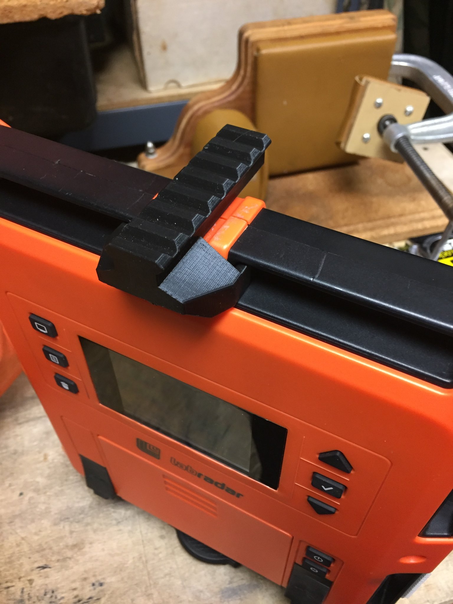

I found a 3d printed pic rail for the LabRadar on eBay and put an inexpensive Red Dot sight on it. Problem solved

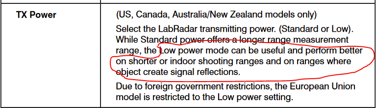

Try lowering the output power when indoors.

The pic rail and Red Dot decreased my setup time and made it a lot easier to “spot check” that my LabRadar is properly aligned. (Wind and Bumps to the LabRadar can be a PIA).
As @6.5SH has pointed out, the LabRadar has a generous beam width to work with. I used a small framing square laid in the Notch to line up the LabRadar originally. I then attached the Red Dot and adjusted windage and elevation to line up the Dot with the Target; rechecking alignment with the small framing square to verify co-alignment. I take the Red Dot Off of the Pic Rail when I pack up and reinstall the next time I set up at the range. No problems thus far with repeatability. As always, My experience only; You results may vary.
