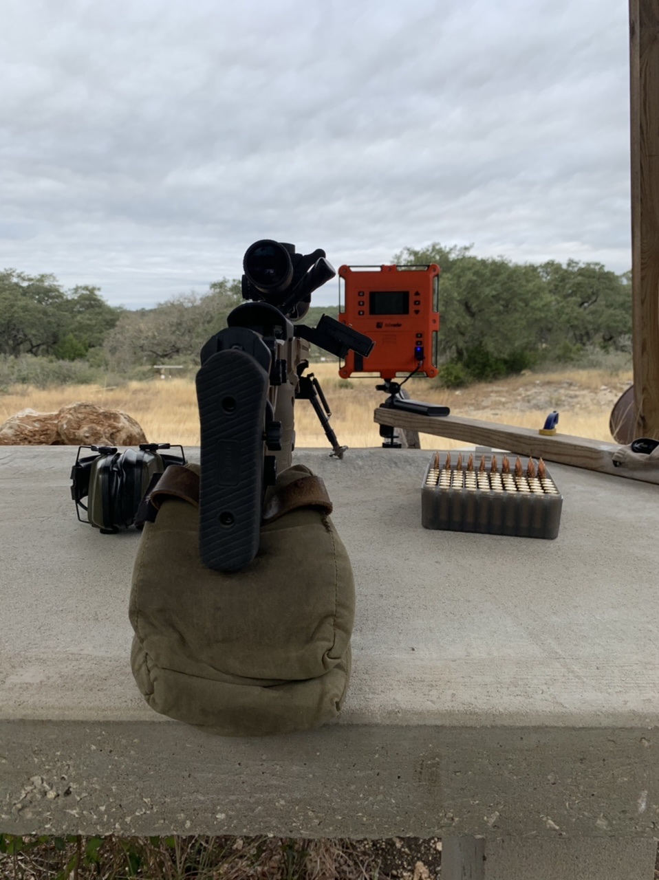

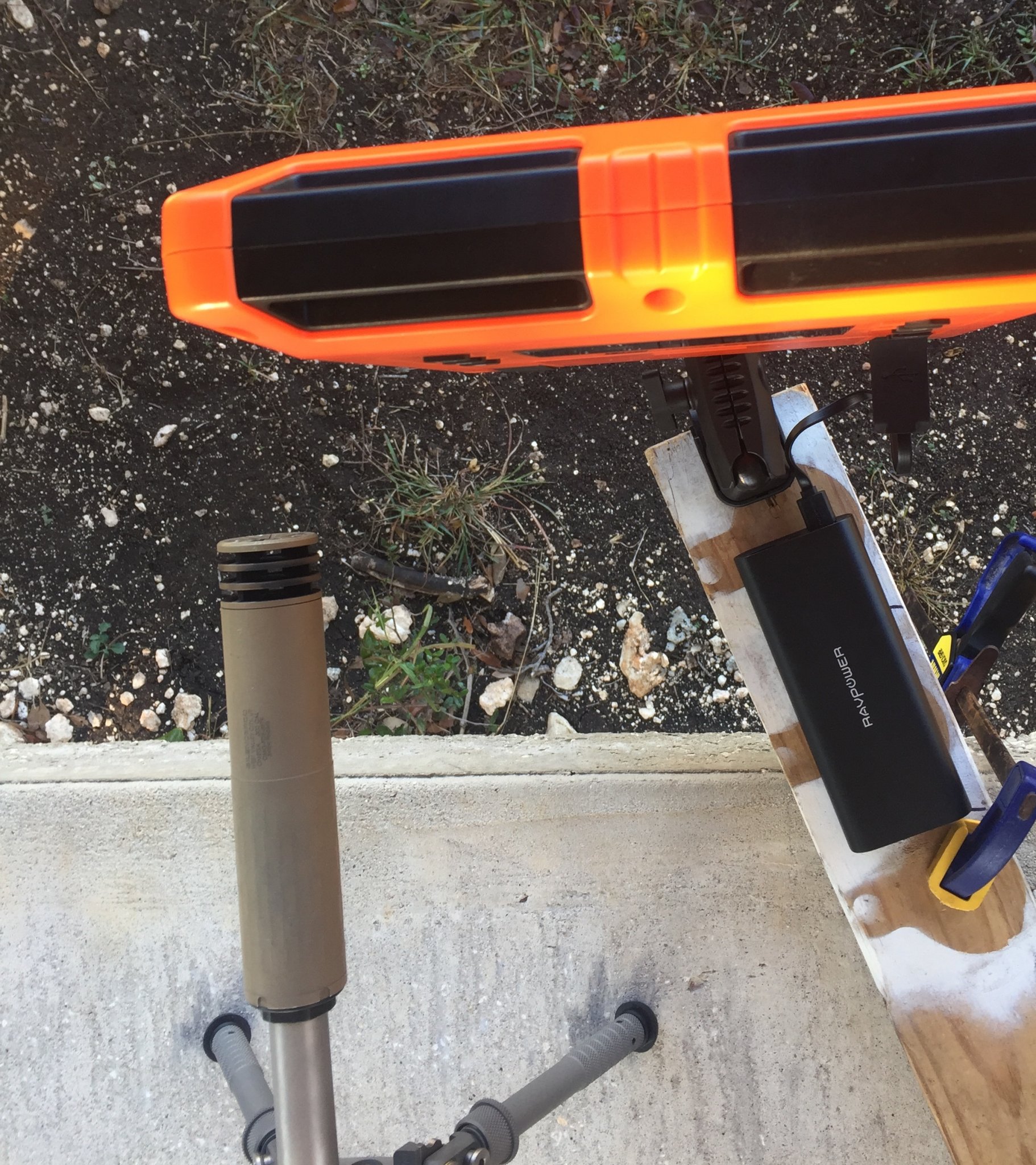

0-6" setting and put the can behind the radar. You want what little blast comes out of the can to be directed at the radar, if you put it in front you miss all of the blast. Rarely misses a shot.
With a nasty ass muzzle break, sure, put the muzzle in front so you dont beat the shit out of the radar. With a can you can be much friendlier with it.

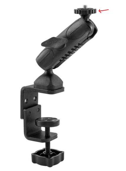

What clamp/mount are you using on the LabRadar itself in your pic?
random cheap amazon crap
Its alright, this little plastic piece cracks though when I tighten it down, but they sent me a new one in warranty but it cracked too. Works without it though. Might make a little washer to add more lateral support. Its made for little cameras, not the labradar with so much leverage I guess.
