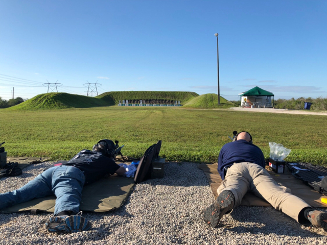

Snuck in a range session before the rain hit in my area this AM. I separated myself from the other shooters and had about 4 benches between myself and the other guy who was shooting an AR10 (308). Only got 5 rounds in before it started to drizzle. I had to put up the LabRadar. Anyway I only received one error when it picked up the sound from the other rifle. I had the can about an inch to the side and back from the mic. Picked up the 5 rounds with no issues.

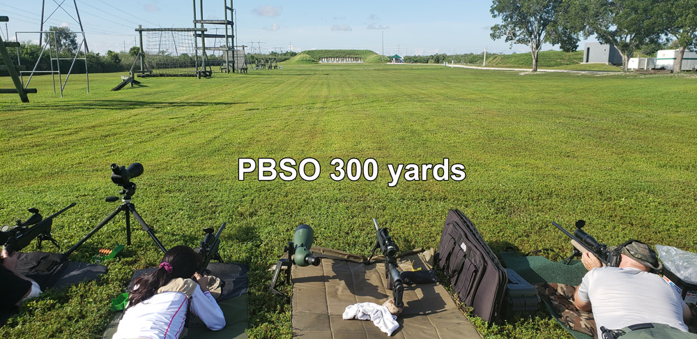

How CLOSE were the other shooters to you? At my local rifle range, I normally have shooters to each side of me, maybe 4 - 6 feet away. How far away do the other shooters need to be for the labradar to function without errors? The targets are even closer together.... maybe two feet between the proximate edges.
We have separate benches... maybe 6-10 feet apart? We aren't right on top of each other, and usually the range isn't full.
I think the bigger issue is the separate between targets. If mine picks up another shooters muzzle blast, it will display "could not track projectile". With targets that close, it may actually pick up the other guys bullet...
That's what I figured, and it was one of my main concerns when deciding between LR and MagnetoSpeed. So, I ended up with the MS.

Here's a pic of my buddy and me at the local range. This is a typical spacing of shooters there.

Same range on the 300-yard line on a particularly busy day. My gun position is the empty one between the two shooters you see here.

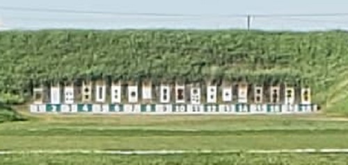

Here's a zoomed in pic of the target stands. Sorry it's a bit pixelated at this magnification, but it should give you an idea how the targets are spaced.

The line isn't always that crowded. But, I'm curious.... from what you see here... LabRadar going to work consistently? Honest question. How challenging would it be to align the LR with my target in this situation? Even if I could get it aligned, would the LR be picking up the other shooters' shots? I'd hate to drop $500+ on a LR set-up only to have it not work here. My choice of outdoor range within reasonable driving distance is this one... or this one. ;) In other words... just this one.

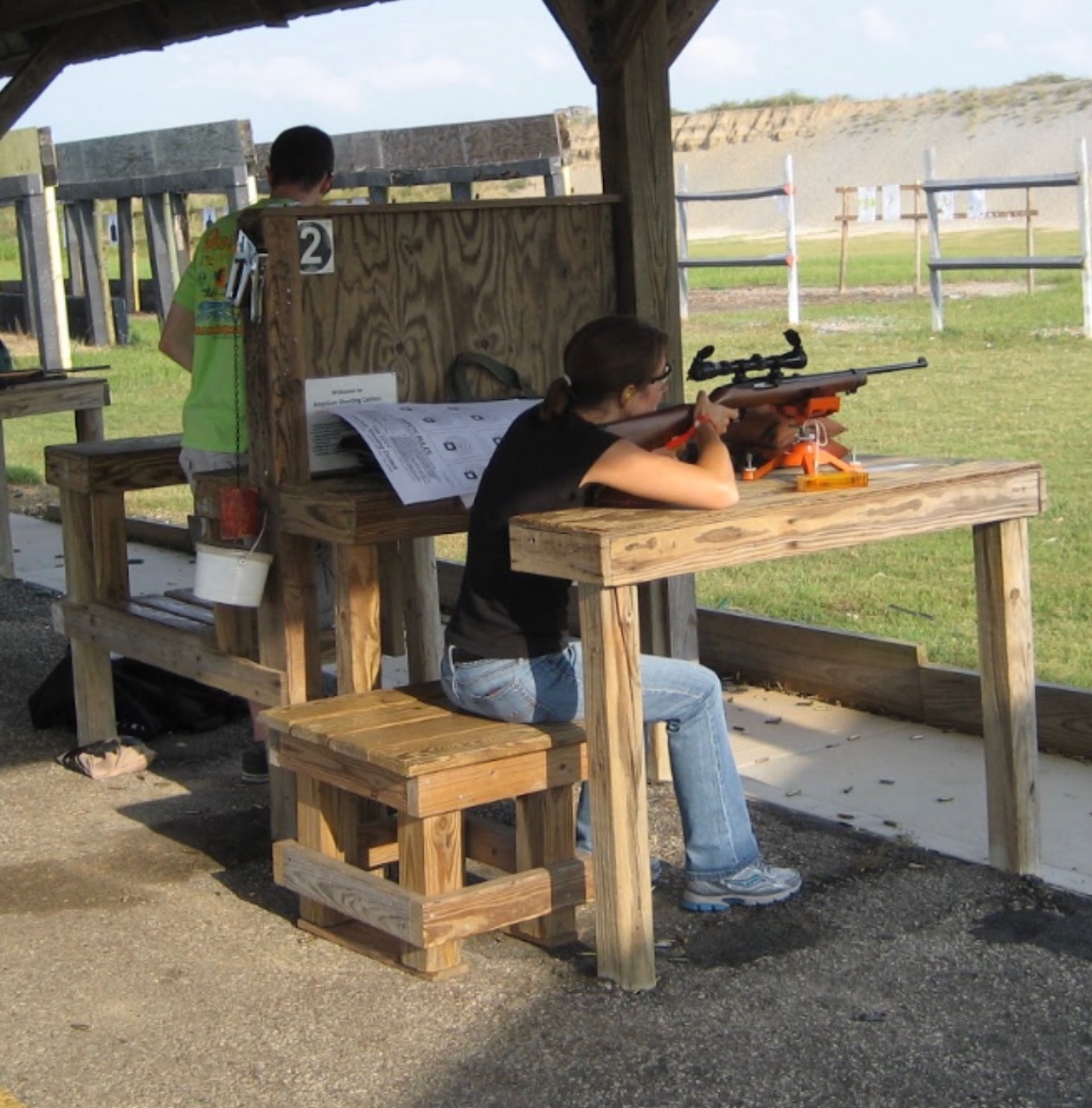

The LR is useless at my range. The wooden benches are separated by a plywood wall and the next guy's muzzle is about 3-4 ft away depending how you're positioned. A high percentage of the time a neighbor's shot will trigger my LR but won't pick up the speed because it's not aimed at the other target. This is where the MS shines for pure data collection. Yes I know POI can shift with the MS but for pure data (velocity) collection the MS wins.
If I want to chronograph I have to remove myself from that range and go down to the 300 yard section where hardly anyone is there.
Photo I grabbed online of my range at the 100 yard line..
I shoot at a similar range only it has concrete benches and no barriers between benches, I set the labradar sensitivity to 3 and it works fine.
