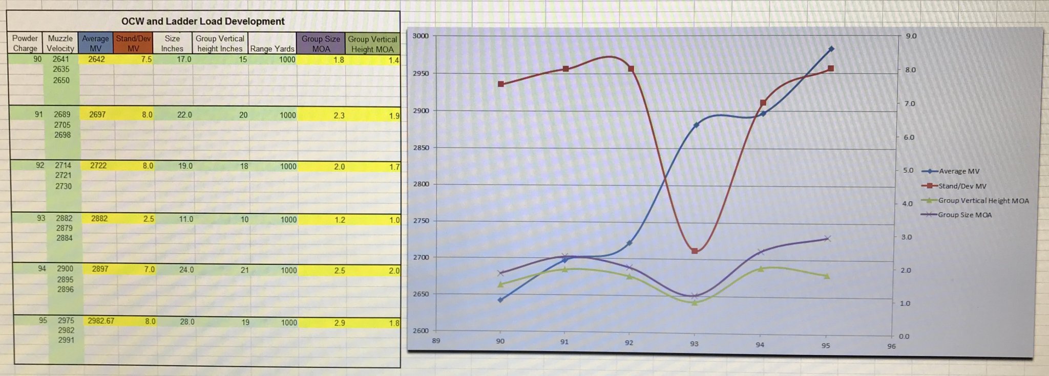

So I shot an ocw and ladder test at 1000 yards with zero wind and took this data. What do you think 338 Lapua 300g otm with retumbo

No just backed off 15 and went for it
This is what I would do, try find your seat depth at 100, seat depth usually controls horizontal, then adj your charge where vertical is held. Then move out and fine tune what you going on.
if you are grouping inch and a half at 100, going to look like crap at 1K.
