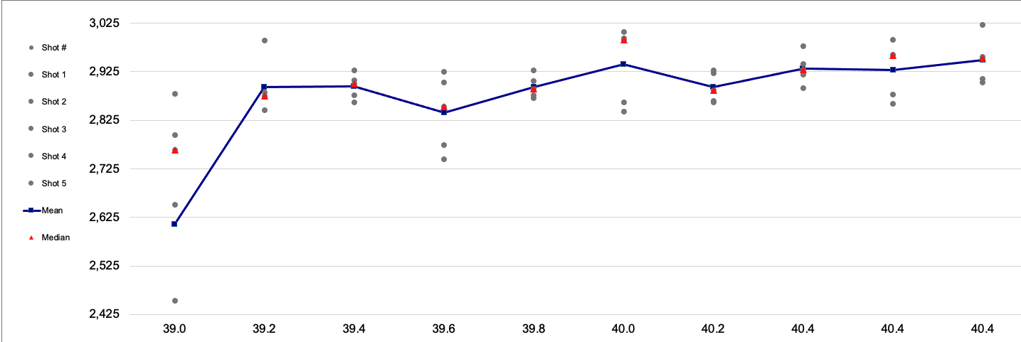

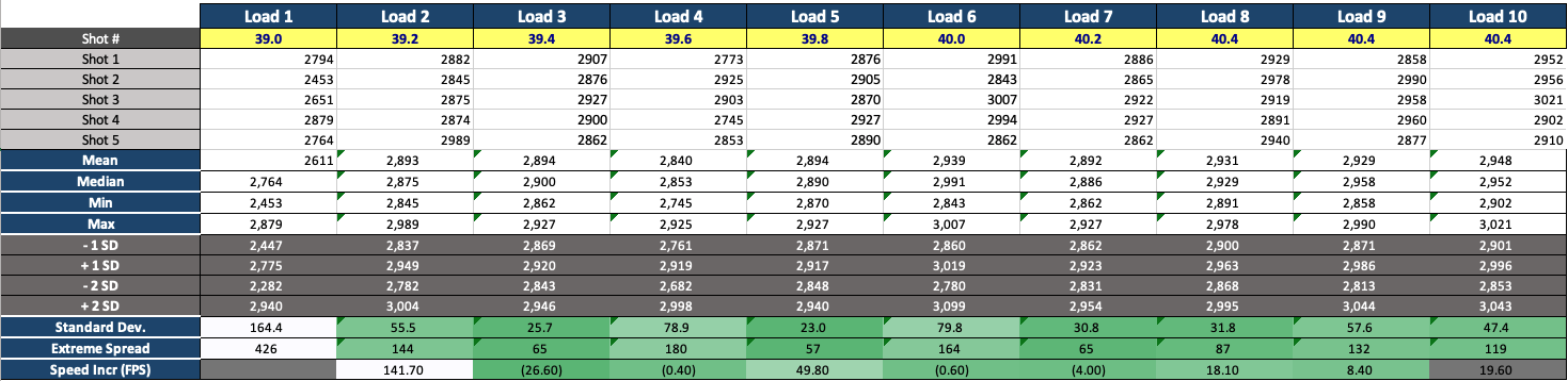

Hello. Did a 5 shot ladder test today with my 6.5 cr masterpiece prs rifle. This is the first ladder test that I've done. I've been reloading for about 6 years and all the rounds I built used the same brass, same primer, and all were seated at the same depth. I have two rcbs chargemaster lites that were my powder throwers and were calibrated before loading rounds. I recently bought a labradar chronograph that I used to track the rounds.
As you can see from the data, my fps variability was to my eyes unbelievably high. The only real variable was the temp of the barrel. I did rest the barrel between sets but not to cold. Looking for other people's experiences with ladder testing to see if what data I collected is even close to normal and either way, looking for recommendations of what I can do to bring standard deviation to a much smaller number. Any insights are appreciated. Thanks.
What are your results with that rifle and chronograph using commercial ammo? Those numbers are a little hard to believe and I think measurement errors would have to be considered.
Can't remember the last time outside of 22lr I've bought commercial ammo. Might have to pick some up as a baseline. factory ammo is soooo expensive :)
Your data is fubared. An extreme spread of 426 FPS? A standard deviation of 164.4 FPS? You would have to be one of the worst reloaders on the planet for that data to be valid. So either you are one of the worst reloaders on the planet, or your Labradar sux. (I'm betting it's the labradar, not you.) Beg, borrow or steal a different chronograph and repeat the same test.

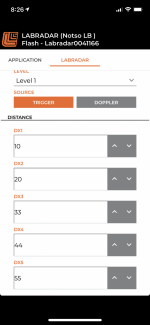

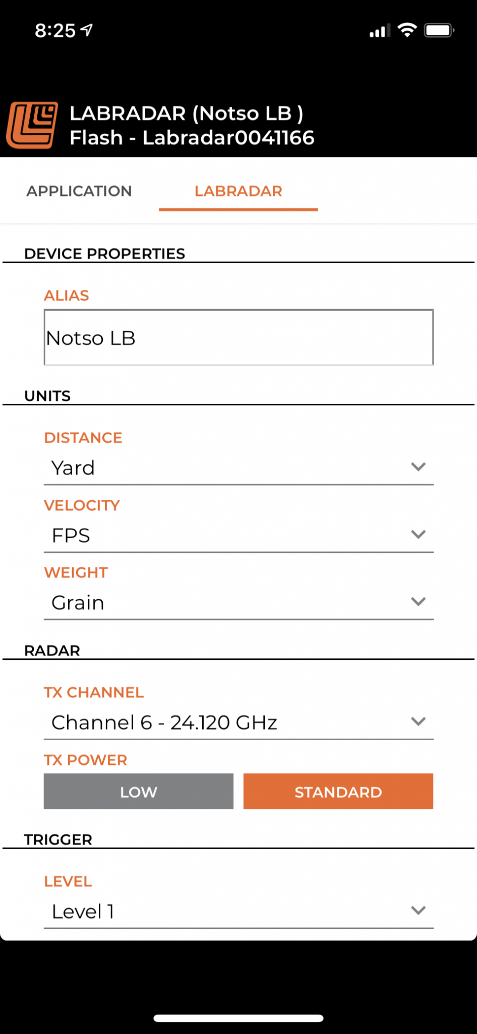

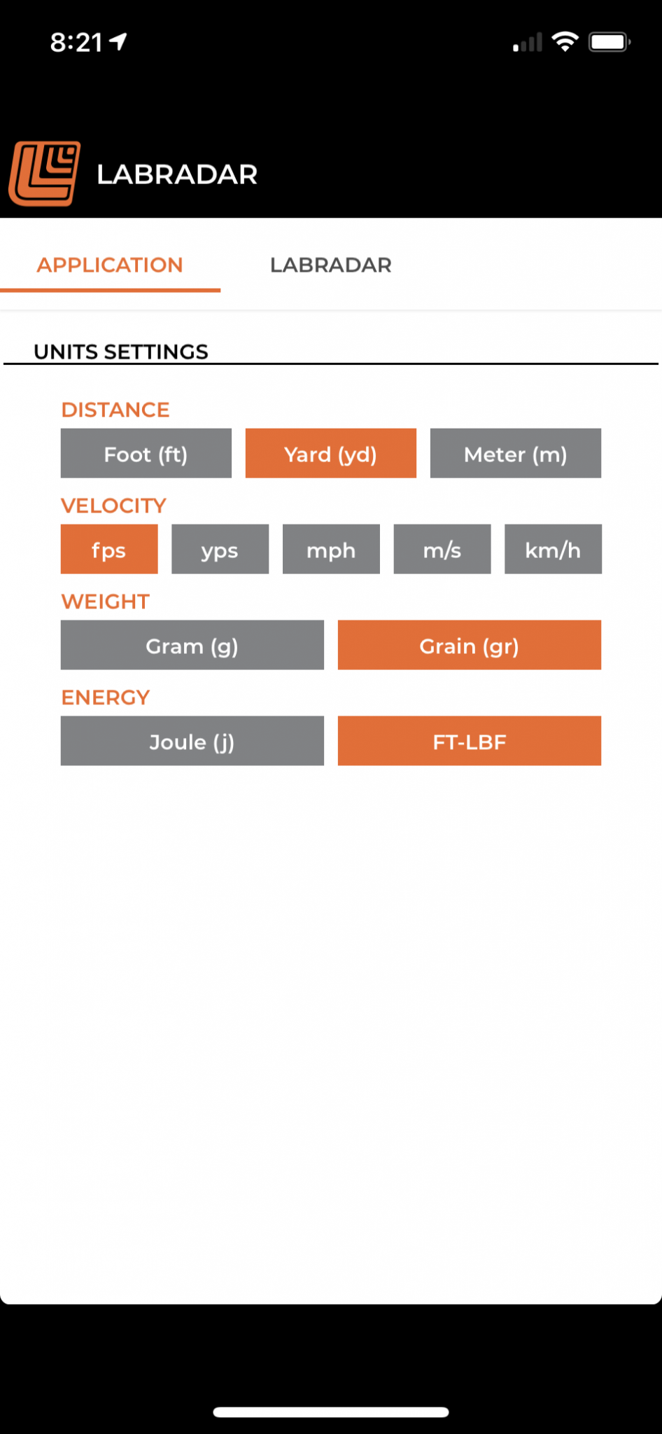

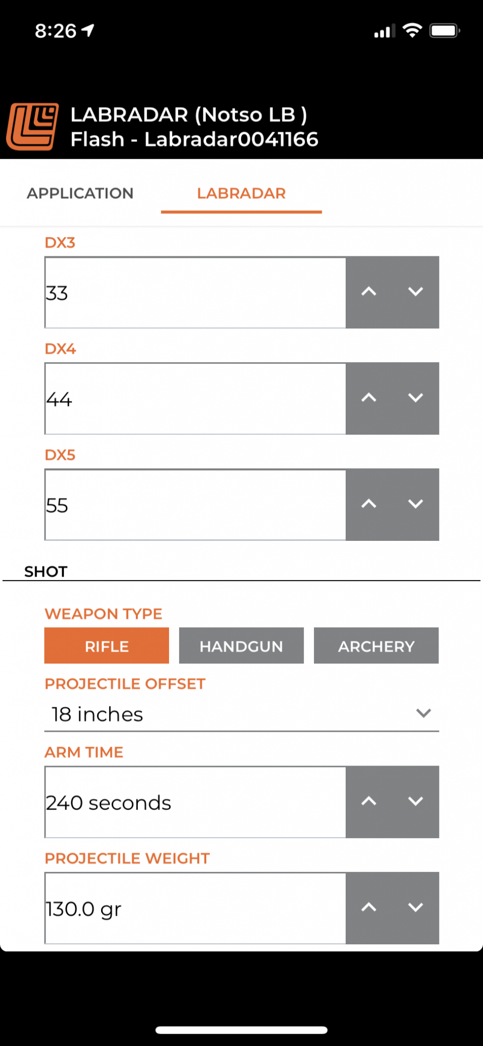

Also make sure you have the Lab radar settings correct. If the unit is not set with the default settings correctly, it could give you erroneous readings. Here's my setup to give you an idea of what it should look like. The "rifle" setting is particularly critical to get it to read correctly, but other ones are important as well. This is using the app on my Iphone. But you should be able to do all this directly on the unit.
