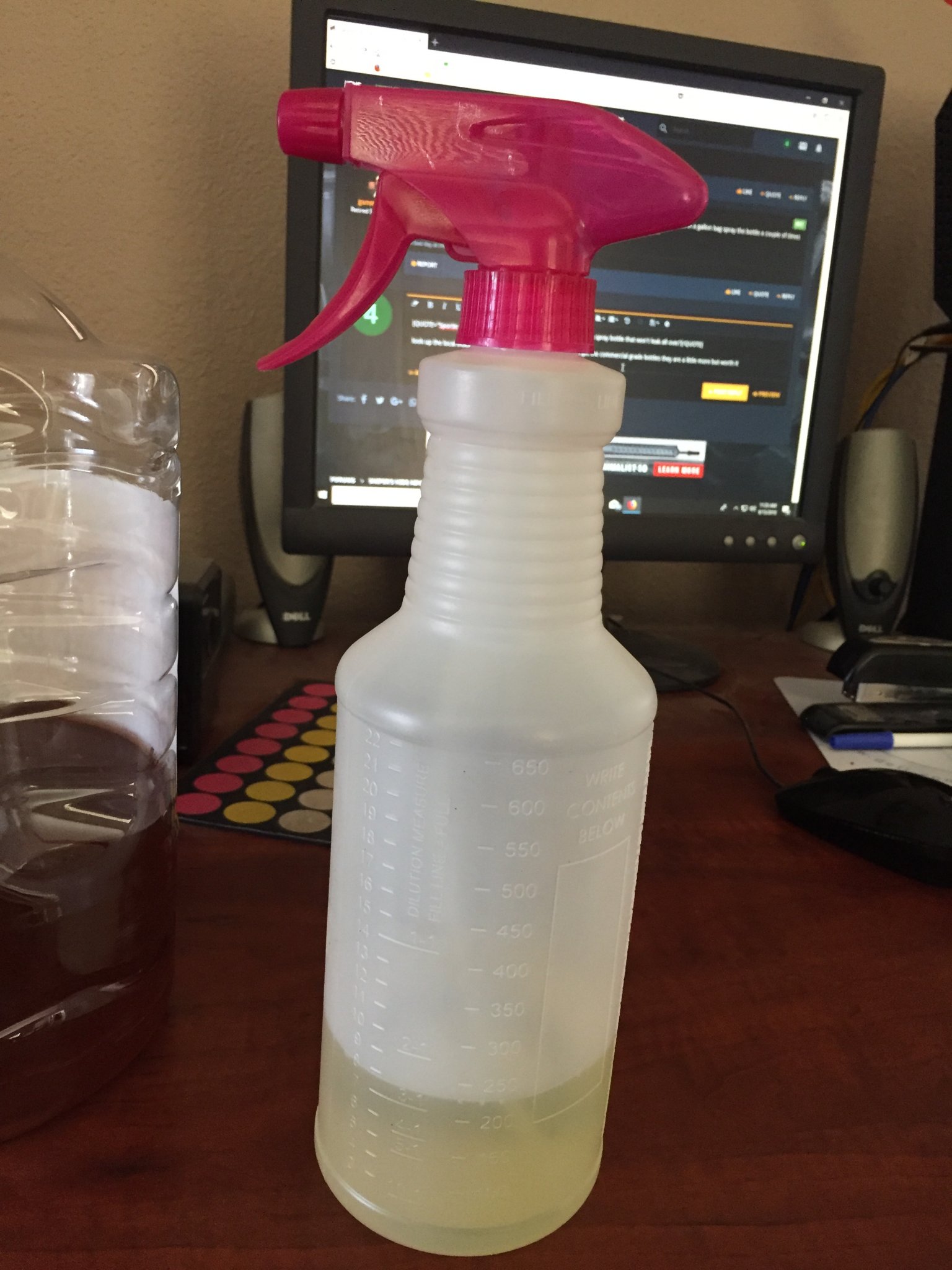

    Anyone find a spray bottle that won't leak all over?
    look up the local industrial cleaning supply place in your area and get the commercial grade bottles they are a more but worth it...ive been using this same bottle for about 7yrs
