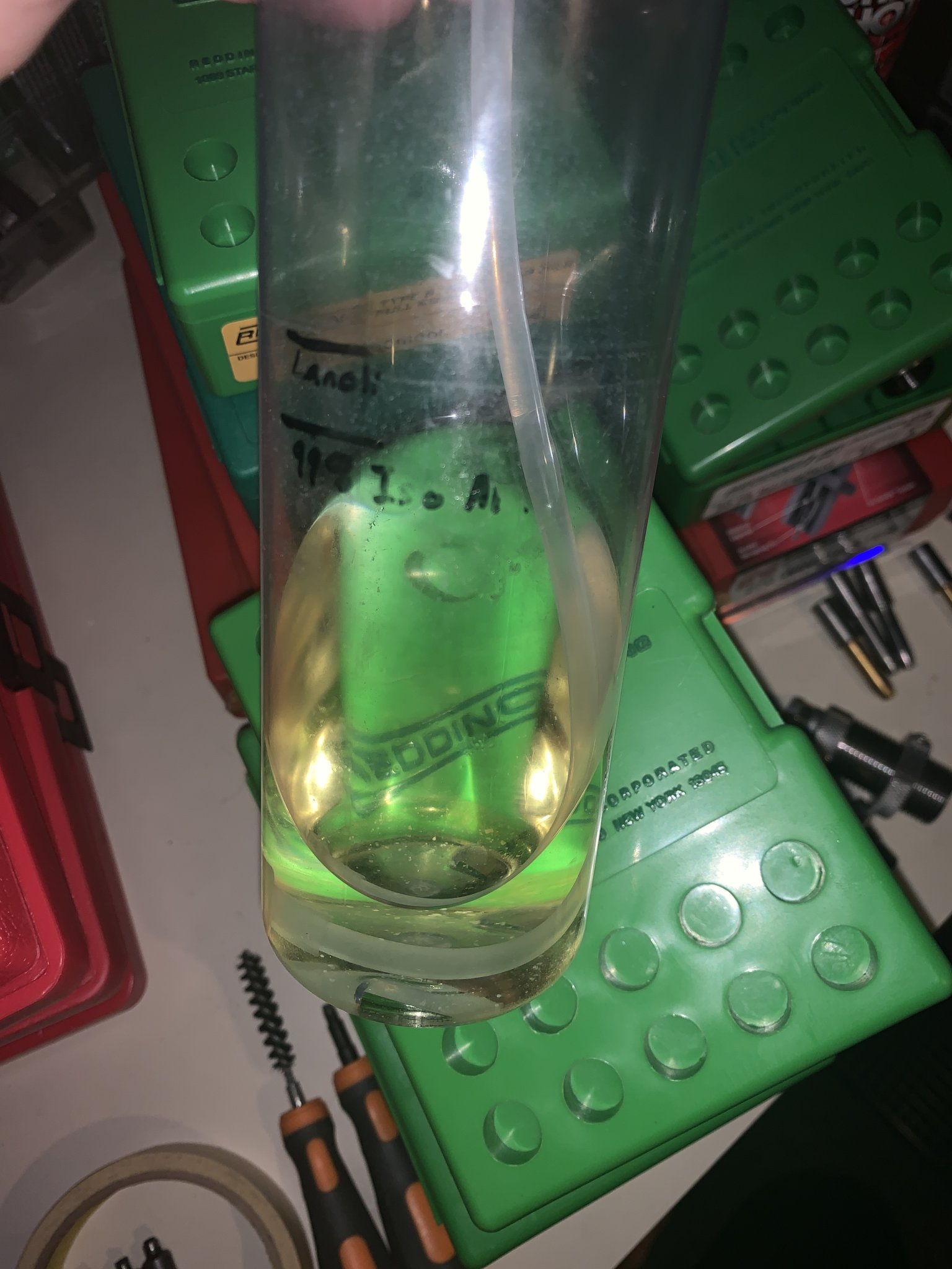

I took my spray bottle and I measured up 4” from the bottom and make a line. Fill it to there with 99% alcohol.
I then used my calipers to measure another .4” up. Now top it off with lanolin to that point. 4.4” total of 10-1 mixture.

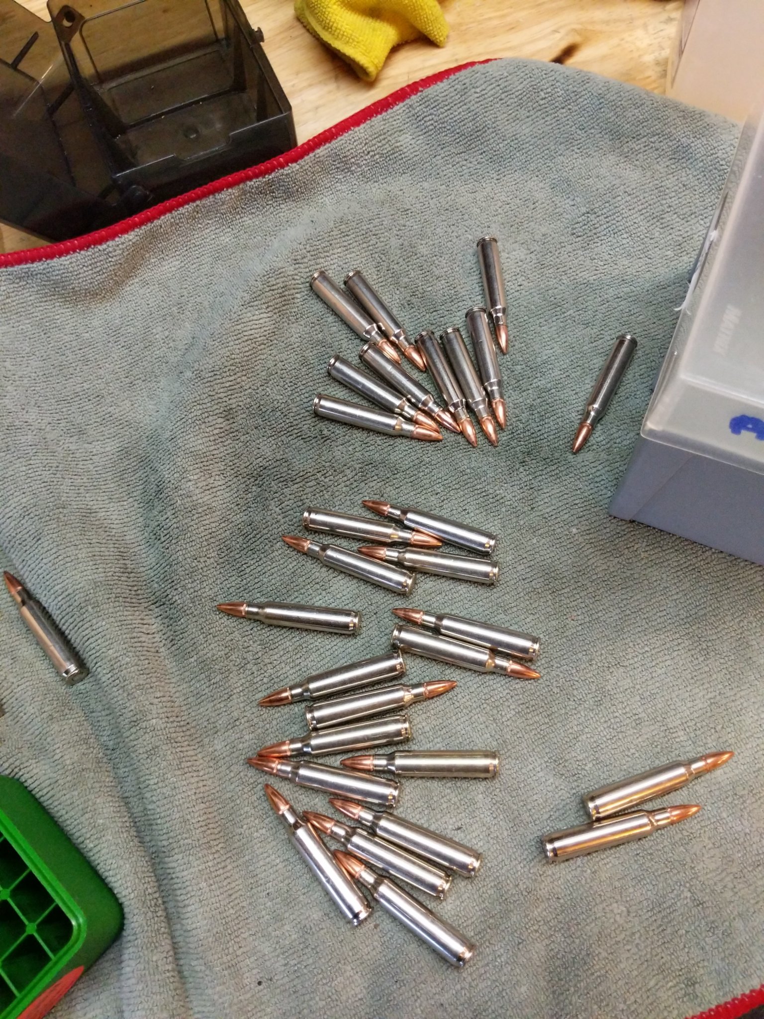

I definitely made a mistake using 70% IPA and that left a horrible amount of residue on the casing easy to size but it was causing crazy extraction problems on my otherwise reliable AR-10 platform. The whole time the problem was an improper ratio so now isonicate after that is using ultrasonic cleaner after sizing trimming if necessary cleaning the primer pockets then drying them and I'm good to go. Here qty: 40, 62gn Fmjbt with 28gn.of Hornady Superpeeformance. Not 23 but 28 and my Chrono numbers are staggering.

I bought a 4 ounce bottle for lanolin, put four marks on it, I put a 12oz bottle of 99% in my spray bottle, then I pour liquid lanolin out until the next line. 4 ounces goes a long way. I still use One Shot when I am in a hurry.
