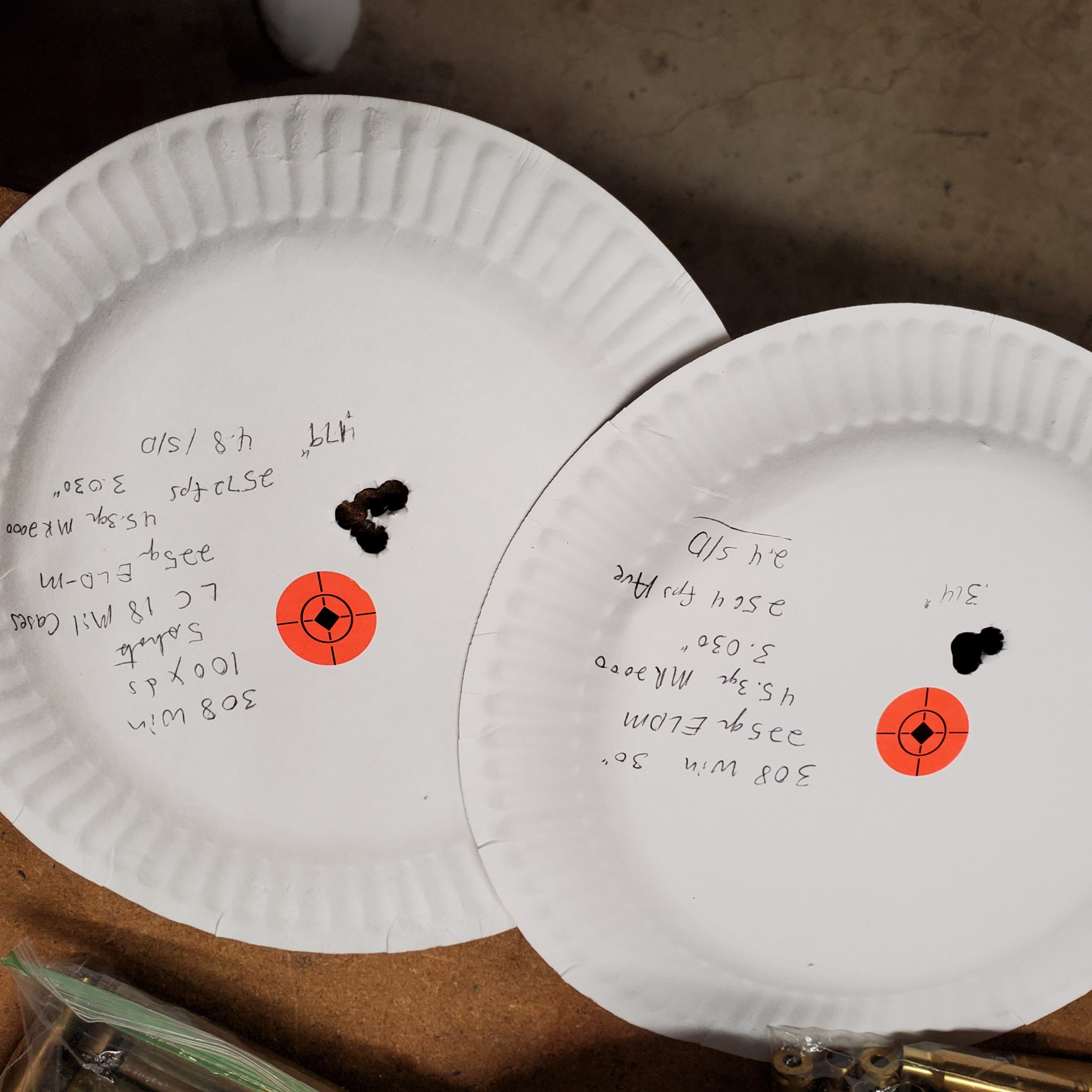

Here is the test example of the difference in group size... fired in a target rifle.
Same exact powder charge and bullet in both sets cases, sized in the same Wilson bushing die.
The smaller 5 shot group on the right Lapua brass no case prep at all.
The slightly larger left hand group Lake City brass no case prep at all, even had the live LC primer still crimped in the case as they were pulled bullet cases, no decapping pin.
The cheap LC cases work great for most shooting.
Auto loaders with premium barrels are capable of tiny groups... less than 1/2" five shot groups some in the .3" and .4" with LC brass.
So cheap ya don't care if ya lose it, no case prep, don't care about longevity...just load and shoot, many times on a progressive press...it still shoots good with reasonable loads, and some unreasonable loads
That's about the difference...it's very small....you decide if that's important to the days shooting endeavors.
