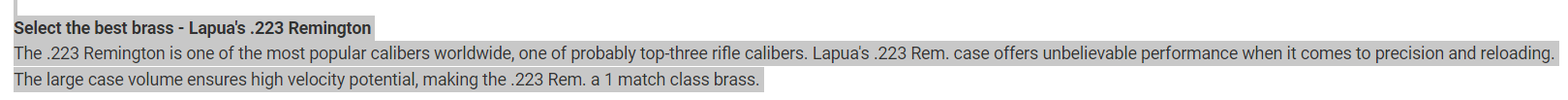

    Scheels has 223 rem Lapua brass, but it does not specifically say that it is "match." In my searchs through the internet this is the first time seeing it. They have it for the cheapest price.
    Just wondering if all new Lapua brass is match or standard and match?
    As far as I am aware "match" is a term that typically applies to barrel chambering. I.E. .308 Winchester and .308 Winchester Match where "match" just means slightly tighter dimensions. All Lapua brass is consistent by design.

    The only time I've seen Lapua brass listed as "Standard" is when they have cartridges produces with LRP's and SRP's, the "Standard" being those with the LRP's. I've not ever seen Lapua list any brass at "Match". grade.

    Every box of .223REM brass I've gotten from Lapua is marked "match" however I have seen Nammo military brass (from Lapua) that doesn't. So it may just be a commercial designator.

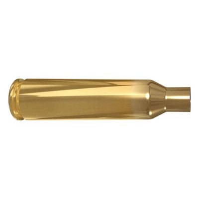

    The standard Lapua 223 Remington brass cases originally sold as reloading components were significantly heavier than Lake City cases and as such they had lower case capacities. Those cases were head-stamped:
    LAPUA
    .223 Rem.
    High Power Service Rifle shooters using heavy OTM bullets wanted all the case capacity they could get and therefore were not very interested in using the legacy Lapua cases. Lapua then introduced their “match” version of their hand-loading component brass which was significantly lighter and had more case capacity than the legacy cases and was roughly equivalent to Lake City brass. This is the brass that is head-stamped:
    LAPUA
    223 Rem MATCH
    The Lapua match brass originally came in the boxes shown on the left and now comes in the plastic containers shown on the right . . .
    Sadly, Laupua has been slowly increasing the weight of the match cases over the las several years and therefore decreasing the capacity,.
