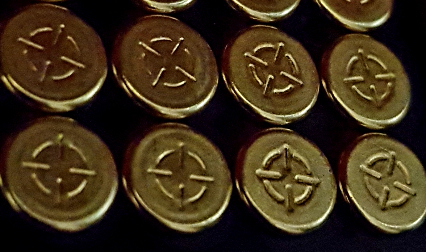

    Has anyone tried sorting exceptional brass?
    This is what I am talking about:
    Picture of SK Biathlons
    7090521
    As you can see 4 in the left have light labeling where 4 on right have heavy labeling.

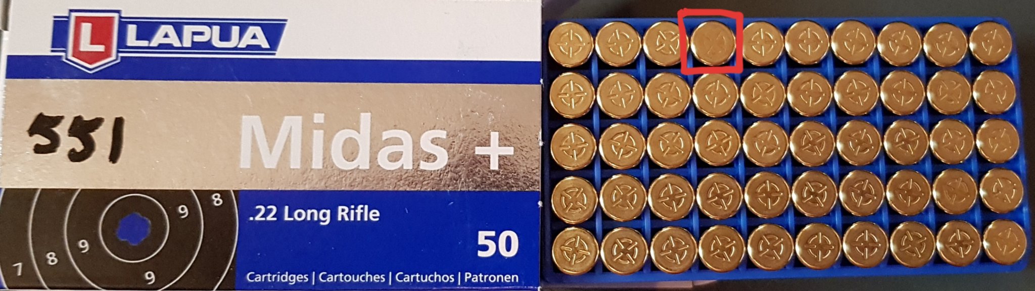

    Here is another photo, of Midas +. Just one brass is lightly labeled??
    7090527
    Is this some conspiracy to ruin my groups or perhaps something even more evil?
    Sort a boxinto groups of ten, based on stamp depth/crispness/whatever. Shoot the groups. I'd be surprised if you see a measurable difference, but I've been wrong before. Post up the results.
    But how do you know they are not one of those.. This thing goes way deep and we need to be careful. You are sure they are skilled enough and equipped well?
    You could try a 22 rimfire rim thickness gauge and see if the rim thickness is why there’s more/less stamp.
    I have a friend who has one, seems like there is point in measuring it in these specimens. But since rim thickness correlates with hardly anything it would be just a 'nice to know'.
    I have heard that the overall length of the cartridge can make or break a group..
    Does not anyone else have these same brass heel shape problems?? I need more cameras...
    I’ve never looked that close. Lapua centerX shoots at or below 0.5” at 50y from my Kidd 10/22, and has the least vertical dispersion at 200y. That is sufficient for me...
