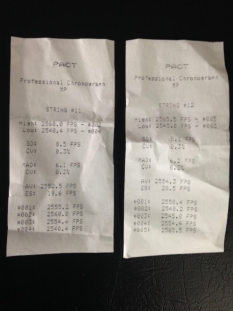

I'm shooting a bone stock Remington 700 VS in 308 Win. 1 in 10 twist 24 inch barrel, only modification to rifle is that it's in a Manners stock. Been using Lapua Palma (small rifle) brass for the last few years and have had zero primer problems. Groups posted below along with chrono data; Federal 205 M primers work just as well, but the SD may not be quite as low. These are the best groups I've ever shot from this rifle, I also run this load in my 308 gas gun; 1 in 11 twist Krieger barrel with no problems. I do use Starline 308 Match brass and Federal AR205M primers in the gas gun though. I don't really try to push high velocities and according to Ballistic AE this load will get to a 1000 supersonic, but not much farther, that's good enough for me.
