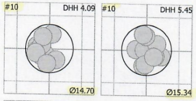

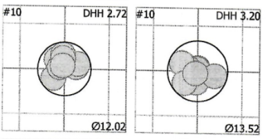

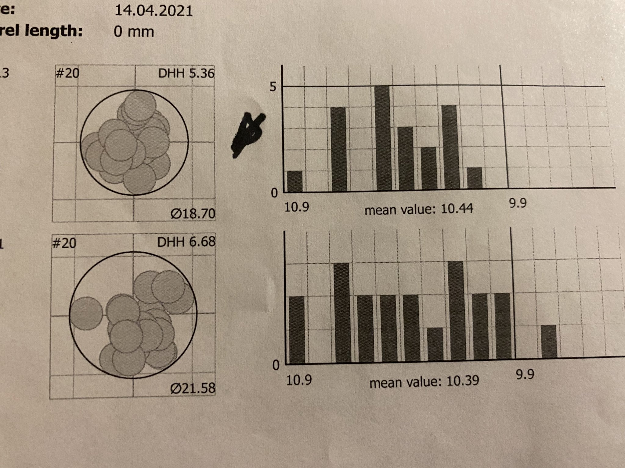

    Hey everyone, wanted to do a group poll on people who got tested at the Lapua Testing Center to see how Midas compared to CX and when you might have chosen Midas, even though Midas is 30% more expensive.
    Vudoo Gen 1.2, Ace Barrel 18" Kukri
    Midas+ 50m
    Midas+ 100m
    Center-X 50m
    Center-X 100m
    I ended up choosing Center-X of course.

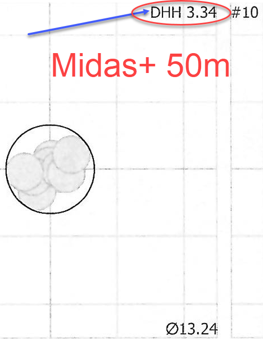

    Midas+ are the lots of Center-X that shot better on average in their factory test rifles, so I’m told.
    I think I've heard that X-Act, Midas+, and Center-X are all the same ammo but based on how well they shot out of their factory test rifles. I don't know if ES/SD has anything to do with how well it shoots. I am guessing they're correlated but not sure...
    I heard also that Eley Tenex is the better stuff than Eley Match. I lot tested 10 lots of Eley Tenex and the group sizes were varied from shotgun pattern to 1 hole in my rifle, very odd how all this stuff works out.
    Reactions: FN15

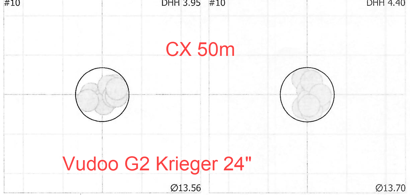

    I have both C-X and SKLR in a couple different lots. They look identical right down to the ID markings on the case head. I subjected a batch of each to rim thickness and weight sorting and they sorted out much differently. The rim thickness of C-X had less variance and the weight did as well. I don't remember the exact rim numbers but where the SKLR had as much a 1 grain weight variation the C-X was within .1 all weighted on my FX120 scale.
    All that said, for the stuff I shoot my Vudoo has performed best with SKLR unsorted.

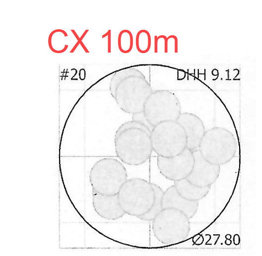

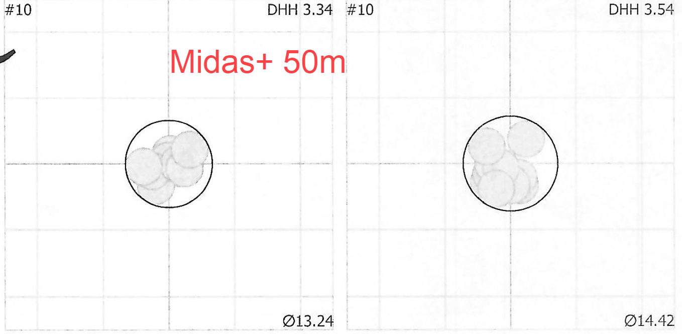

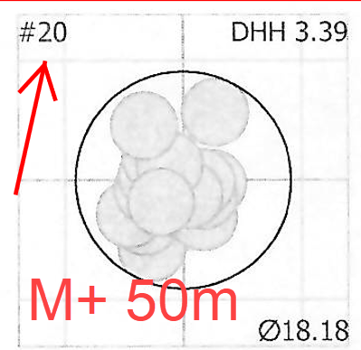

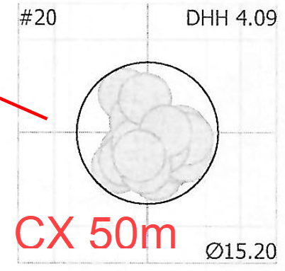

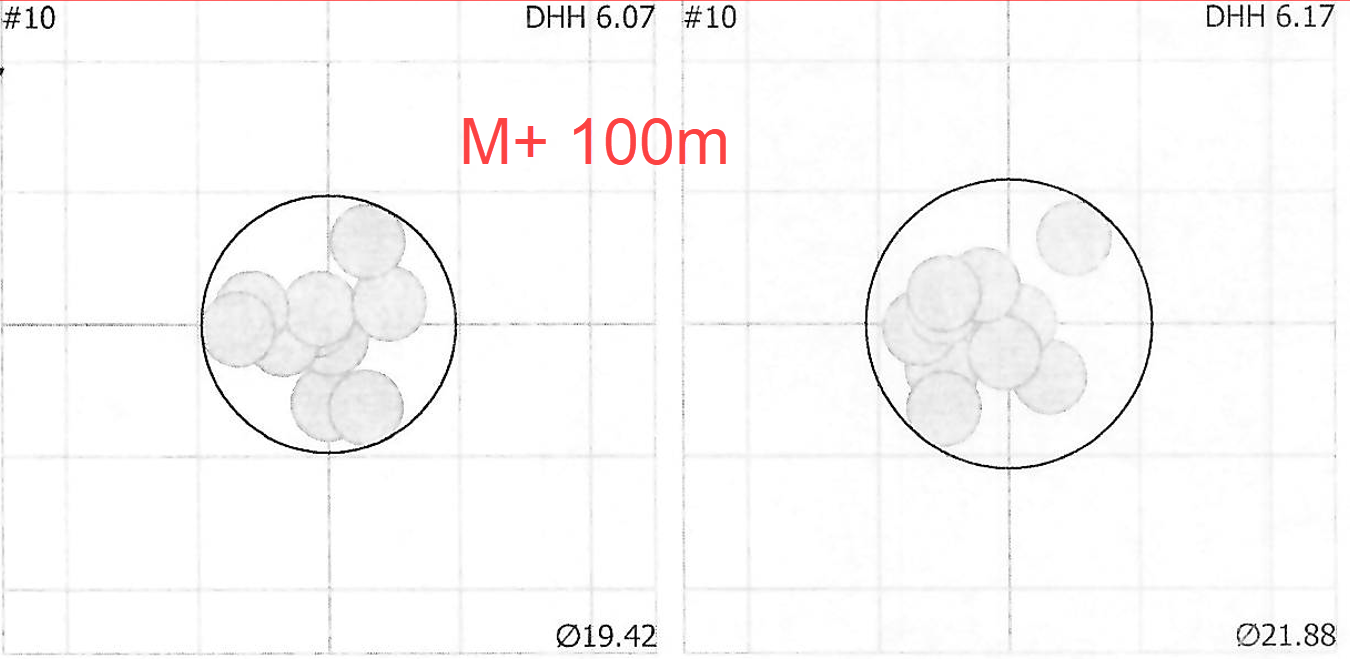

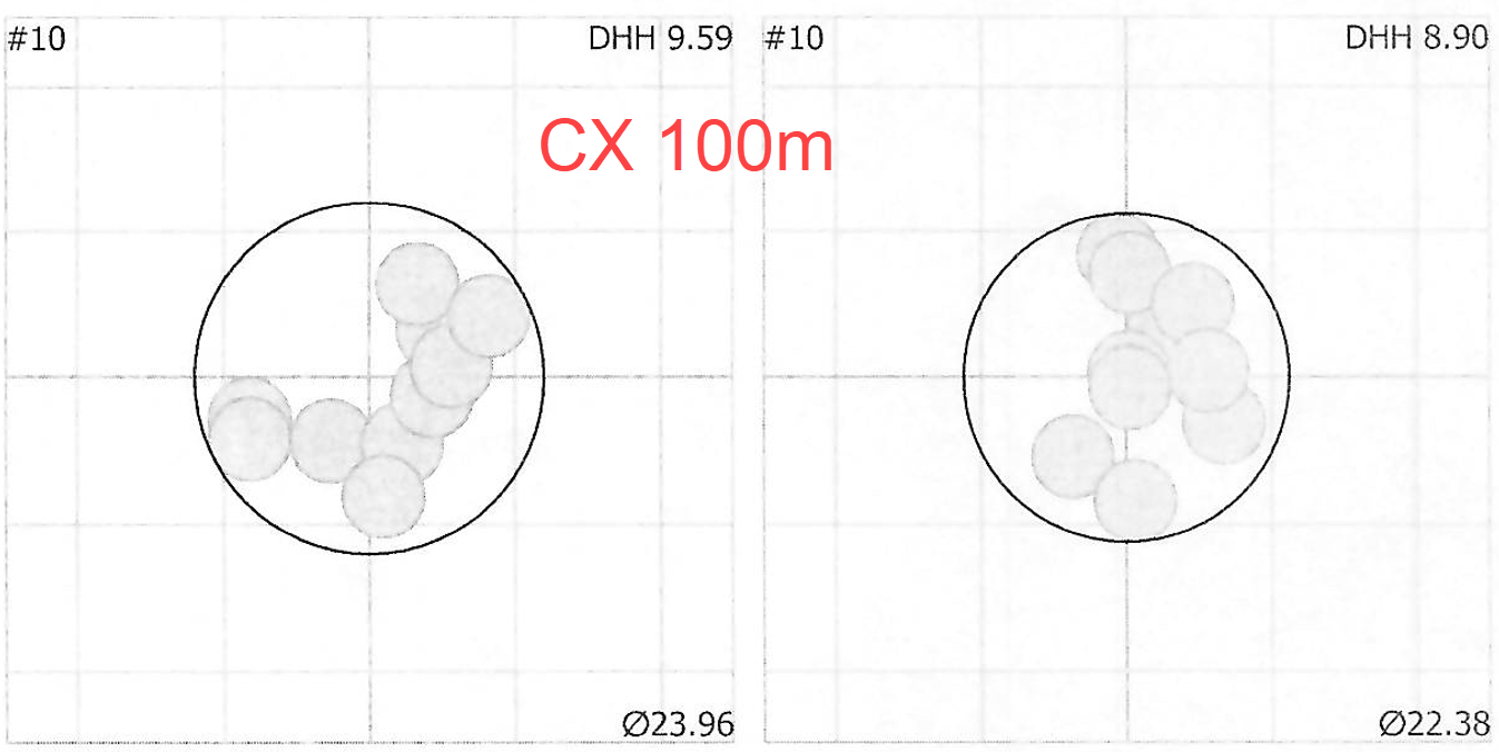

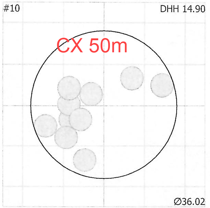

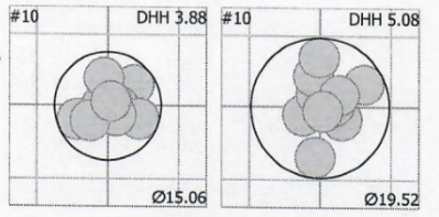

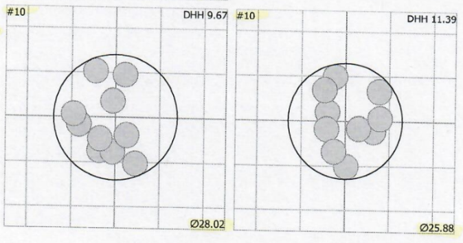

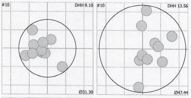

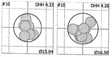

    From 3weeks ago
    Mounted in McMillan A6 Bedded Stock
    As you can see, the difference between CX and M+ here is minor but tangible, especially at 100m.

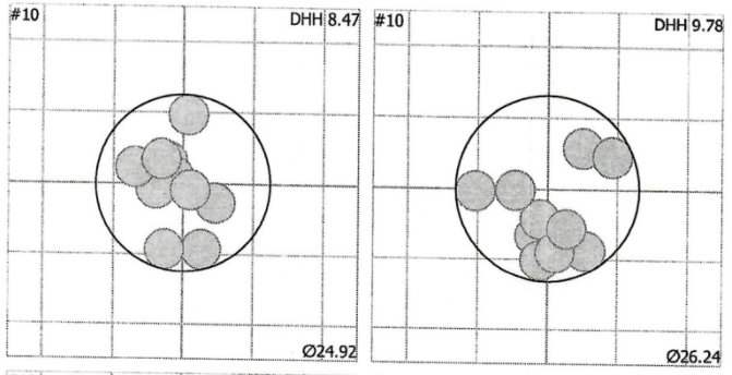

    I was able to get almost a case of CX (they were 3 bricks short) so was able to also purchase half case of M+ to use at long range or against my archrival when he shows up. :)

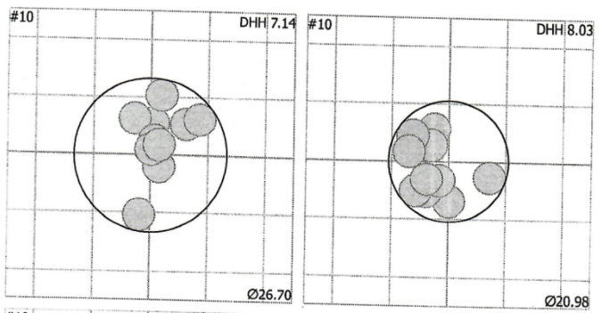

    What I thought was so interesting is how poorly some lots shot. For example:

    From 3weeks ago
    Obviously rejected...
    To me, this shows how important lot testing is.
    Wow great results! Those are amazing. I'd definitely have taken that CX lot you got! Who chambered your Krieger barrel?
    What convinced me to test at Lapua was the number of lots of C-X that I had to sample to find a really good lot in my Krieger barrels chambered with an EPS reamer. And then - because of delays in getting the lot samples tested due to poor weather conditions - by the time I'd found that really good lot, everyone else in the country must've already found out how good it was, because I couldn't find any more of it anywhere.
    👍 What more can one ask for!

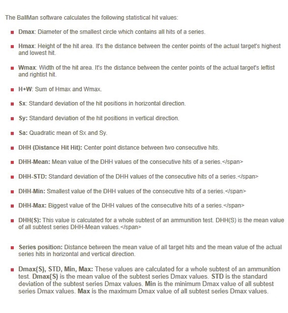

    Just to point out that there are 6 values given that relate to DHH(ie. mean,std dev, min, max, etc). Clearly the straight DHH between the 9th and 10th shots in the group is about as meaningless measurement of precision that possibly exists.
    I've noticed that lately the guys who are posting test center results are only showing 10 shot groups. There are lots of older examples on the forums that show 20 and 40 round groups which I consider much more relevant. Are you guys not getting to see 4x10 composite groups at the Lapua facilities?
    On the first page of the print out, do they just overlay the two 10 shot groups to show you the 20 shot total?
    The two times I’ve gone in person what Luke would do is pick the best few 10 shot group lots and do twenty shot groups with the best lots for a final test. I’m a poor so don’t sneer at my CZ’s results. On this trip we had to shoot it in the stock without the rear action lug screwed in, long story. I’m shipping a different CZ out to Mesa today.
    Reactions: HenryRed
    Yes, Luke ran through 14 lots of CX and 8 lots of M+ that he had on hand. On some of the lots, it was obvious after <10 shots that they didn't match up with the barrel so we moved on. Then he revisited the best performers and the results matched the first time around. From there the decision was pretty obvious. Luke has just recently taken another job where his wife can be closer to home. For him, it must have been a no-brainer. He was a nice kid for sure.
