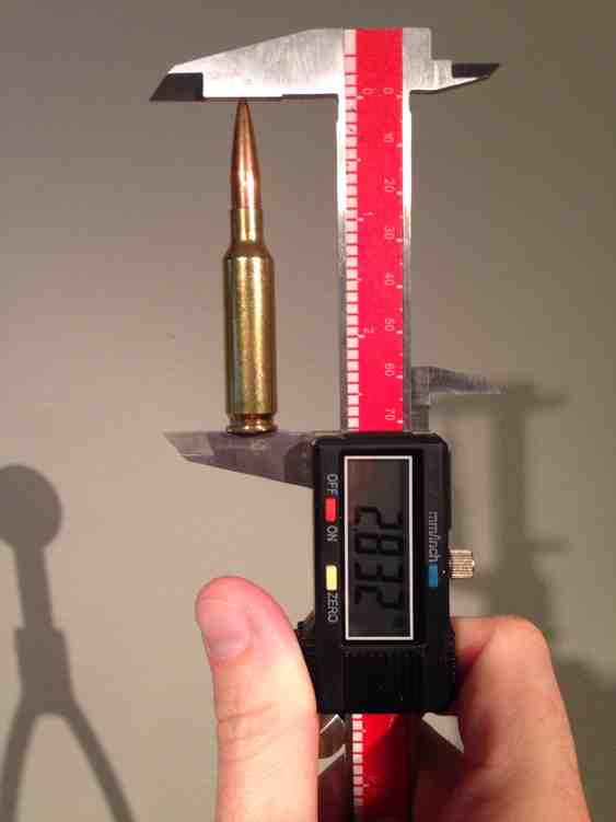

I just came from the range, no wind in WY this aft, maybe 3 days a year we get this lucky! My estimated bc would be .570, if my chrono is close. I've held this bullet up to a 139, IMHO this is a way better looking bullet, it just doesn't have the length to give it a .6 bc. I only had access to 1100 yards today, so don't take my bc as gospel, maybe this week I can run it out to 1500 or so.
As it stands, for 31.50 a box, via Midways 1k sale, I'll run with this bullet till I can find more Norma's.
