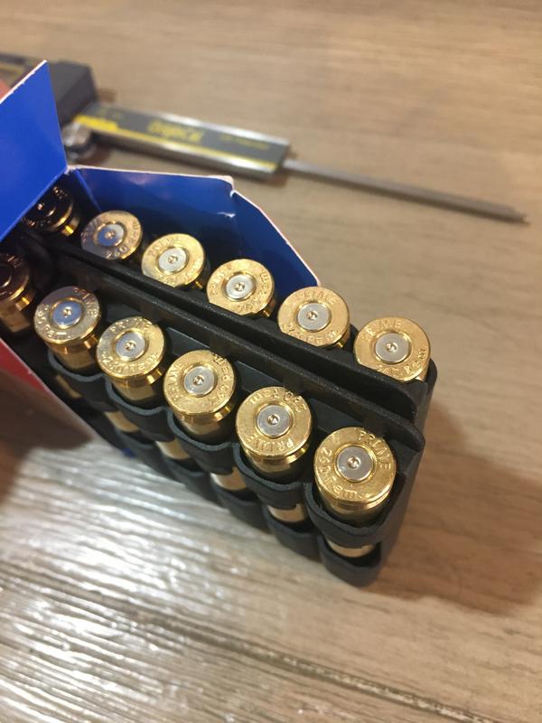

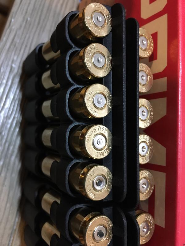

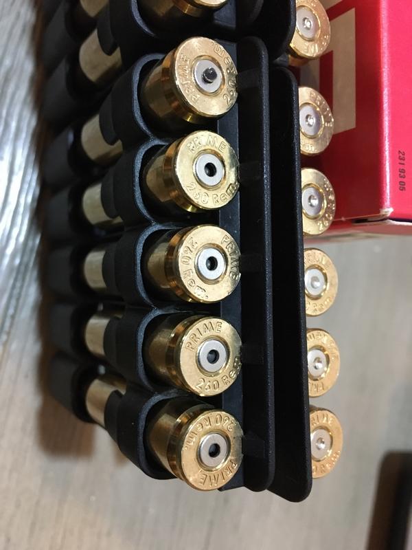

I counted through the brass from yesterday, and I ended up with 6 pierced primers, and 10 craters. Got a nice fire check on the bolt face too.
I put pierced ones in the first picture, some craters in the second, and standard hits in the third.

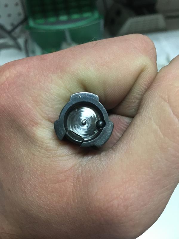

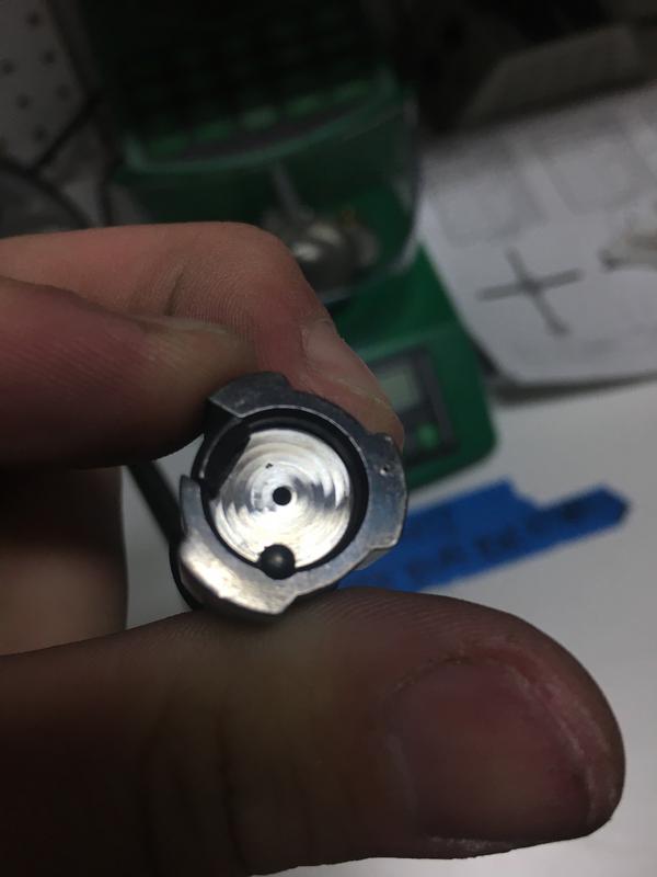

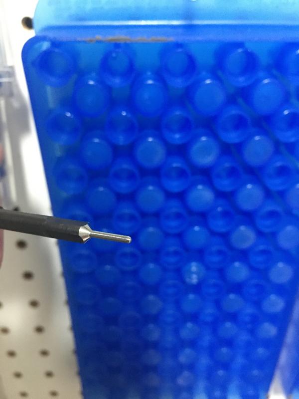

Just wanted to update post-surgery as I got the bolt back from LRI this afternoon. Awesome service and a quick turnaround. I was quoted 10-14 days, and from the time I sent it to the time I got it out of the mailbox was 9 days. I tried to get some light between the FP hole and the pin to no avail. there has to be less than .001" of clearance between the two. The machine work on the bolt face and the pin looks awesome. Check out the radius on the pin shoulder!
Thanks Chad!
I'll update again how the gun behaves after I get the time to shoot it.

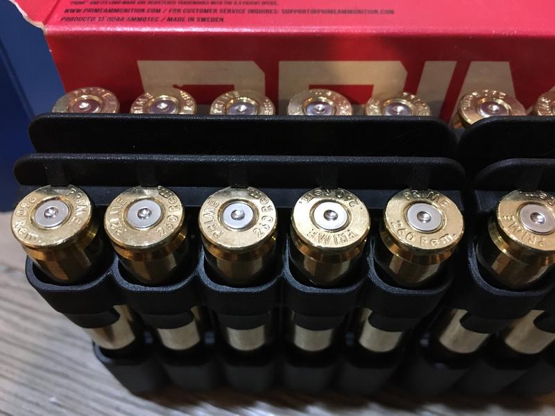

The gun shot fine, and retained the velocity I gained (2870-2880 on the magnetospeed) even after cleaning, so good signs there. I was a little over a tenth high on paper, but that was to be expected.
The brass/primers all looked fine, nice uniform deep strikes with no backflow. I was a little puzzled by the fact that not all of the strikes were centered up, but the gun shot fine, so..... ? Maybe someone can shed some light onto why that could be happening.
When I measured brass to the shoulder I gained about .0015 to .002" of headspace compared to the pre-surgery cases. Plenty manageable numbers there, so no issues.
